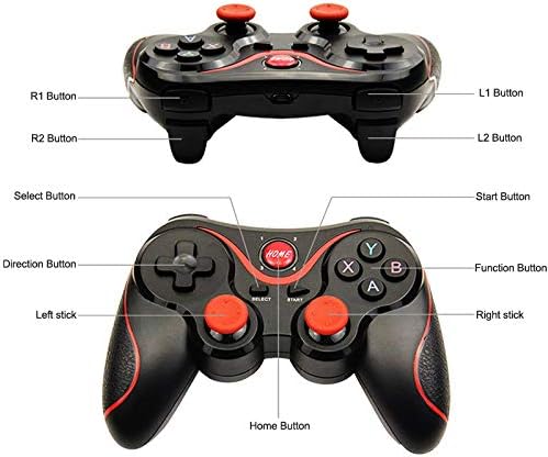

Hi,
I have a Bluetooth controller that I'm currently connecting via a USB cable to play GameCube games using Nintendont. If I understand correctly, does your homebrew app allow you to pair non-Nintendo Bluetooth controllers with the Wii? Would that theoretically work with mine as well, and would I then be able to use it in Nintendont without a USB connection?
It’s a Terios T3 X3 clone, similar in shape and button layout to a PS2 DualShock 2 controller but with A/B/X/Y face buttons instead of ✖/●/■/▲.
It has various connection methods; for example, hold down the X and Home buttons for 3 seconds to pair via Bluetooth, and hold down the Start button while plugging in the USB cable for a wired connection.
I’ve already created a working controller.ini file with HID test for Nintendont:
[BM-707 / BM-727 Bluetooth Android Controller FW: v11]
VID=20BC
PID=5500
Polltype=1
DPAD=1
DigitalLR=1
Power=6,04
# Face and shoulder buttons
A=5,01
B=5,02
X=5,08
Y=5,10
Z=5,80
L=6,01
R=6,02
S=6,08
# D-Pad
Up=4,00
Right=4,02
Down=4,04
Left=4,06
RightUp=4,01
DownRight=4,03
DownLeft=4,05
UpLeft=4,07
# Left analogue stick
StickX=0
StickY=1
# Right analogue stick
CStickX=2
CStickY=3
# Digital / Analogue triggers
ZL=5,40
LAnalog=0
RAnalog=0
The default values (without pressing any buttons) in HID Test were as follows:
80 80 80 80 88 00 00 00
Hi,
Hi!
The homebrew app I've been posting in this thread is just a testing tool for the embedded-game-controller (EGC) library, which is where all the heavy work of supporting USB and BT controllers is done. The idea is that homebrew applications will use the EGC library (maybe not even directly, but most likely via the toolkit they are using, such as libSDL) to process input and gain compatibility with all the controllers supported by EGC. Then the next step would be to prepare a tool to patch official games, so that they can also be used with non-Wii controllers (patching could even happen on the fly, via a loader such as USB LoaderGX or WiiFlow).
Now I am at a stage where I got it working with the Nintendo Switch Joy-cons, the Pro controller, and a couple of brandless Chinese controllers. I plan to improve the testing program in a way that it can be easily used by non-technical users to add their controllers too. I can try to add your controller, if you are willing to test it.
As for Nintendont, the matter is a bit tricky, both because Nintendont code runs on the ARM Starlet CPU (for which I haven't yet created a bluetooth backend -- EGC can work there, but at the moment only with USB controllers), and because Nintendont is built with a special version of devkitPro and libogc, which complicates the build procedure (at least for newcomers like me). But on paper it's all doable.
