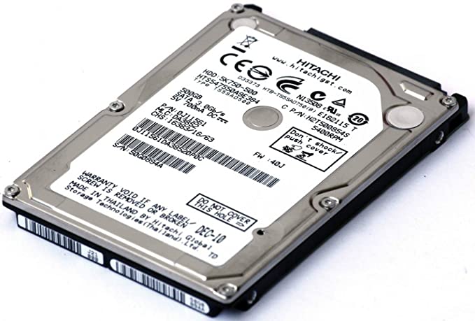

Im not talking about phone though we are talking about hard drive, there is specified voltage and minimum ampere on the drive like the one in the photo
