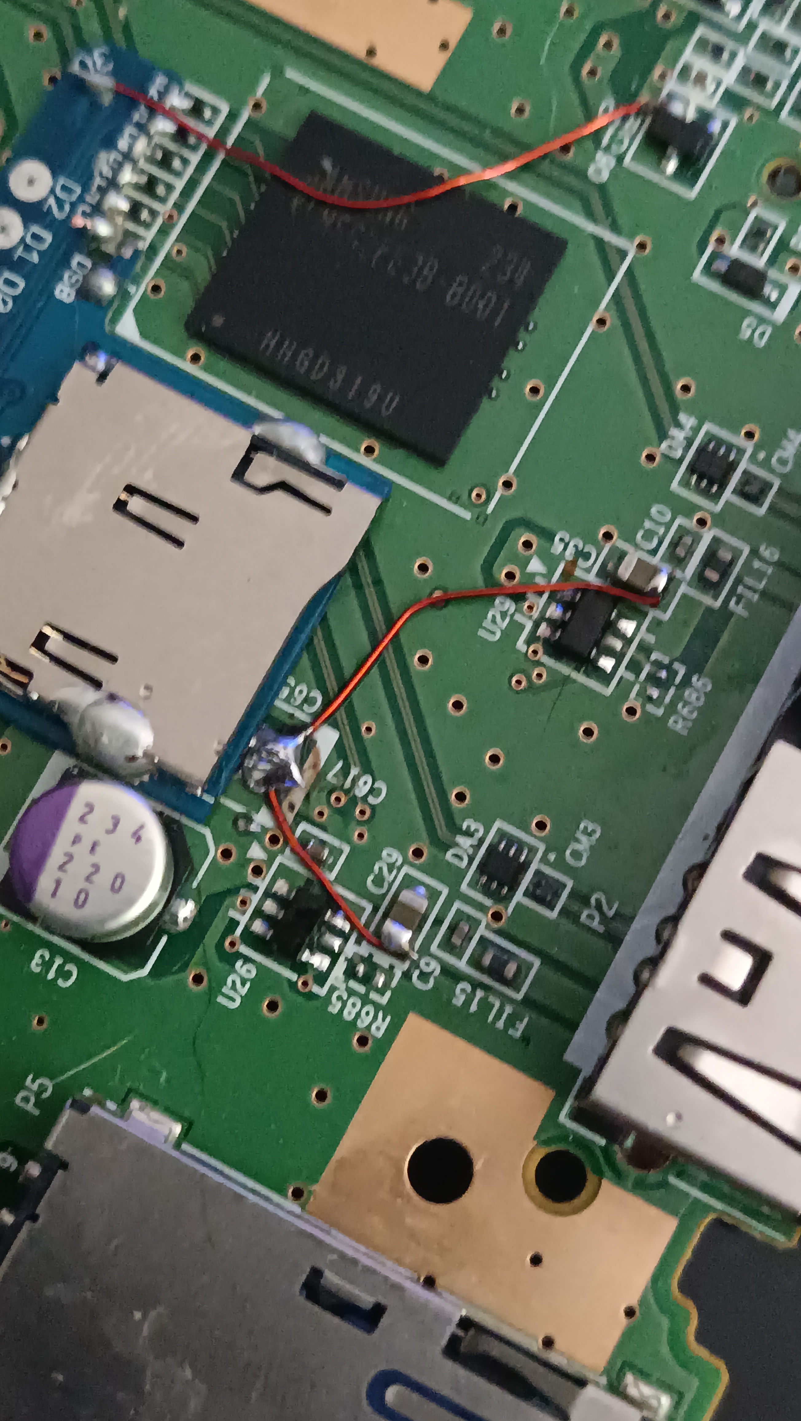

Beside what others said there's also a relative simple hardware mod available. This mod removes the 500mA restriction from the USB ports, so you won't need Y cables anymore.
Can't find the correct link real quick but it's written up here, too: https://ralimtek.com/posts/2023/wiiu/

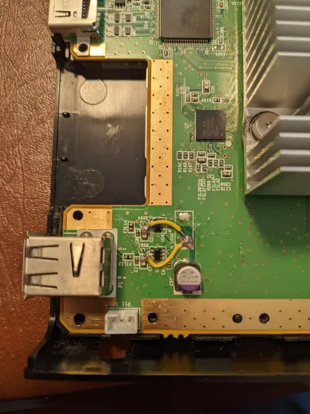

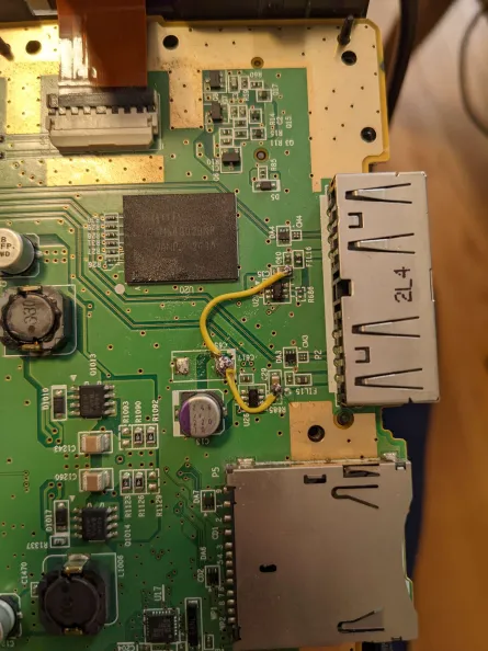

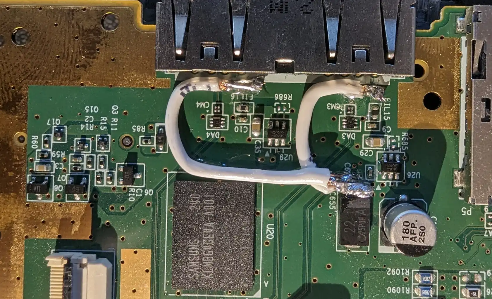

(note that these pictures aren't from me: I highly suggest to use emerald wire here as it makes the job way more simple. Also the first picture is from the link I gave you and while it works I would suggest to make it like in the other pictures: You want to get as close as possible to the small, yellow capacitors to give the USB devices the most stable VCC possible)
//EDIT: Searched through all my backups and here's the mod done with emerald wire, so you might see why I recommend this:
(yes, as you see on that picture the mod is NAND-AID compatible but just ignore that part for now)
