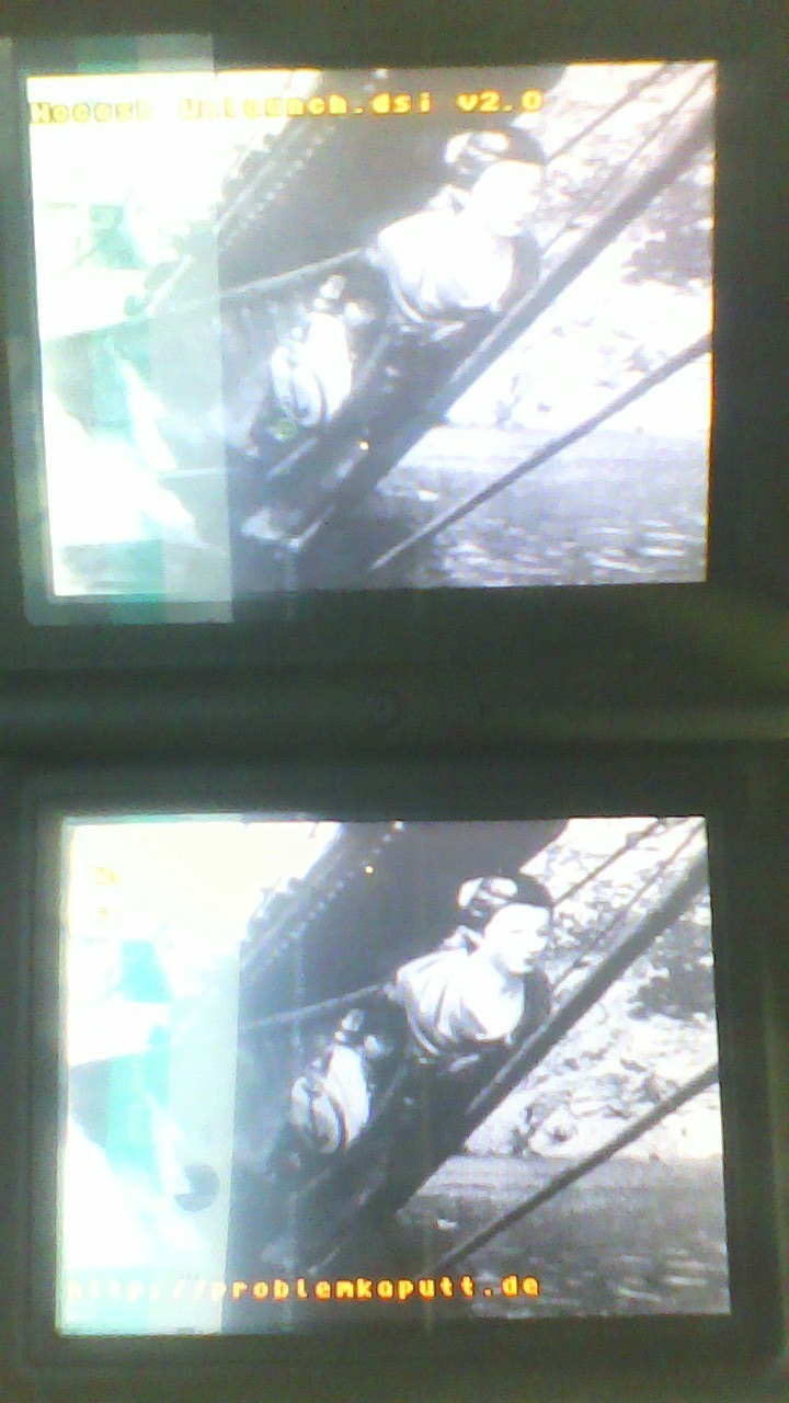

When booting up my dsi it automatically boots to unlauncher but with no options on it, it's empty. I can see the weird lady in the back and everything, there just aren't any options to do anything or click anything. I managed to get twilight working before this happened, can anyone help? I'm usually bad with stuff like this and I just followed a tutorial but I think I did something wrong. unlauncher.png unlauncher.png

It's a micro sd card adapter, I was wondering if that would make it not work but it seemed like it was working
It's 16gb
I formatted it with both the windows formatter and with the SD Card Formatter that was linked previously on this thread, it's still stuck on empty unlaunch menu :/

Yep, it's not a black screen. It's only a black screen if I only turn the console on, but if i do A+power then it opens on blank unlaunch
I also didn't use Memory Pit since my camera crashes whenever I do the tutorial, I used Lenny. I have removed the SD Card and formatted it multiple times but nothing worked, it keeps going blank. I've tried another card as well and there were actual options on the unlauncher menu so it worked, but it literally only showed anything the first time, then it was back to blank again.
You mentioned proceeding with launcher but I can't even get to it, it always autoboots to unlauncher no matter what.

Wait, you're onto something. When i remove my sd card, the menu isn't blank anymore but when I put it in then unlauncher is blank again for some reason?
https://i.imgur.com/pNcTkYm.mp4 this is what happens

yep I did. I also did what you said and plugged in my sd card and I go into flipnote to try and do lenny but it doesn't read the card, says 'sd card cannot be used'. Also another thing, plugging in my sd card when on the unlauncher menu with options instantly makes it empty lol
Maybe this means the sd card is dead? Which is very weird because windows reads it fine, and both of them worked fine on my phone. I ran the first sd card through h2testw and it said it was faulty but it was literally working fine. Maybe the ds is somehow killing my sd cards? don't know

So apparently I got it working. All I did was switch the SD card from unlocked, to locked, and then back to unlocked and now it's reading fine. Super fucking weird but thank you all for the help, was all thanks to you.
