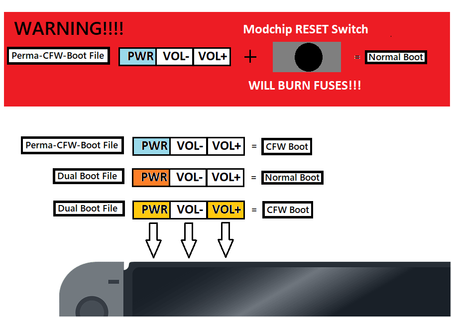

They are incomplete. I have had so much to do lately, I haven`t had chance to complete a thorough write-up.
Easiest thing to do, is:
Choose your part 1 file. Either dualboot by holding vol during power-on, or perma-CFW boot. in this case, CFW will always load.
Choose your part 2 file. Either Fusee_UF2 or Switchboot_UF2.
Drag and drop this onto your SWITCHBOOT or TRINKETBOOT drive.
Fusee_UF2 just searches for "payload.bin" on SD and boots it.
Switchboot is a mod of the Hekate bootloader that is more engineered towards our chips.
Will also boot payload.bin. Will also boot Linux or anything for that matter.
Don`t worry about the extra stuff. That is just for hardcore modders.
Casual users will be fine with Fusee_UF2.

I decided to do away with payload colours, as a lot of chips don`t use an RGB led. And in practice, using colours is useless to those with RCMX86 or REBUG boards.
The first "blink" (red on RGB LEDS) is always payloads - hold until first blink - let go, count the pulses. 1 pulse - payload1.bin, 2 pulses - payload2.bin etc etc upto payload8.bin. Press VOL+ just after your chosen blink, this will save your selection. Reboot Switchboot each time to see your new chosen payload.
The second "blink" - green is always mode. Just 2 modes operational now, in an attempt to simplify this.
Mode 1 will boot switchboot everytime(from the chip)
Mode 2 will boot Fusee_UF2 everytime(from the chip) - remember, all fusee-UF2 does is look for payload.bin (or payloadx.bin depending on the settings you made during the first "red" blink). Thats it. No further configuration necessary.
The third "blink" - blue is further settings. Only 2 further settings.
First is RGB led (called DotStar) brightness. Change your brightness level if too bright or too dim. For people with clear cases. Select this, your LED will fade from dim to white and back again 3 times. Hit vol+ at your required brightness. Saved. Done
Second is "reset". This will set all payloads, modes etc to default settings.
The fourth"blink" - white - you can just hold vol+ for around 10-12 seconds for this - will place your chip into Update mode. You will see a steady blinking light. Power off your console and reboot it. Itv will be a black screen. Connect to USB and your SWITCHBOOT / TRINKETBOOT drive will pop up for updating. Hold power-off for 12 seconds once you have finished dragging / dropping your UF2 files in this mode to return to normal.
Dualboot is only possible if your fuse count matches. Dualboot will NOT save fuses, indeed they are required to be burnt to make it a hardware dual-boot.
Booting stock from within Hekate / Switchboot, is just a normal stock boot, except the fuse-count is ignored. Meaning you can boot any version firmware, regardless of fuses.
Regarding clean boot - if you are using an emummc or emunand and have done since day 1, then I guess your systemNAND will be clean. Never go online if in CFW mode.

1) Choose your chip below.
2) Select a part 1 file - DUAL-BOOT or PERMA_CFW_BOOT
View attachment 173166 Click this to see the difference in bootloaders...
3) Select a part 2 file
