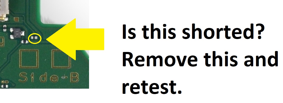

Hi there, I soldered a trinket m0 for my friend's switch and when vol+ strap is soldered the vol+ button itself is acting as a vol-, vol- isn't functional and when I press launch without a microsd card inserted the "couldn't init microsd card" error message is being displayed all across the screen and softlocks the device. I didn't short anything while soldering, I even tried to solder the strap to the ribbon with the buttons instead the make sure it isn't my soldering and setup the trinket from scratch. Can anyone help? I'm clueless.
I keep getting my device isn't recognised on windows after connecting my Switch to the PC. But when I disconnect both the USB cables on the trinkets (traces 2 and 3) via desoldering them then I can connect the cable to the pc and everything works. Does this mean, I wouldn't be able to usb install stuff. I usually use nxmtp you see to connect my switch to the pc, but since those wires are connected I can't and when I remove them, I can use nxmtp to explore my switch content and usb install stuff. Is this normal? Here's what I disconnect to get everything working normally.

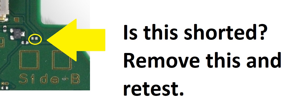

1) Is the Trinket flashed OK?
2) There is a capacitor... Shunt capacitor. Gives the "discrete" voltage somewhere to go if current too high. Makes the pressing action nice and smooth. A bit like a condenser on a car ignition system. If it fails, it shorts GPIO to GND, leading to a "constantly pressed" condition. Doesn`t happen often during installs. Replace with something like a 100nF 6.3v 0201.
This could be shorted.
Remove and retest console. If vol buttons now work, then replace this.
