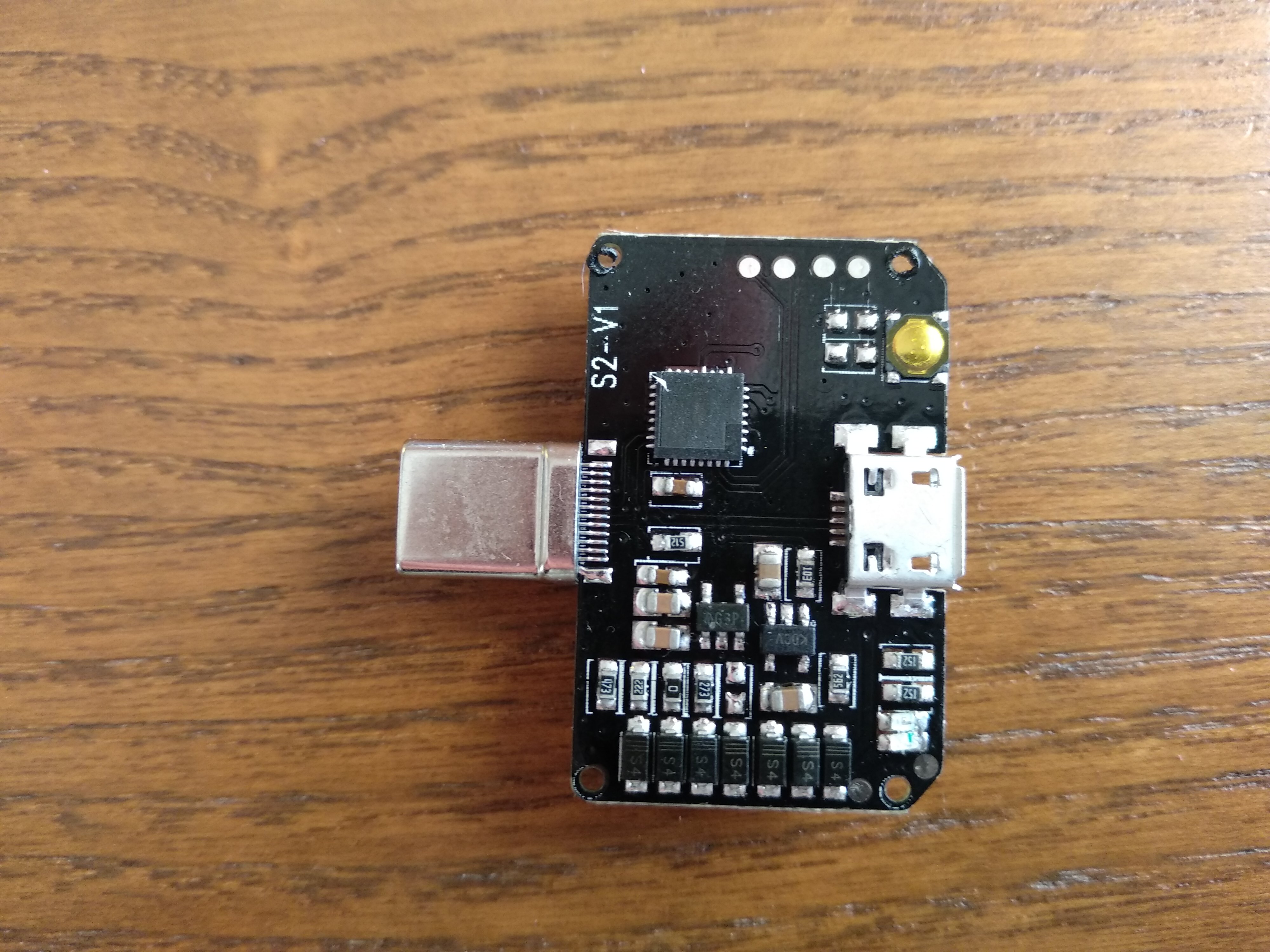

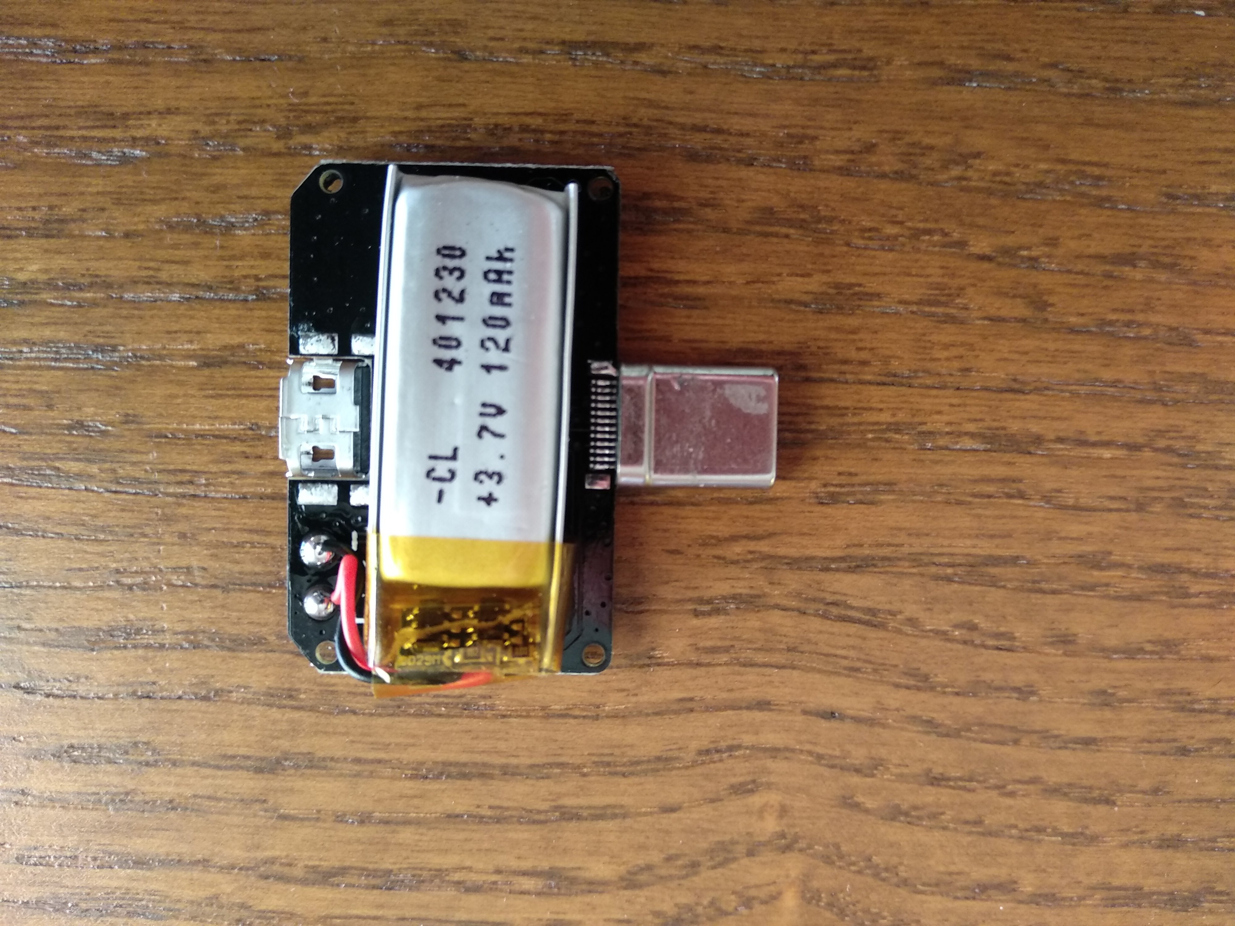

I've got mine installed in this configuration what should i do? Also if anyone wasn't aware you can use your switch as a dongle for other switches with a c to c cable
It may not work as the data lines are used when the console is charging. If you try to boot with a modchip while the charger is plugged in it doesn't work so i doubt the dock will

And indeed, yes. You can use a C-C cable back to back to push a payload to another switch.
Are you 100% positive that the data lines are used when charging, or are the tx rx etc used?
