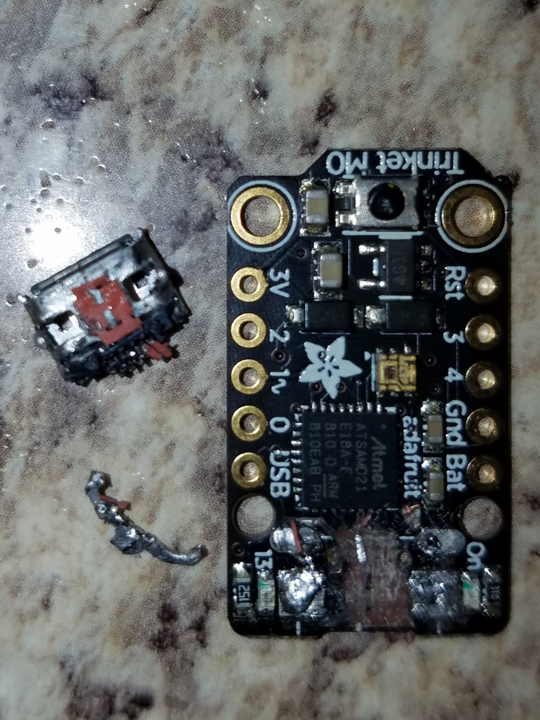

The good news: flashing the chip was easy and it only cost me $12 to buy.
The bad news: I torched the crap out of the chip with a heat gun trying to get the USB port off of it. I ended up pulling the pads off entirely, so this project is bust for now. I actually think I could have soldered it in place had I been able to prepare the chip, but that isn't relevant now.
Here's a good example of what not to do.
You can still connect to the qfn pads... They are still intact. Difficult though
