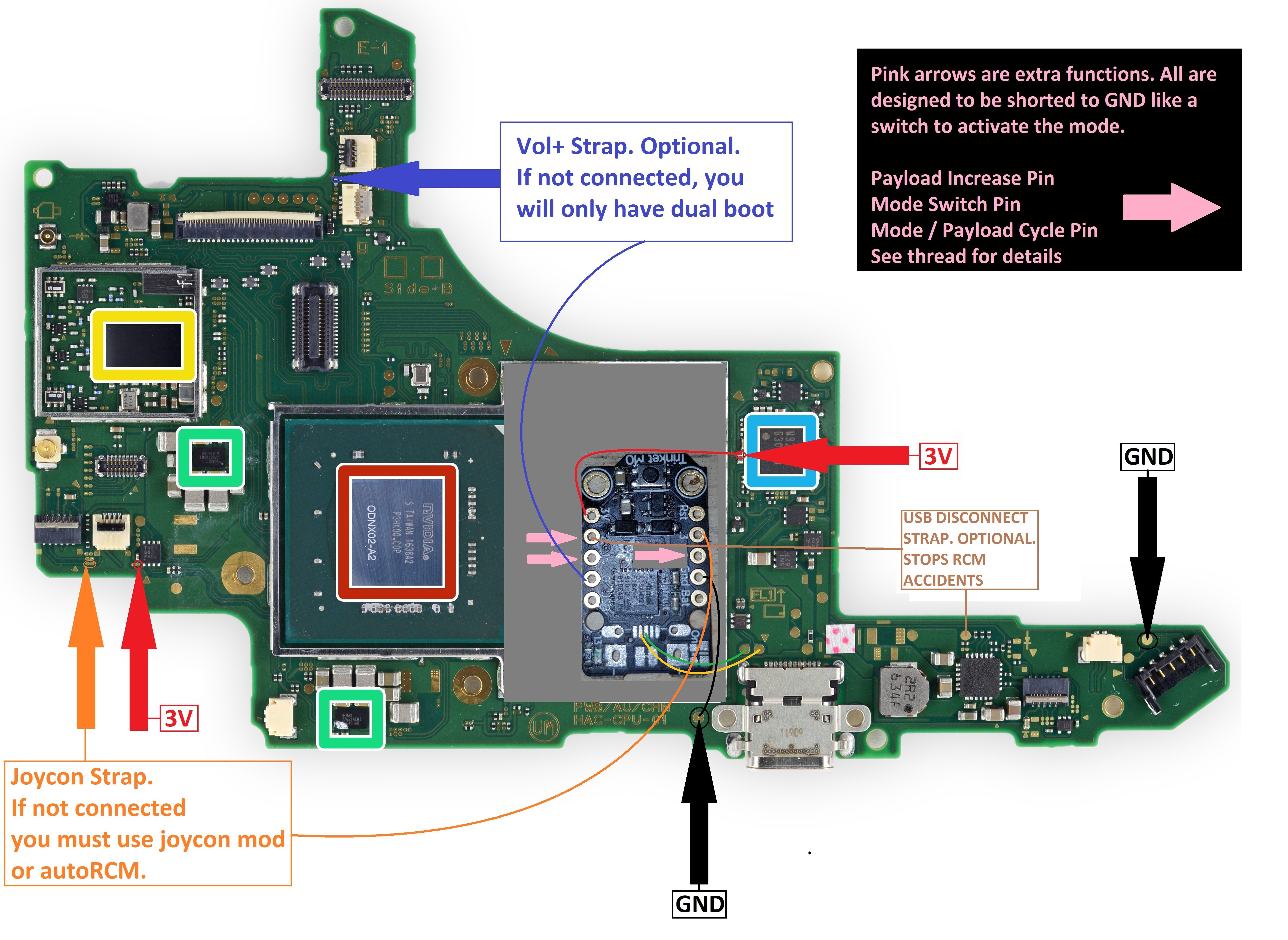

I just installed with Trinket M0 (v0.9.8r2) and I'm having an issue where USB install with Goldleaf or Tinfoil does not work. Goldleaf hangs, whereas Tinfoil causes an error on the Switch. I know Goldleaf USB install worked prior to this installation. It seems like the Trinket is not properly disconnected from the USB lines when asleep. Is this issue documented?

What exactly is the USB strap for? I couldn't find any clear description of what it does and I'd like to know in case it could be related to the problem.
Thanks for helping me troubleshoot this. I tried that UF2 image and the USB issue with TInfoil stopped. However, I put the 0.9.8r2 UF2 back on the Trinket and Tinfoil works now. I have no what changed.
OK... The USB strap is to prevent being stuck in RCM.
If you connect your switch to your PC when it is switched off, because you either have autoRCM enabled or straps connected, the console will go to RCM mode.
All the USB strap does is sense this unplugging of USB and push the payload.
If this didn`t happen, once your console is in RCM, you either need to hard-power-down (for 12 seconds) or press the reset switch on the trinket to manually push the payload.
This is enabled and disabled in software. If it is fitted, it will activate the code. If it isn`t fitted, it will remain disabled until either you reflash a UF2 or a full vol+ reset is made.
If you have the strap fitted, but wish to disable it, you can long-press vol+ for 12 seconds, or if you don`t have vol+ strap fitted, as soon as you drag over simple-UF2, as soon as the file transfer box disappears, disconnect USB. It relies on checking if it is plugged in you see. If you unplug before the results of the check have been complete, the code will be disabled.

I'm a little confused now. I got the same error with Tinfoil again even though it had been working (using the 0.9.8r2 UF2, not the test one you linked). Now, the Switch behaves as if the volume up button is always pressed, even though I did not connect a wire to it. I've fully powered it down, turned autoRCM off and on, but this issue persists. How can the volume button be "pressed" when the Trinket is only connected through USB? This almost seems like a software bug caused by shutting down after an error message.
I uploaded the second USB-disable-UF2 you sent to see if it would change anything, but it wouldn't boot Hekate or anything else. My PC also couldn't see the Trinket in bootloader mode until I booted Horizon by sending a payload from my PC through USB.

OK. You have no "straps" connected...
OK where are you getting power for your Trinket? The emmc by any chance?
Power is coming from the component indicated here:
