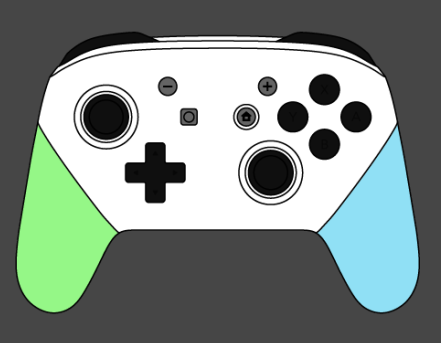

So everything works however the pro controllers only rewrite as one solid color even though it gives me an option to make the grips a different color. Anyone have similar issues and have a fix?
Pro controller grip color changes do not work. The pro controller changes into one solid color and does not show the grips different colors on the switch. Switch and controller are updated. Anyone have any troubleshoots?
Pro controller grips won't seem to change for me, is there something I'm doing wrong? The handles just seem to copy the colour of the body.
Edit: Is it possible that the splatoon controller is somehow different? The other controller I did was a normal pro controller and it worked perfectly.
Edit again: After browsing through this thread some more I found an explanation and it seems to have worked for me (in case anyone else has this problem).
"A fix has finally been found for the Pro Controller color issue!
First, set your colors like you normally would.
Then, open "More..." and go to "Debug" to open "Debug: Custom Command".
Set the following:
Cmd: 01
Subcmd: 11
Then click on "HD Rumble Player". This is necessary to trick the program into allowing you to set the Subcmd to 11,
as it's normally disabled. Open "Debug: Custom Command" again
Subcmd arguments: 1B6000000102
Hit "Send" .You should get a Subcmd Reply starting with 80 11. You should be good to go then"

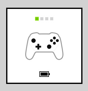

Hello, I have a problem. When I use these colors, I got that on my switch. It's strange because when I reconnect to joycon toolkit, it show the right colors but not on the switch. (originaly, my controller is the Splatoon one) 2020072420515400-1E95E5926F1CB99A87326D927F27B47E.jpg Annotation 2020-07-24 204939.png
