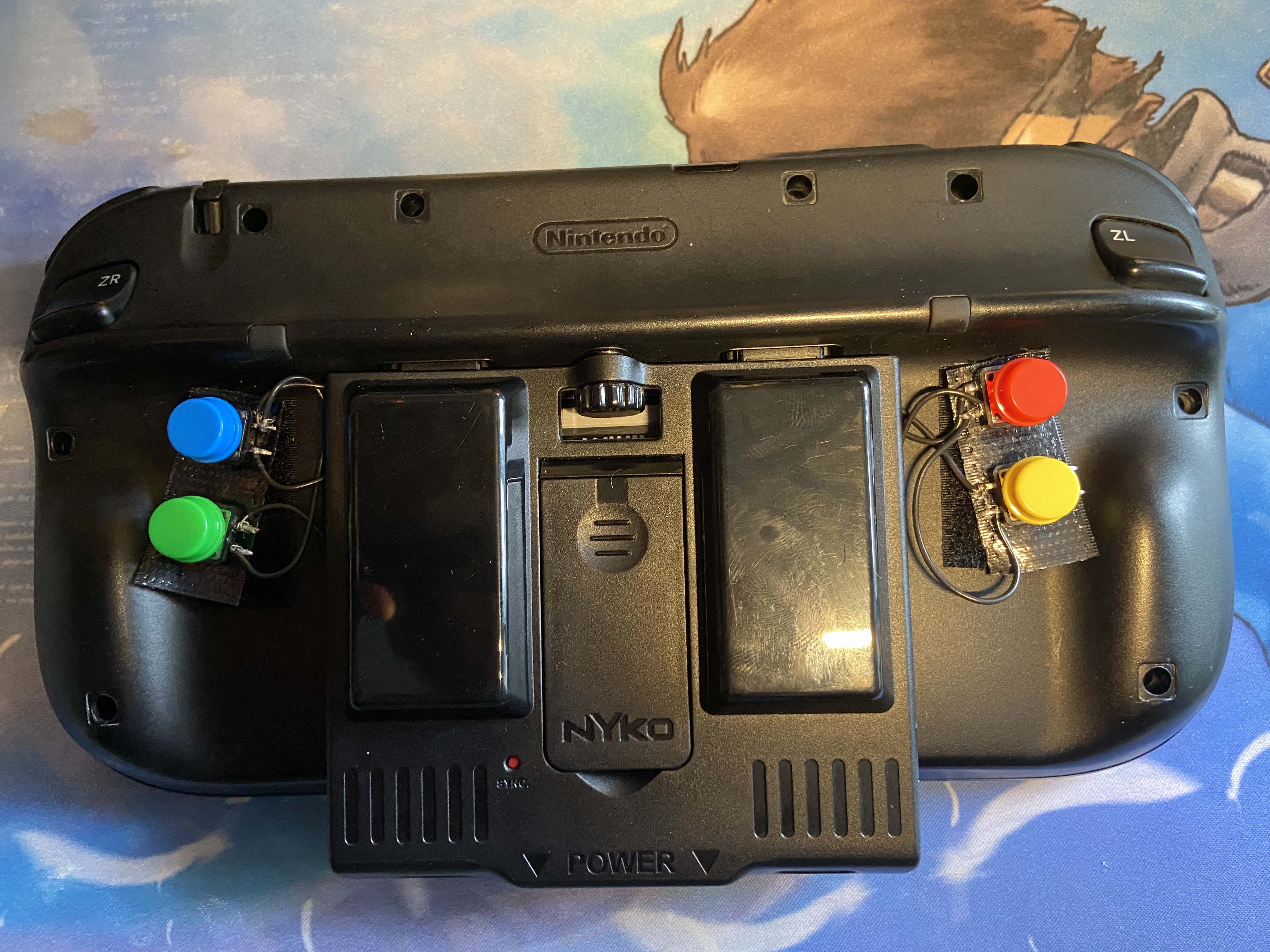

I have used my Xbox Elite controller as a Pro Controller mostly for the paddles on the back so I can keep my thumb on the right control stick, and navigate menus with my dominant left hand. Having them mapped to A & B on the left and X & Y on the right also lets me sprint and jump at the same time in BotW. But it's a pain to set up, and a pain to change which adapter is attached (Brook Super Converter for Wii U, Brook Xone for Switch), especially as the Xone replaces the battery door and is quite stiff to attach/remove.

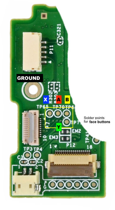

The Gamepad has flexible circuit boards for ABXY+-RZr and dpadLZz, and soldering to these would probably melt the plastic backing. So I've soldered wires to the test points on the motherboard:
I would also be interested in adding d-pad directions for use with Xenoblade Chronicles X, but there is no similar cluster of test points at the other end of the board : (. I have tested all hundred-odd test points against the ribbon cable sockets on each side, but I've only been able to identify a bunch of common-ground connections.
As the Wii U was not very popular, controller modders have mostly not studied it, so AcidMods doesn't have pinouts the way they do for Xbox controllers. The main hardware mod seems to be removing motherboard to build a Raspberry Pi portable, retaining the button connections. Sudomods therefore have details of the ribbon cable connections, so I was able to trace the face buttons's test points.

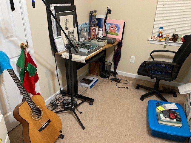

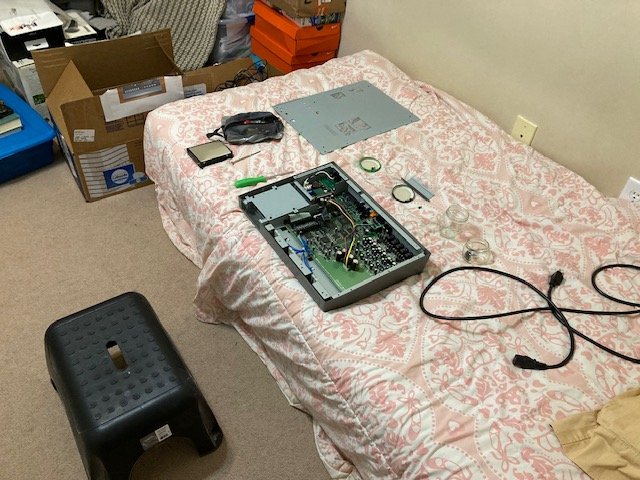

Doing a double open-heart (HDD) surgery on two old Roland VS-880EX multitrack systems the other night. I had been getting "drive not detected" errors on my old system, and my brother gave me his. His worked a few times, then the same issues. He also hadn't used his in a long time. Mine, I hadn't used in probably 15 years. I ordered a comparable HDD off eBay, threw it into his system, and though it recognized the drive at first, it wouldn't initialize. So, I had waited 'til I had some free time to take them both apart and confirm that I had the adapter pins connected properly. They were...
So, another drive from a different eBay seller arrived yesterday. Gonna make a last-ditch effort next time I have more free time to try for a positive result.
The new HDD arrived the day before yesterday. I had some time yesterday to work through the install. Powered her on, and...
It took several hours (had to leave it on to do its thing overnight), but she successfully processed through all the initialization and testing procedures, and was asking for a restart this morning. I just successfully executed the shut-down procedure. Looks like I've got myself a working digital workstation again. She might be "outdated," but she still got the moves.
