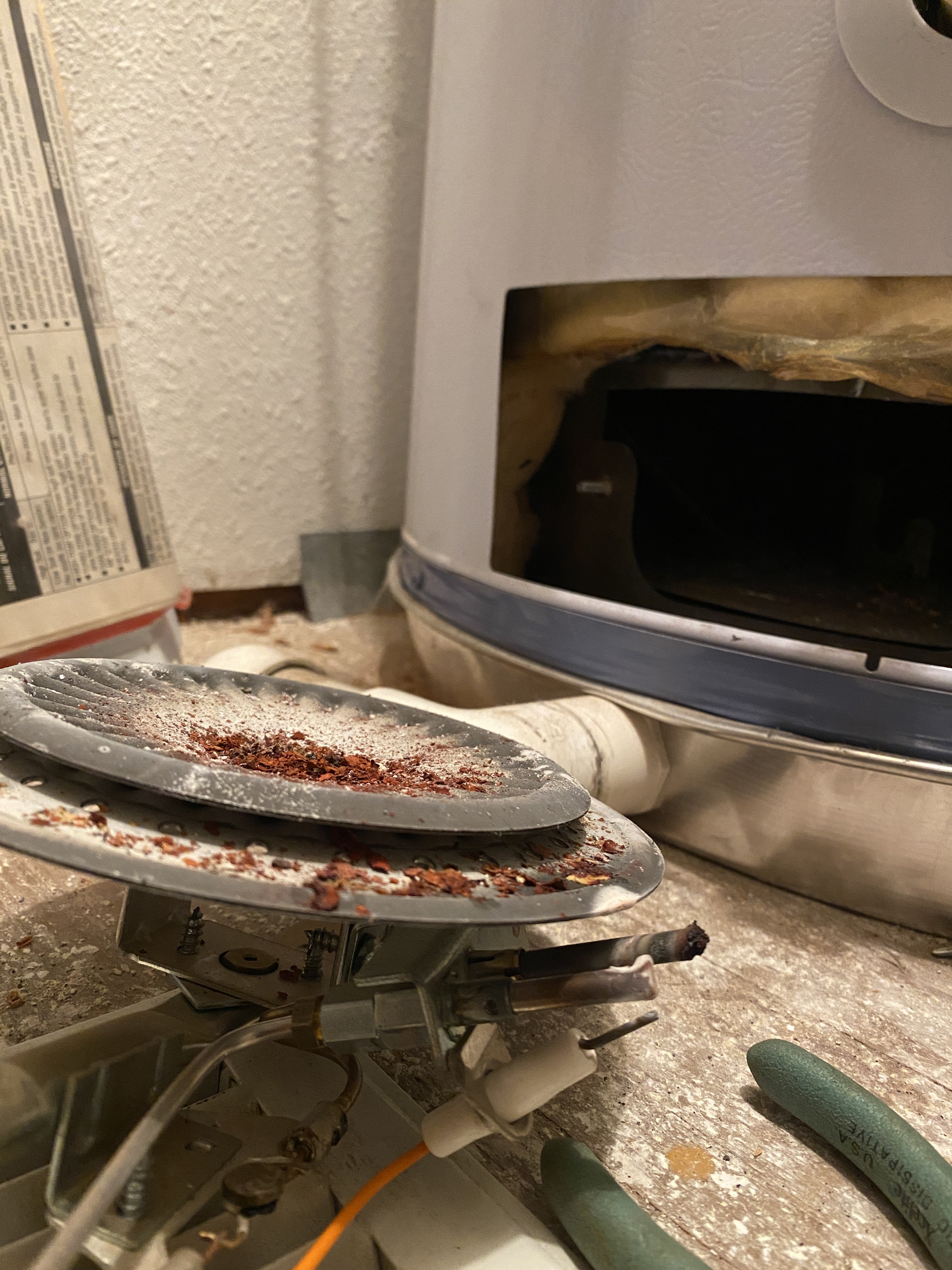

Fixed our water heater! The pilot light would light, but go out immediately. Turns out, either the thermopile and/or thermocoupler got too dirty. Found out there might be an issue when my kid said there was no hot water when she took a slower.
Cleaned it up and vacuumed the mess, inside the heater too. Works great now! Saved a grip of money and headache. I just wished I could’ve fixed it sooner. It’s been a couple of days.

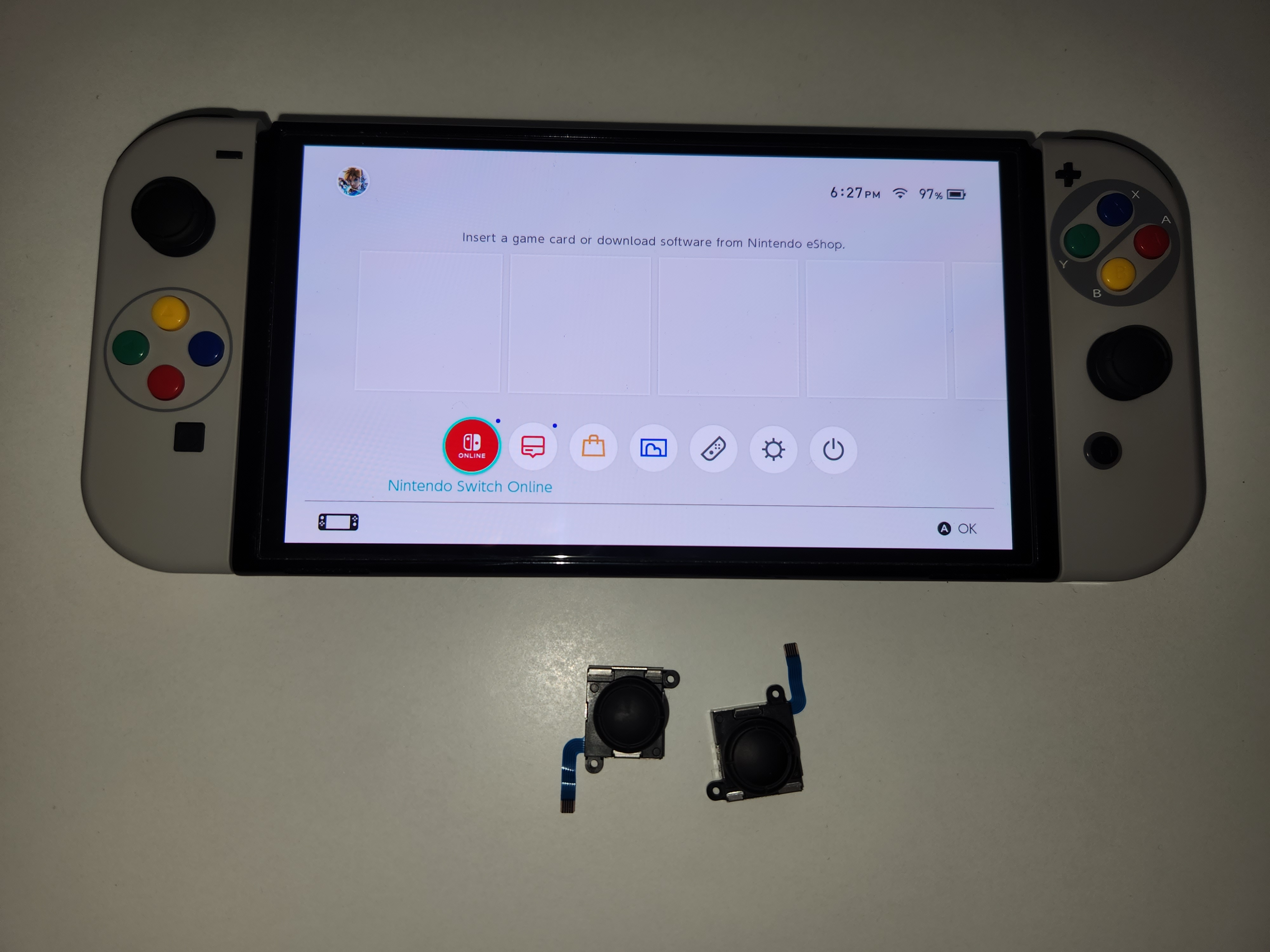

Analog stick replacement for drifting joycon. I guess I play too much 😂.
I used that paper trick. You place some cardboard (card stock) under the metal housing of the analog stick. It really resolved my drifting issue.
Luckily I have no drifting issues with my Switch so far.
Good to know, even though I have a cheap Logitec PS2 type controller. Thanks.

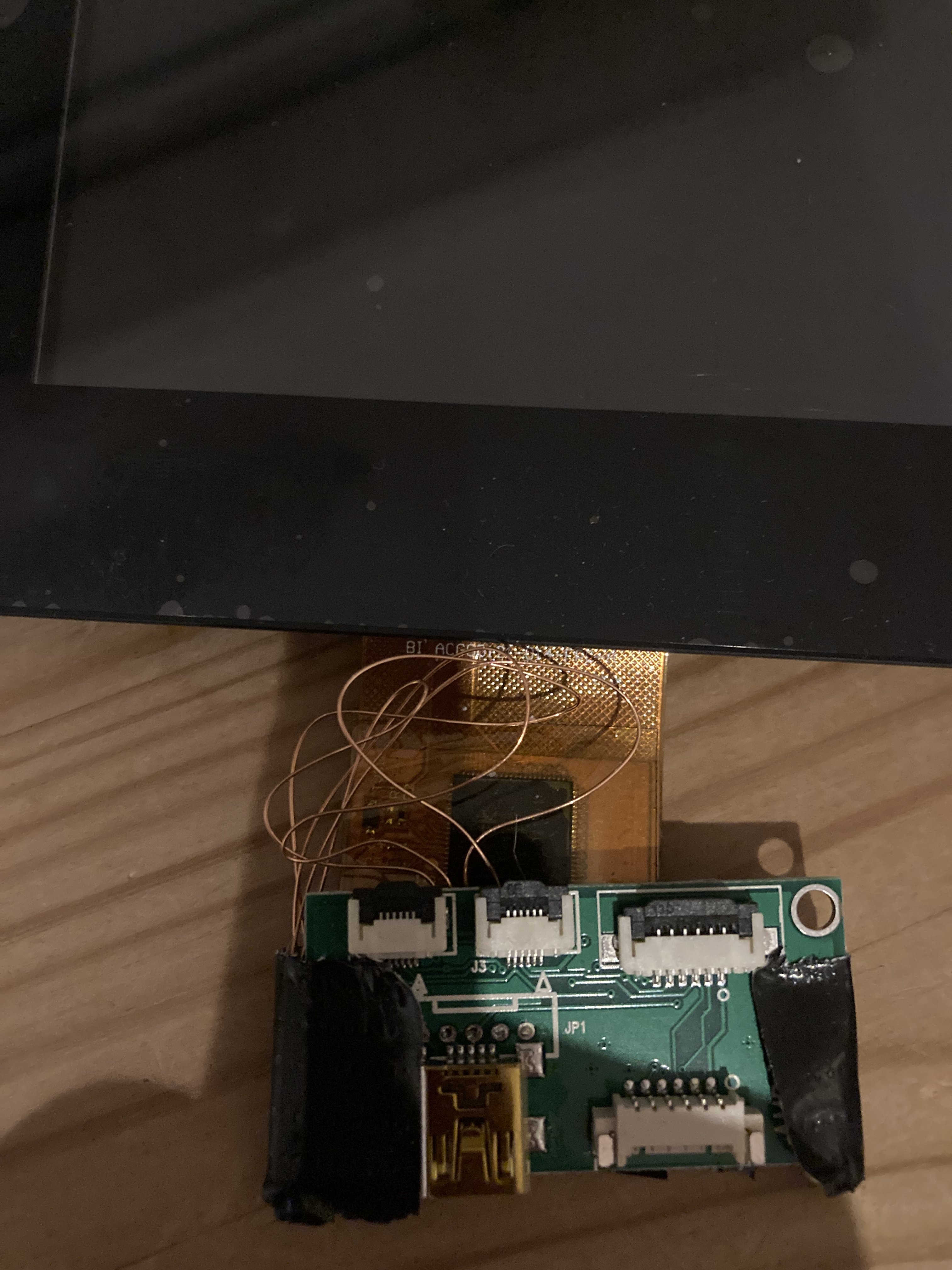

fixed a self-cap touch button. The button didnt turned on the LED no more. I drilled a hole above the button, but it turned out the thickness of the plastic wasnt the reason why it wasnt working. I also checked the battery, but it was charged. The root cause was the plastic itself. It draw energy from the sensor at direct contact. after I realized that, I cleaned the plastic below the sensor, but surprisingly it didnt worked any better. However after putting small stripes of doubles sided tape between sensor and the plastic shell it worked flawless again, also through the plastic. and do not ask me about the ear. I have already reattached with any type of glue. It always survives only a few days afterwards. I have given up here and accept the disability of the mouse.
