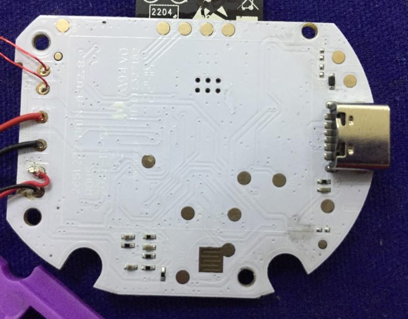

- Most importantly: tomorrow56 found and photographed test pads on the back of the board, explicitly identified as exposing UART plus the signal for triggering the chip's Download Boot mode. That's just the standard Espressif bootloader entry point — the same one esptool.py talks to on every ESP32 project. No glitching or decapping needed to get flash access, just normal ESP32 dev workflow.
Given that, the procedure to actually dump the flash should be:
1. Open the case and locate those test pads (cross-reference tomorrow56's photos for exact placement — I haven't pinned down which pad is which signal yet).
2. Identify GND, TX, RX, and the boot-mode pin (typically GPIO0 on ESP32-series chips — needs to be pulled low during reset to enter download mode).
3. Touch test probes (pogo pins or fine clips, no soldering needed) from a cheap USB-serial adapter to those pads.
4. Hold the boot pin low while power-cycling/resetting so it boots into Download mode instead of running the app.
5. pip install esptool, then read out the full 16MB: esptool.py --port [your port] --baud 115200 read_flash 0 0x1000000 uni_dump.bin
6. From there we've got the actual firmware to dig through — partition table, trust store/certs (answers the CA question from earlier), and hopefully the asset/character data format.

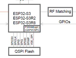

Block Diagram for SWALLOWUNI
The SOC has an external SPI Flash (not a shocker i know) and guessing being BANDAI, they would have forgotten to disable both UART and SPI Read permissions (since well, it kinda needs it)
AND, THE DIAGRAM OF HOW THE ESP32 IS CONNCECTED IS KINDA EASY TO SEE DUE TO the internal photos document.

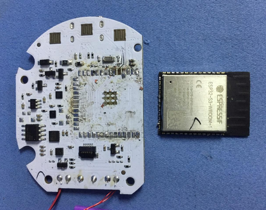

FCC Internal Photos for SWALLOWUNI

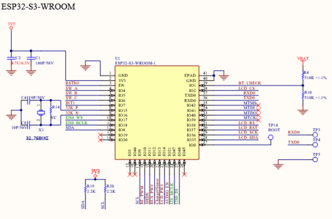

And also thanks to the FCC, we have public the:
Circuit Diagram For SWALLOWUNI
Which oddly enough show me a few things:
  • Besides the ESP32-S3-WROOM-1being the only interesting thing (and the one that handles everything), the thing also has an accelerometer.
  • Anything else is just basic or regular components (Power Block and DAC/Audio Circuit).
  • And that the ESP32-S3-WROOM-1 Is kinda a normal unit with only BANDAI/ Tamagochi Software.

EDIT: Found that BANDAI Technically has the pins for TX and RX enabled
Sorry for shody Pic, idk how to download off FCC.

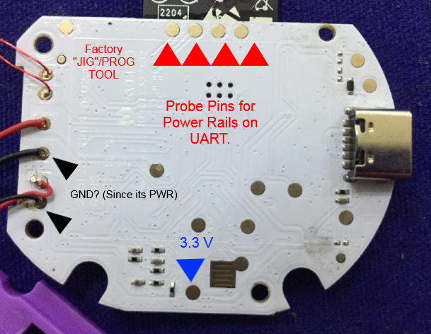

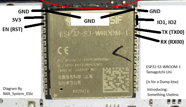

I have an idea. Since we know what the pinout of the ESP32 is and looking at the PCB, It seems that oddly enought Bandai left 4 pins of the back of the device that are:
  • Close to the ESP32 Module (I'll refer to it as ESP32 as its easier to name it.)
  • Seem that could be for UART (4 Pins: GND, PWR/3.3 V (Since well, the patchi OFF uses a exposed 3.3 V Line that could be wired)
Since i guess, we could probe these with a multimeter, we could figure out where the power rails for that are.
BUT, YOU MAY ASK OR SAY: "Cool N4A, BUT WHERE DO WE GET TX AND RX?!"
Haven't tried this myself yet on a real unit, posting the plan before touching anything in case someone's already further along or sees a problem with it. Anyone want to confirm pad locations against their own board before I commit to probing mine?
But inestead of probing like crazy/ risk damage to a Poor Uni unit (as it's suffering wasn't enough) To figure out the pins, i have made a little diagram/idk what that (Maybe poorly) figures out how the ESP32 is wired on the PCB.
My idea is as follows. (SINCE I DONT OWN THE DEVICE AT THIS POINT)
  • Use the diagram to find UART Pins, and my best bet is the 4 Close pins under the board. since i guess a JIG or a tool that poked those was used.
  • After finding the pins, try and talk to the ESP32.
  • Read eFuses flags (If any)
  • And then dump the SPI flash.

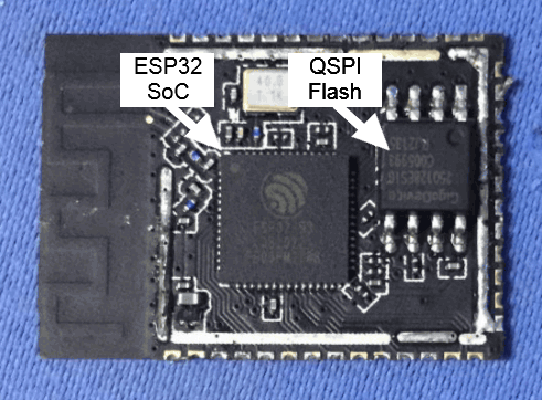

Here's the SPI Flash. I cant really touch it, becouse I DONT OWN IT :c (i wish i would btw)
After googling the SPI... Or should i say... NOR!..
Well, back on point i can say this (Which we kinda knew)
  • Its 16 MB (128 Mbit)
  • Its NOR.
  • In this case its made by GigaDevice (GD25Q128ESIG). FOR THIS CHIP ONLY IT SUPPORTS OR HAS:
    • Uniform Block sectors of either 4/32/64 K-Byte.
    • 128-bit Unique ID for each device.
    • Serial Flash Discoverable parameters (SFDP) register
    • It also has "Software/Hardware Write Protection"
      • "Write protect all/portion of memory via software"
      • "Enable/Disable protection with WP# Pin"
      • "Top/Bottom Block protection"
    • And sadly, OTP Protection. "3x1024-Byte Security Registers With OTP Locks"

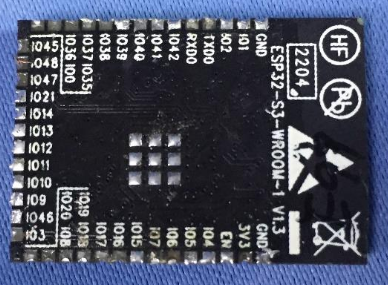

So i have been reading about the especific ESP32 Used on the Tamagotchi Uni (ESP32-S3-WROOM-1)
And i have concluded the following:
  • Besides Wi-Fi, the chipset supports and has bluetooth (Bluetooth LE: Bluetooth 5, Bluetooth mesh), but is "never used" (Unless the phone Wifi pairing uses it, i cant test this as of the time of writing i dont own a device.) (Tamagotchi Uni Manual (ENG)
  • Internal co-existence mechanism between Wi-Fi
    and Bluetooth to share the same antenna
  • 36 GPIOs ( Let's say 3 are used by the buttons, 4 by the screen (i can count 6 pins on the connector and i guess GND and 3v3/3.3V are shared from somewhere else), The accelerometer (lets say 4-6), so that leaves us with 24-22 GPIO Ports free, which can be traced by looking at the ESP32's underside, but no worry, no need to desolder yours since theres a diagram on the reverse side where you can look at the pins, and for what i guess is our uses there's no need to use them.)
  • 384 KB ROM
  • 512 KB SRAM
  • 16 KB SRAM in RTC

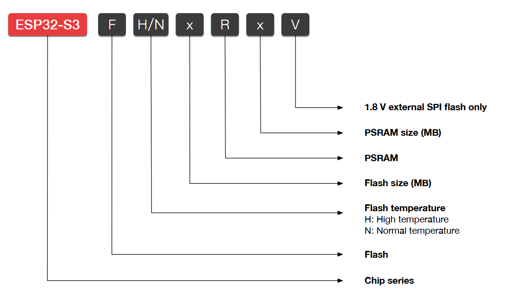

  • 16 MB NOR/SPI Flash (So that makes this one a ESP32-S3-WROOM-1-N16R8 or ESP32-S3-WROOM-1-N16R16VA. Although if bandai customized it "For customization of ESP32-S3-WROOM-1-H4, ESP32-S3-WROOM-1U-H4, and ESP32-S3-WROOM-1U-N16R16VA, please contact us" - Extracted from the Datasheet (Page 4))
  • The PSRAM is embedded ("The modules use PSRAM integrated in the chip’s package." - Datasheet (Page 5))
  • VDD for the NOR/SPI is 1.8v ("Please note that the VDD_SPI voltage is 1.8 V for ESP32-S3-WROOM-1-N16R16VA and ESP32-S3-WROOM-1U-N16R16VA only." - Datasheet (Page 5))
  • And that this thing does have 8 MB or 2 MB OF RAM! Not 16... Why Bandai... When the peak was coming up...
Also something important to note is that according to the block diagram Bandai used a S3,S3R2 or S3R8. So that means... That maybe what i said above could be wrong. (Im refering to the board used, not the CPU/SoC used)
(The photo here is from the FCC block diagram)
But luckly the Specsheet for these cores is available Online!
ESP32-S3 Series Datasheet

The beatiful weird, cute, odd block diagram. Which i must admit is quite unique.
And we also get some of the cool I/O (Over digital I/O or GPIO):
  • 3x UART Ports! (Factory flashing could have used one... and i have wired it out...)
  • 2x I2C (Screen Interface and accelerometer maybe?)
  • 1x USB Serial / JTAG Controller
  • 1 x SDIO Host Controller with 2 slots.
  • A General DMA Controller (GDNA) with 5 transmit channels and 5 receive channels.
  • Has two Low Power CPUs:
    • ULP-RISC-V coprocessor.
    • ULP-FSM coprocessor.

Ignoring that and looking at the nomenclatures:
I can conlude that Bandai used:
  • A model that was either customized by espessif (Not likely since Bandai uses lots of off the shelf parts since forever. like the Sonix SNC73410 MCU found on the Paradise)
  • Or any of the S3 models (S3,S3R2 (2MB RAM), S3R8 (8 MB OF RAM))
This is all i can conclude unless i get a picture of the Chip used, since the filings dont have a very high quality pic.
But what i can add is that my theory of the pins being conncected to a test point on the mobo is correct since if i look at the block diagram (UNI Block Squematics):
Yes. The TP3 is RX and TP4 is TX. So that also means that my theory of the JIG being real is possible.
Well that's all for now.

I have news to share, It seems that on some areas (Discord Servers and such) some people have discovered that:
UART IS possible, but leads to a console.
The ESP-32 has secure boot enabled and its SPI/NOR IS encrypted.
That Bandai at much js contacted a design company to make the Device.
And for the moment the ESP-32 Device family that the Uni uses has been undefeated.
This doesnt mean ofc that im giving Up... If anything im going to try and get more help, research, data and people to help me. But if the info above resulta useful (but maybe for the people that i have talked to see It more as a recap/basics of what they know of the Uni.)
In resume, we need more people and help. So if anyone has any ideas or anything that could help us (Knowladge, Devices, anything) is welcome. I know this is a far cry into the void, but if you the render have something that can help this, please share It...
