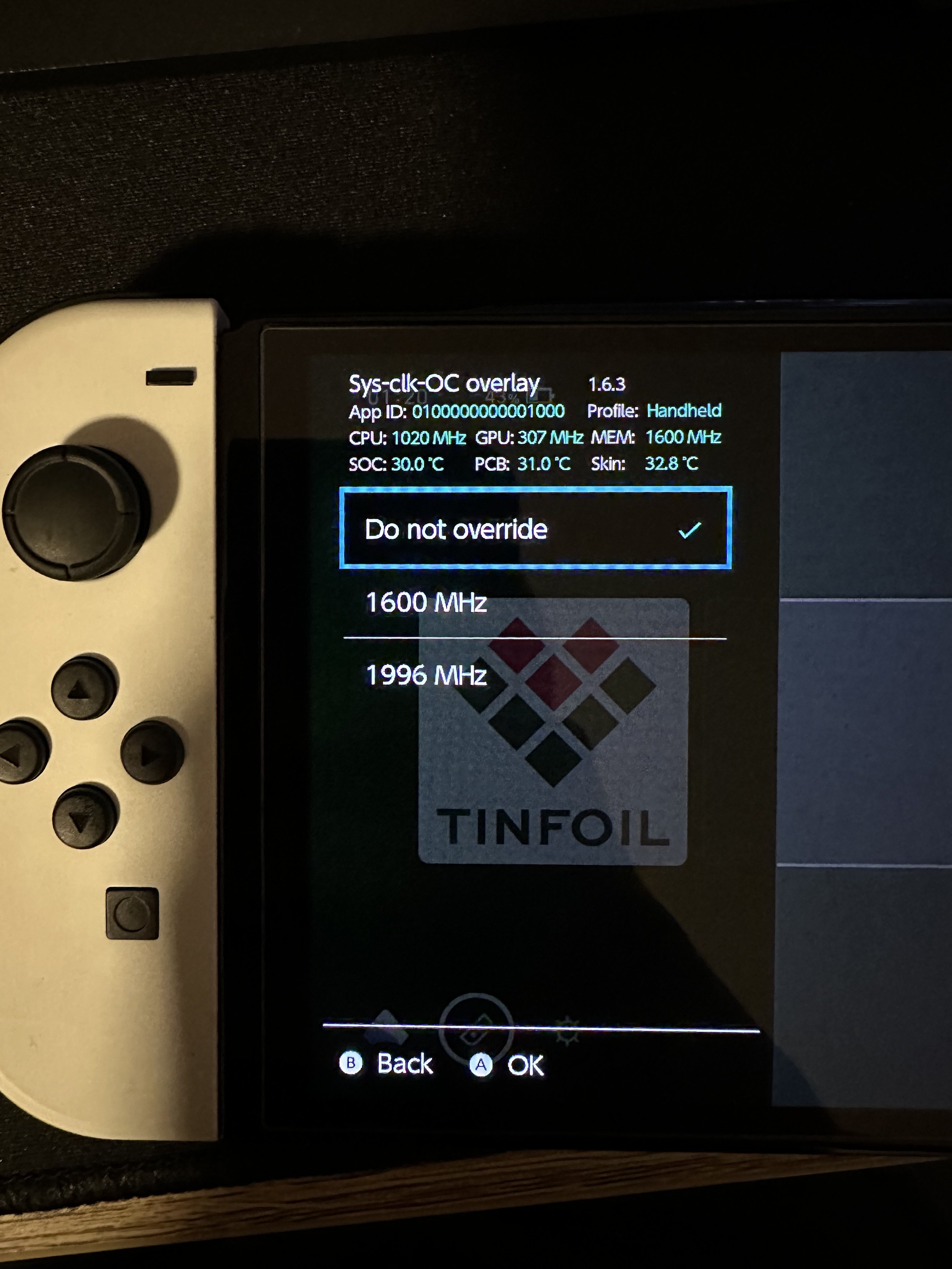

Why does my Ram OC menu only show 1600 and 1996? Couldn’t there be a option for 1600, 1862 and 1996? It would be better if I could choose without changing the loading.kip file
Due to OS limitations we can only select two RAM frequencies at runtime, what used to be 1333MHz is replaced by 1600 and the 1600 slot is the custom max frequency of your choice which you can change using the loader.kip configurator.
mariko has only 3 tables available unlike erista, which is 204(used for sleep), 1331, and 1600. it's not easy to add another table because it's HOS, not linux.
(table means dvfs table which contains more than 1000 values related to that ram frequency)
