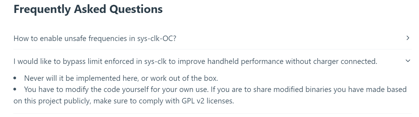

The project page was added less than week ago and it says 'never'. That issue post response is from December. I think they have made up their mind. It's a shame if you want to use it those but you would have to edit out the restriction and compile it yourself.
I don't have the knowledge to do it, I only wanted 768 possible at handheld, but I understand the reason to not implement it, so no problem, I always have an external battery when I take my switch out home.
I haven't tested it, but that's in FAQ.

https://kazushime.github.io/Switch-OC-Suite/
This is on the project homepage. They aren't going to add it.

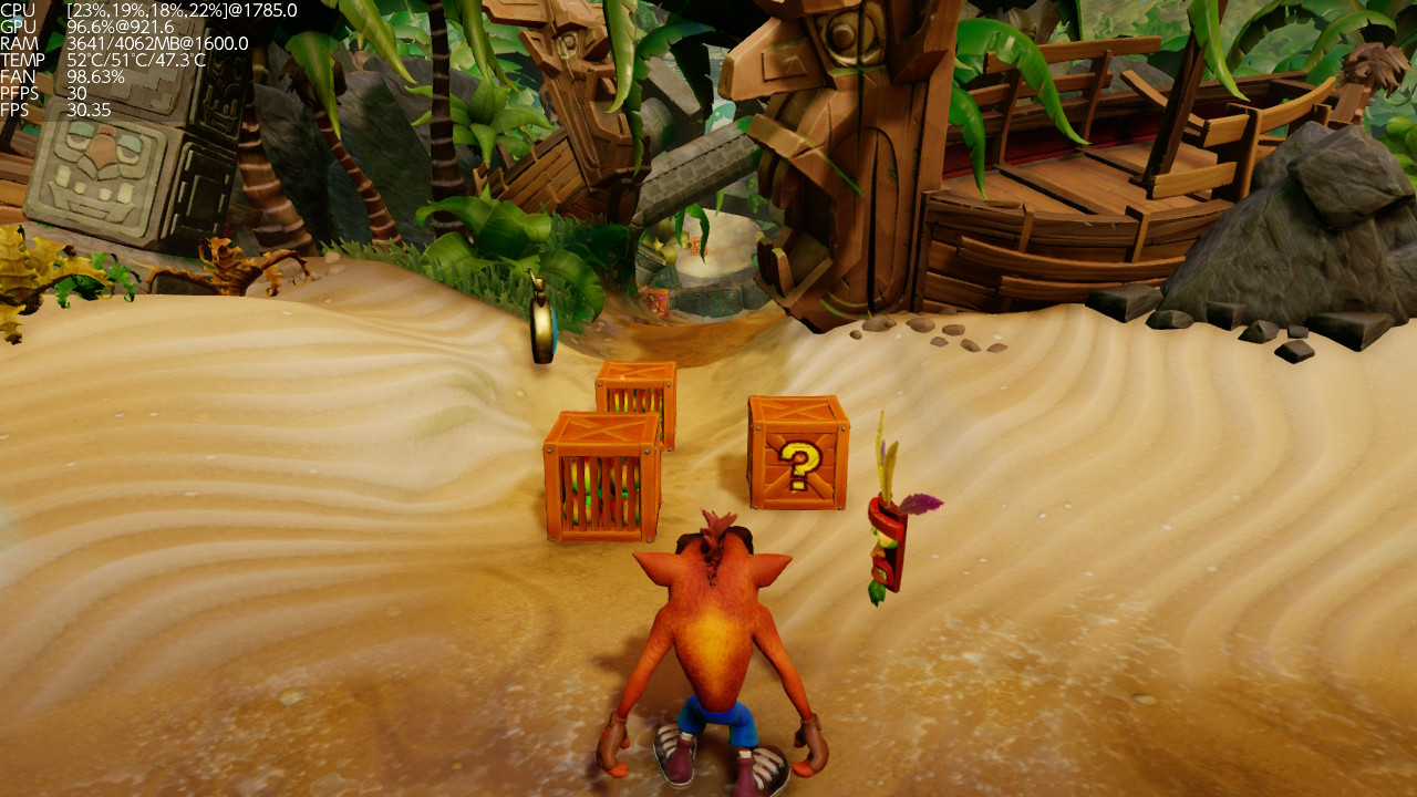

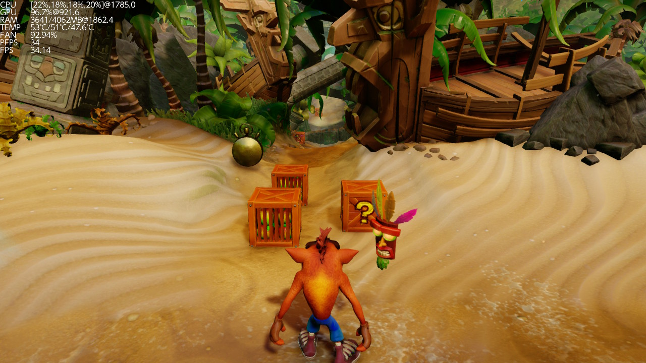

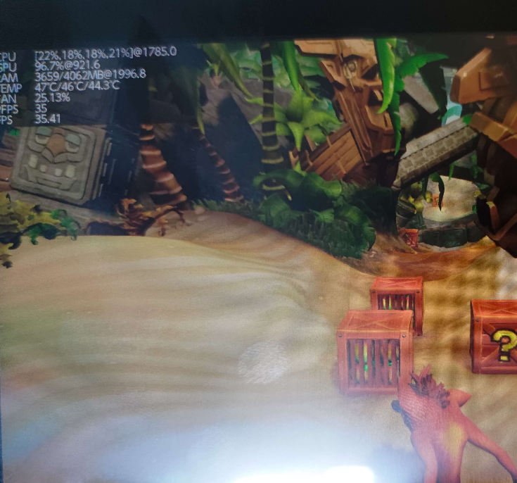

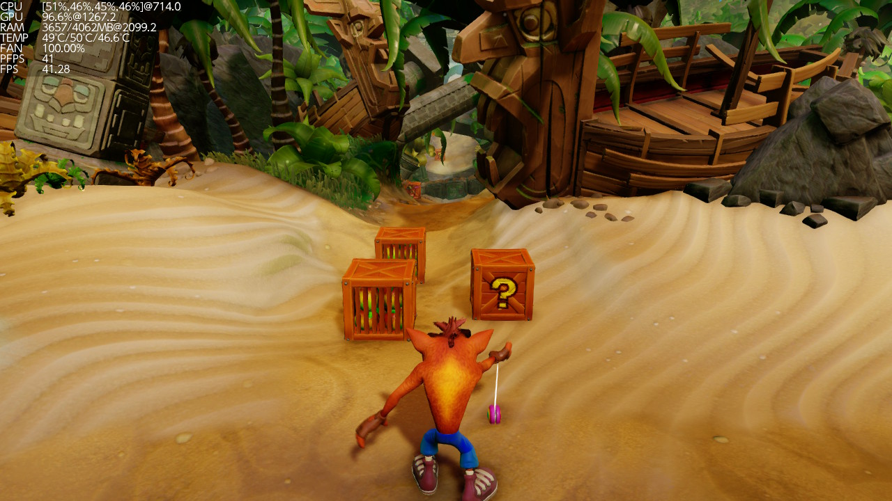

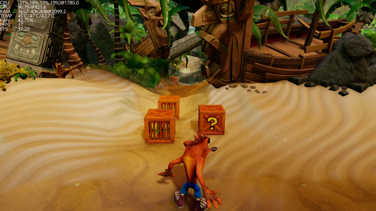

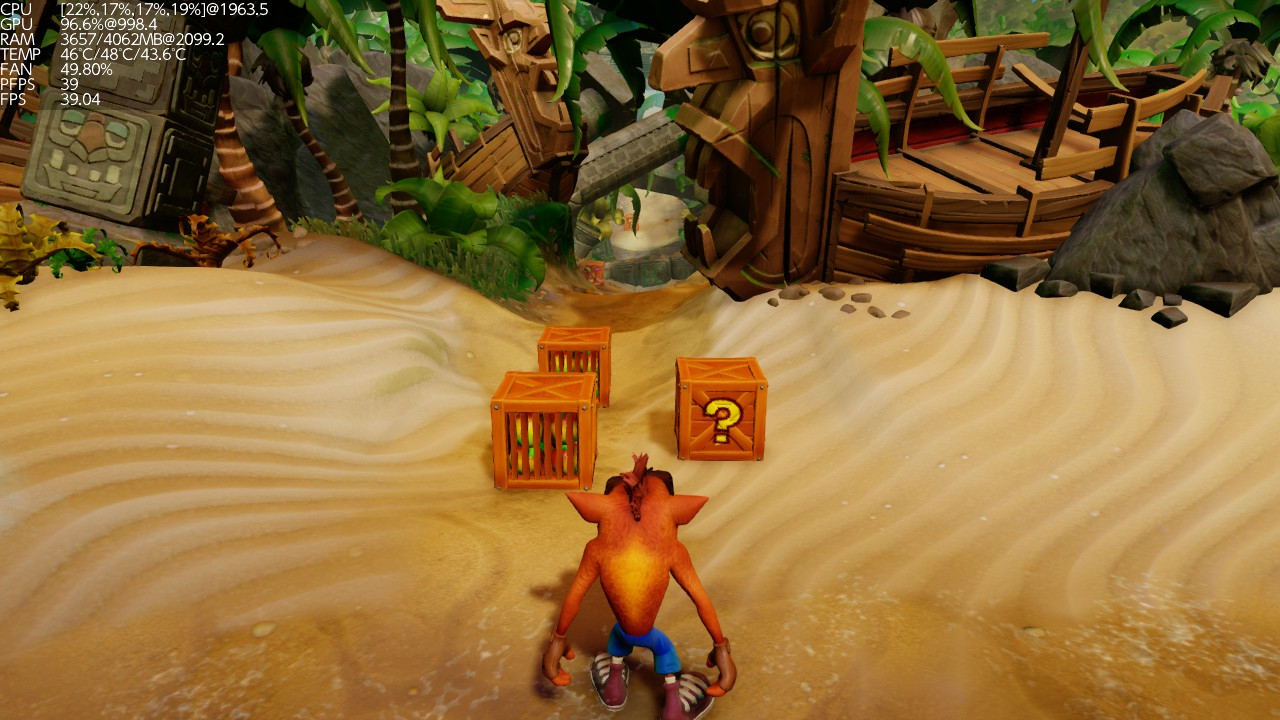

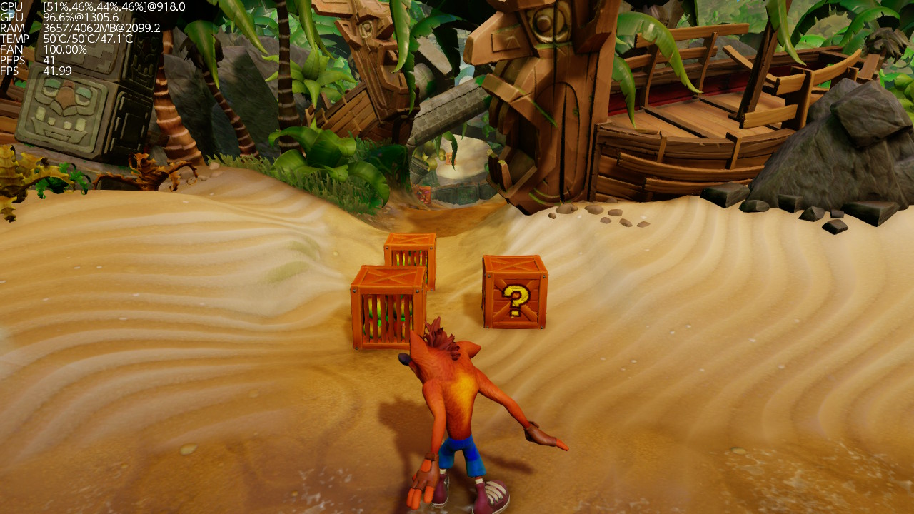

Here's a performance comparison that should be useful showing GPU clocks over 998 offer diminishing returns (plus they have unsafe power draw). GPU performance at high unsafe clocks does depend on GPU speedo (gacha) I'm going to add this to the main post later. RAM performance on Mariko is a gacha as well.
Mariko w/ auto adjusted RAM (1996) timings #1
Mariko w/ non-auto adjust RAM (2099) timings #2
Mariko w/ auto adjusted RAM (1996) timings #3
v1 Switch 1862 RAM and 1600 RAM
Are you using fixed resolution in the game?

The game being tested is Crash N'Sane Trilogy and it does not have dynamic resolution. It renders at 720p in docked and 480p for handheld. The screenshots are taken in docked.
screenshot_2023-02-03-19-32-28-806-edit_com-brave-browser-jpg.350890
The allow unsafe frequencies is not to unlock full OC support under battery, it's just to go beyond the very known safe power delivery OC for each Switch on Erista is to go above 1785mhz in the CPU for example...
Sadly they had that in the tesla overlay, but on latest updates they removed it, now it has to be manually added if you want it by doing the following:
going into: /config/sys-clk/config.ini and adding this to like the bottom:
[values]
allow_unsafe_freq=1
(in their FAQ they say to only add the allow_unsafe... but it doesn't work without the "[values]" specification).
ps: Hope they bring back the option to select "allow unsafe frequencies" in the Tesla overlay like before...
