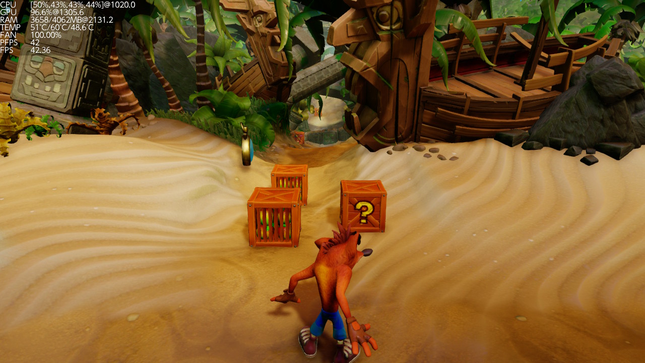

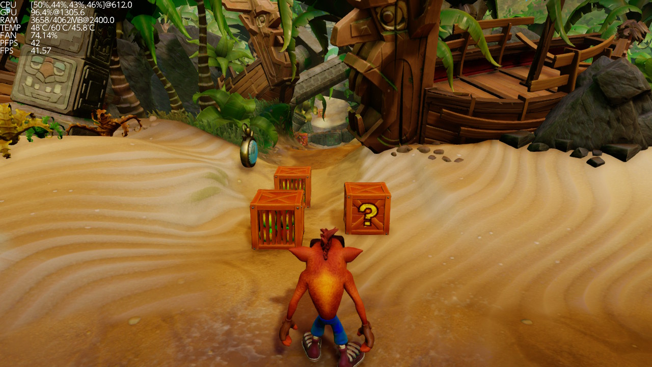

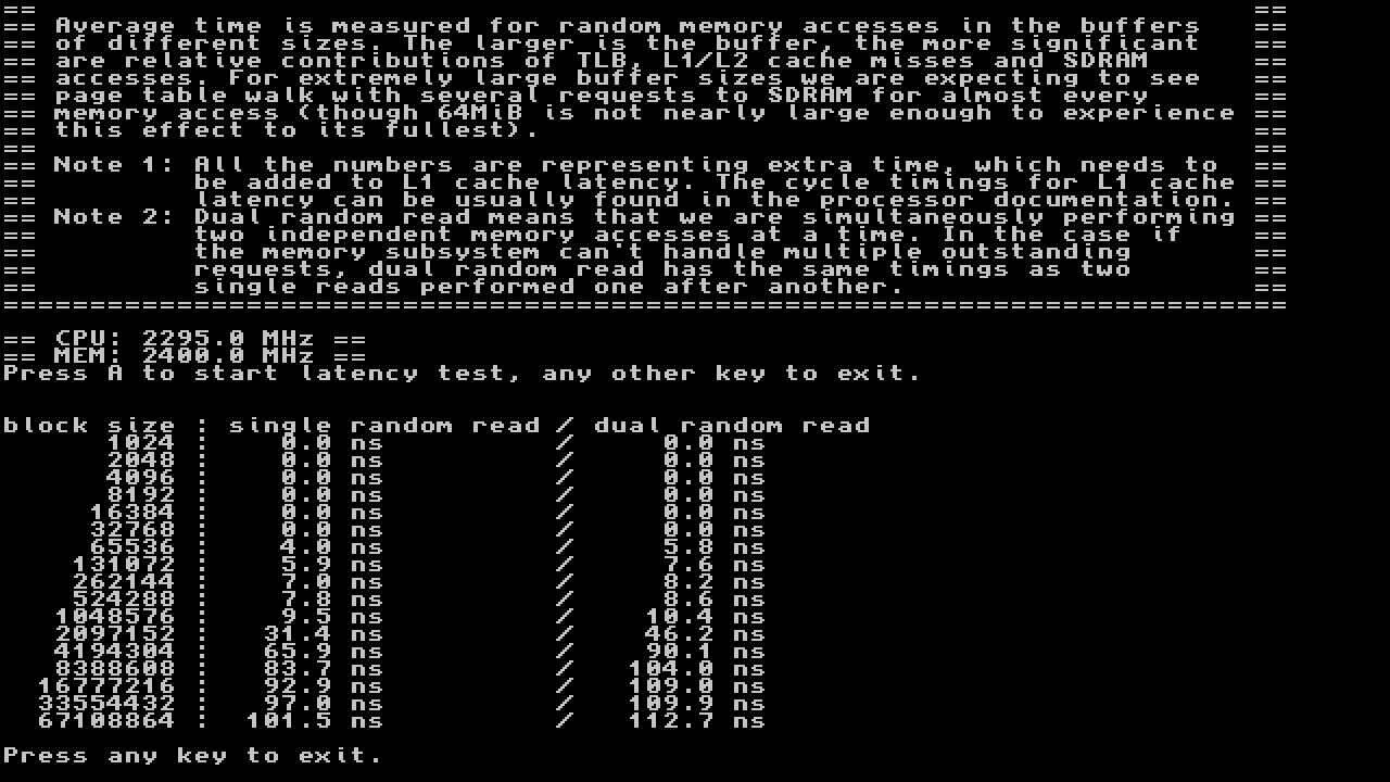

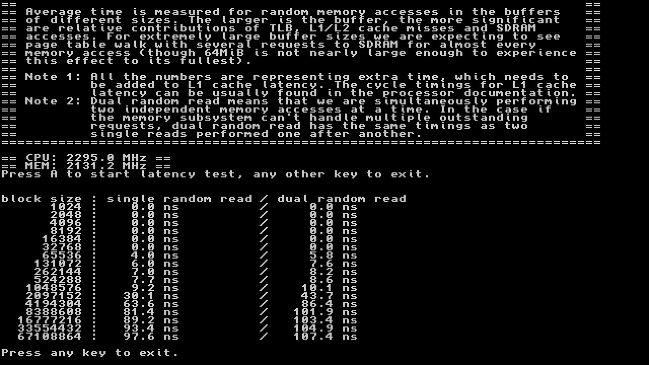

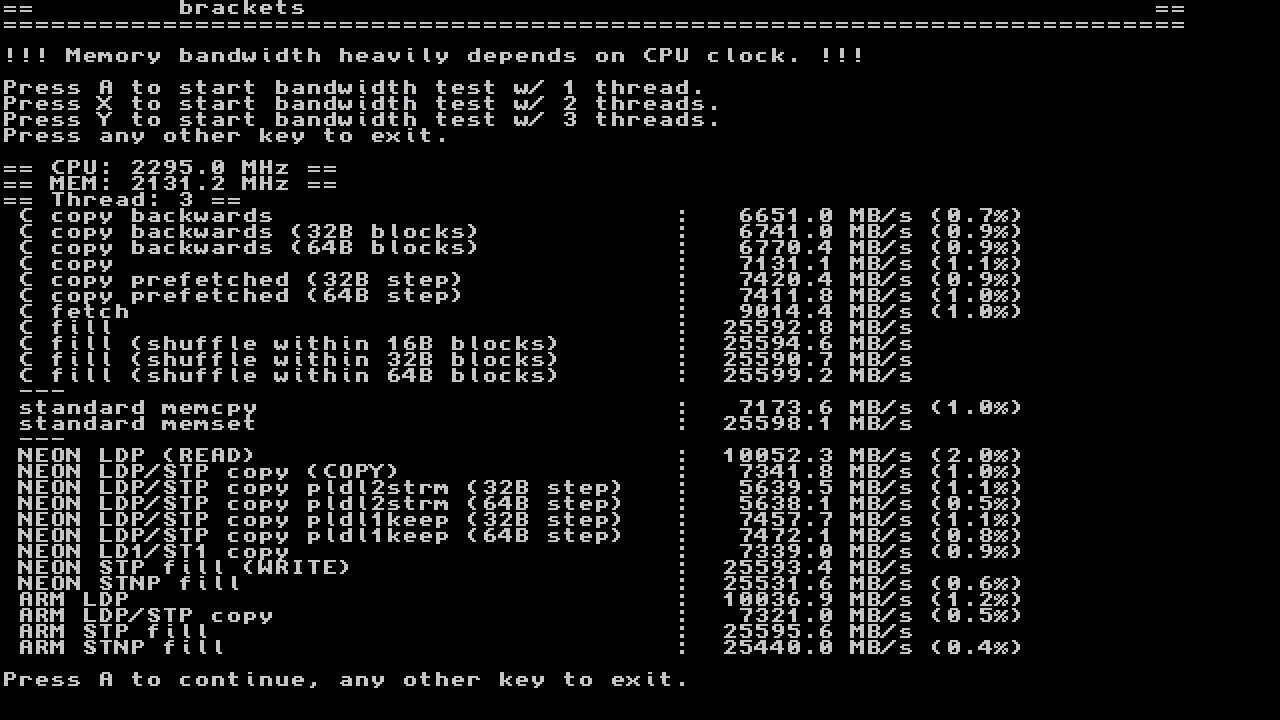

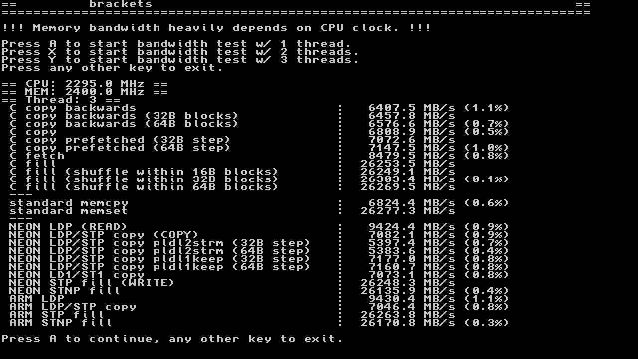

a few benchmarks:
Cooler3D 2400 MHz kip & modified hekate | EMC Vddq = 650mV | EMC Vdd2 = 1250mV
(I've lowered the EMC Vddq Voltage from 700mV to 650 mV)
KazushiMe kip with the following settings:
2131 MHz
NO_ADJ_ALL
EMC Vddq = 600mV | Vdd2 = 1125mV

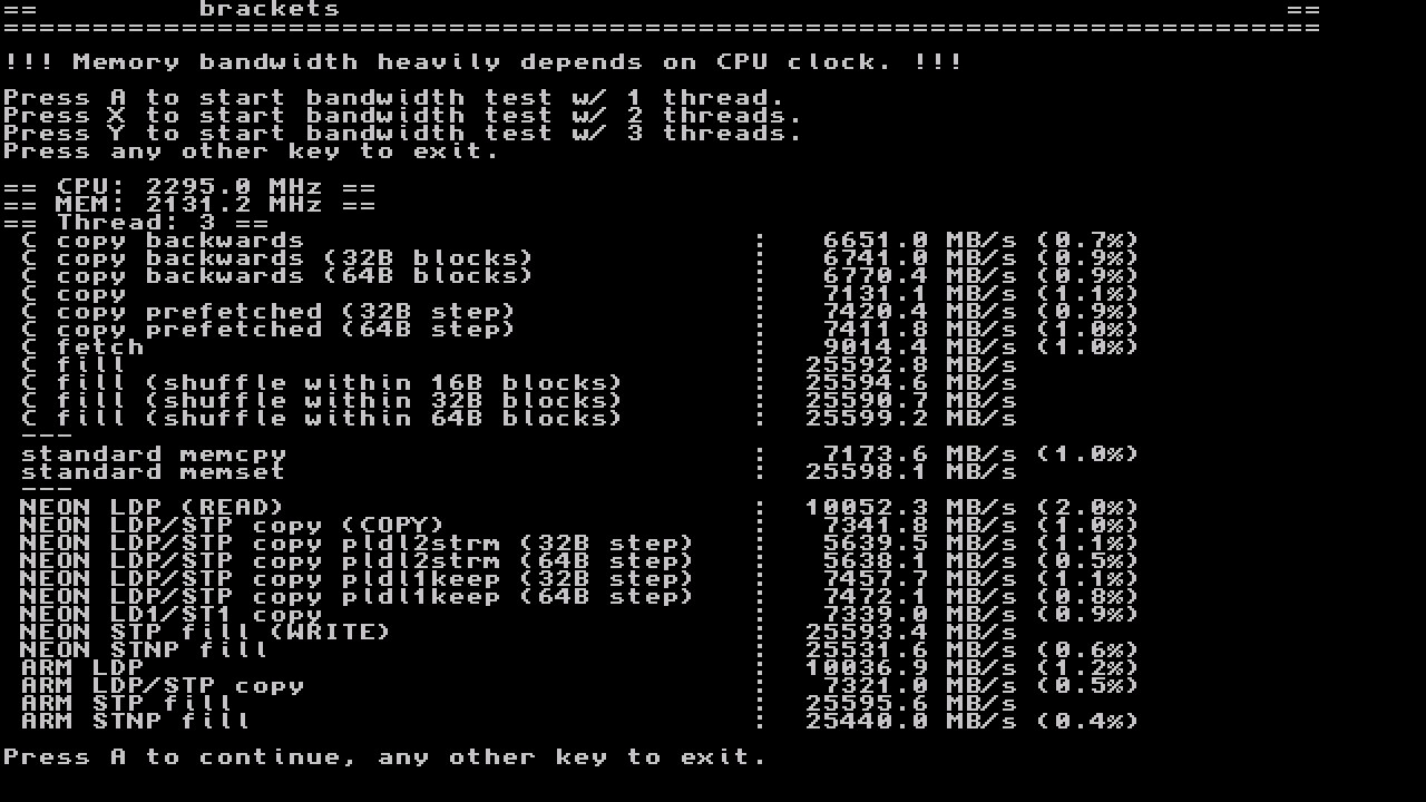

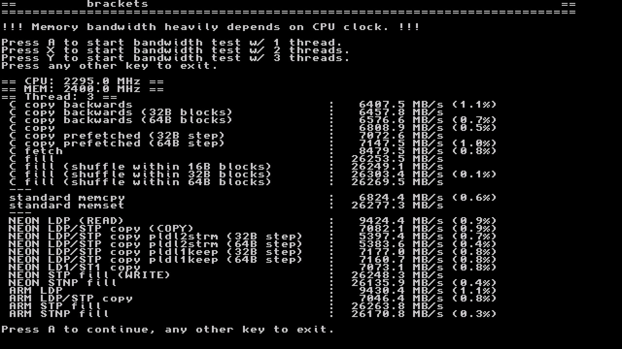

Yes I thought it would be interesting to compare the Switch-OC-Suite to 4IFIR.
I followed your telegram link and those files were the last ones you have uploaded there.
It's impressive to see 2400 MHz is bootable.
But performance is more or less the same as 2131 MHz,
and it is not stable with or without OV.
So with a Samsung 4266 Mbps Ram i don't see any advantages.
Maybe it is a different story with a 3733 Mbps Ram or your final Version.

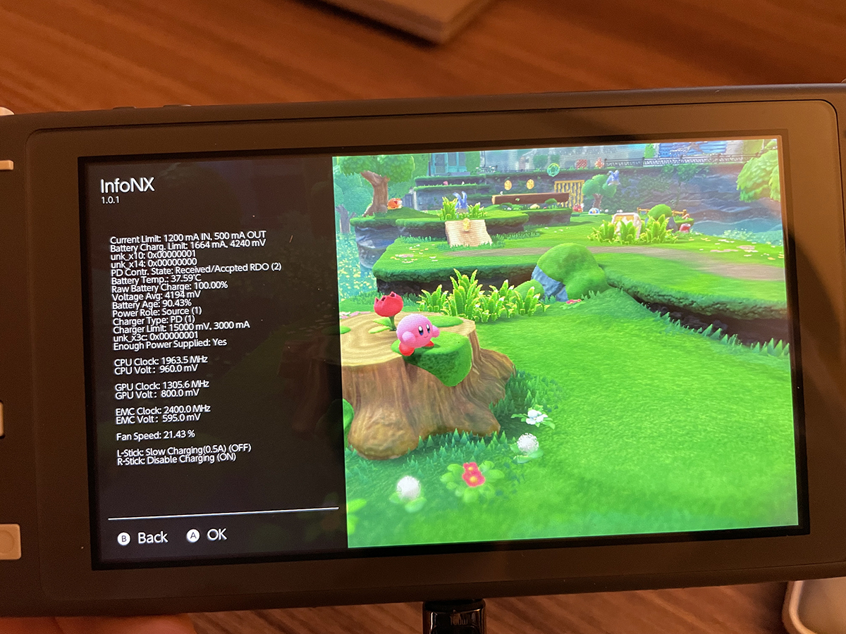

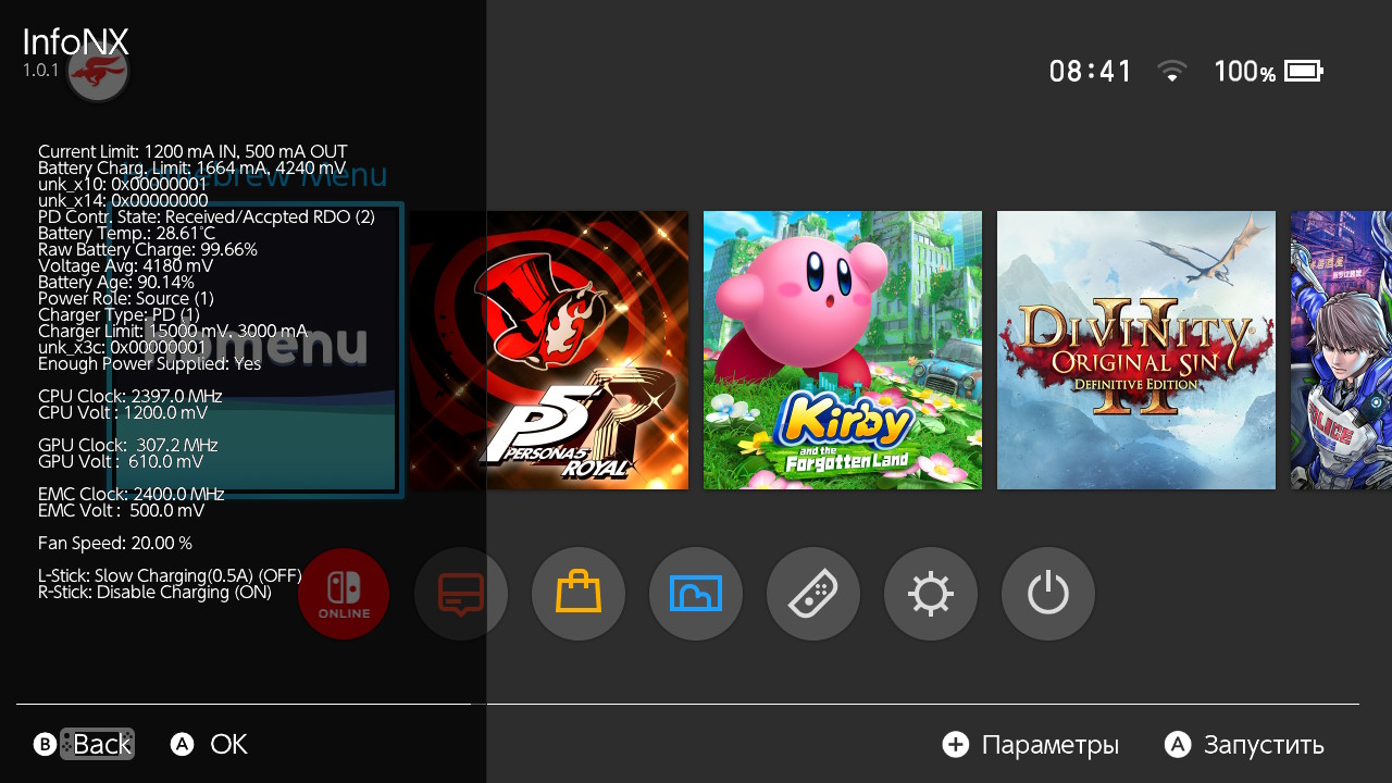

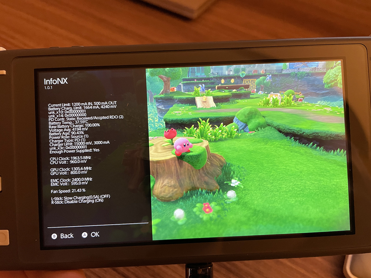

At that low voltages in such clocks my Switch would have a good performance penalty at least with OC suite, don't know with your 4IFIR mod...
Also I don't think it would handle such memory frequency with such low voltage either, but I never tried.
ps: Couldn't InfoNX be lying on the voltages there???

a few benchmarks:
View attachment 352362View attachment 352363View attachment 352364

try test 921 or 998, you would see different performance. but it wont stable for switches, to risky for small gain
a few benchmarks:
Thank you for showing how just because the RAM frequency is higher it doesn't necessarily translate into better performance especially with the extra voltage you have to put towards it. I'll add these to the main post as well.
I knew you guys would get to the bottom of 700 millivolts, so I put it there on purpose. I imagined your faces when you suddenly realized under what voltage my proof of concept of 240 was actually designed. Check it out:
There are no tricks here, they are stable, and work at a voltage that is not enough for the stock 1600 MHz.
As soon as I combine this with other optimizations, the effective performance will increase noticeably.
Obviously, if the solution were as simple as setting the voltages in three places, you would not be standing in front of an insurmountable barrier at 2131 MHz, any attempt to overcome which fails, regardless of the voltage used (if I did not miss anything). If you get tired of guessing on coffee grounds, you can ask me directly about how I did it. I'm in a good mood, and if you ask politely, it will probably succeed.

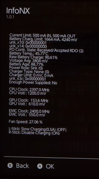

You're only on the home screen menu because if you try doing anything like booting a game it will crash and is super unstable. It's not surprising that you got worse results on the benchmark because you took and used Kazu's code he got rid of. I wonder why he got rid of that code? Probably because it wasn't very good.
Do you really think that I came here with such an obvious deceit, to risk my reputation? If this is a deception, then it is enough to ask me for a proof, and the illusion will dissipate. Ask.
In the meantime, I propose to agree that the indicators in the screenshot are so impressive that in your opinion they cannot be true, and there is probably a catch hidden somewhere. Did you mean it?
Ask for proof...
Ask for proof...
Post it. And even then if it works it only works on a few units that have miracle RAM at that voltage. And I seriously doubt how stable that might be. It could boot into a game and then later crash but you wouldn't show that. I could undervolt shit slightly on my Switch as well but it would only work for my unit because every unit is different. It doesn't mean much. Still doesn't change the fact that your 2400Mhz was getting lower performance then 2133Mhz.
Post it. And even then if it works it only works on a few units that have miracle RAM at that voltage. And I seriously doubt how stable that might be. I could undervolt shit on my Switch as well but it would only work for my unit because every unit is different. It doesn't mean much.

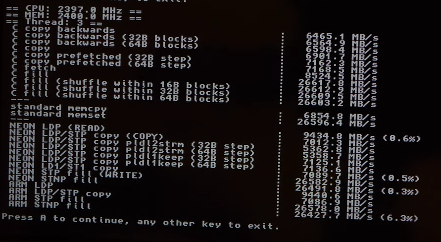

I have the most ordinary, average device, the same master sample on which I test 4IFIR. 3733 Mbps (Rated) SAMSUNG K4U6E3S4AM-MGCJ nothing special.
My method is stable on any memory chips, including Hoonix. If what I show raises doubts, it is enough to ask me to provide a patch, and make sure it works for yourself.
And since you already asked for proofs, give me a minute, I'll shoot it now.

Done. Sorry for keeping you waiting. I hope this is what you expected:
VHQ Video | VHQ Mirror (watch or doianload) | YouTube Video
I made this video, taking into account all your wishes. It was recorded in one 27-minute take without gluing, on it you can see at least every pixel of each frame. I was not too lazy to use a tripod and a camera.
Obviously, it is not mounted, there are no tricks in it, it is extremely unsophisticated. This video is a testament to the fact that I somehow managed to do what no one else could before (at least on Switch). You, CTC, PSam, even KazushiMe, whoever. None of you not only did not understand how to achieve a similar result, it seems impossible to you, and I know why:

For one you blatantly lied - that is not 500mv that is 550mv while the image a couple posts above that you previewed is 500mv.

Secondly your results on tinymem bench are worse then swutch's at 2133 meaning that your 2400 performs worse then Kazu's. The numbers don't lie, why would someone use yours when Kazu's runs at a lower frequency which means it's more stable and gets better performance. Who cares that 2400 is higher then 2133 when it runs worse.
From your YouTube video
Swutch's 2133
Thirdly, I don't care about you playing some random games and checking the memory for less than half an hour. It can take gameplay for hours on end for corruption to start happening.
Fourthly, there's no reason to undervolt RAM past the default. RAM barely draws any power and undervolting it increases instability.
Why the hell would some use something that is closed source, unstable, and performs worse then something publicly available. There's a reason why Kazushime never had to advertise his project - its quality speaks for itself. I made this thread because I wanted to spread good information around.
It is absolutely disgusting how you shit on the people who originally made sys-clk - the people who know what they are doing ZachyCatGames, CTCaer, m4x. It's appalling how you tried to pawn sys-dvr as your own with no credit to the original author. It's gross how you barely ever acknowledge your sys-clk is a poorly edited Switch-OC Suite by KazushiMe. It's beyond indefensible how you do not advice users to make an immediate backup of their EmuNAND and SD card when the chance of corruption is very real and likely.
And ultimately all for what? A script-kiddie mod of Switch-OC that runs worse. The numbers don't lie.
Next time you post on my thread about your precious cobbled together 4IFIR, don't expect that post to stay up for very long at all. Why don't you go back to your 4IFIR thread - I wonder why the mods haven't opened it yet?
