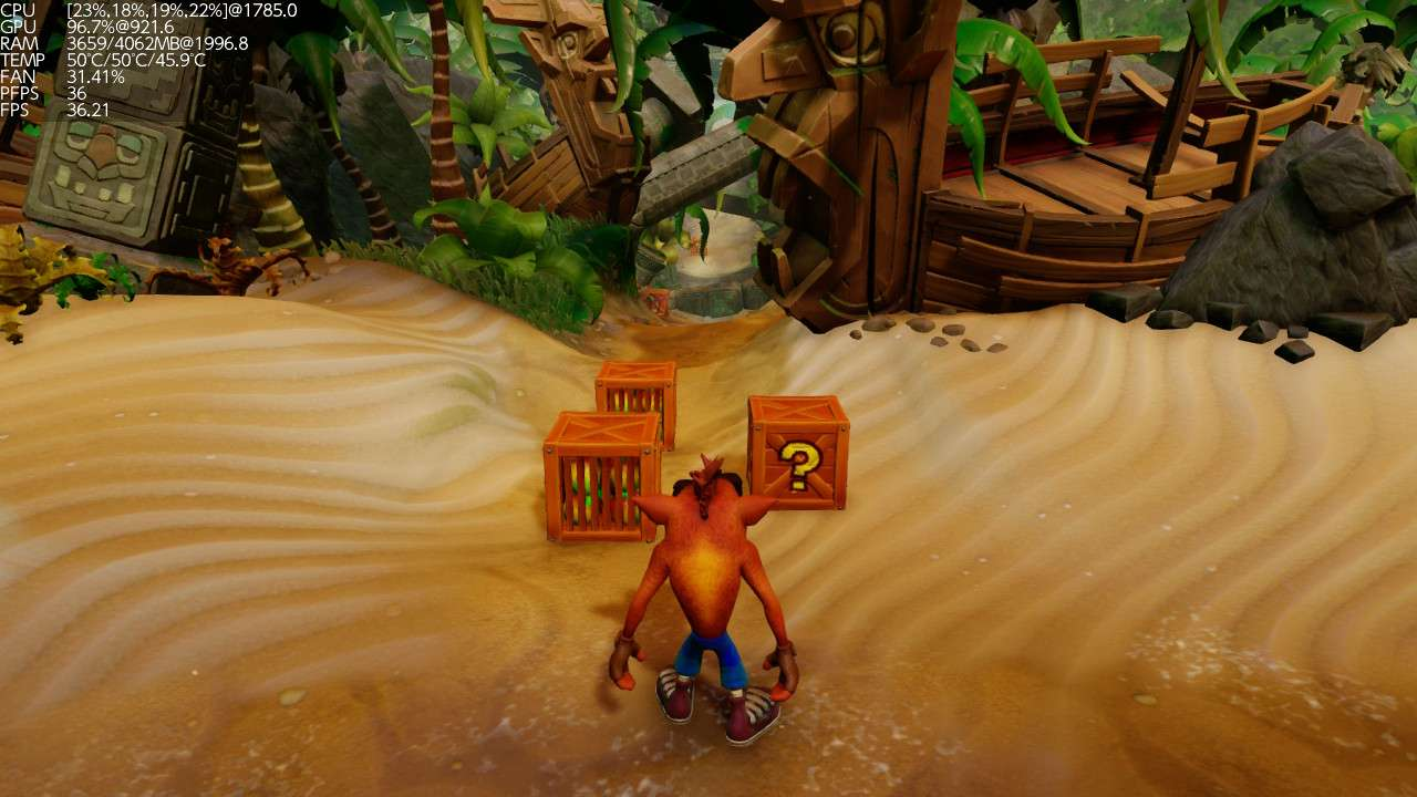

These were 'fake' clocks, I believe voltages weren't set right. Not all Mariko Switches could handle those clocks because they have varying CPU and GPU speedos. It's basically a gacha. Those high didn't exactly boost performance all that much and had crazy high power draw.
Here's a performance comparison that should be useful showing GPU clocks over 998 offer diminishing returns (plus they have unsafe power draw). GPU performance at high unsafe clocks does depend on GPU speedo (gacha) I'm going to add this to the main post later. RAM performance on Mariko is a gacha as well.
Mariko w/ auto adjusted RAM (1996) timings #1
Mariko w/ non-auto adjust RAM (2099) timings #2
Mariko w/ auto adjusted RAM (1996) timings #3
v1 Switch 1862 RAM and 1600 RAM

KazushiMe got rid of those later frequencies because they aren't real and don't work right. They are 'fake' and can give lower performance. You'd set your Switch to one of those clocks using status monitor but it wouldn't actually be set at that clock and would be set lower and you'd get worse performance. You could literally set the clock to 10000mhz it would show that in Status Monitor but it wouldn't actually be running at that and would drop lower and have errors (worse performance).
If you still have those higher clocks and want to do test do a performance comparison in Crash Trilogy on the first level of Crash 1 and compare your FPS to the FPS in the images I sent on each GPU clock increase. That should show the problems with those clocks.
