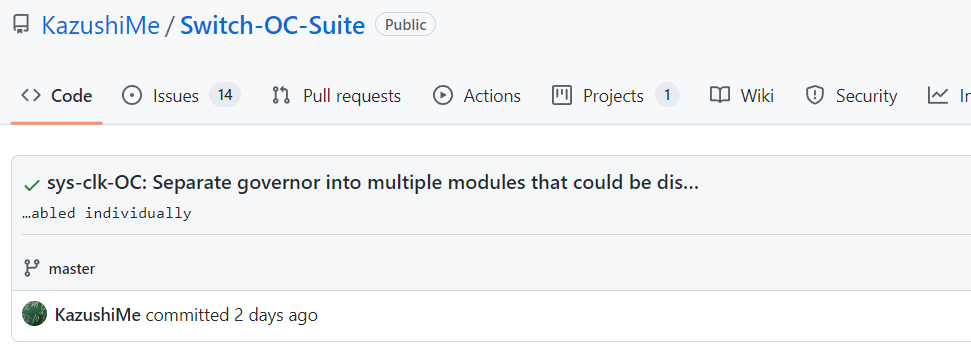

Governor is getting separated so you can turn on CPU governor only or GPU governor only or both on the next release most likely. Turning on GPU governor might help with some of the input lag and stuttering issues found on some games I've tested.

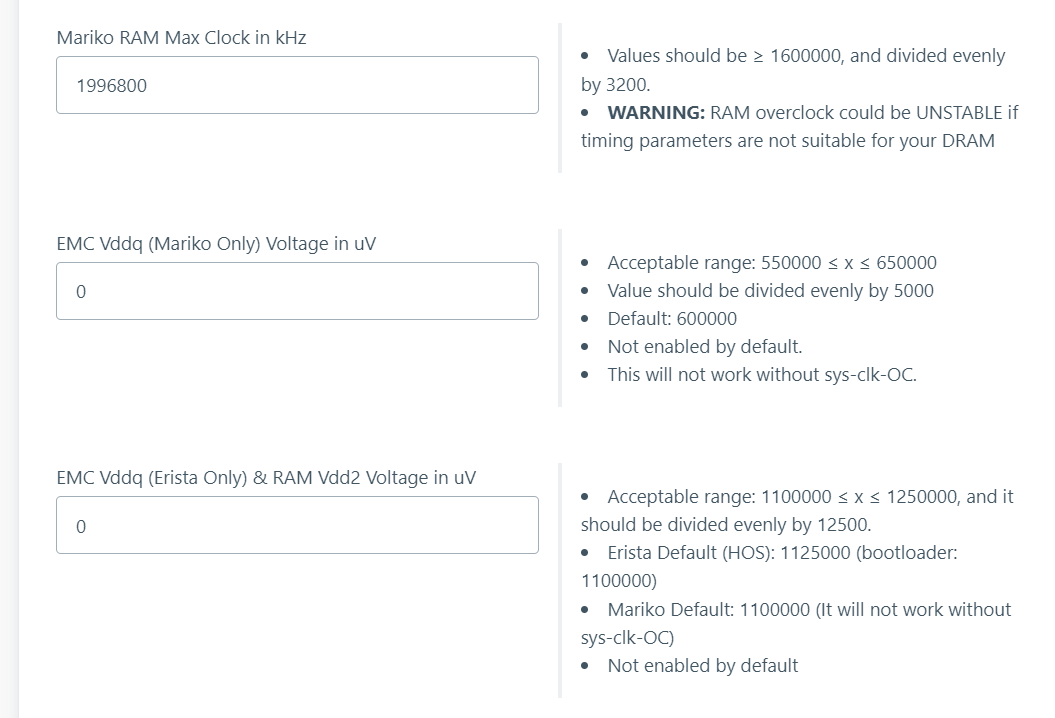

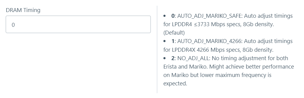

Anyone who using a non-stock .kip created with the loader customizer I want to know what parameters your using so that RAM OC is stable for your unit so we can compile information on what generally works so I can add it to the main post. Make sure you say if you are v1 or Mariko and if you know what kind of RAM you have in your unit.

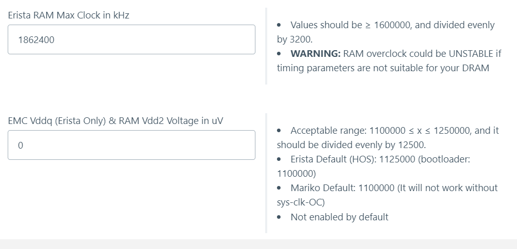

@ChanseyIsTheBest I have Erista with samsung RAM, I'm using 1100 voltage for CPU and 1100000 voltage for RAM, and 1958400 frecuency for RAM, I'm going up for frecuency little by little to find upper stable with this voltage
Pd. If I remember well, I have more than 36fps with crash bandicoot, will try when find upper frecuency

oh lawd he cooking
oh lawd he cooking

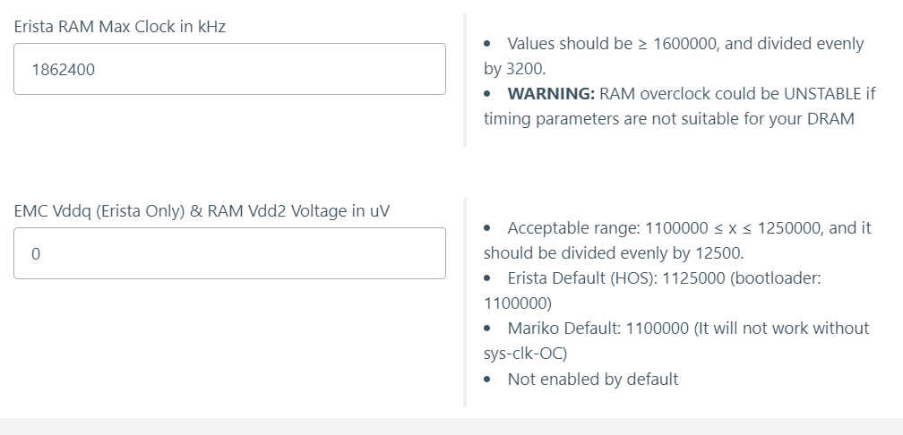

That's the way the values is show at the online configurator, curious you surprised by it and not by RAM frecuency, lol, if you looked at how it is configured before talk, you won't be suprised
That's the default voltage without overvolting. I think its 1.1mv its not like 1100000v but if they are in a hot environment at 921 GPU yeah they are cooking
Default is 1125000
Reactions: guily6669
Default is 1125000
It said there was two defaults to I thought it was that one thanks for the correction Also I put your config in the main post
Reactions: Medel87
For Mariko and at Erista bootloader is 1100000, so I understand the confusion, hehe, my config is -25mV of undervolt for CPU and RAM, is not too much, but all are welcome
You mean will be better GPU only governor, right?

GPU only governor will be better for some games yes, and vice versa.
