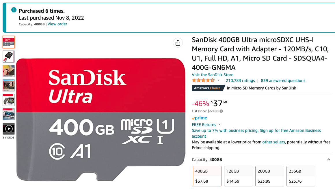

I'm contributing to the put-a-SanDisk-engineer's-kid-through-college fund.
The issue I had was resolved by switching cards. I later formatted the card and put it back in rotation. Have not had any issues w/ the card since.
PS SanDisk 400 is on sale for $37.68!
so all ftpd "compatible" cards for now are a bit slower (A1) and not bigger than 400gb. Where are the 512gb-1tb boys? :P
I could try some SanDisk, amazon will hate me thoo but i will rather go for something min 512gb
