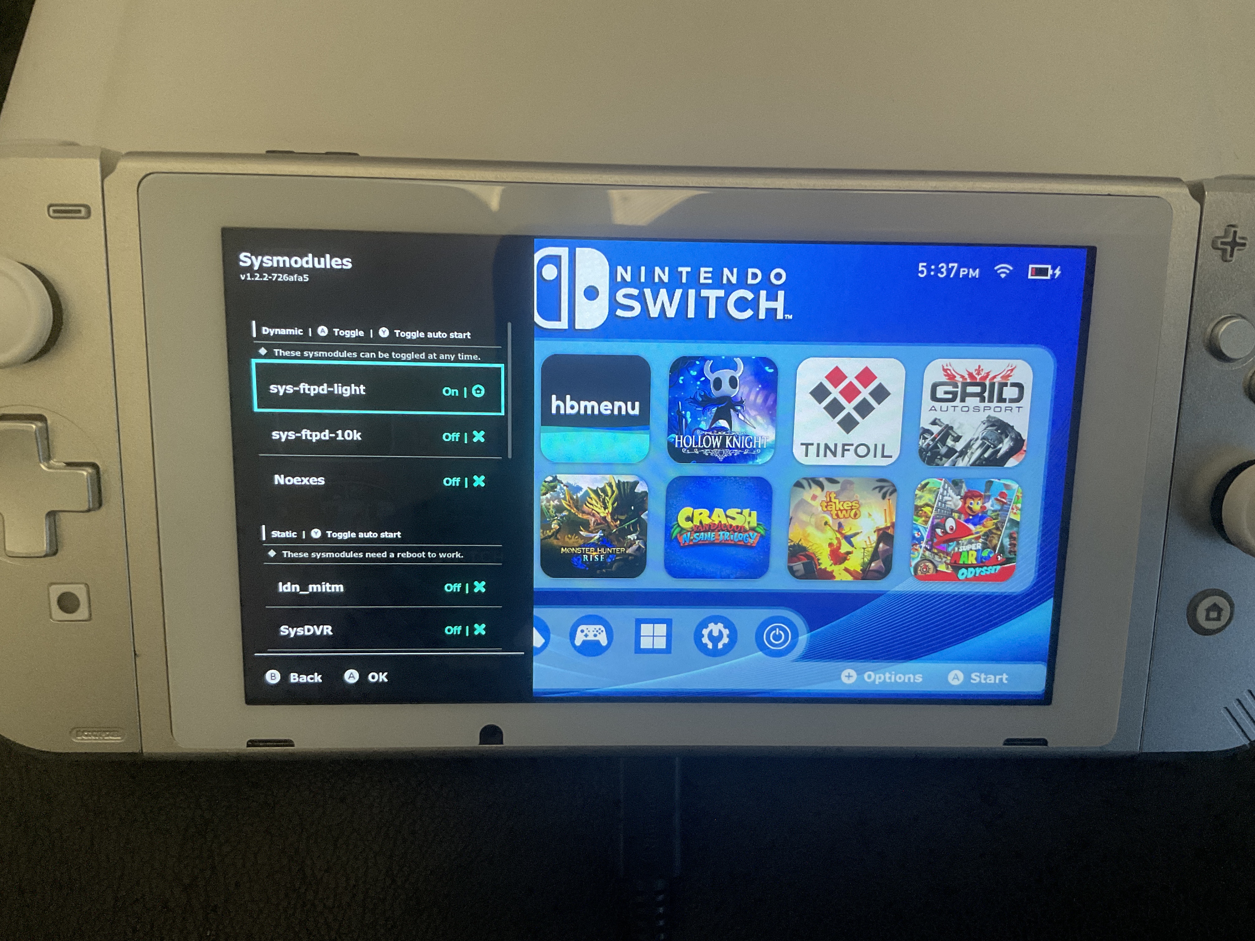

sys-ftpd-light sys-module running.

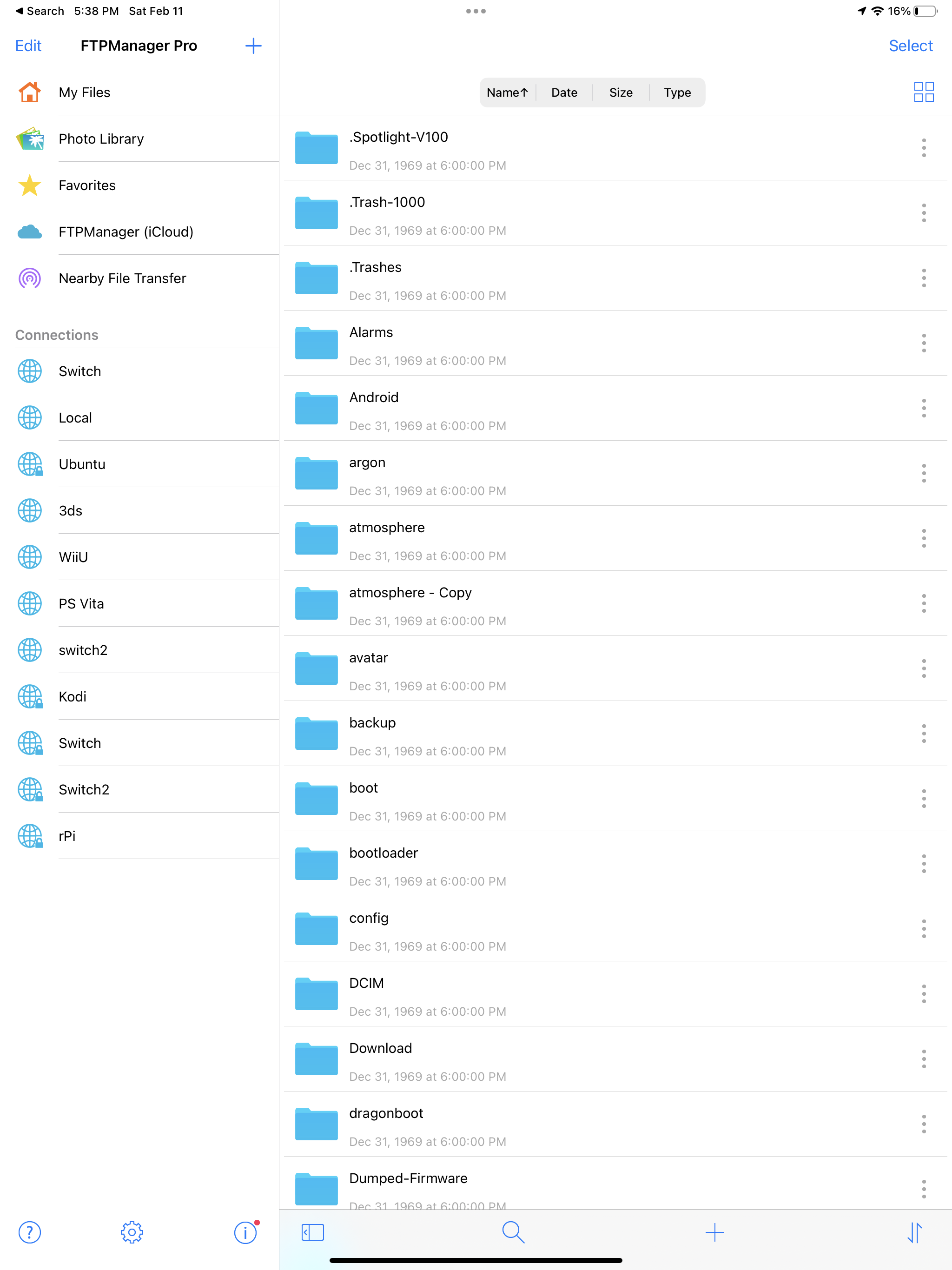

connected to switch from iPad.
You called it. It just works.

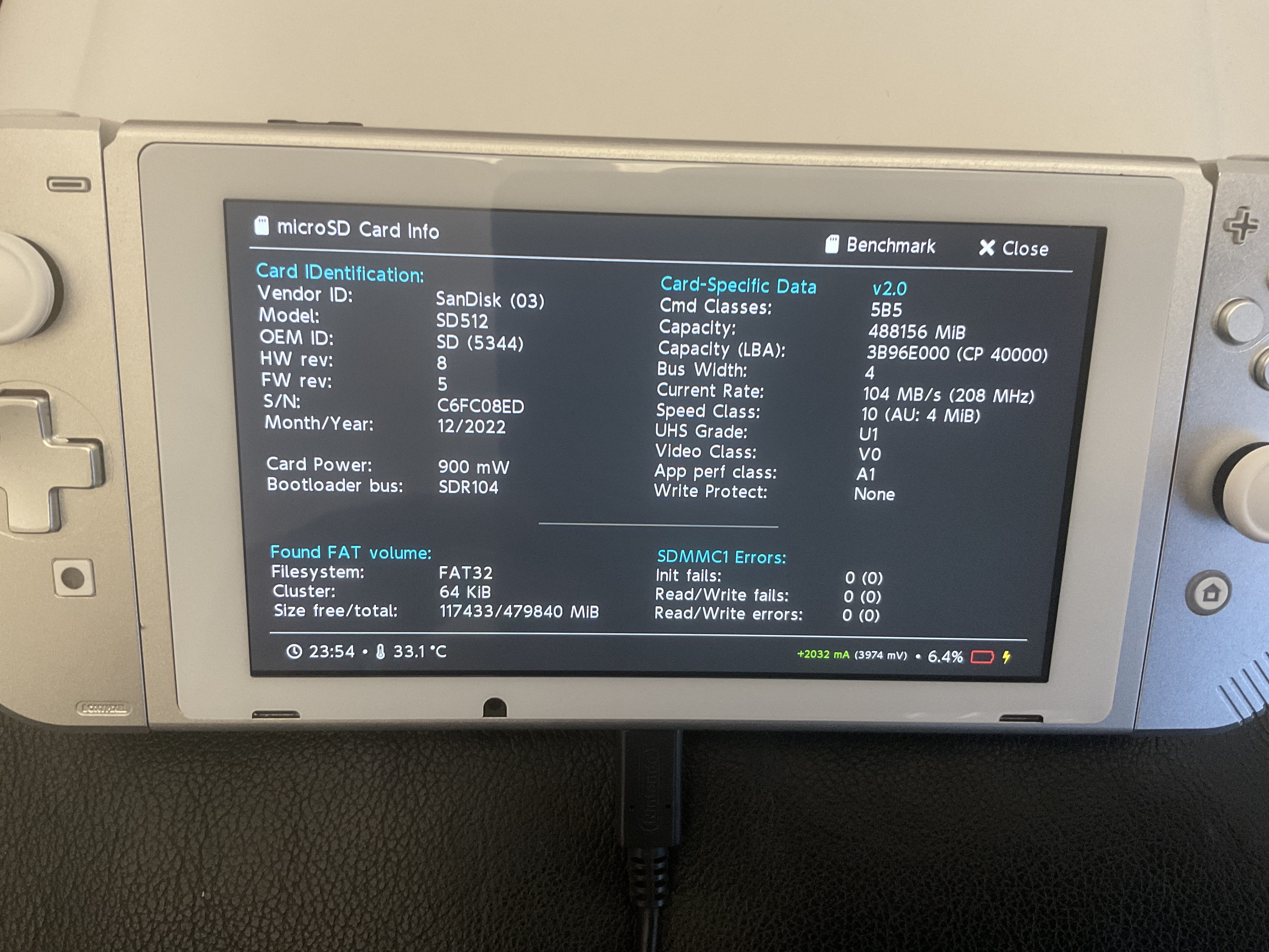

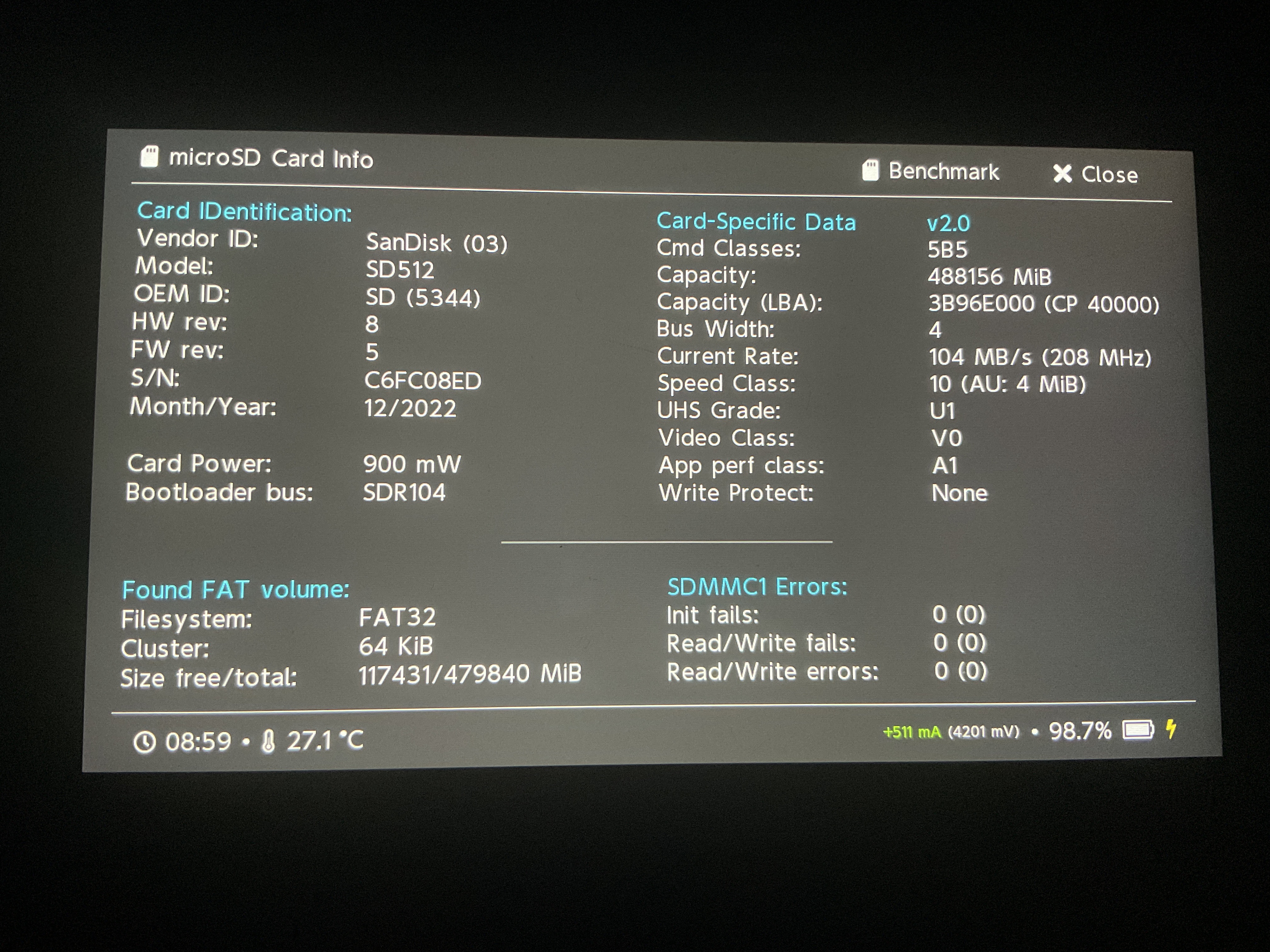

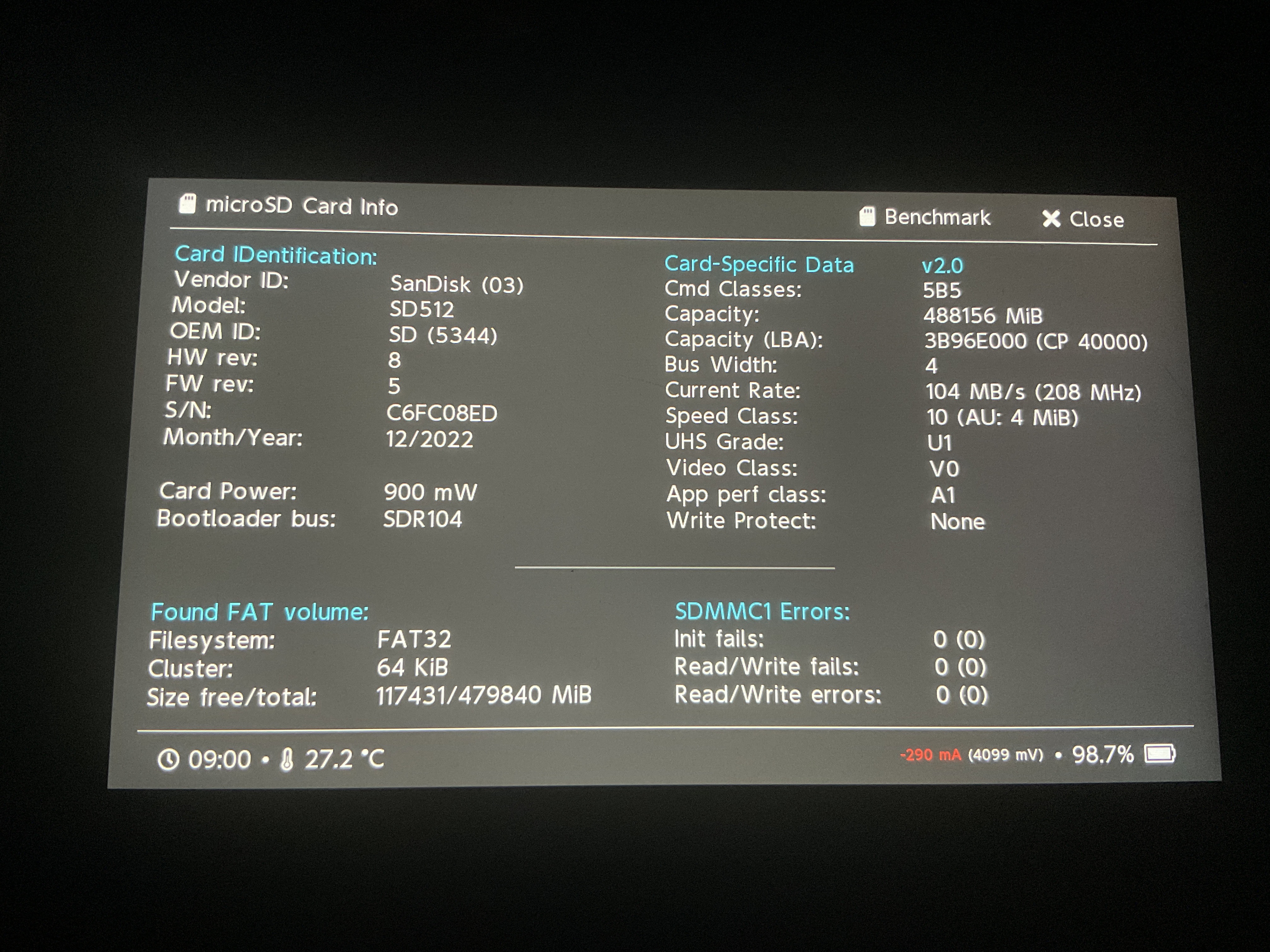

Mine is at 900mW no matter what I do. Plugged, unplugged, ran a benchmark. Anything to move the needles. Nothin.
Here it is off the charger:
and yes, this is my V1.

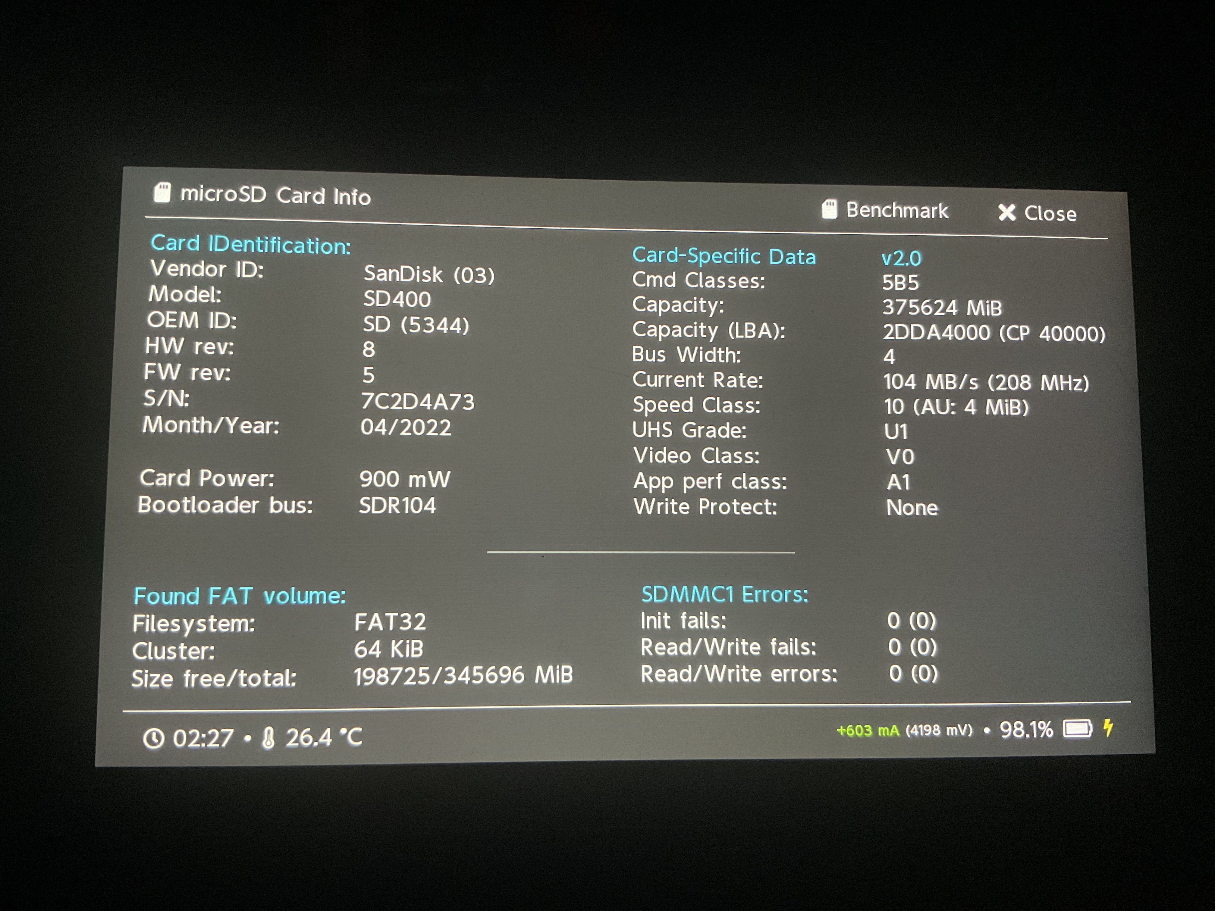

here’s my V2 on charger w/ the 400G:

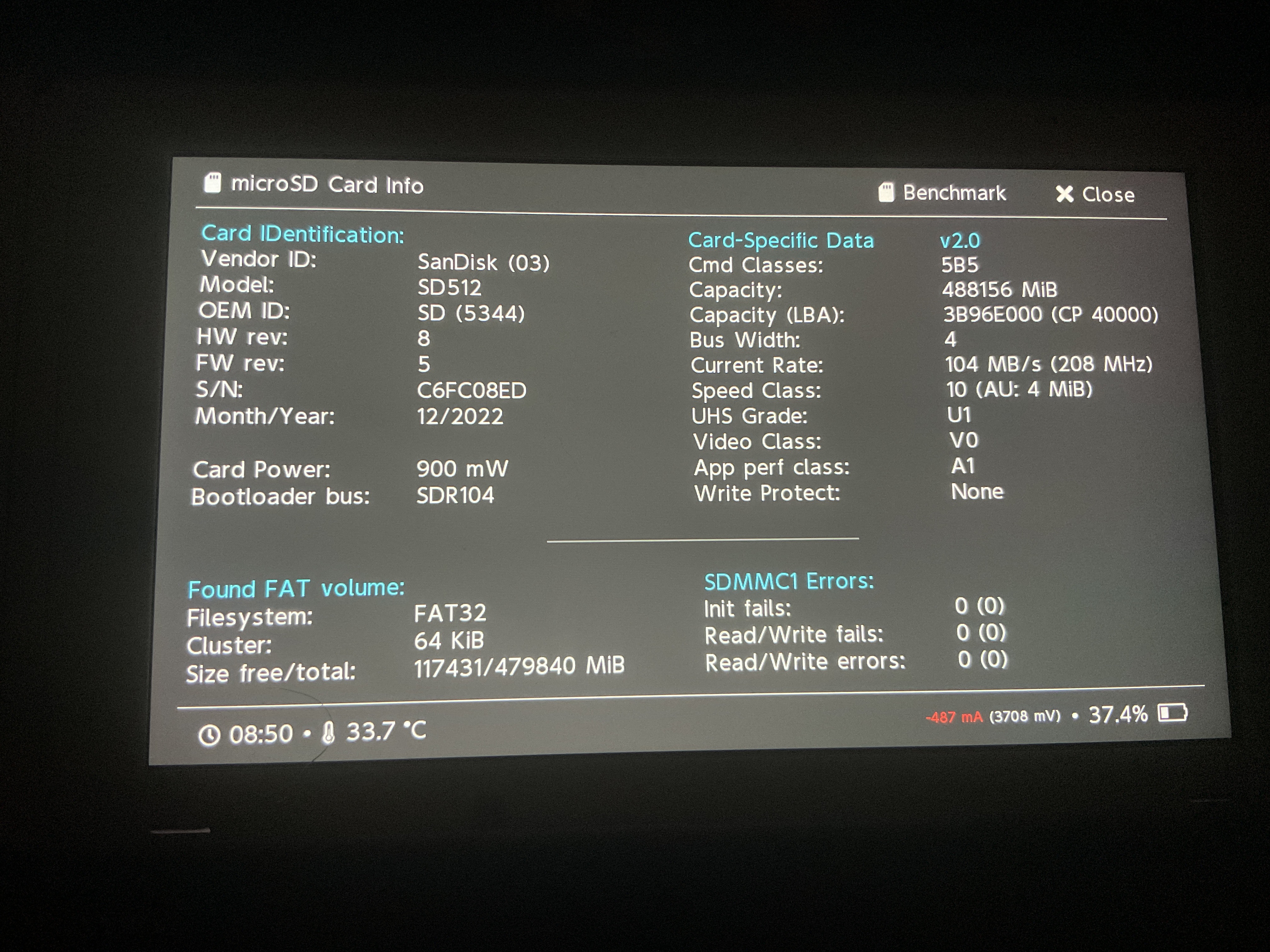

V2 with 512G on charger:
V2 with 512G charger unplugged:

I’m not 100% certain what that number means. I thought it was how much it was drawing but I can see where you’re coming from too.
I can try my V2 on the same card (just booting Hekate should work.)
if it is sd card power draw so maybe here is my issue just check your main card on v2 there is no need to swap :D and check it again in v1 when its charged maybe it is some kind of power saving: o?

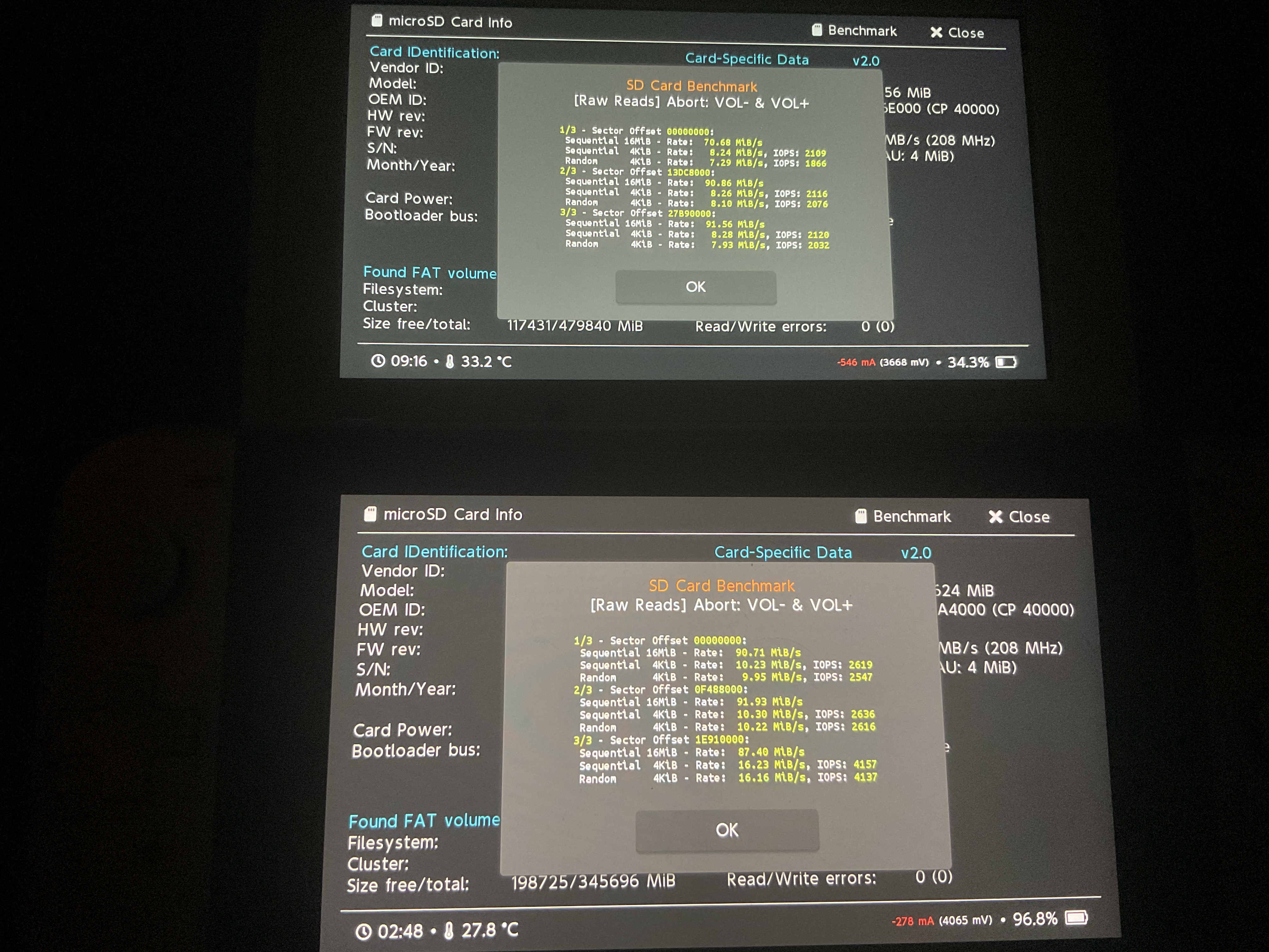

LOL. I just happened to be doing a V1 vs V2 race just for the hell of it.
Here you go.
V1 on top with 512G
V2 on bottom with 400G

so speeds are good but that mW :X my sd card is not out of spec all of my cards draw that 2880mW :P
Same value on my Samsung Evo select A2 512GB, now I wonder how verdict is that info from Hekate... Most likely it's some value it fetches from the mSD data?
I mean memory always gets higher power on heavy reading\writing and less idle and that value seems to just be there glued with tape :toot: :D
