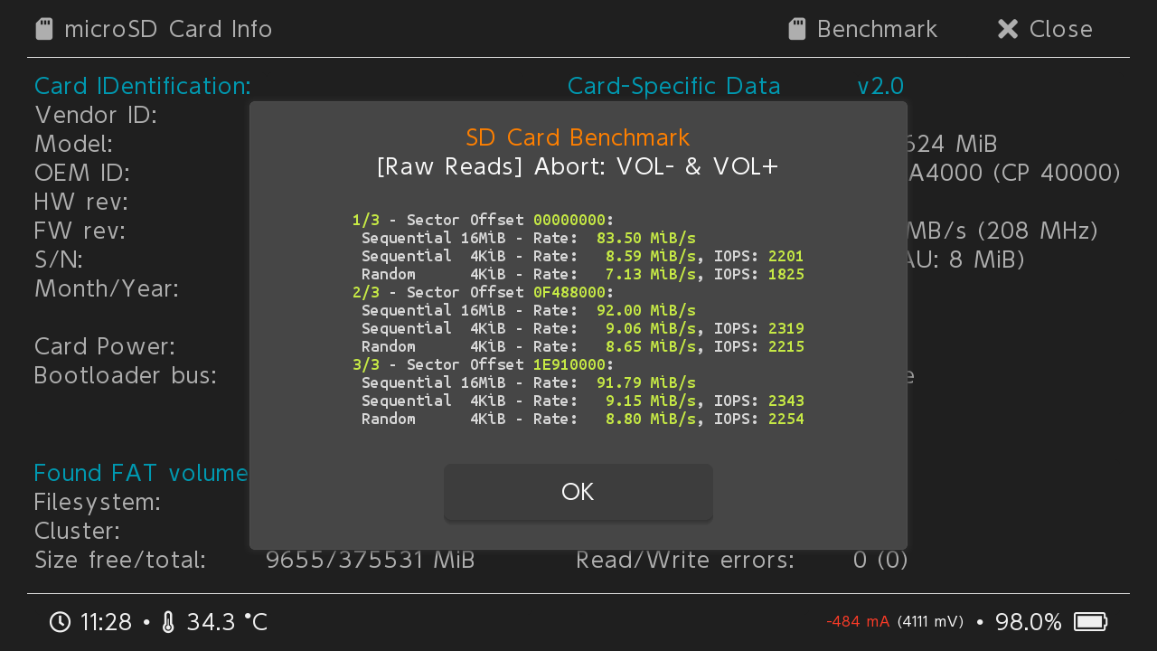

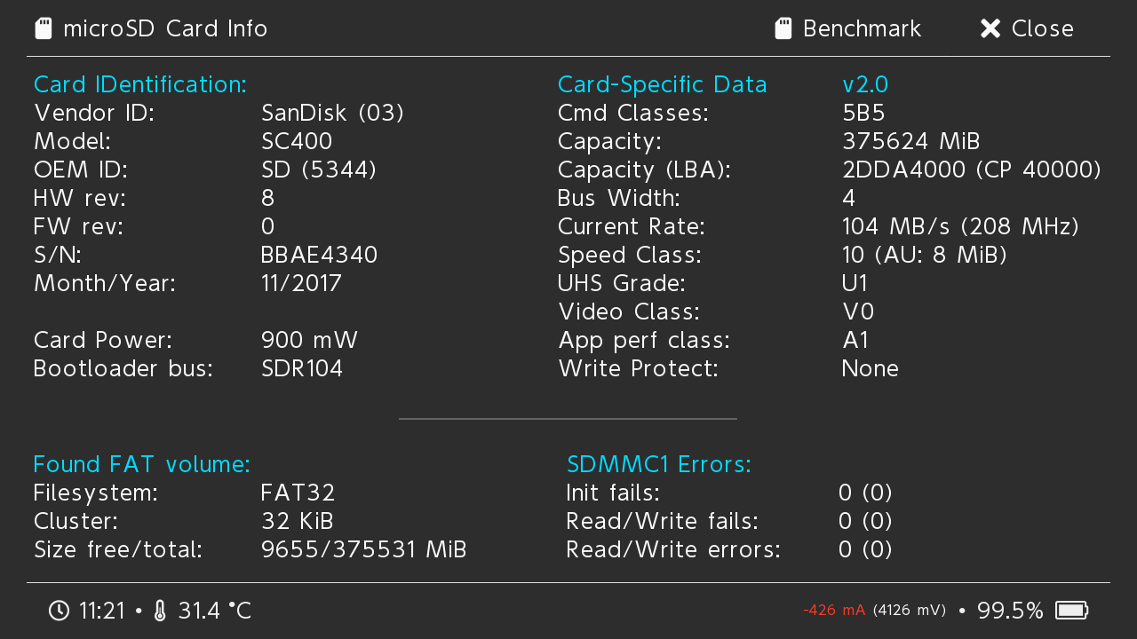

Iam adding info from samsung pro and lexar play 512gb plus bench of the samsung

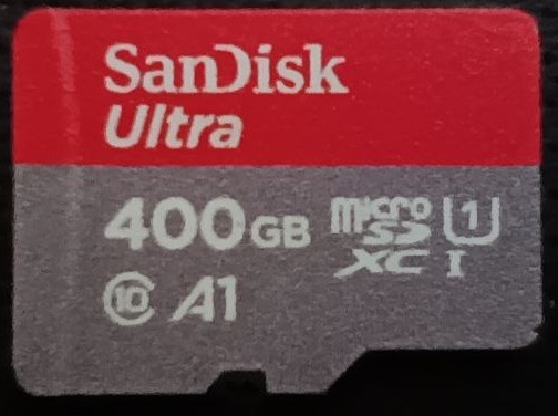

This is my SD Card:
and this are my Hekate captures:
may be I haven't the issue because my card is slow.

This is my SD Card:
you are using file-based so you are safe anyway but your card is on 900mW lvl same as Binki so this is again interesting ;P because i get that 2880mW(with is the max allowed?) even on the 512 sandisk(same model as Binki prchase in this week) or 128gb samsung evo and few other cards :o again even the same cards can draw more or less power but in my switch all of them are pushing for max :P Think i will buy a new sd card reader just to check if this can go lower on the new one.
