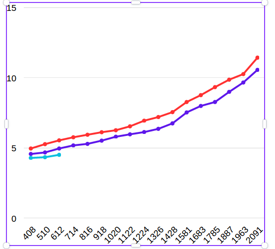

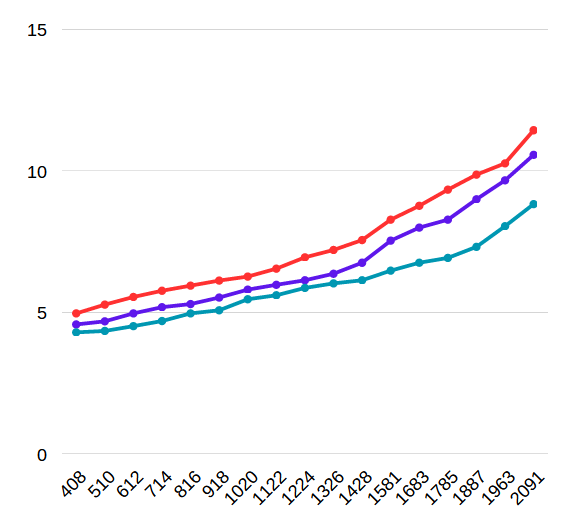

I just got done with 2 thread load testing, I'll get everything done with 1 thread probably today at the latest.
For now, this is what I have
CPU Speed3 Thread Load2 Thread Load
209111.4510.58
196310.289.68
18879.889.01
17859.358.29
16838.788.01
15818.297.55
14287.576.77
13267.226.38
12246.966.15
11226.565.99
10206.285.82
9186.145.54
8165.965.31
7145.785.2
6125.564.98
5105.294.7
4084.984.59
Red is 3 threads, Purple is 2 threads and Light blue is 1 Thread (still not done)

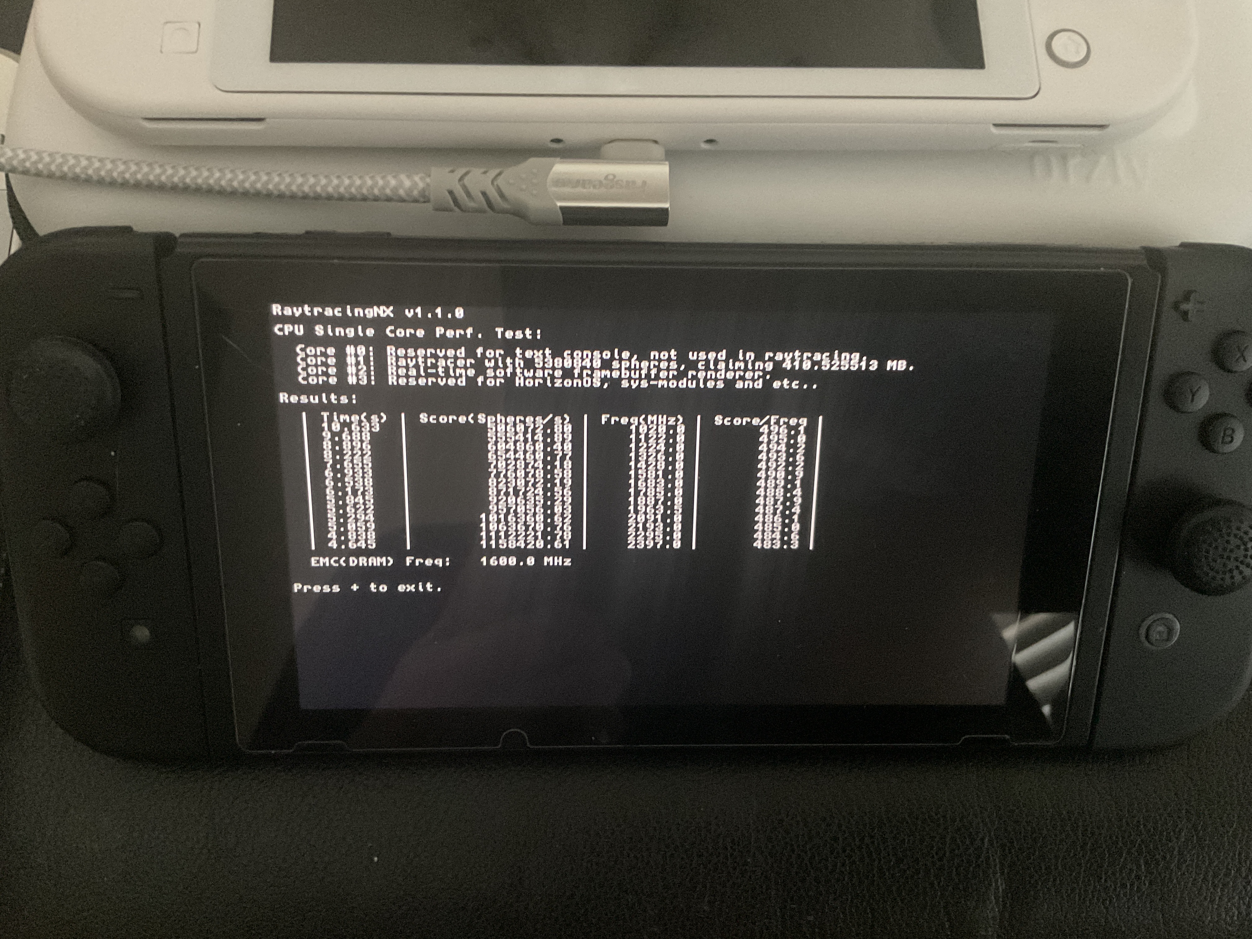

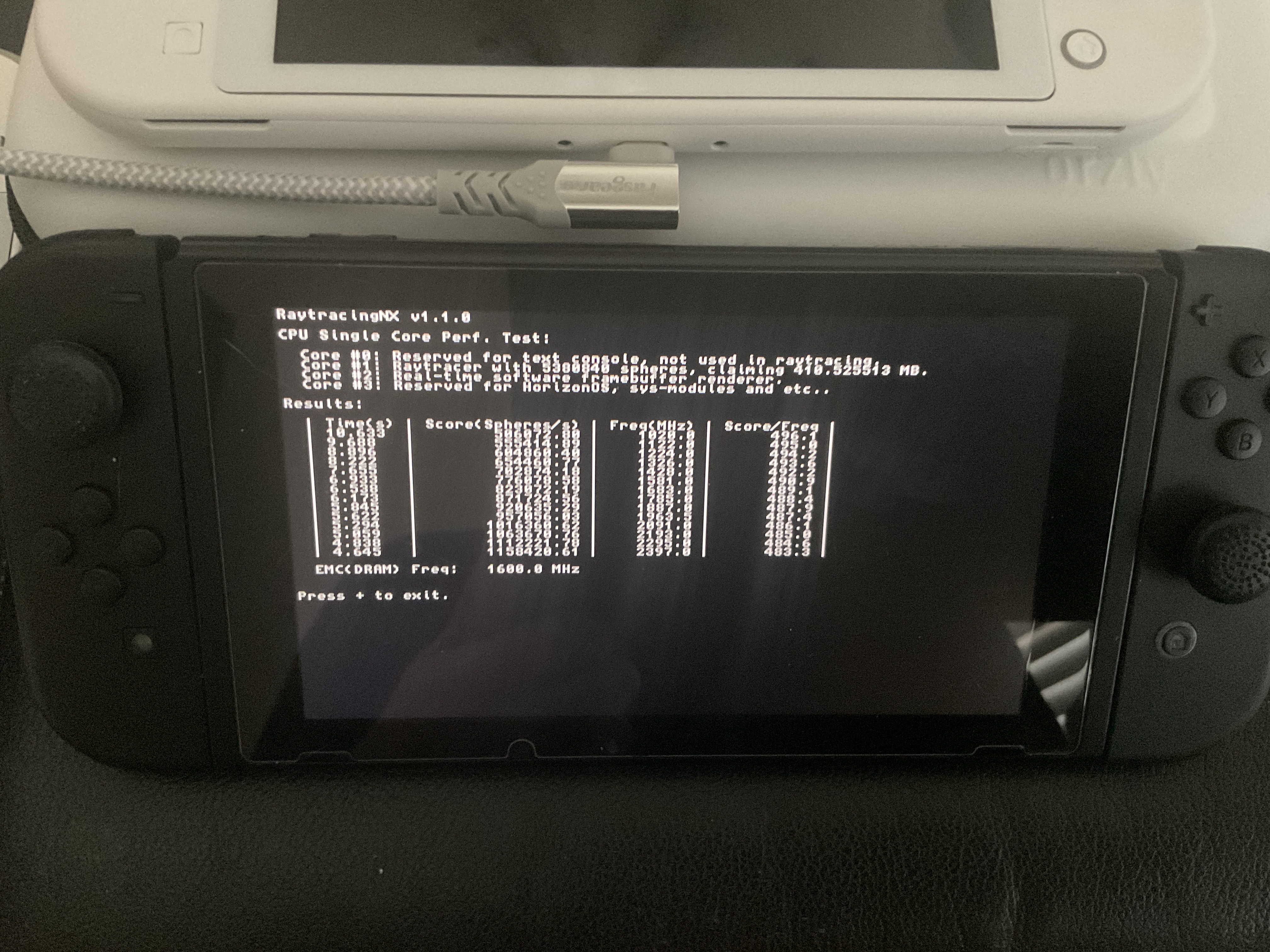

What's that RaytracingNX???

Final graph for power draw from 3 to 1 thread. In watts, and only recorded peak power (Average was about 8-4% lower)
209111.4510.588.84
196310.289.688.06
18879.889.017.33
17859.358.296.94
16838.788.016.77
15818.297.556.49
14287.576.776.15
13267.226.386.04
12246.966.155.88
11226.565.995.62
10206.285.825.48
9186.145.545.09
8165.965.314.98
7145.785.24.71
6125.564.984.53
5105.294.74.36
4084.984.594.31
Final power draw numbers

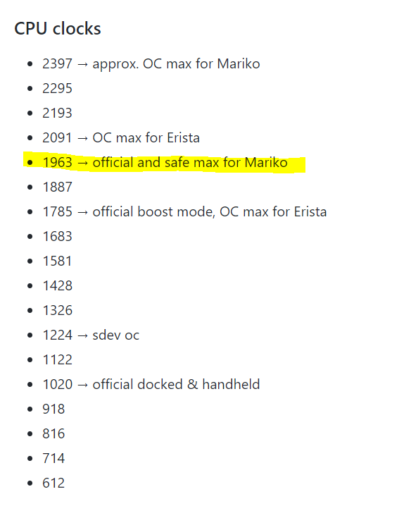

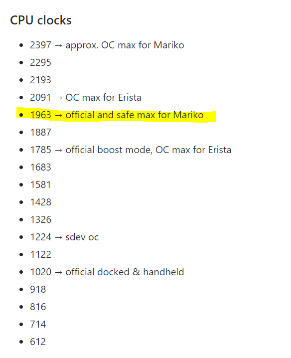

So if I’m reading this right, on my V2 I see tremendous improvement (about 1 sec) from 1020-1224 and the about 1/2 second from 1224-2091 and from there it tapers off into diminishing returns. So I take this to mean I should settle for 1963 or 2091 at most to get the most bang for the buck without stressing the rest of my machine unnecessarily.
I know there are more angles, but is that the correct way to read this one facet of the picture?
Neat!
Yeah it's good settling for 1963, that's the highest 'safe frequency' on Mariko. You probably can go on 2091 but only if GPU is not being used very much at all something and set to a lower clock i.e. 460 GPU. Good for demanding emulators. The CPU increases don't necessarily translate into double performance in games, however. If you overclock your RAM you will get higher results and performance as well with lower CPU clocks.
I'd probably also use TinyMemBenchNX instead now because that's what the vast majority of people use to compare CPU/RAM performance. There's some screenshots of that benchmark hiding in this thread somewhere.

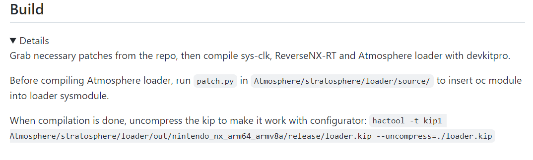

The only way to edit the loader.kip is to use the online configurator, unless you compile it for yourself which is complicated and I personally don't know how to do it, however there is a guide under the Build tab here if you want to make your own edits. https://github.com/KazushiMe/Switch-OC-Suite
