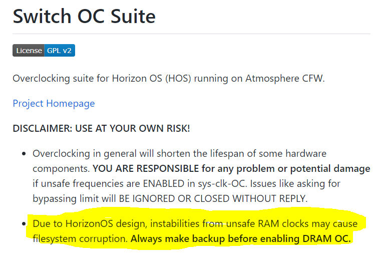

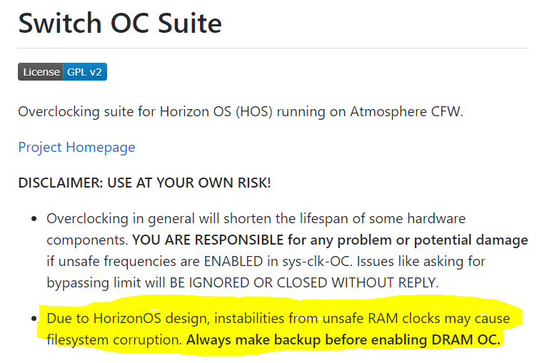

Higher RAM frequencies above 1600 have a chance of auto-corrupting the emuNAND on boot and also during games. The higher and higher the clockspeed the higher the risk. There's a huge chance of corruption at this clockspeed because of how high it is and I bet there isn't a warning either that this is extra dangerous, not to mention how this is likely overvolted up the ass which is not good for the longevity of the RAM.
The voltages are almost stock (slightly higher) and the timings are short, the performance benefits are huge, and it works on most of the Mariko consoles, no corruptions
I believe you about the performance increases though I know of someone in the 60FPS Discord this has crashed which isn't surprising.
There's a good reason why the project whose code you are using says to always make a backup before enabling RAM OC because it can cause corruption. Don't lie and say there's no chance of corruptions.
Also you really should talk about this in the 4IFIR thread.
And what if I told you than NO actual cases of FS corruption were found during testing? Remember, 4IFIR uses lots of custom optimizations and even a custom build of Hekate called 4ekate

Compatible means working effectively on Samsung, Hynix and Micron RAM with good timings, and only 700 mv voltage, on some good RAM chips, voltage can be dropped lower than 600 mv
700mv minor overvolt :rofl2:
The default is 600mv. I don't think I'd call that minor especially when hekate doesn't let you go over 650mv. That's a huge increase
