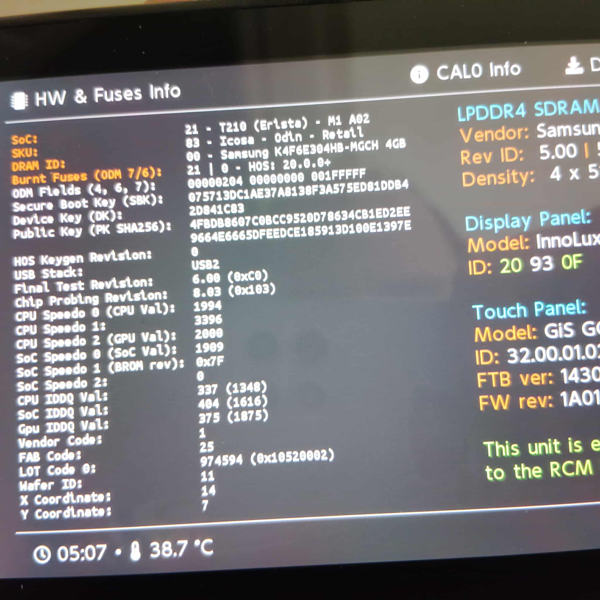

Hello i just modded my v1 switch i think i hit silicon lottery i know to use sys clk for safe overclocking but i wanted to push it further and show off this bin because idk how good it is and if someone can help me push it further or tell me how hard i can run it
Hello i just modded my v1 switch i think i hit silicon lottery i know to use sys clk for safe overclocking but i wanted to push it further and show off this bin because idk how good it is and if someone can help me push it further or tell me how hard i can run it View attachment 532769
Remenber that you could KILL YOUR SWITCH and the things are more expensive nowadays so be careful.
yes i know im very familiar with PC overclocking i plan on being careful i havent even touched these "safe overclocks yet" Im just wondering if this is silicon lottery (because its the highest speedos i saw) and if it is how can i safely push it more/undervolt it necessary i dont want to mess it up but if i do its not the end of the world right now i got it really cheap
https://rentry.co/howtoget60fps
https://rentry.co/erista
This explains everything you'll need to know.
This is a tablet, it overheats way faster due to half of it being a screen.
Overheating is not a problem for switch overclocking especially on Mariko. I rarely go above 51C at 2397/1228/2400 on my v2. Yeah, Erista is worse but 1785/921/1996 undervolted is fine in terms of temperature. on my Erista I don't remember it going above 61C or so. You are more worried about power draw and other stuff in terms of overclocking on Switch anyhow.
