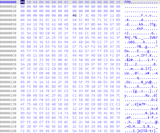

Has anyone worked with fpd archives? Are there any methods of unzipping? (New Fate/stay night by type-moon)

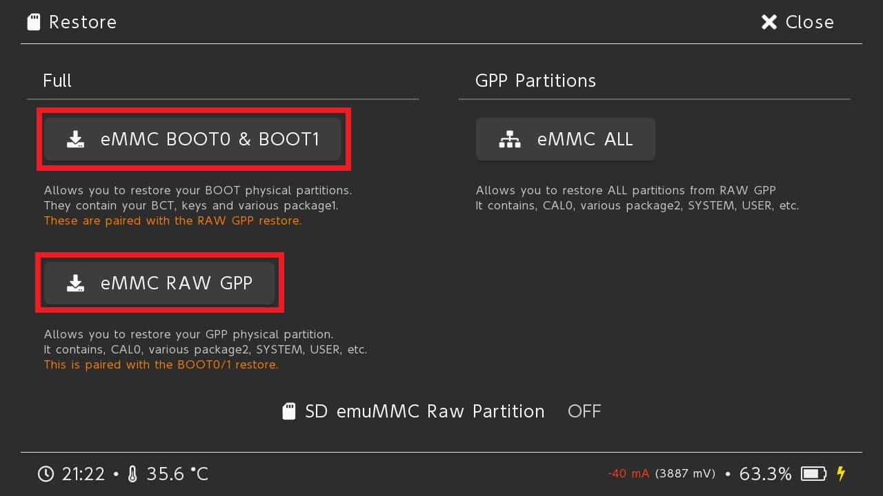

Hello everyone! I encountered a problem, I want to ask for your help, at night I installed picofly and ruined the switch, at first it started in hekatu, in it I made emunand and saved the prod key, but I didn’t make a backup copy of sysnand, I restored everything that I ruined by a long way, but having tried all the methods through tegra I cleared the nand, and the question is, is it possible to make a copy from the working emmunand and restore it in sysnand?
Why not? I don't see why it wouldn't work. But if you installed nsps on your emunand already, obviously, your sysNAND would then be dirty as well. If you want to avoid being banned, that's a problem.
switch was completely empty I didn't have time to install anything I only did emunand and prod key saved and only then discovered a problem with the processor power controller
tell me what tool to use to make a copy from emunand to return it to sysnand, thank you very much in advance!
I believe you can turn on SD emuMMC Raw Partition then make a backup of boot0/boot1 and then turn off the SD emuMMC Raw Partition option and then restore to the internal Emmc.
Unfortunately it didn't help
Does your emunand boot?
yes but sysnand not work
on the other hand micro sd writes here's how to do it to return information to the native nand
всем спасибо! кто ответил,решил эту проблему через hekate вкладка more black screen fix.
Thanks to everyone! Who answered, I solved this problem through hekate tab more black screen fix.

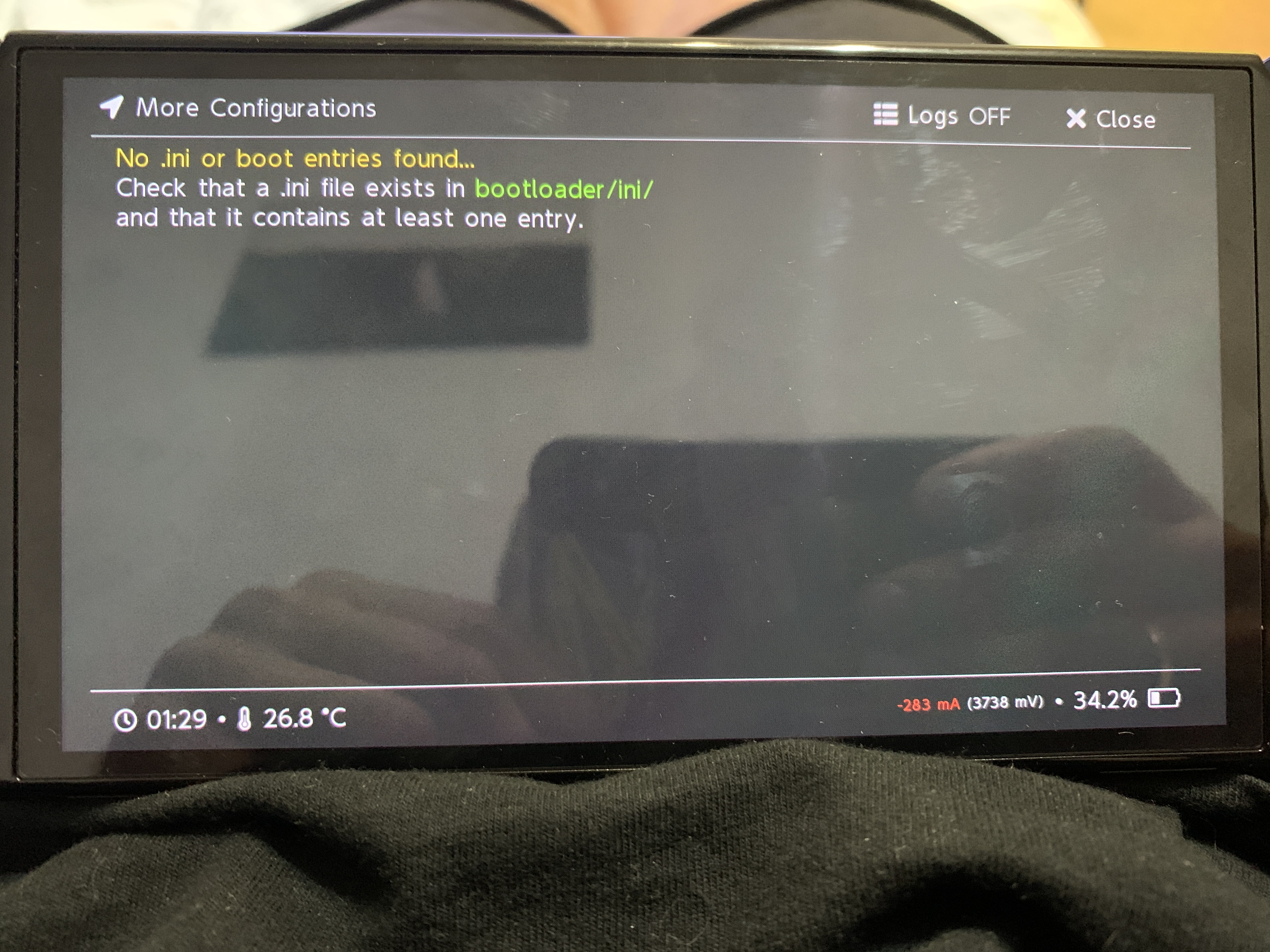

Okay, back to this.
I dont understand what is going on. I dont know what its problem is. But it is a problem, im tired of having it happen. What is its damage, ans how do I get it to stop?
Atmosphere keeps crashing. I take it off the dock? It crashes instantly. I go leave to do an errand and come back to it? Its crashed. I put it in its case to take with me to work? Not only has it crashed, its burned through at least half of its battery capacity before I can get it to finally boot.
What the hell is its problem? See attached. It gave me this when I took it off the dock, to start up ttyd. It *played* fine, docked. But with this behavior, I literally cannot take it anywhere because it'll just burn through its battery before I can play at all. And that is bullshit.
