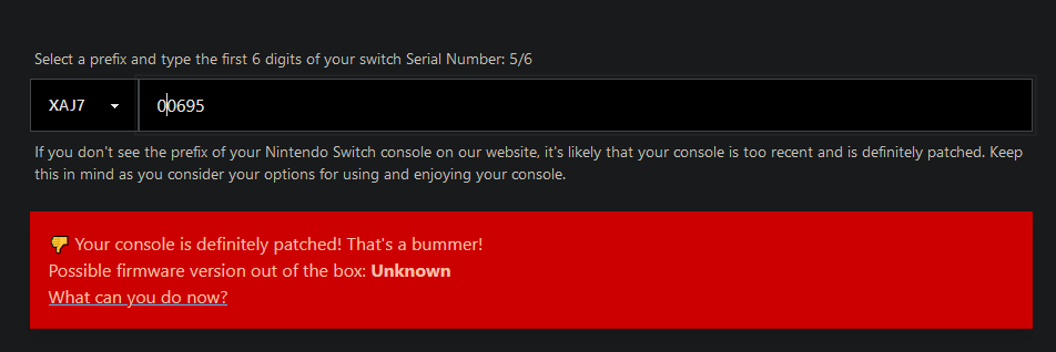

First is the serial number (I bought a used V1 switch and it is unpatched - based on Is My Switch Patched?), how would the chance of being a fake "unpatched" switch? Because the serial number is XAJ700695XXX (the website states that it is unpatched but the possible firmware version is unknown)
Is the serial number correct? No additional 0? Because XAJ700695 is definitely patched, while XAJ7000695 isn't.
I really hope that it's just a typo, seeing that you probably typed in as many digits as possible.
Firmware version doesn't matter as far as console is the unpatched (i.e. Erista) model, so don't worry about that.

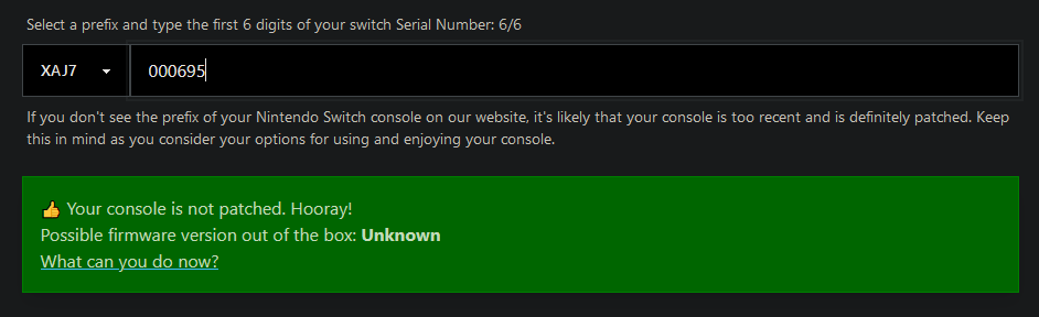

Yes it is just a typo (is 000695).
