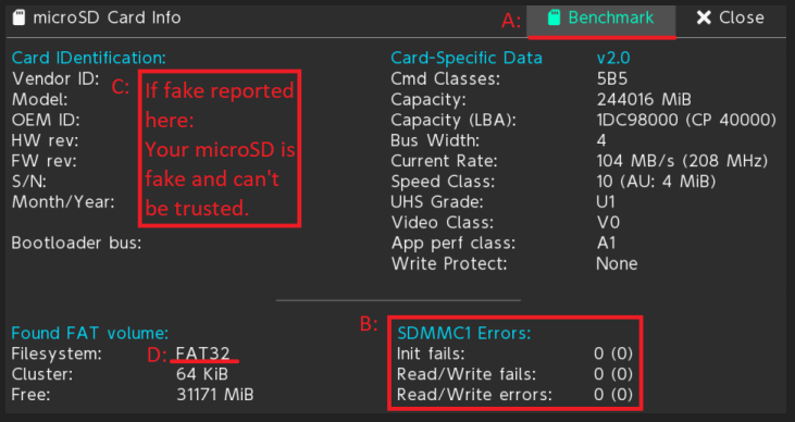

If you run the card through H2testw it will tell you if it's a fake (most likely if it's unbranded). You may be able to tell on the Hekate screen also. Example: https://rentry.co/SwitchSDInfo
