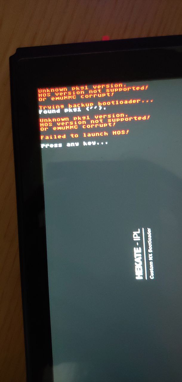

hi guys,
I'm new at this "Hacking", I followed the guide of the nh-server.github site step by step, I did it twice but both times I get this error, I'm desperate, I created an account here just for this problem because I don't know what to do anymore xP
all files have been downloaded today, so all files are up to date, also the switch is up to the latest update
does anyone have any ideas?
hi guys,

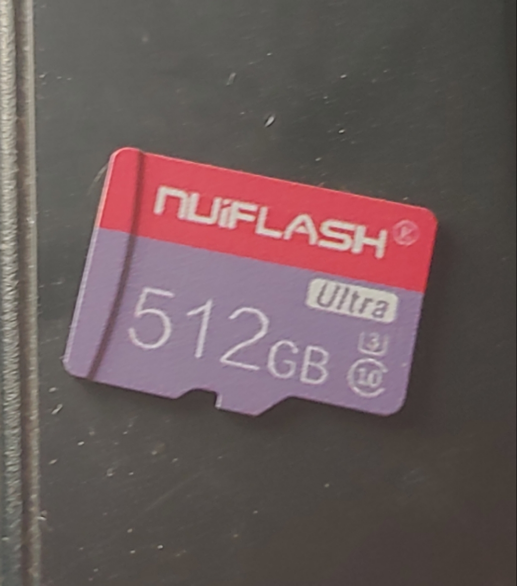

Hey I'm having the exact same error. What SD card are you using? Is that error from trying to boot into emuMMC?
Yes, the error appears when I try to start emuMMC, I'm using this sd card:View attachment 346916
Alright, I'm using a no-name 512gb sd myself, and I'm starting to think that might be the issue.
Do you perhaps have a smaller card you can try? Sadly I don't have anything but this one, and the replacement I ordered won't arrive until the 12th, so I can't test this theory myself.

I never thought it might be the sd card the problem, tomorrow i'ill try to test on another sd
Look quite cheap for a 512GB on Amazon, so you would wants to test the card as suggested. Doesn't look like a legit brand.

You should definitely always test your mSD card with H2testw like people always said here, if the mSD is fake or simply bad, it's a waste of time to try fixing problems when your mSD is the problem.
In fact you should stop buying strange named randomware mSD and buy a proper good fast one. I recommend Samsung Evo Select (the latest all blue A2) for example when it gets in promotion on amazon it has a good price-per-performance, I think it's the same as Samsung Evo Select but I heard it's exclusive to Amazon so you are even way less likely ever get a fake Evo Select buying from Amazon as seller than buying a Samsung Evo Plus from random ppl that if the price is too good to be true most likely it's going to be a fake one.
Also if you want emunand, a fast card makes a HUGE difference in speed and overall system smoothness, not to mention making huge backups and moving data on PC, like my friend 500GB he got cheap in a promotion here from a crap brand, I had to wait 2 hours to make a backup of like half it's GB at almost USB 2.0 low annoying garbage speeds while my mSD is around 80MB/s+...
