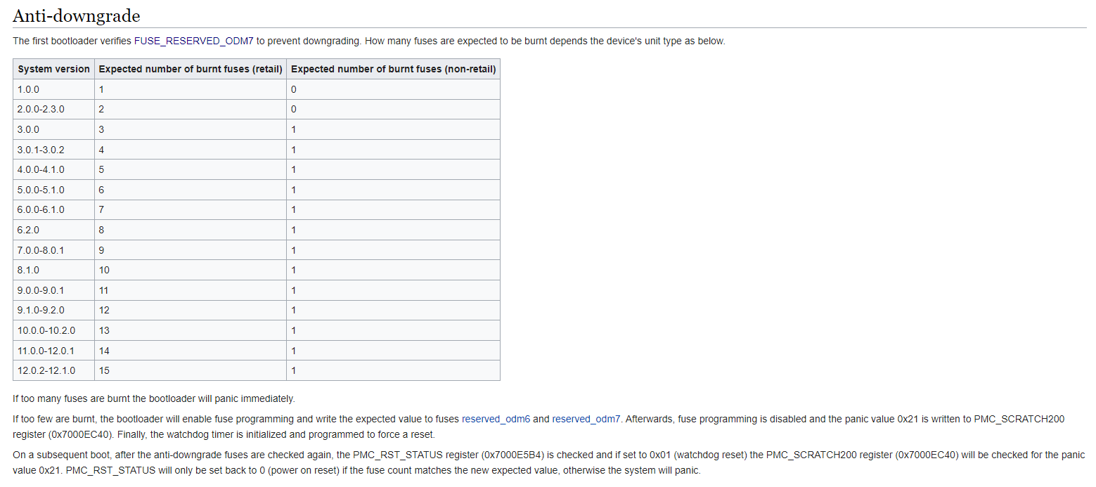

'Somewhat', because although I'm booting and backups do run OK, I'm also getting the dreaded "failed to match warmboot with fuses" error, and so sleep doesn't work. Kinda frustrating being this close, but not quite there.
Mariko unit, my emunand cfw matches versions with my ofw (10.2.0), but I noticed that I have 14 burnt fuses which seems to be incorrect, and may be the cause. Second-hand console, don't know the exact history.
What I deduced is this: for whatever reason my ofw is on 10.2.0, but to match the fuses it should be at least 11.0.0. Am I right on this? Do I need to update my ofw to 11? Do I end up with 15 burnt fuses if I do update it to 11? Can I update my emunand to 11.0.0 or 11.0.1 via Daybreak instead?
Any help is much appreciated.
Yea 14 fuse burnt expect 11.0.0 to 12.0.1 not 10.2.0.

I have a Mariko switch + trinket chip +sx core 3.1.0 + emuNAND
OFW 10.1.0
I have Atmosphere + Hekate 5.6.0
When I want to launch Atmosphere I have the error :
Failed to match warm boot with fuses - Sleep Mode won't work
When I press a key I have acces to the desk and all "utilities"
pgkg1 ('20200303104606)
Burnt Fuses (ODM 7/6) 14-0 HOS 11.0.0 12.0.1
ODM Fields (4,6,7) 00010A40 00000000 00003FFF
I followed a video on YT for migration
I'm totaly noob, can you help me with simple instructions ?
Thanks !
The error is self-explanatory if you read your own post. Your burnt fuses reflect a firmware of HOS (Horizon Operating System) between 11.0 and 12.0.1 but your firmware is 10.1. Since you cannot unburn fuses, the only option is to update the firmware to match the fuse count. As stated already, your fuse count reflects a firmware between 11.0 and 12.1 so any firmware in that range will do the trick. As for how to update the firmware, you can use the homebrew application Daybreak to do so; it comes bundled with Atmosphere nowadays. However, in order to use Daybreak to update your firmware, you will need to download the firmware files separately. Those files are copyrighted so we cannot link or help you find them but rest assured that they are available on the Internet if you look hard enough.
