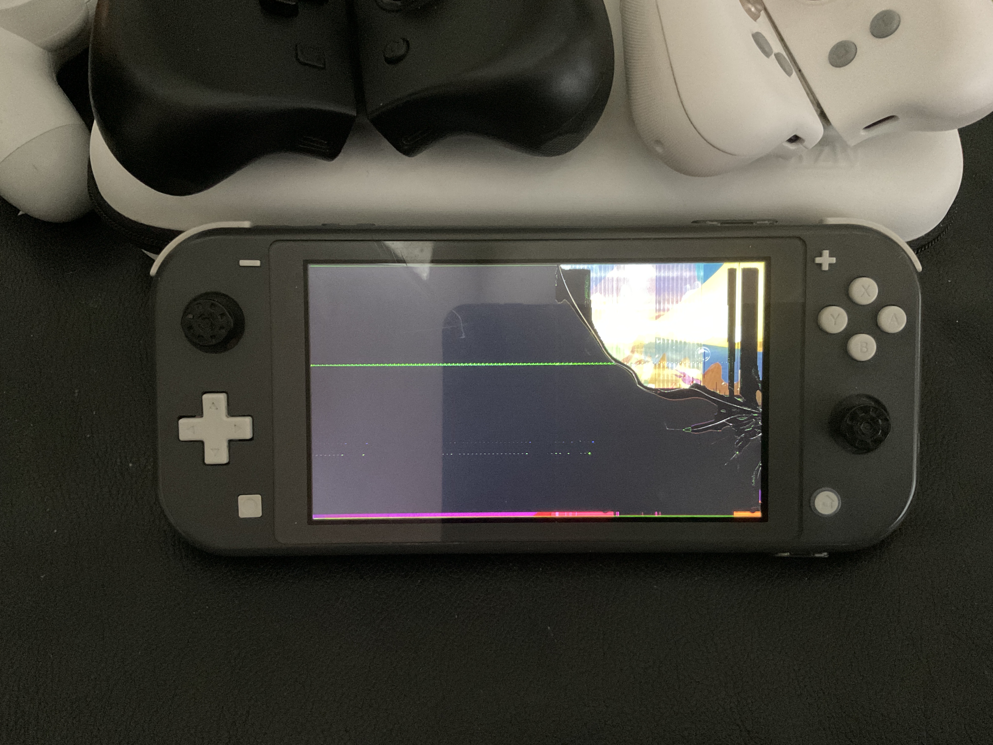

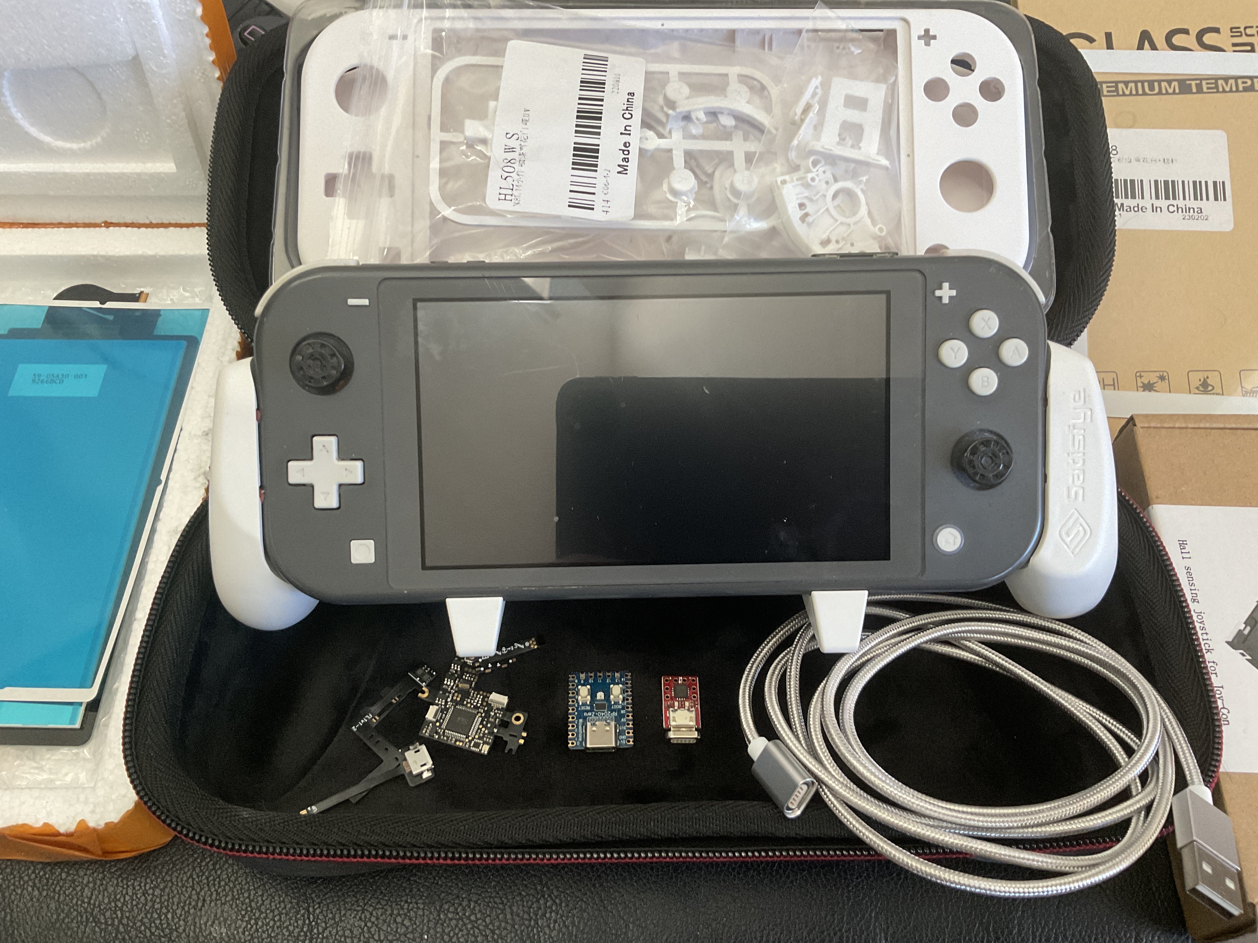

So I bought this $80 Switch Lite to experiment w/ the Pico Fly discussion going on over here:
https://gbatemp.net/threads/pikofly...-modchips-or-not.622701/page-14#post-10058218
With all the money I saved buying a broken Switch Lite I decided it was time to invest in those poor children of Extremerate engineers to ensure they can afford to go to college!
(In reality I just wanted an excuse to buy a Lite and custom mod it.)
Here’s what we’re starting with:
Cheap Switch Lite with a cracked screen
Laminated one piece screen replacement from Ali E https://www.aliexpress.us/item/3256804496995627.html
Extremerate soft touch shell (white)
Extremerate buttons (white)
Extremerate glass protector (white rim) https://www.aliexpress.us/item/3256801218913400.html
Gulikit Hall Effect joysticks (joysticks in the switch are shot!)
Satifeye grip and case (there goes the budget)
HWFLY modchip (in case the Picofly thing doesn’t work) https://www.aliexpress.us/item/3256803809562640.html
Rpi 2040-zero (in case the Picofly thing works out!) https://www.aliexpress.us/item/3256804090654134.html
Super tiny USB to UART adapter (want to mount it inside to UART-A since Lite has no Joycon rails)
Silver Magnetic USB cable (to connect to internal UART)
I’ll be following this guide and replacing things as I go
https://www.ifixit.com/Guide/Nintendo+Switch+Lite+Screen+Assembly+Replacement/156978
I’ll add some more pics and links as I come across things that deviate from the guide or are just generally interesting…

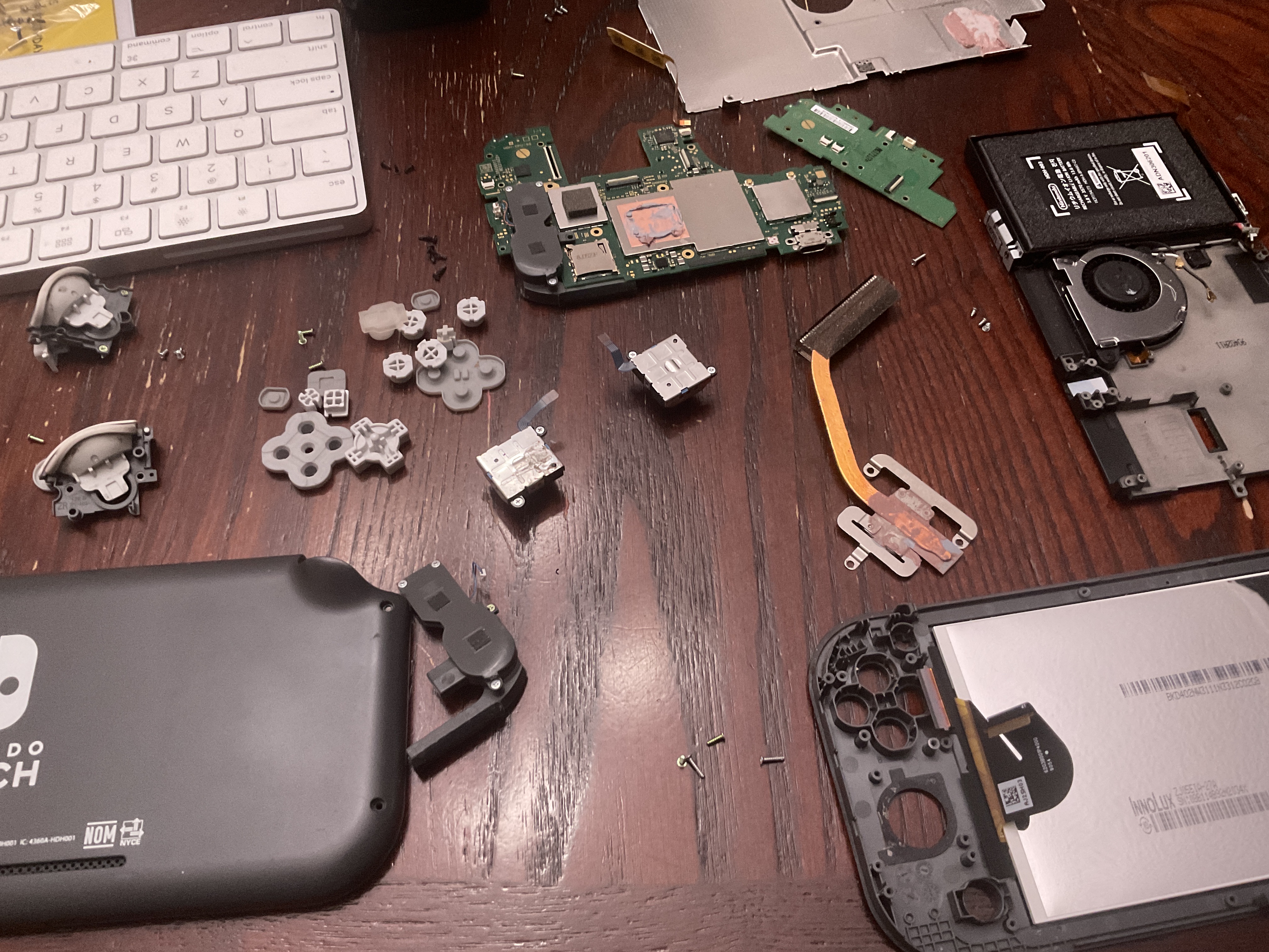

I guess this might be mildly interesting…she’s completely stripped down. I hope I remember where all these screws go!

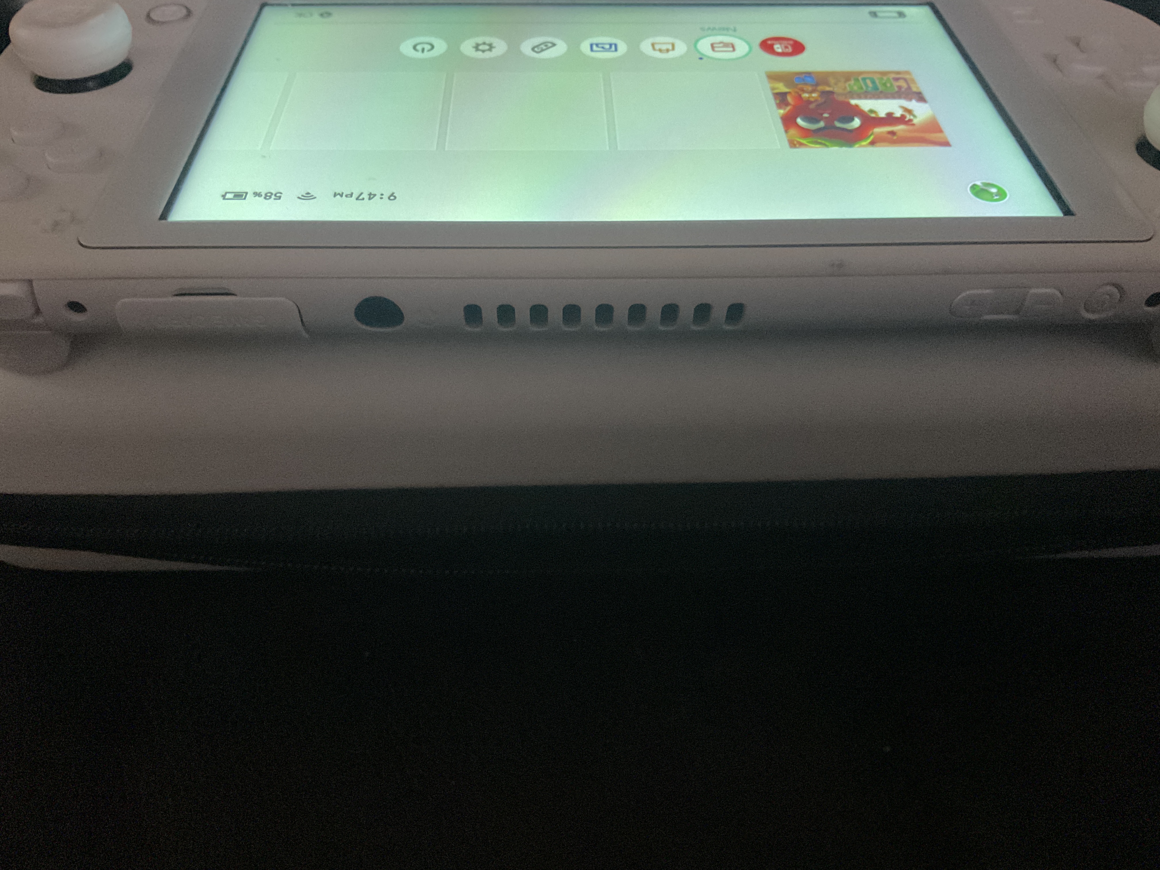

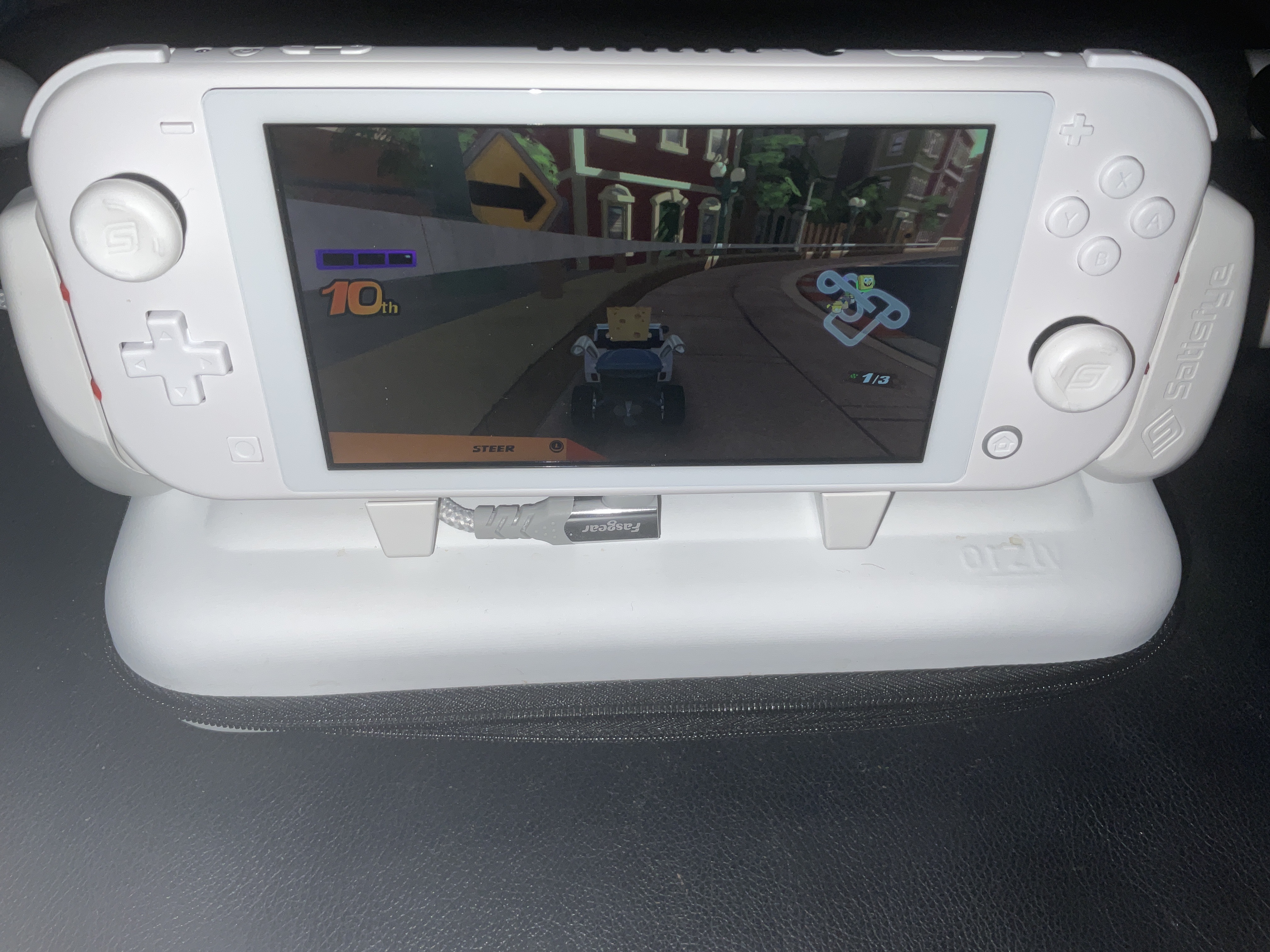

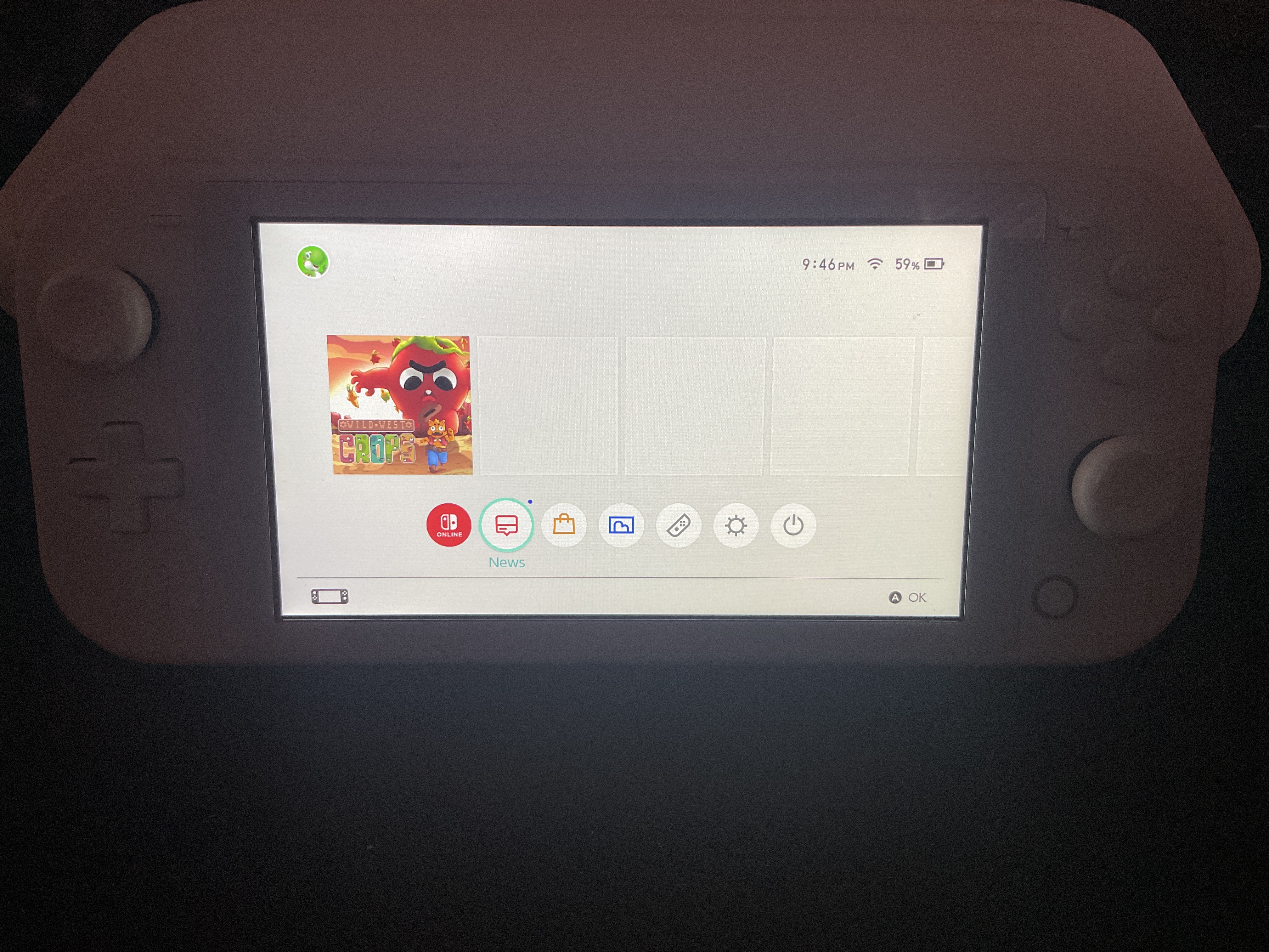

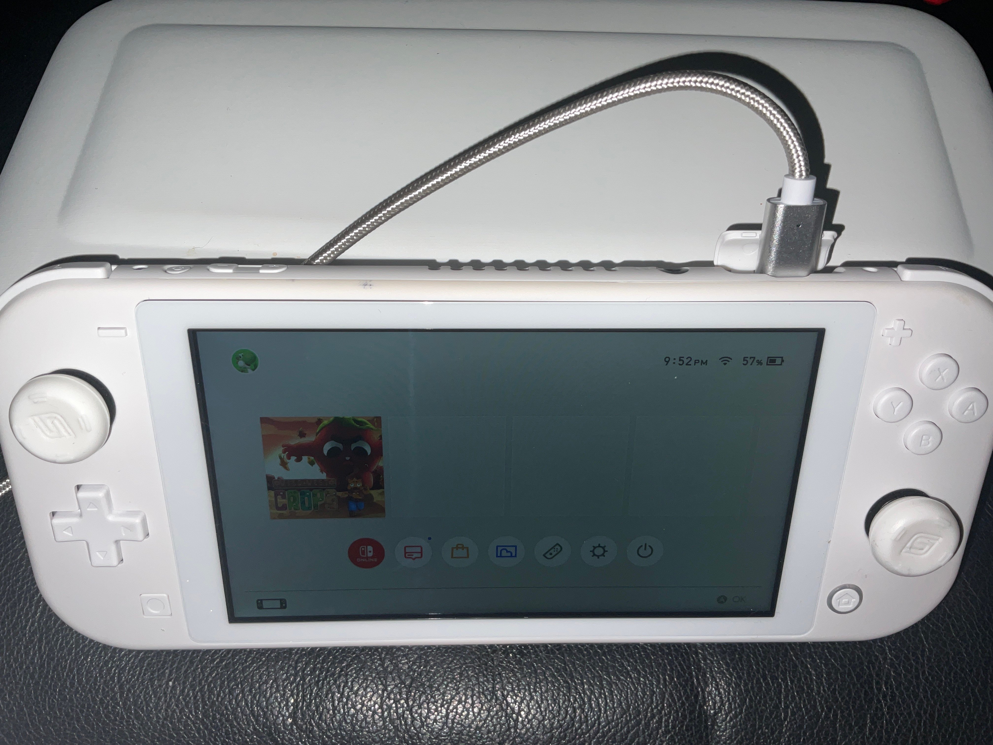

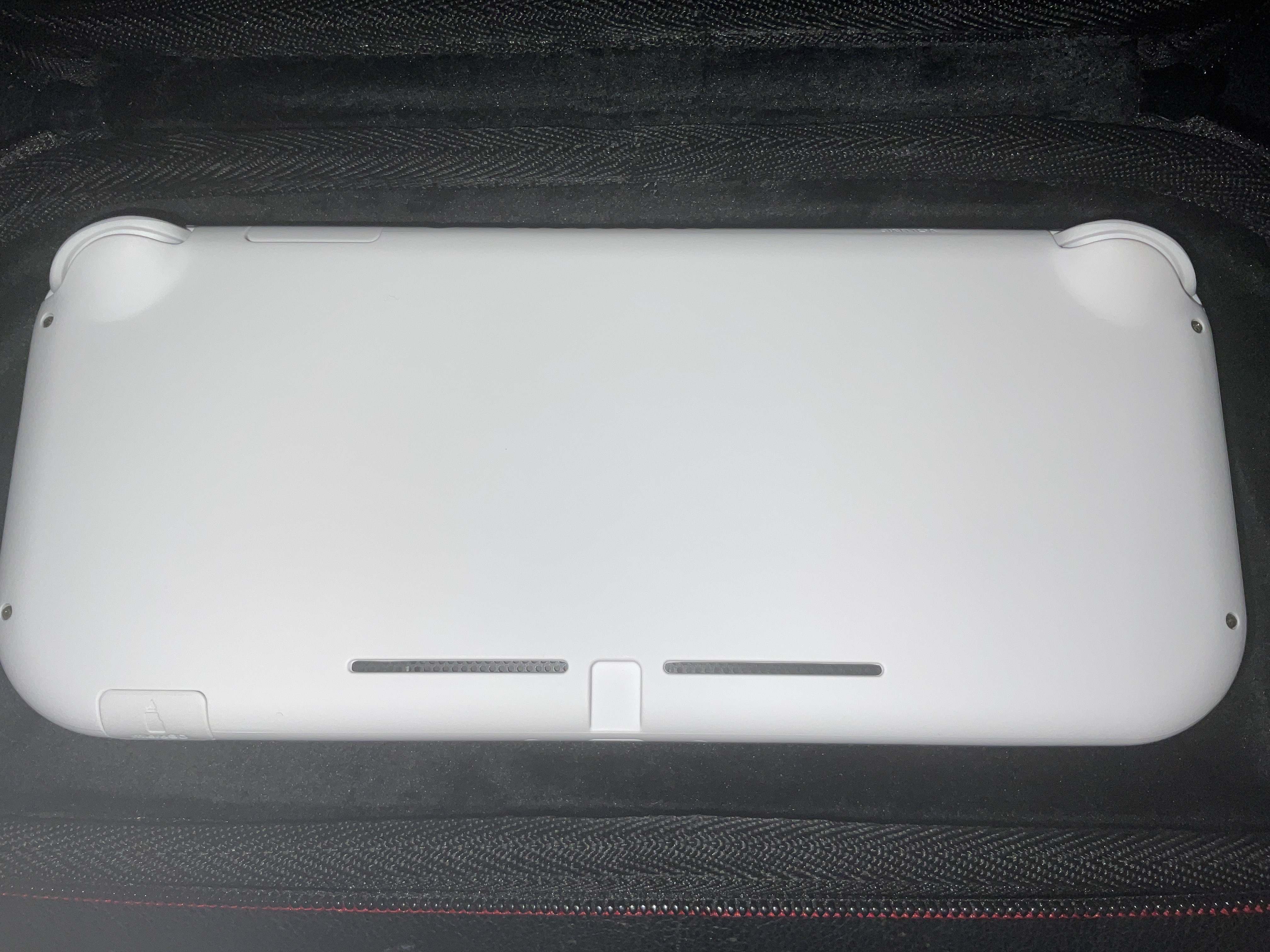

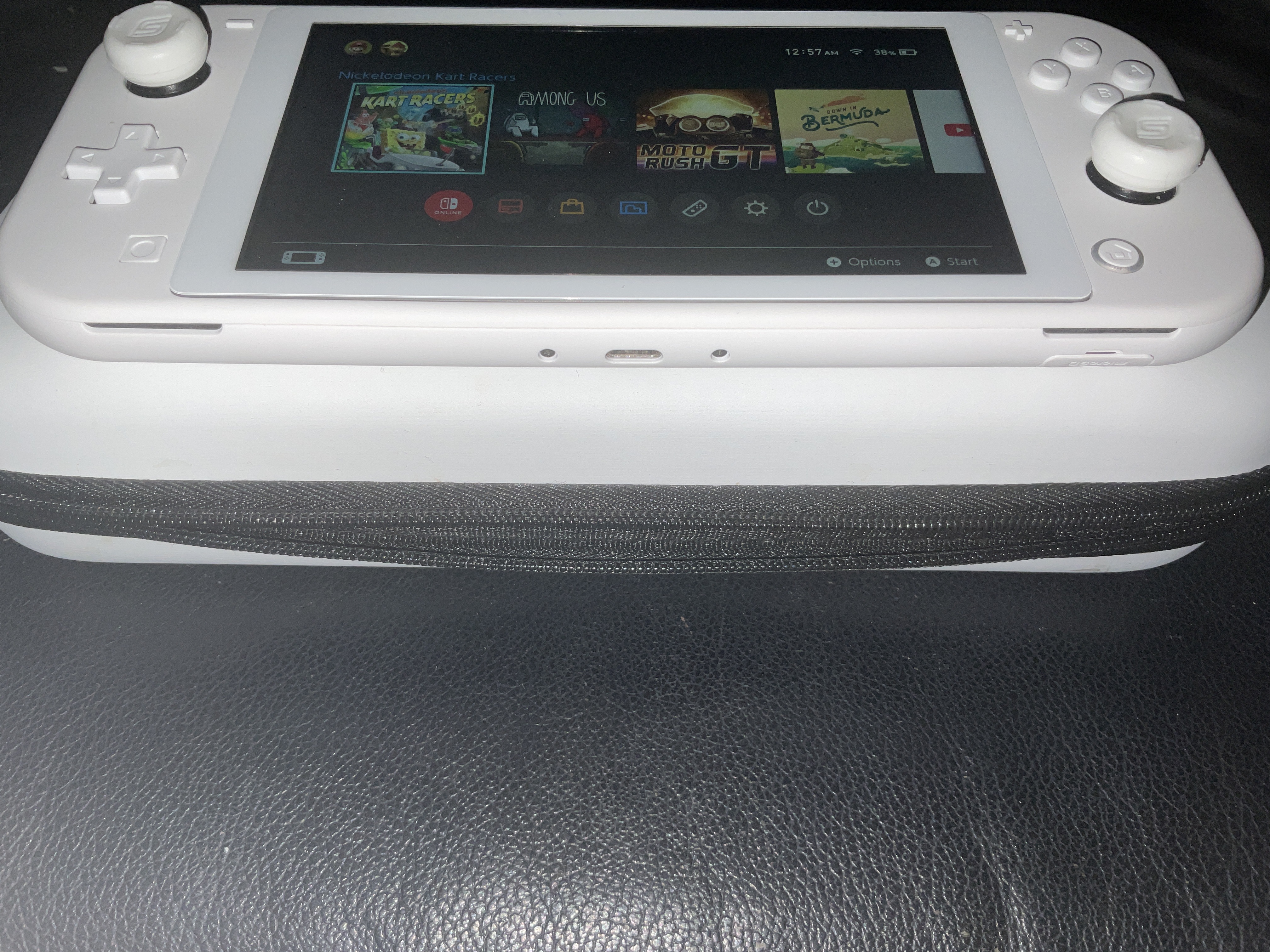

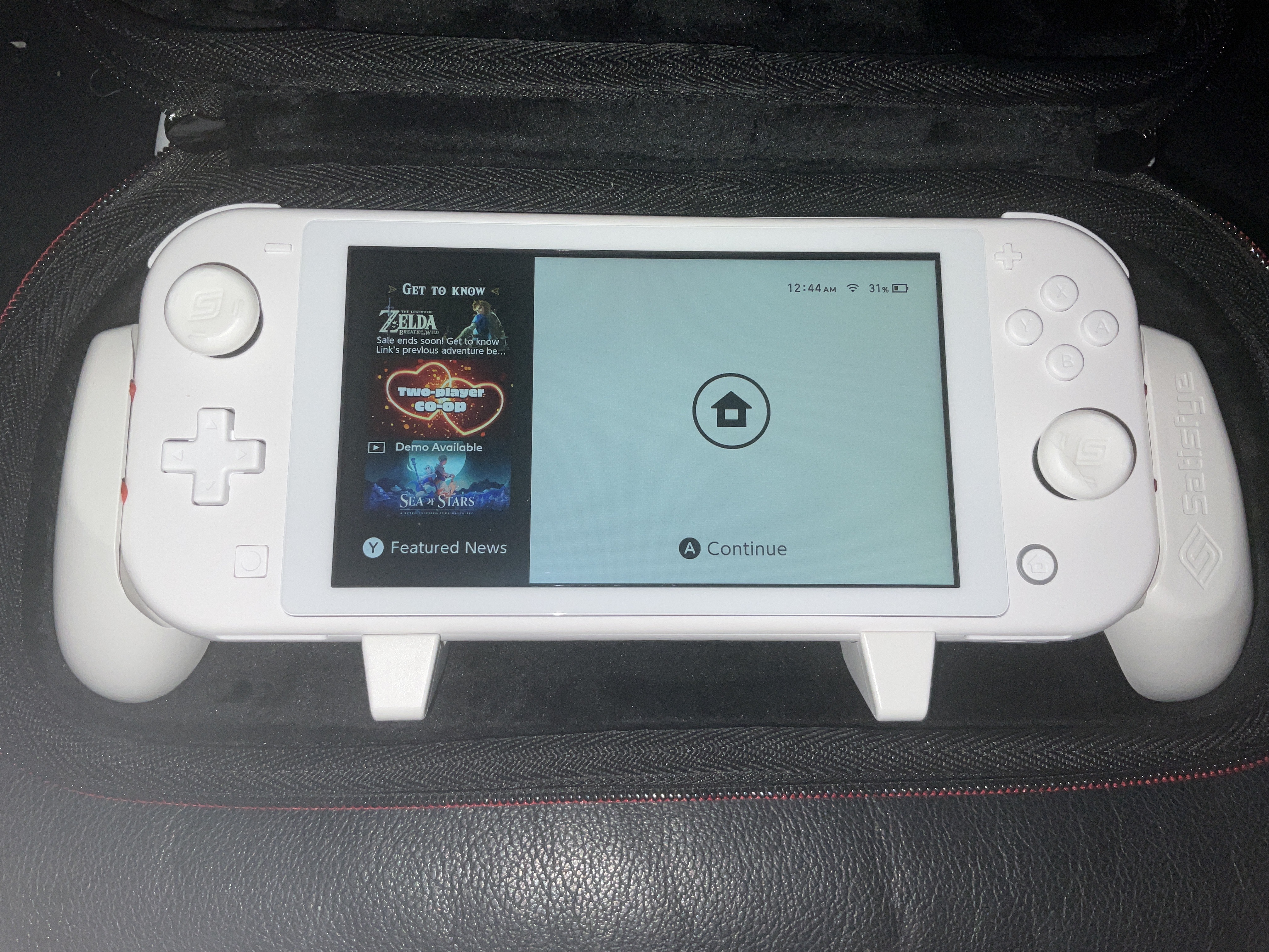

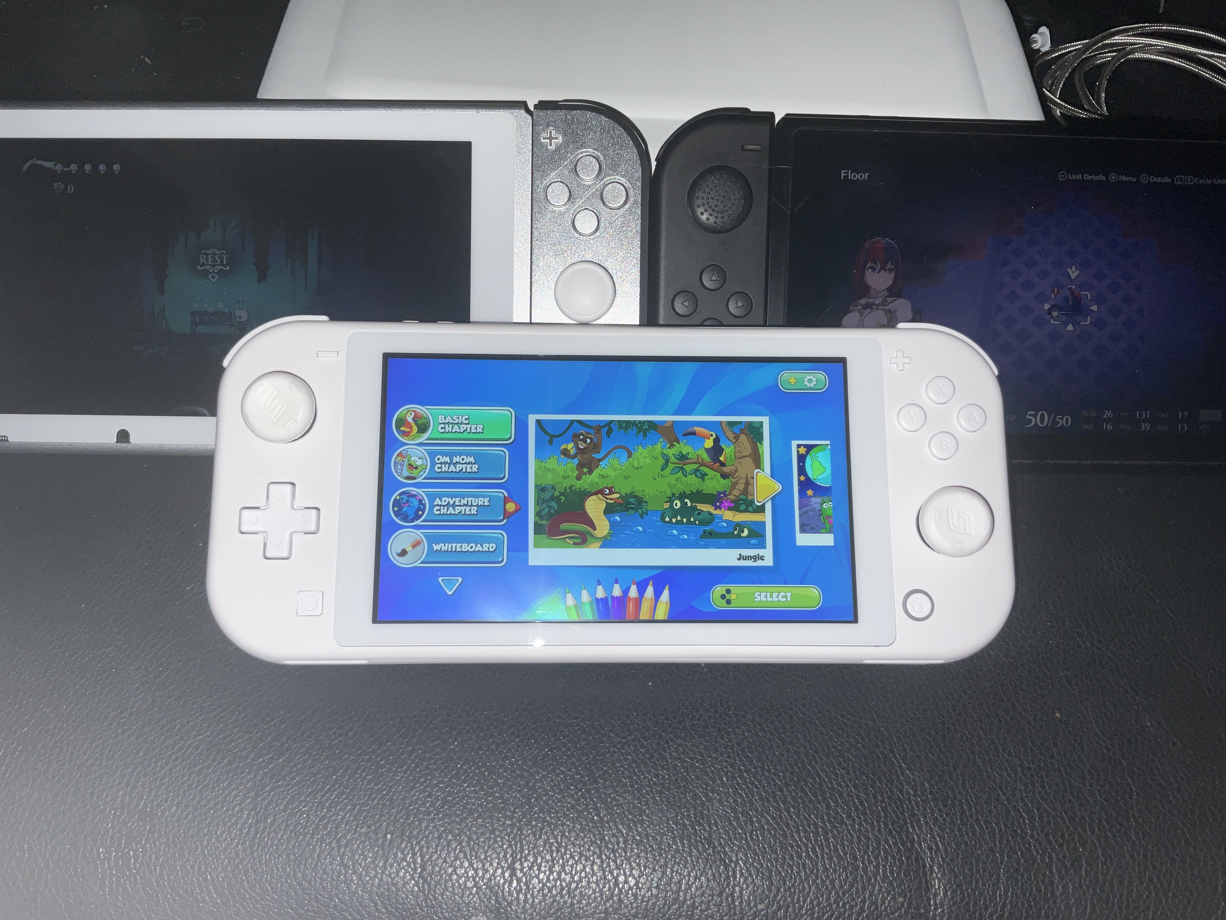

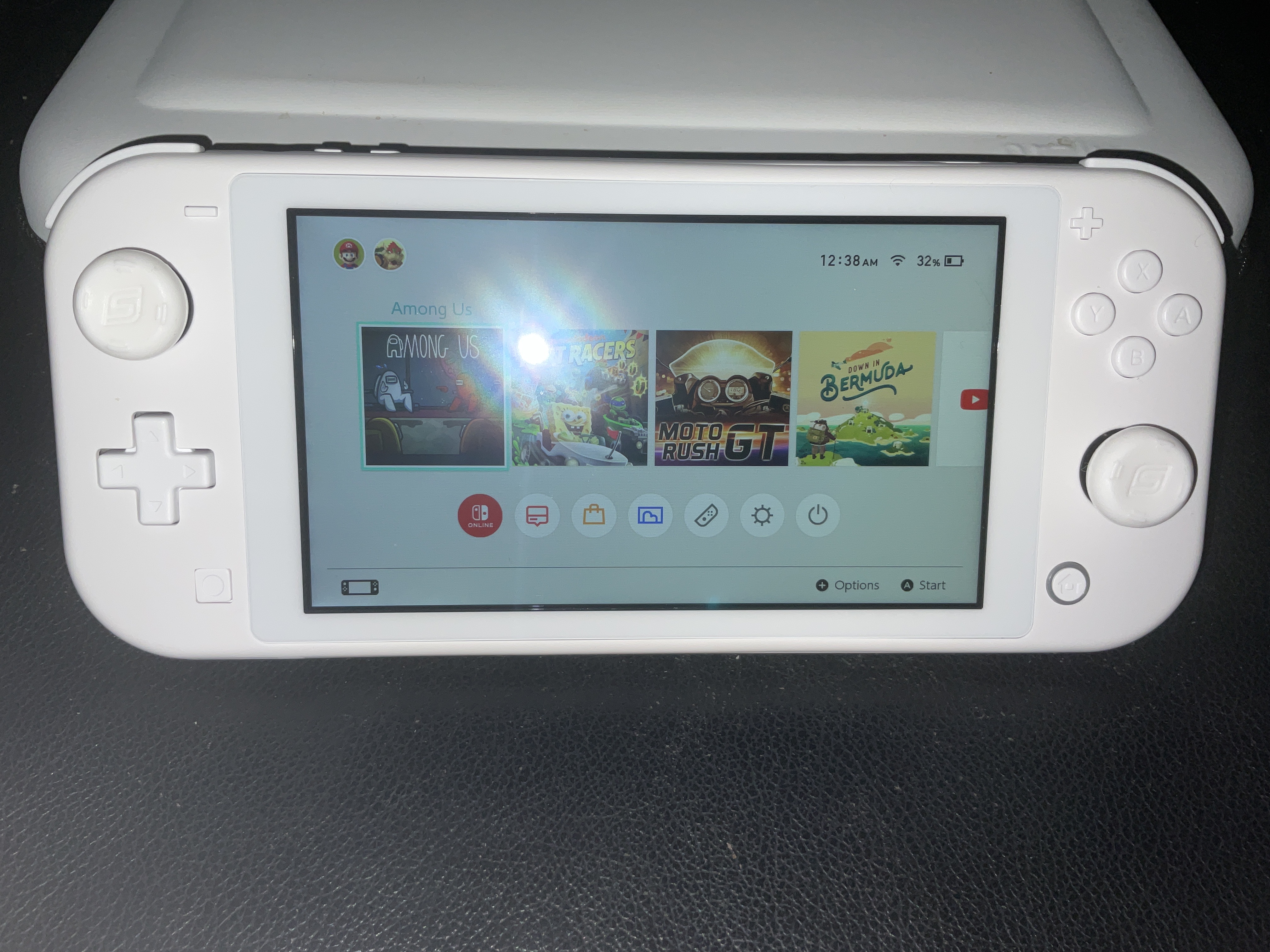

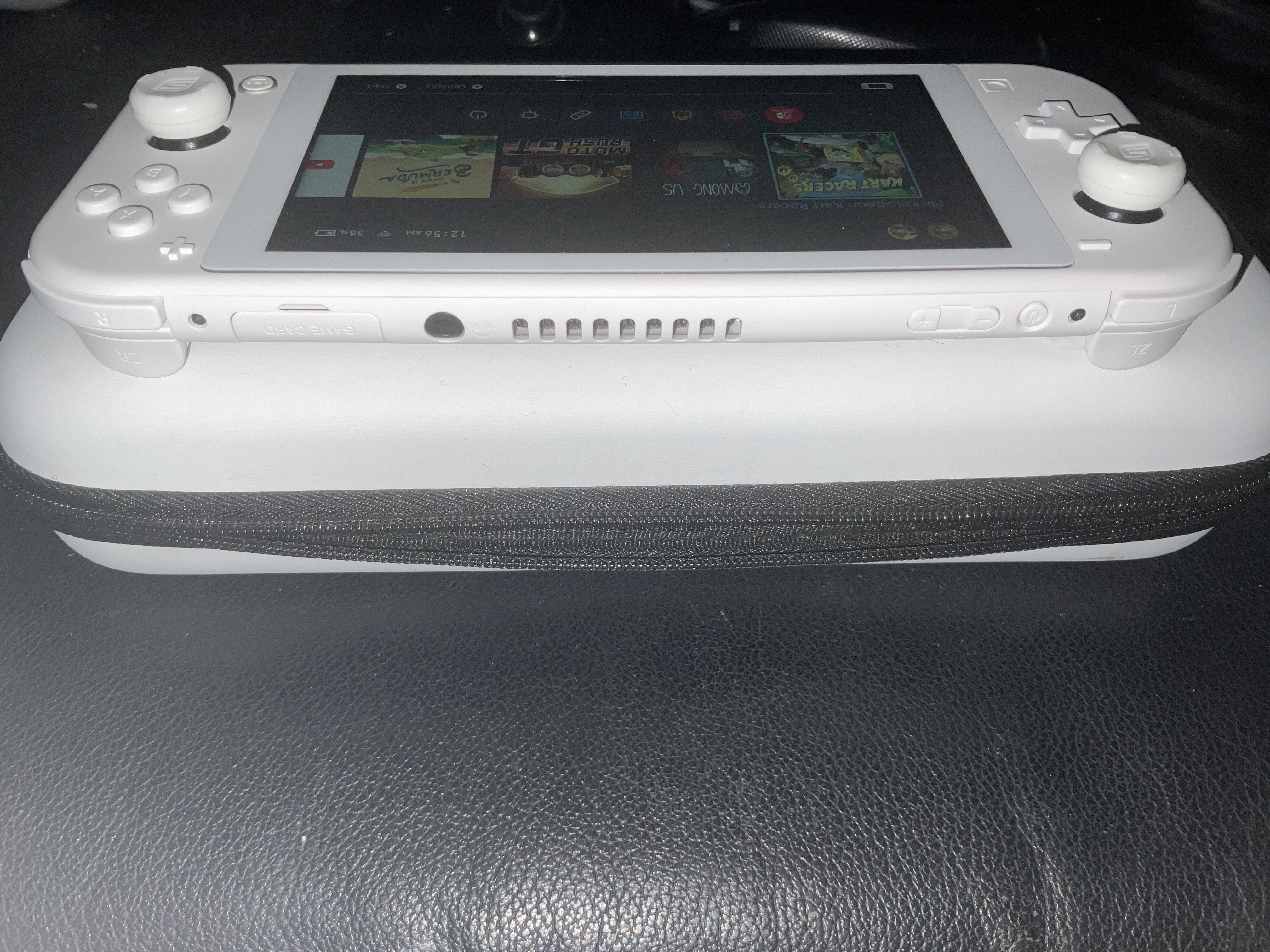

Without further ado, here are the latest glamour shots:
Family photo with V1 back left and V2 back right
Solo
Butt shot
With Satisfye grip and slim case
grip is self standing with room for 90mdegree power cable in “mini TV mode”
Edging
Underboob
Overall I’m pretty happy with how it’s turning out.

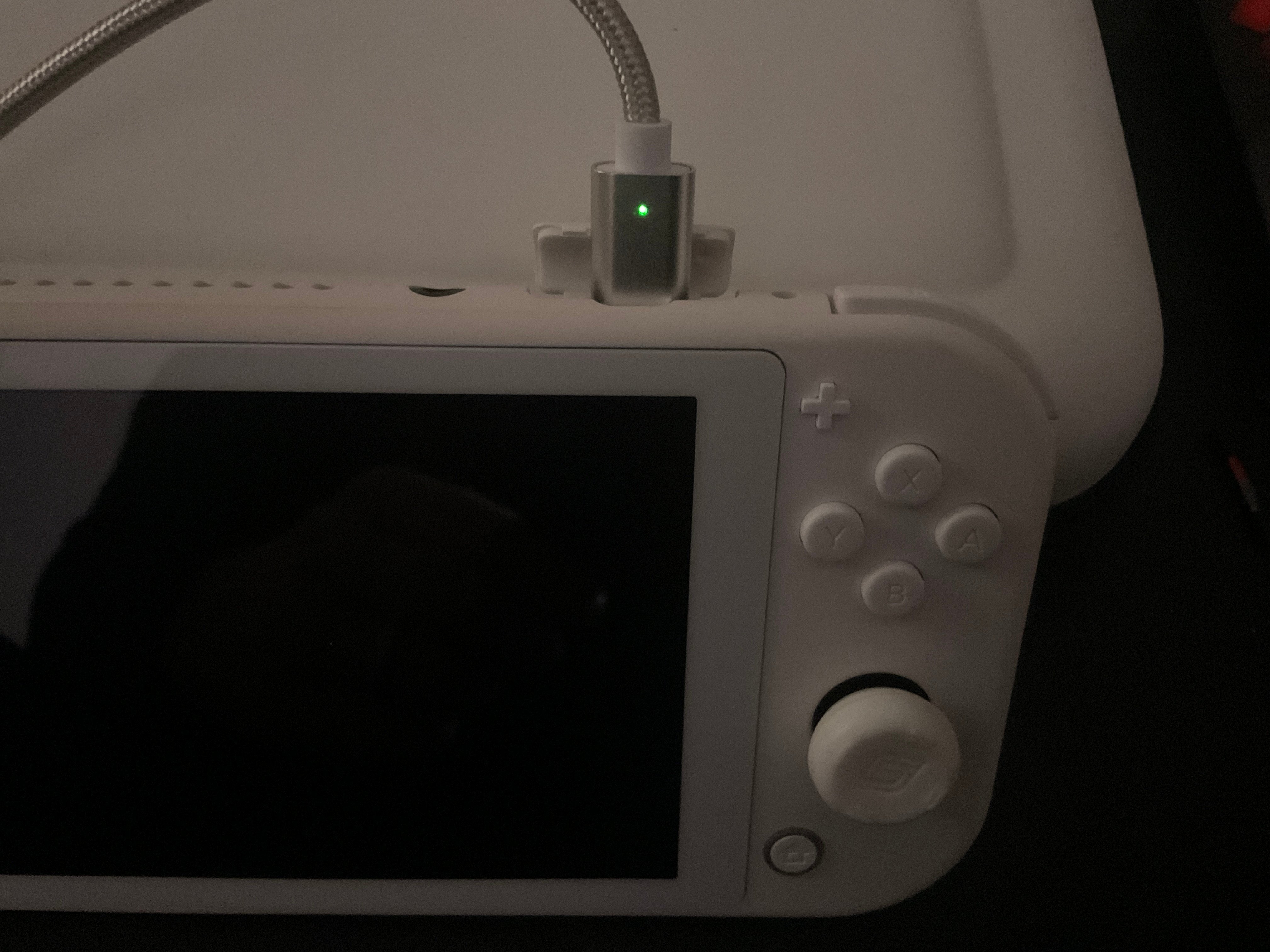

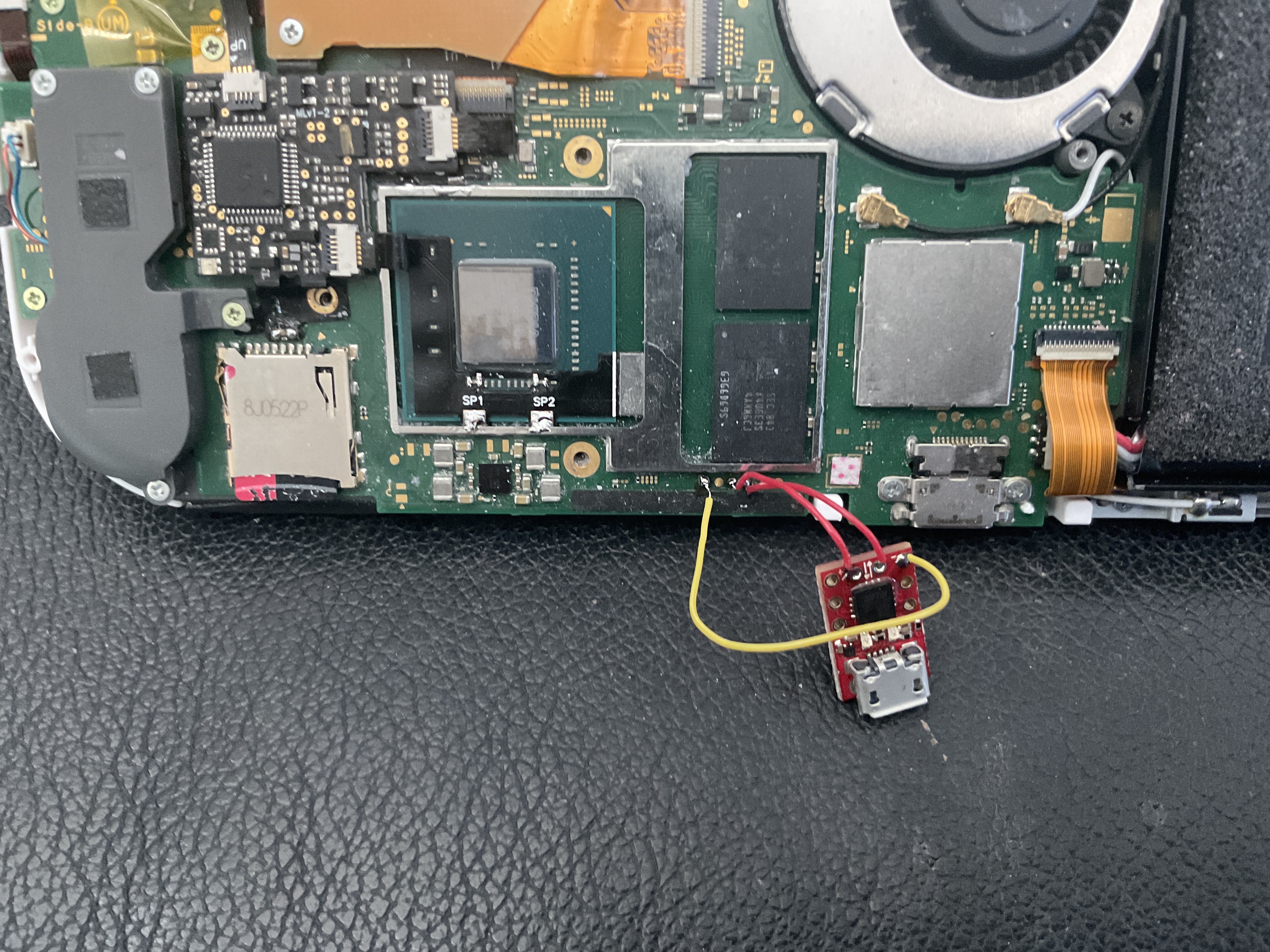

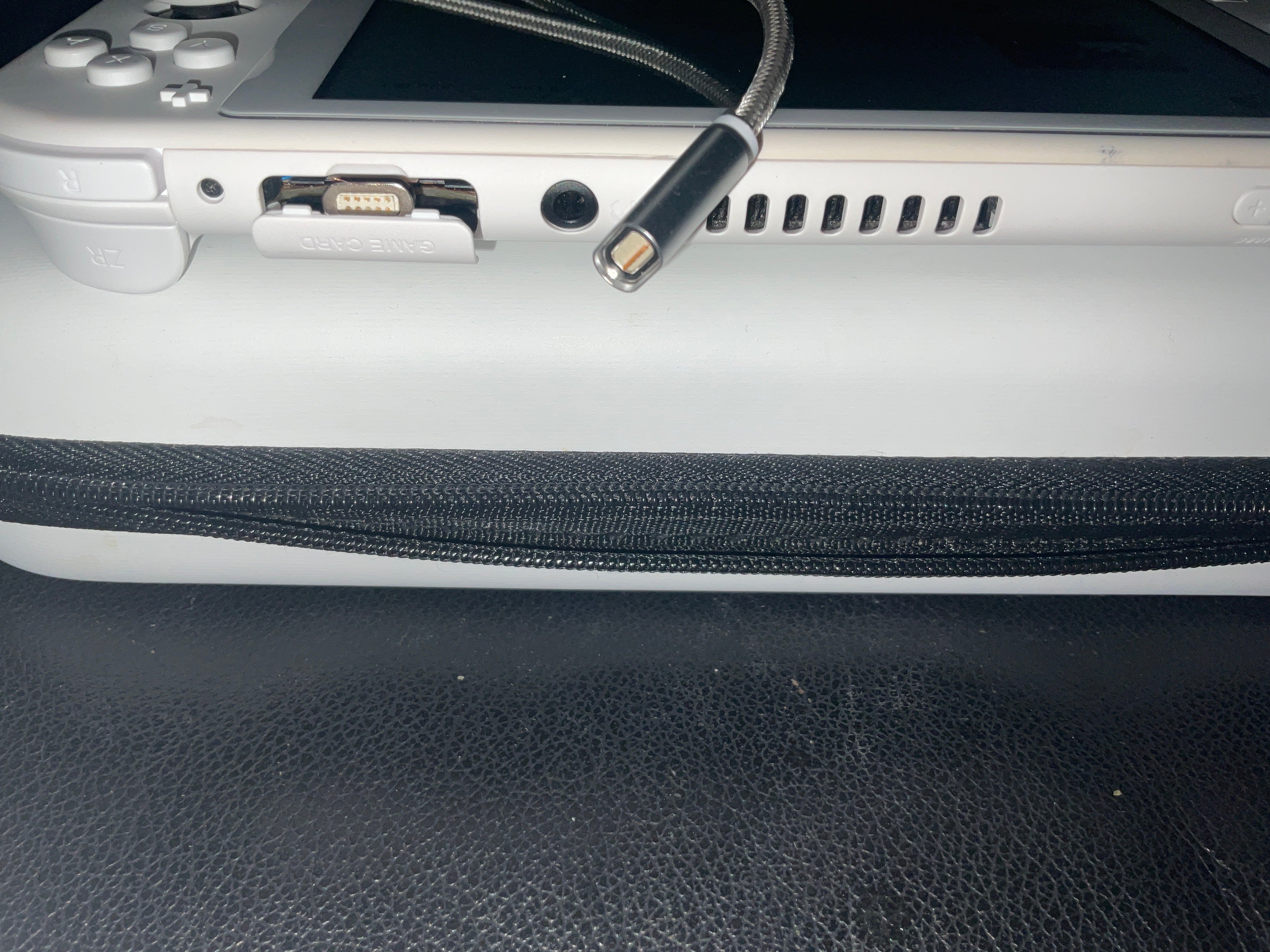

Adding the bits I did for the jim.sh UART
Here’s my final pics of the inside of the Switch Lite. I forgot to hook up a GND wire in the previous pic.
Here’s a cleaned up diagram based on CTCaer’s pic.
Here it is in action!
“It is finished” -Jesus
Full Frontal
Overhead Drone Shot
Oh, you naughty little monkey, you!
Here you go!
Magnets!
With LED!
Instructions for wiring up the UART on a Switch (now including the https://Jim.sh)
https://gbatemp.net/threads/how-to-make-a-joycon-rail-uart-to-capture-boot-log.625784/

Sorry, I meant how much better is the screen compared to the original :)
Indoors, not much difference. Walking around outside it‘s pretty damn cool. I’ve had mine outside twice, once to see the impact of the different angle of light refraction, and another time when I went to a relatives house. There might be times when it’s a little better indoors but I don’t notice it on the daily.
