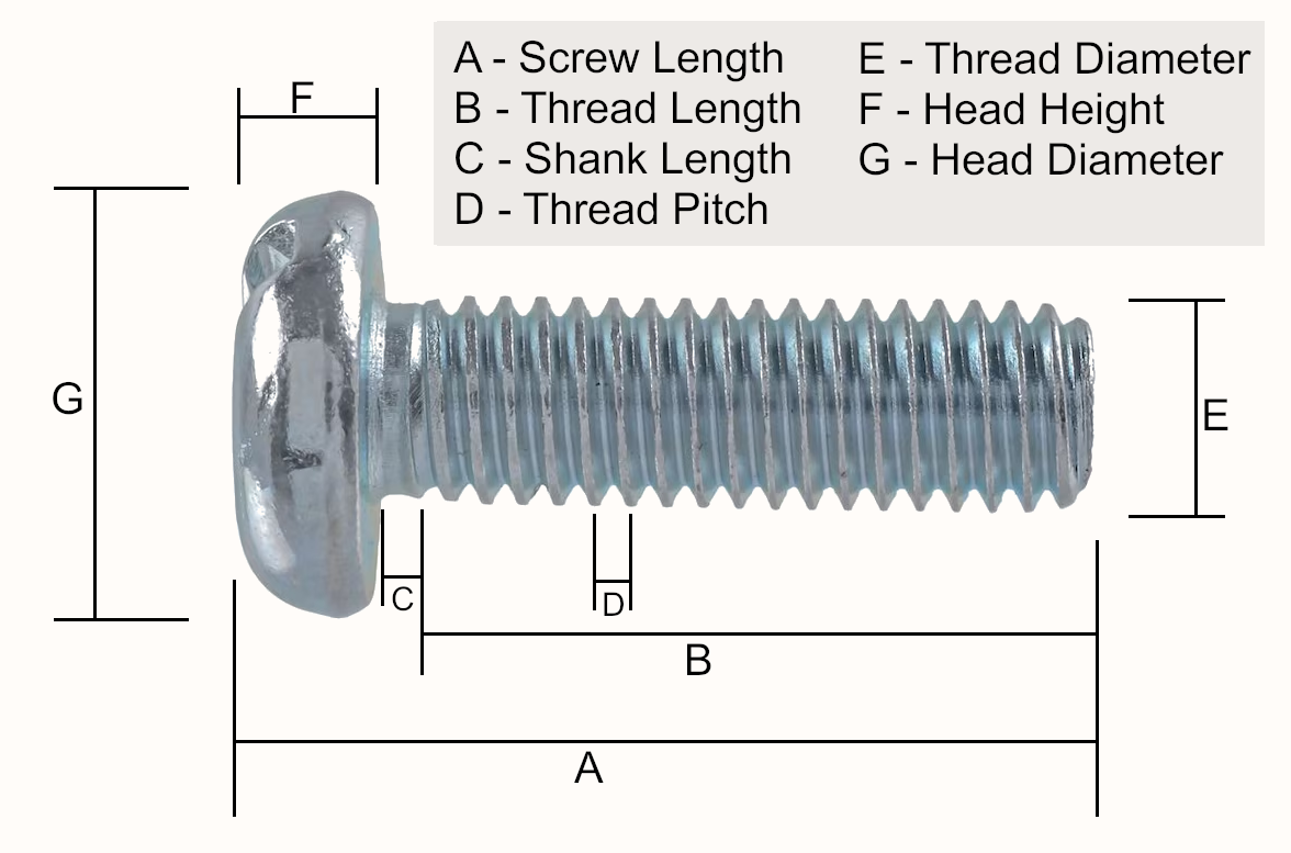

Using a custom chart that I made, I will be using this as a reference to measure each screw with my calipers.
Measurements done with Calipers will only be done on one screw per category, and will be subject to some amount of inaccuracies due to the size of the screws and the tools I have. Measurements like Thread Pitch, Shank Length, Thread Length, and Recess Width are done by eyeballing it with my calipers and a microscope. Measurements like Thread Diameter and Screw Length will be far more accurate as I can physically clamp them in my calipers.

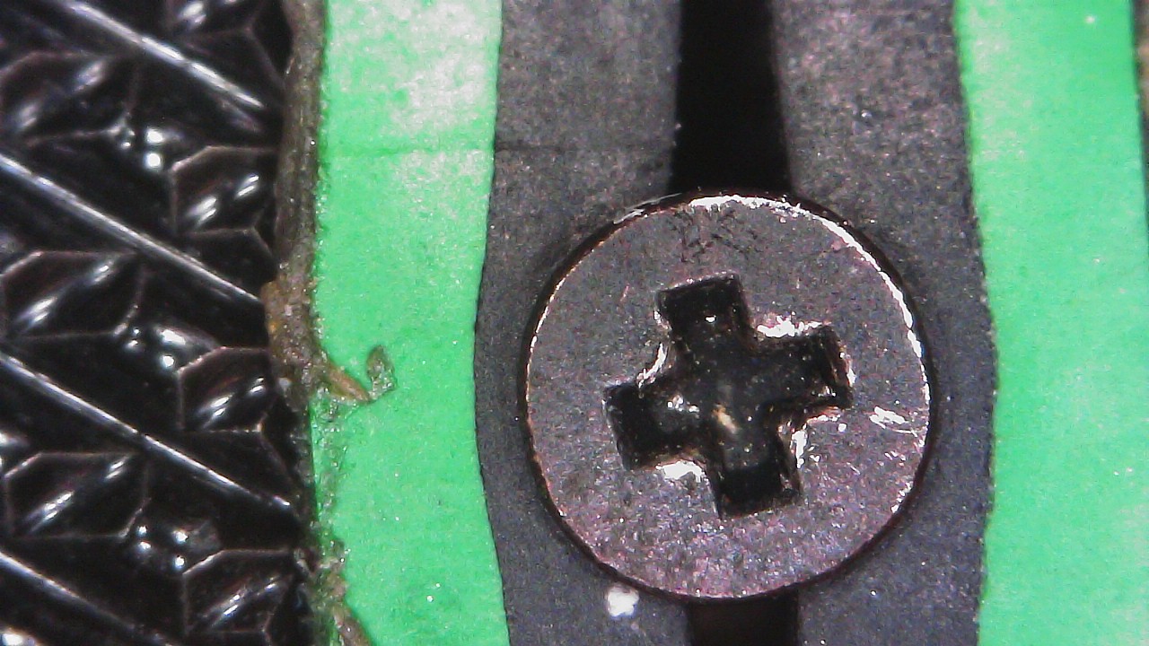

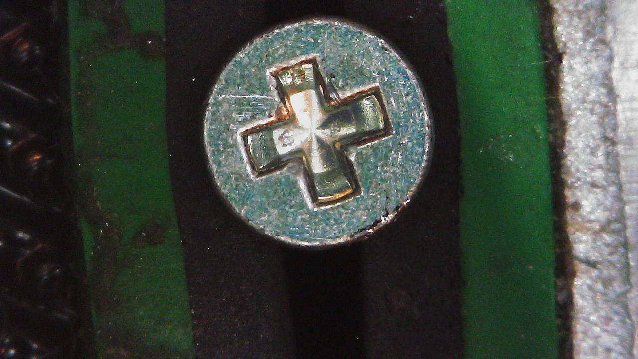

The IFixIt guide I will be referring to for the majority of this post is the LCD Replacement guide. There are some issues with the tools recommended in the guide. The "Parts" section recommends a "Phillips #00", but the steps in the guide recommend "JIS 000 driver or an official iFixit PH 000". Based on the measurements of the recess of the screws, and how my screwdrivers fit into the screws, these screws absolutely are Cross-recess 00.

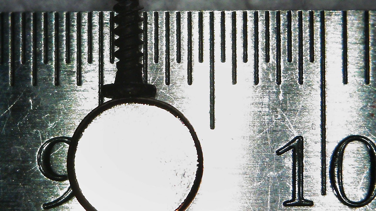

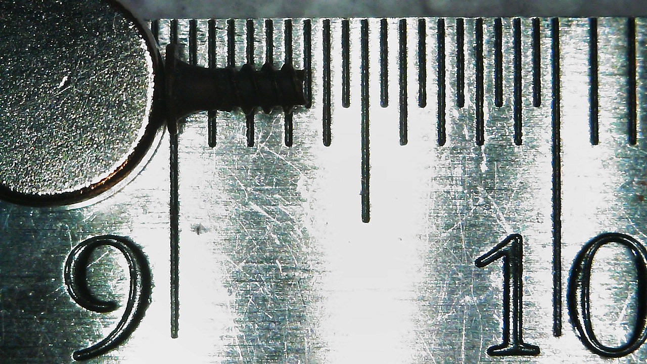

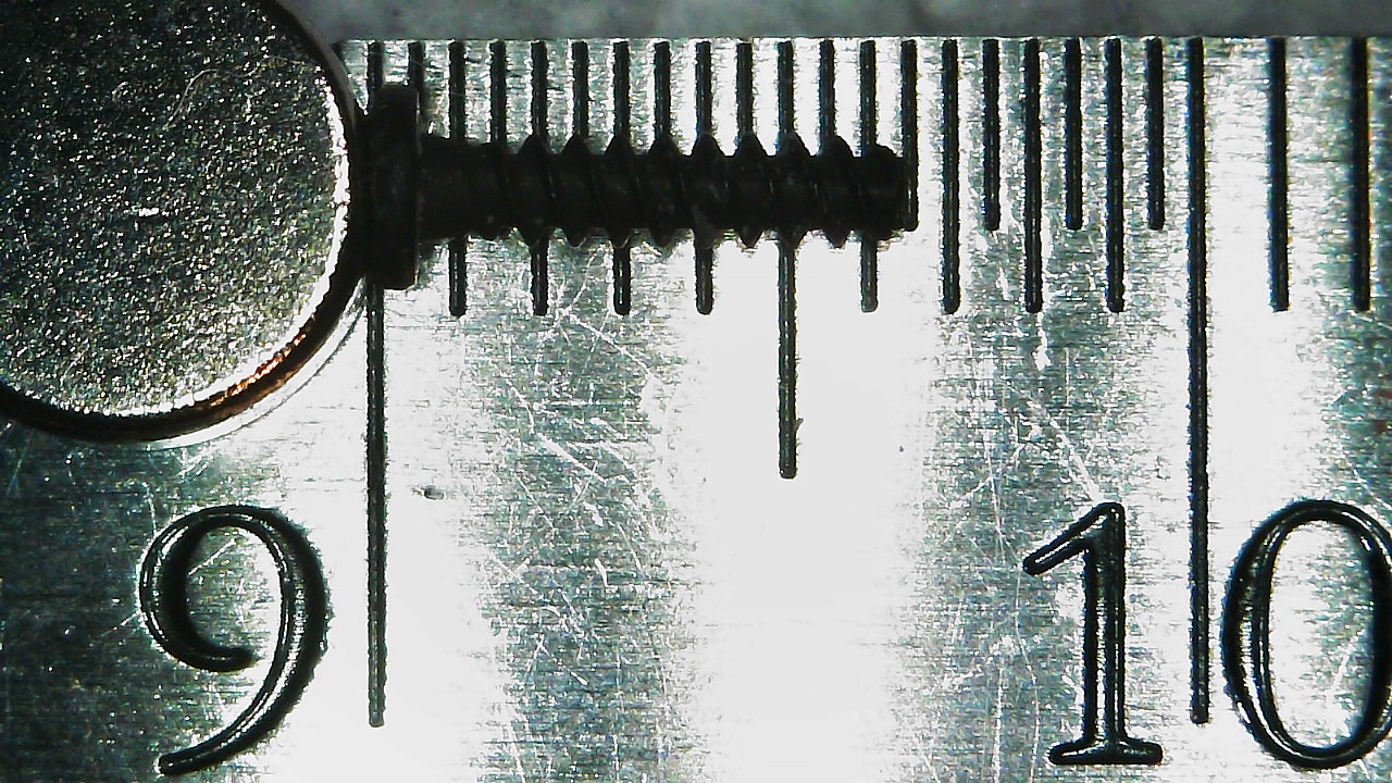

How I Measure Screws.

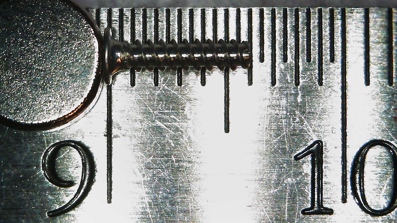

2.50 mm Silver Screw. Coarse Thread. Cross Recess #00
- (1x) Gamecard Slot Cover Screw
- (1x) SD Card Slot Cover Screw
- (3x) Midframe Screw Red (Step 52)
- (3x) Left Speaker Module Housing Screw Red
- (3x) Right Speaker Module Housing Screw Red
Caliper Measurements
- A: 2.56 mm
- B: 1.69 mm
- C: 0.52 mm
- D: 0.44 mm
- E: 1.46 mm
- F: 0.23 mm
- G: 2.42 mm
- Cross Recess: 1.49 mm (#00)

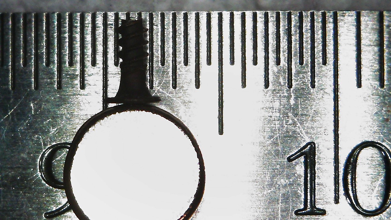

3.00 mm Silver Screw. Machine Thread. Cross Recess #00
- (3x) Shielding Short Red (Step 9)
- (3x) Heat Sink (Step 15)
- (7x) Gamecard Slot and Headphone Jack (Step 18)
- (3x) Motherboard Short Red (Step 32)
- A: 3.06 mm
- B: 1.96 mm
- C: 0.38 mm
- D: 0.17 mm
- E: 1.36 mm
- F: 0.51 mm
- G: 2.48 mm
- Cross Recess: 1.30 mm (#00)

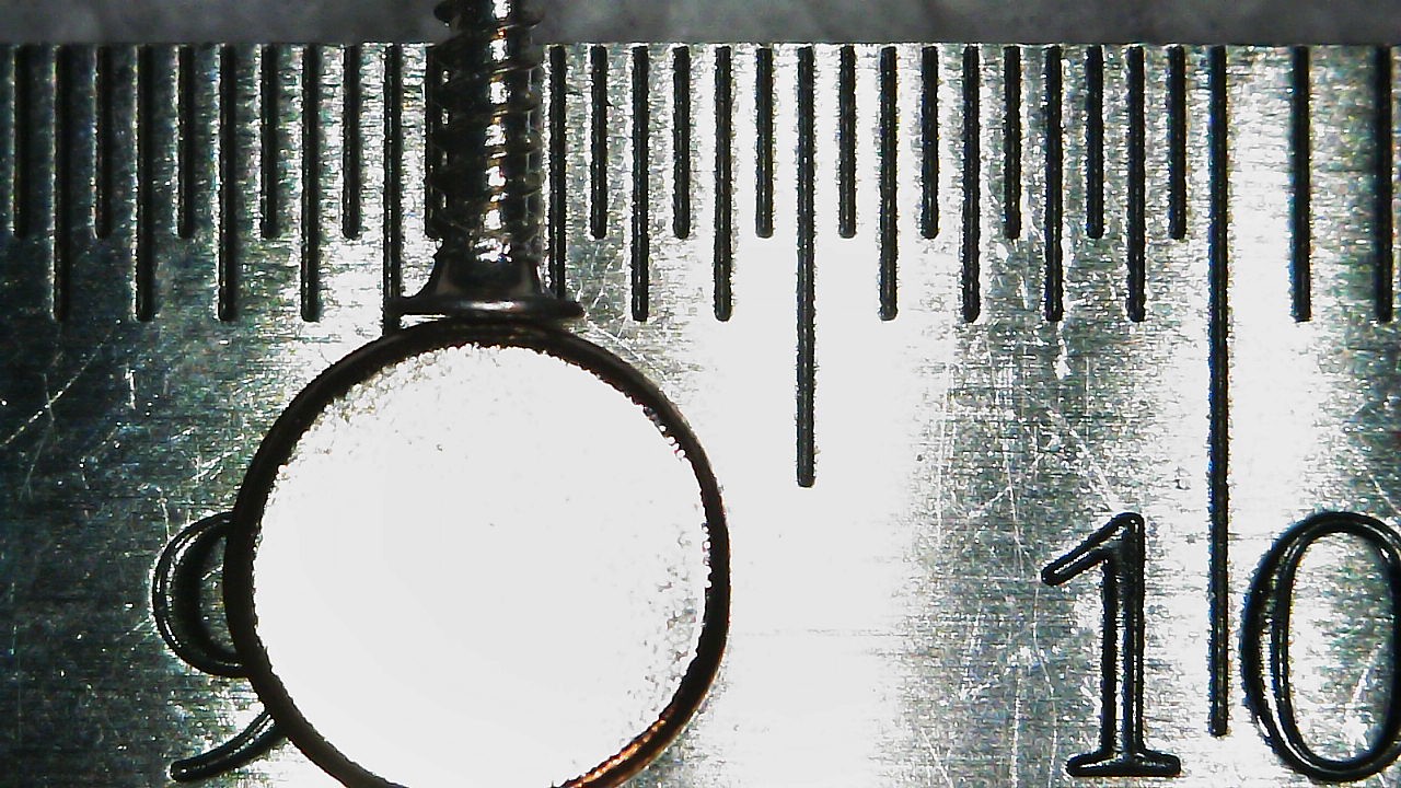

3.50 mm Silver Screw. Coarse Thread. Cross Recess #00
- A: 3.58 mm
- B: 2.75 mm
- C: 0.61 mm
- D: 0.53 mm
- E: 1.39 mm
- F: 0.17 mm
- G: 2.46 mm
- Cross Recess: 1.43 mm (#00)

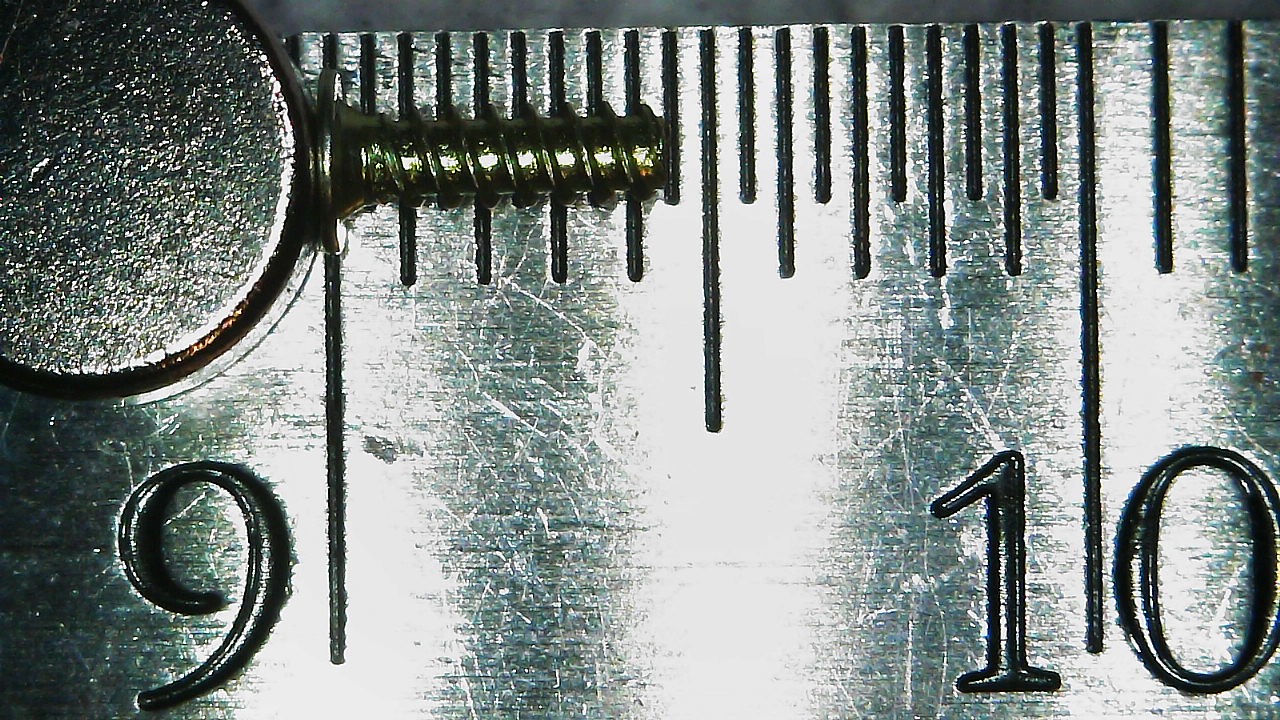

4.50 mm Gold Screw. Coarse Thread. Cross Recess #00
- (1x) Shielding Long Orange (Step 9)
- (2x) Right Shoulder Button (Step 20)
- (3x) Motherboard Long Orange (Step 32)
- (1x) Left Speaker Module Mounting Screw (Step 37)
- (2x) Left Shoulder Button (Step 46)
- (2x) Daughter Board Small Red (Step 48)
- A: 4.54 mm
- B: 3.79 mm
- C: 0.63 mm
- D: 0.41 mm
- E: 1.39 mm
- F: 0.26 mm
- G: 2.46 mm
- Cross Recess: 1.47 mm (#00)

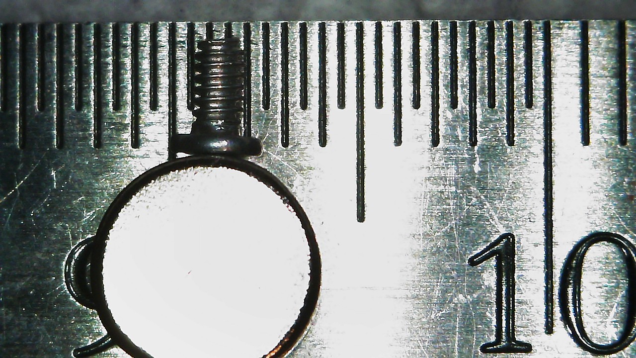

4.80 mm Black Screw. Fine thread. Cross Recess #00
- (3x) Fan mounting screw
- A: 4.83 mm
- B: 1.52 mm
- C: 2.67 mm
- D: 0.24 mm
- E: 1.34 mm
- Shank Diameter: 2.47 mm
- F: 0.41 mm
- G: 3.77 mm
- Cross Recess: 1.55 mm (#00)

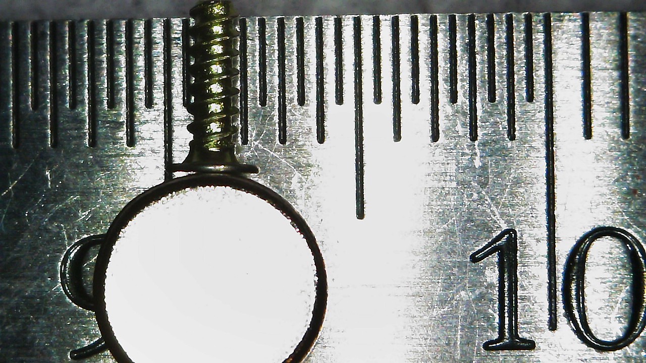

6.00 mm Silver Screw. Coarse Thread. Cross Recess #00
- A: 6.12 mm
- B: 4.83 mm
- C: 0.46 mm
- D: 0.40 mm
- E: 1.39 mm
- F: 0.25 mm
- G: 2.45 mm

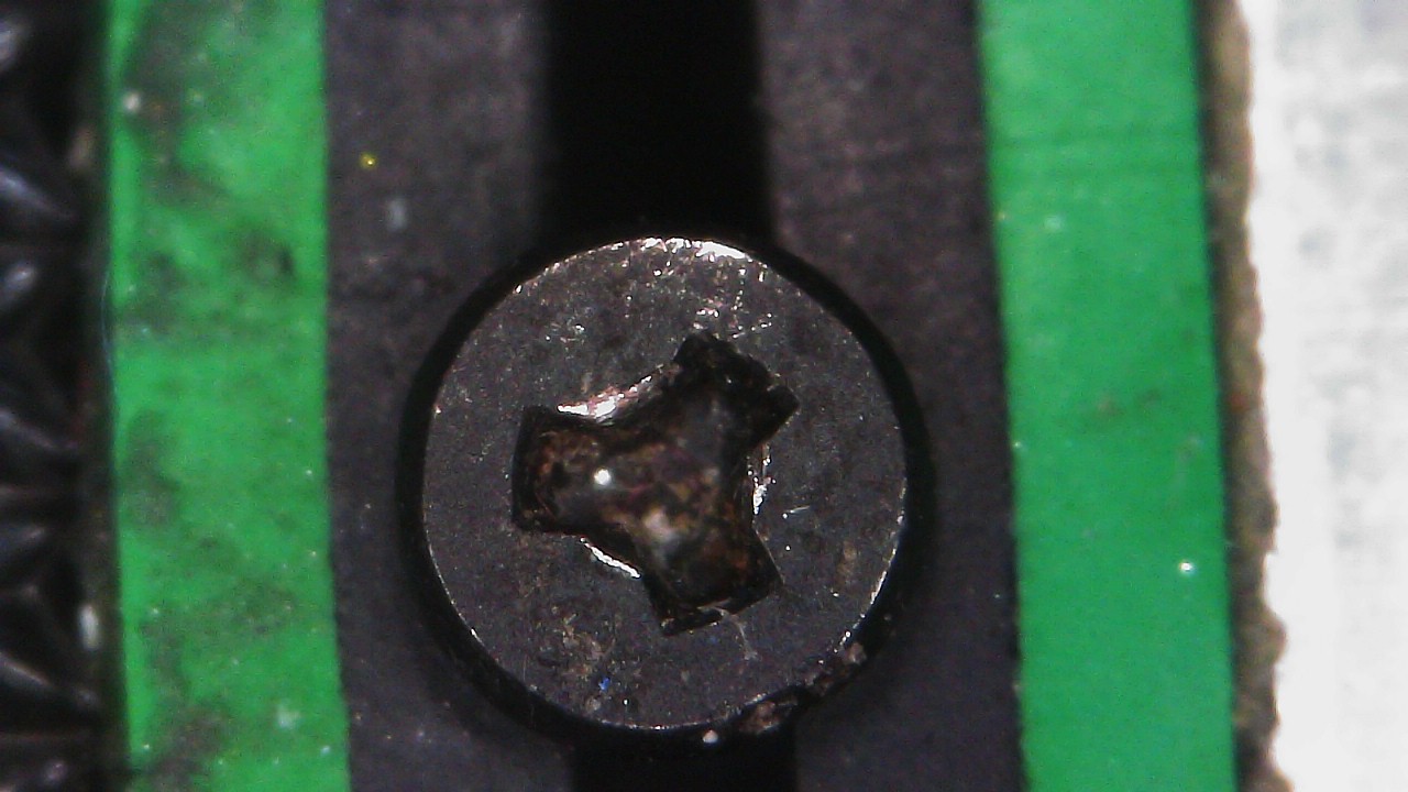

6.50 mm Black Screw. Coarse Thread. Y-Type 00/2.0
- A: 6.45 mm
- B: 5.15 mm
- C: 0.68 mm
- D: 0.37 mm
- E: 1.40 mm
- F: 0.57 mm
- G: 2.46 mm
- Y Recess: 1.31mm

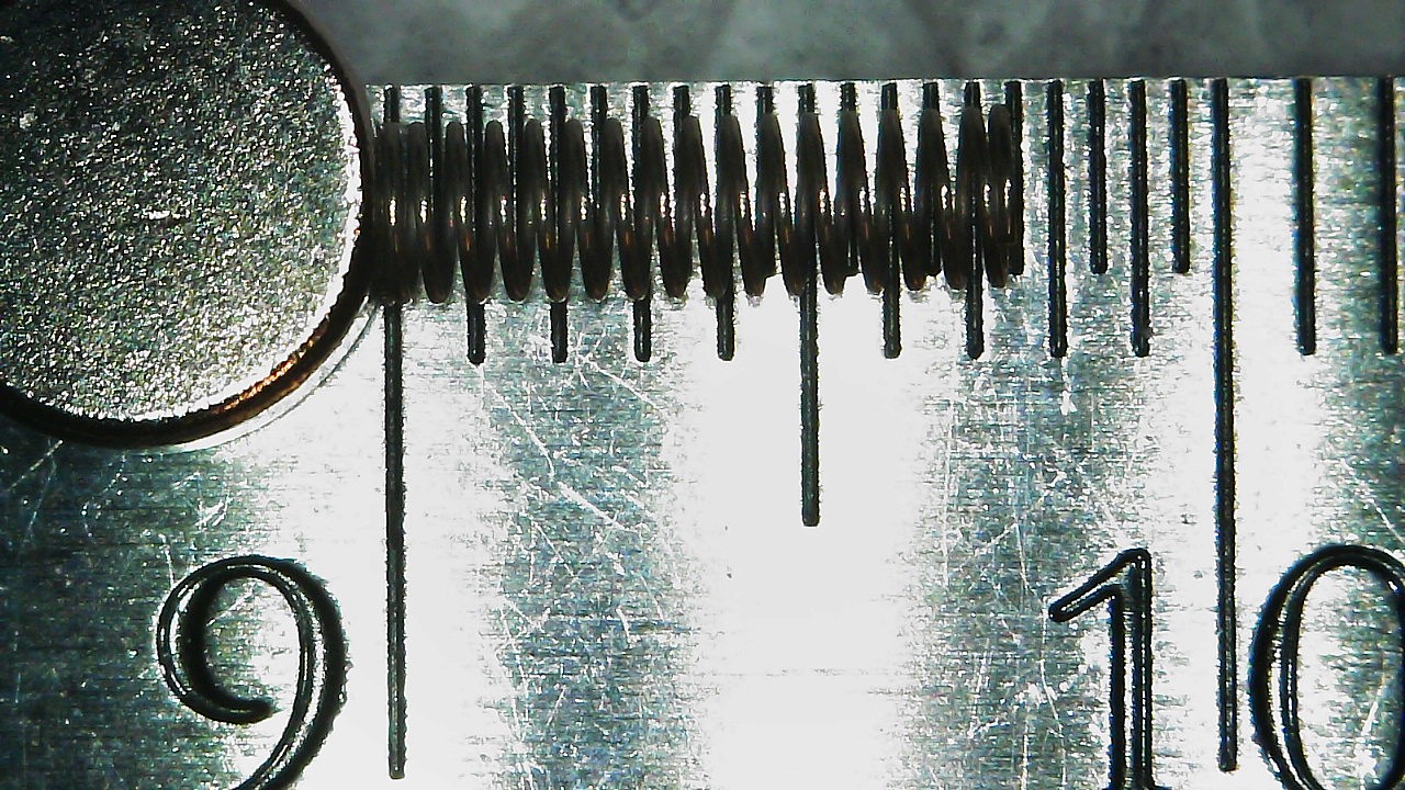

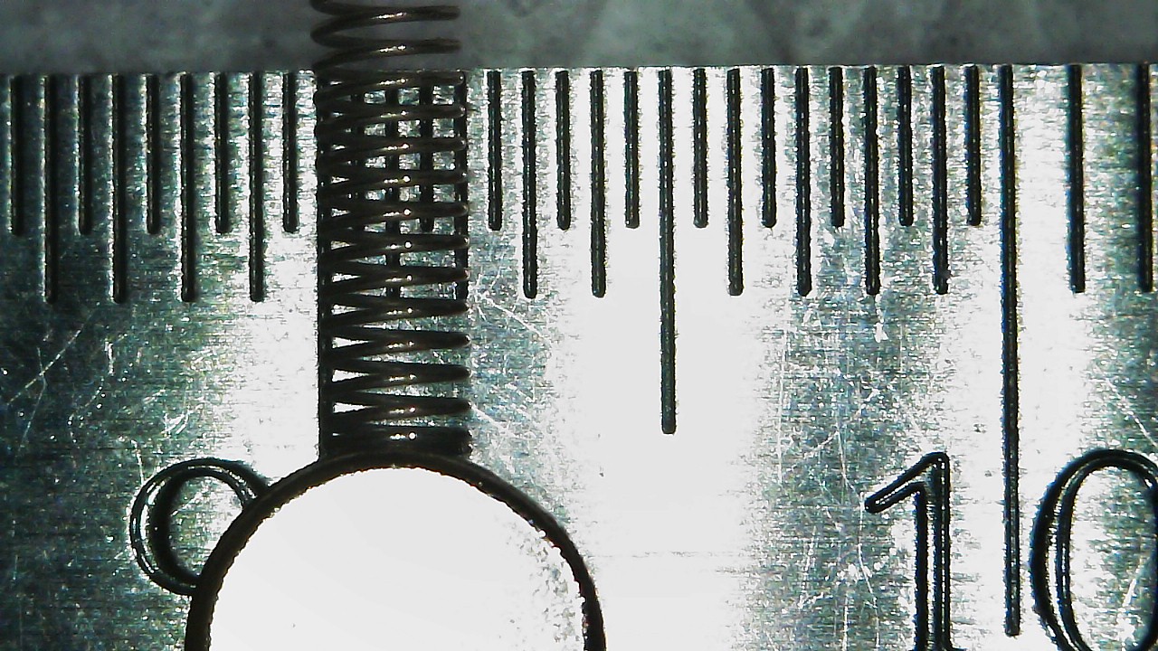

Shoulder Button Springs.
- Length: 7.13 mm
- Diameter: 2.18 mm
