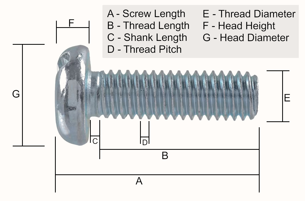

How I Measure Screws.​
Using a custom chart that I made, I will be using this as a reference to measure each screw with my calipers.
Measurements done with Calipers will only be done on one screw per category, and will be subject to some amount of inaccuracies due to the size of the screws and the tools I have. Measurements like Thread Pitch, Shank Length, Thread Length, and Recess Width are done by eyeballing it with my calipers and a microscope. Measurements like Thread Diameter and Screw Length will be far more accurate as I can physically clamp them in my calipers.

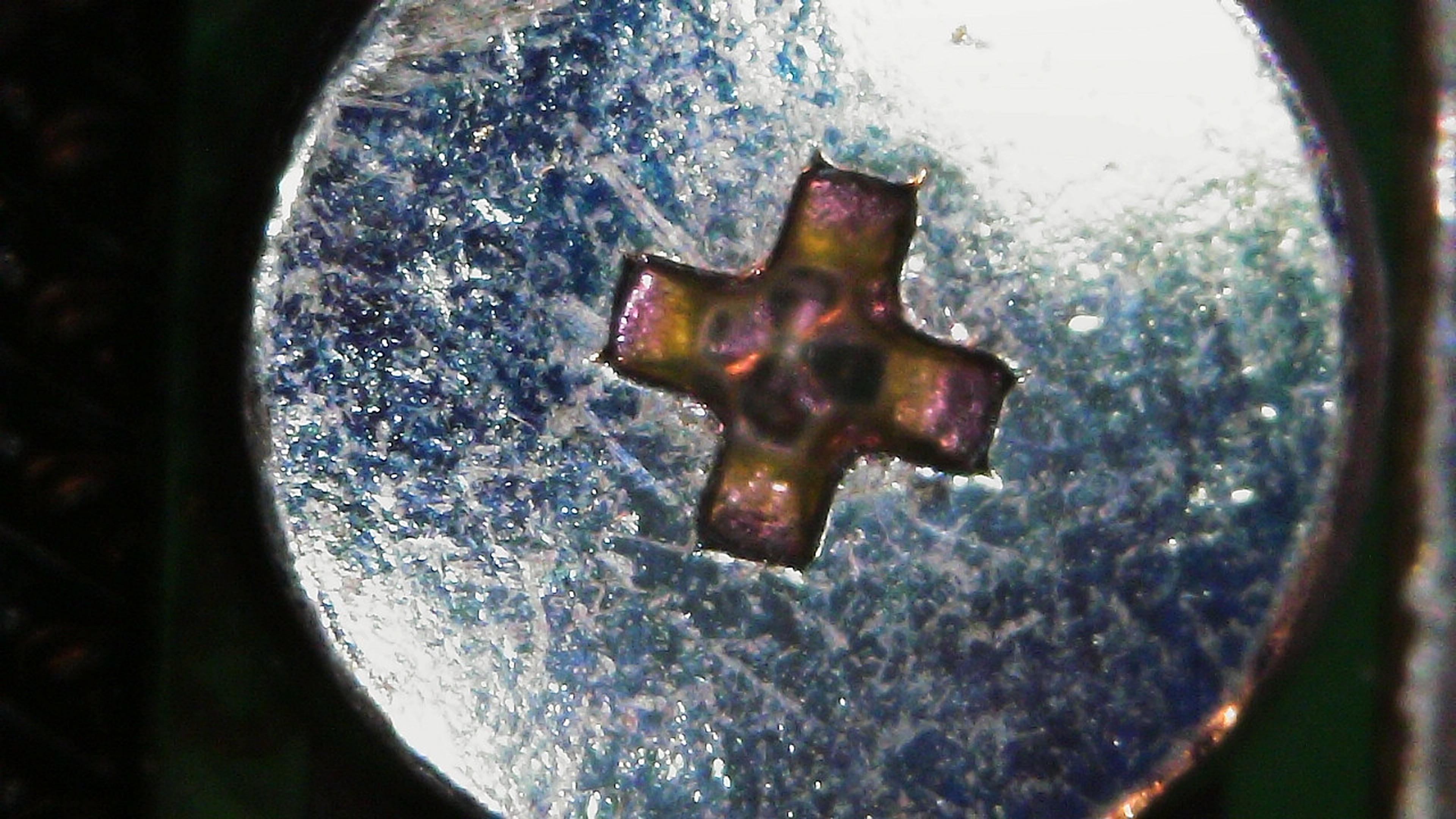

M2.5 – 3.65 mm Black Machine Screws. Cross Recess #0​
  • (4x) Disk Drive Mounting Screw. (Step 9)
Caliper Measurements​
  • A: 3.68 mm
  • B: 2.23 mm
  • C: 0.39 mm
  • D: 0.42 mm
  • E: 2.54 mm
  • F: 0.70 mm
  • G: 3.94 mm
  • X Recess: 2.02 mm

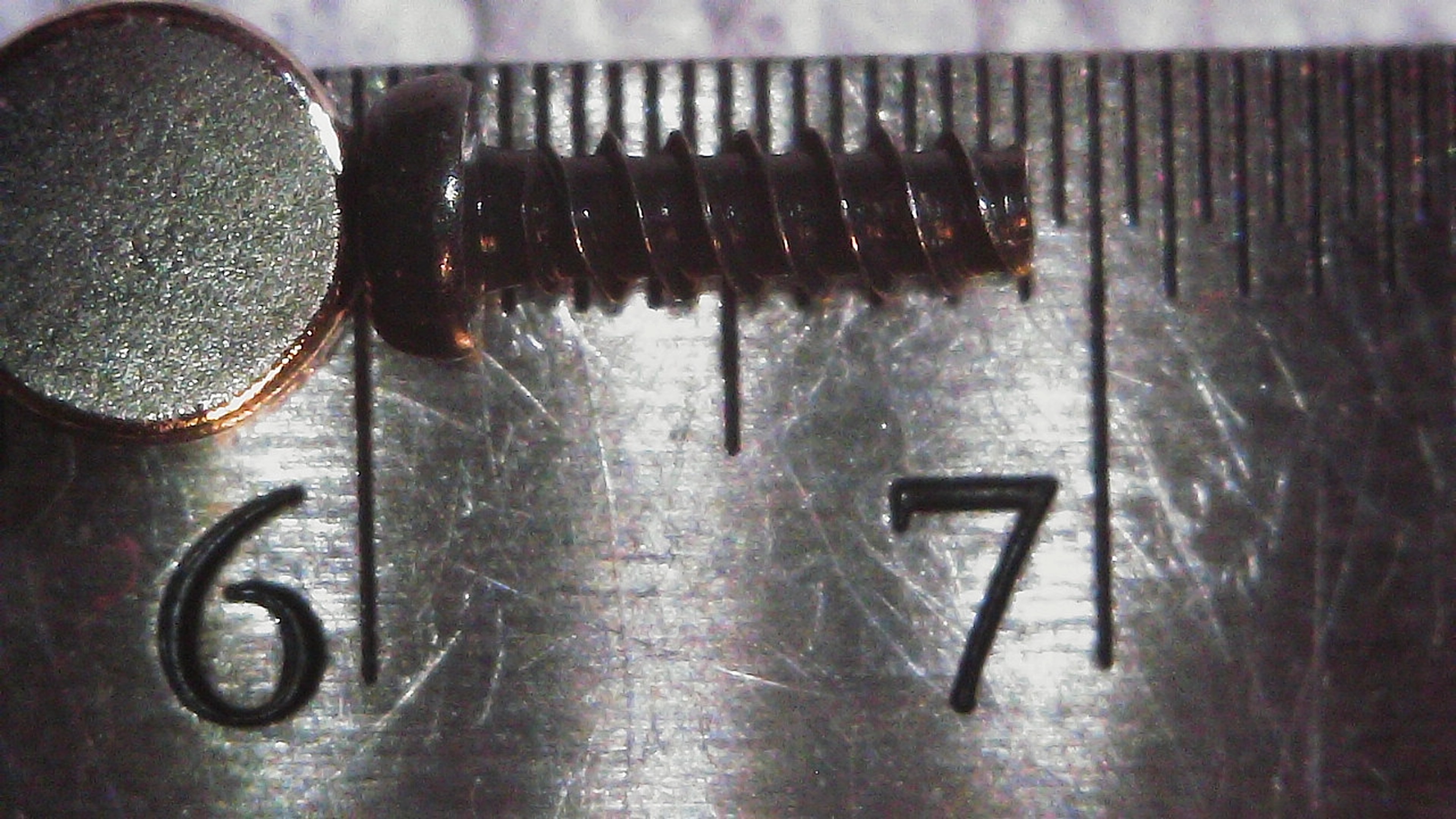

M2.0 – 4.75 mm Black Machine Screws. Cross Recess #1​
  • (2x) Front Panel Mounting Screws (Step 6)
  • A: 4.71 mm
  • B: 2.39 mm
  • C: 0.53 mm
  • D: 0.34 mm
  • E: 1.92 mm
  • F: 1.55 mm
  • G: 4.80 mm
  • X Recess: 2.49 mm

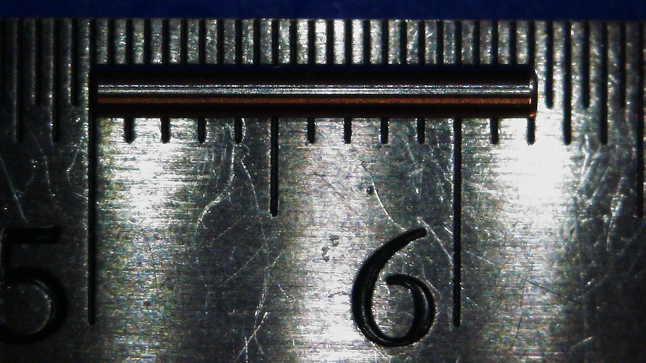

M2.5 – 5mm Gold Machine Thread Screw. Cross Recess #1​
  • (1x) Upper Housing Metal Shielding Gold Screws
  • (1x) Outer Housing Vent Screw Short (Step 2)
  • A: 5.04 mm
  • B: 3.42 mm
  • C: 0.55 mm
  • D: 0.25 mm
  • E: 2.54 mm
  • F: 0.72 mm
  • G: 3.94 mm
  • X Recess: 2.53 mm
12.5mm Spring.​
  • (1x) Right Disk Roller Spring. 034.ND
  • Length: 12.52 mm
  • Diameter: 6.88 mm
12mm Shaft.​
  • (1x) Ejection Belt Gear Shaft.
  • Length: 12.15 mm
  • Diameter: 1.50 mm
