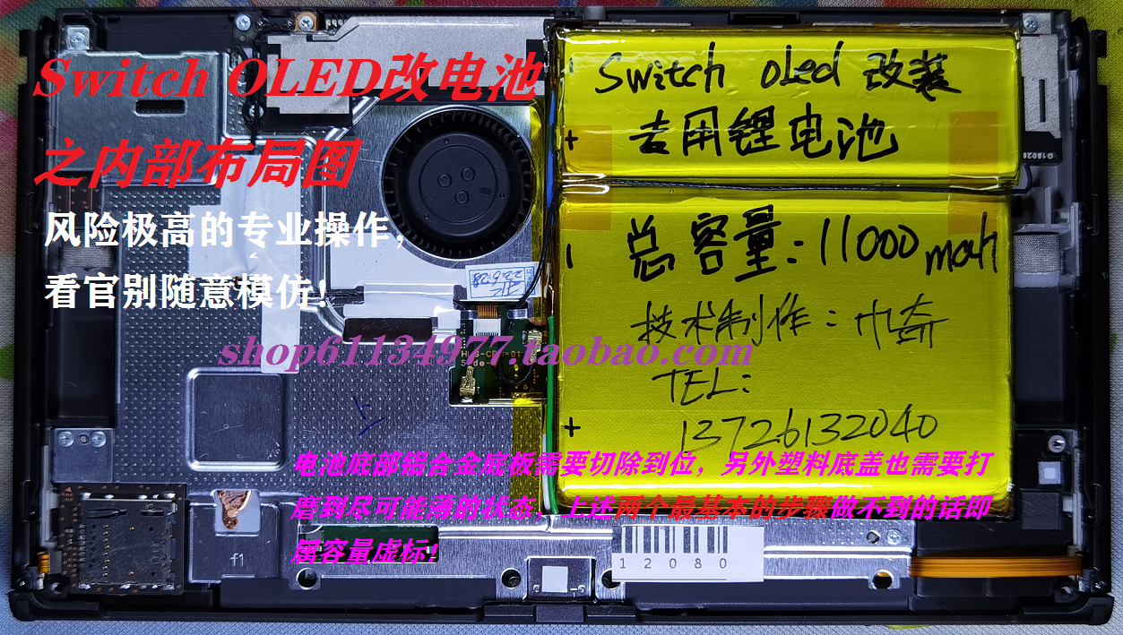

But wait I found something more interesting here from a modshop on taobao:
Seems like they will cut through the mid-frame and put the battery right against the lcd screen. They will also dremel down the back cover so they can fit a thicker battery inside. Pretty wild stuff but damn a 11000mah battery that's almost 3 times the original capacity. Wonder what's the battery's model and I might try it myself..
OMG
I'm banning you from my thread. Every time I follow you down a rabbit hole I fall down and get hurt and it takes me months to recover!
You play too rough, man!
(I do have a dremel though...going to translate to English and see if they have more clues about the sizing.)

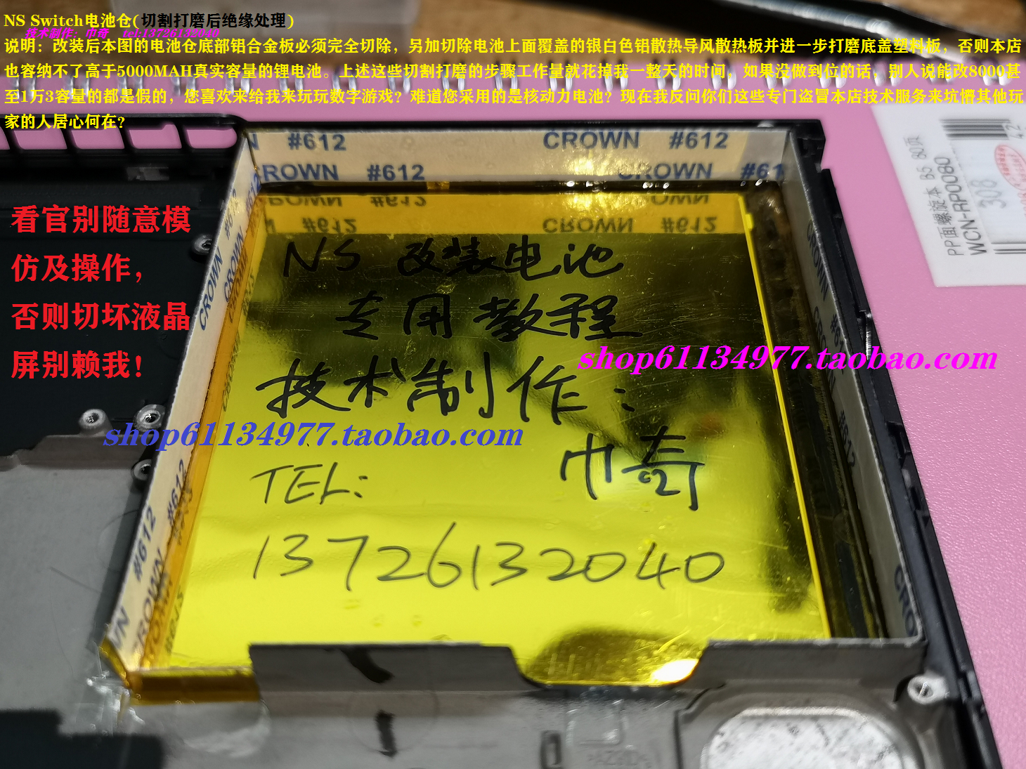

Yeah I think this battery mod is a bit too crazy.. Anyway just something I saw on taobao when searching for a better battery for my switch.
Here's the original link with more details and google translated. Didn't bother to translate the picture but I think they just mean you need to remove a lot of internal components. Also I think they mentioned it's a custom-made battery in the text. Btw they don't sell the battery alone, the link is for their mod service.
https://item-taobao-com.translate.g...l=auto&_x_tr_tl=en&_x_tr_hl=en&_x_tr_pto=wapp

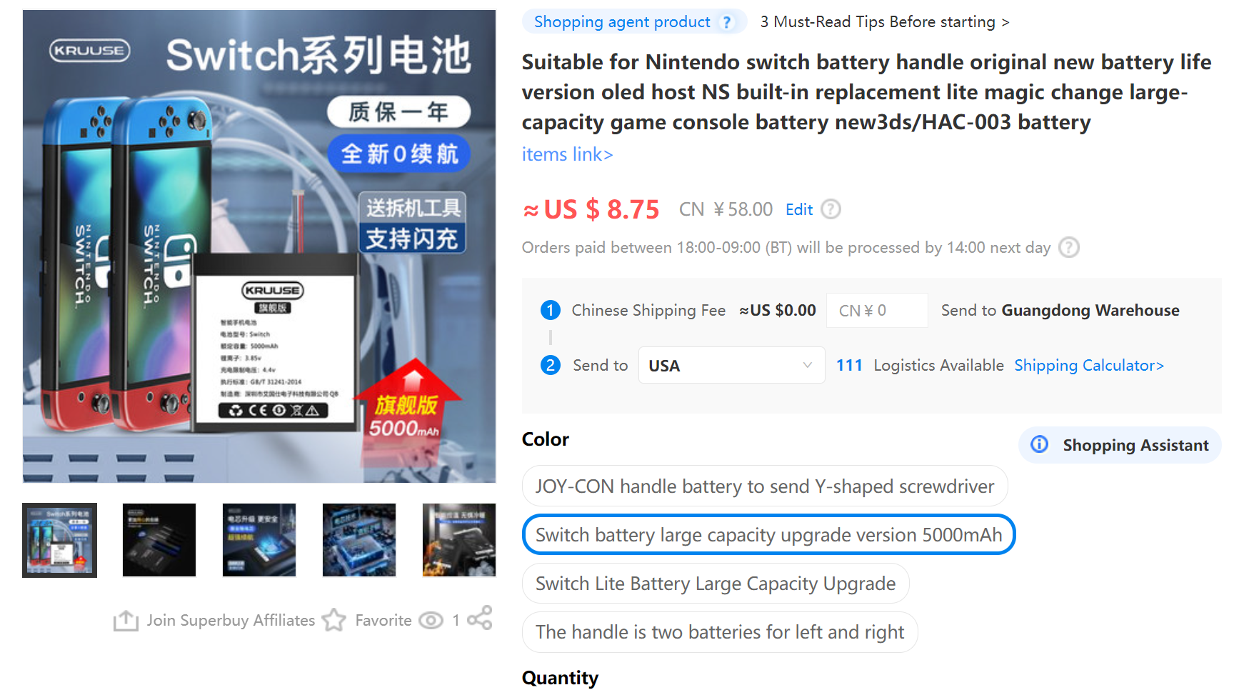

I also tried to get the 5000mah drop-in aftermarket battery but seems like I can't find a package forwarder that accepts lithium batteries.. If you can find a forwarder that accepts batteries here's the link:
https://www.superbuy.com/en/page/bu...s://detail.tmall.com/item.htm?id=680810688153
https://www.superbuy.com/en/page/buy/?nTag=Home-search&from=search-input&_search=url&position=&url=https://detail.tmall.com/item.htm?id=680810688153

It does look like two batteries, a long thin one up top and a more square one In the normal position. I‘m thinking this is OLED specific plans and I’m still on the older models.
Wait…I see now…these are different mods for different models.

I heard the specs on the 5K battery were exaggerated but for $10 it’s worth finding out for sure!
I kinda wanna try a drop in before I start hacking up a mid-frame and making potential LiPo bombs inside my console.

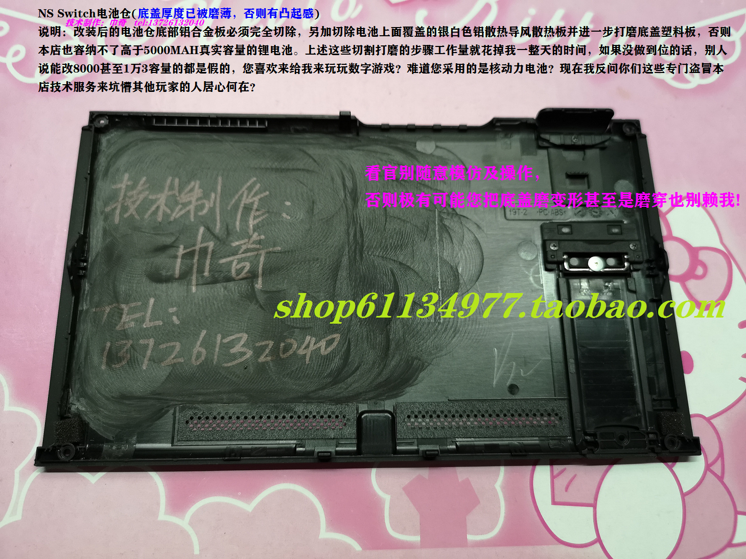

Latest update on the battery upgrade saga…
I have a friend’s Switch at my house for some minor upgrades and while we were tearing it down he said it was OK for me to tear up his mid frame as an experiment as long as I rather expand his batteries or give him mine after we’re done. Deal! Let’s go!
I took some measurements of a V1 Erista battery bay. I believe it will be the same for V2 since they use the same battery. OLED and Lite use different specs and since I have neither, none of this will apply to them.
L=76.99
W=71.69
H=6.91 (*8.01)
* I plan on cutting out the bottom of the battery bay giving me the extra space down to the back of the screen for extra depth. The additional 1.10mm give me a total of 8.01 to play with.
