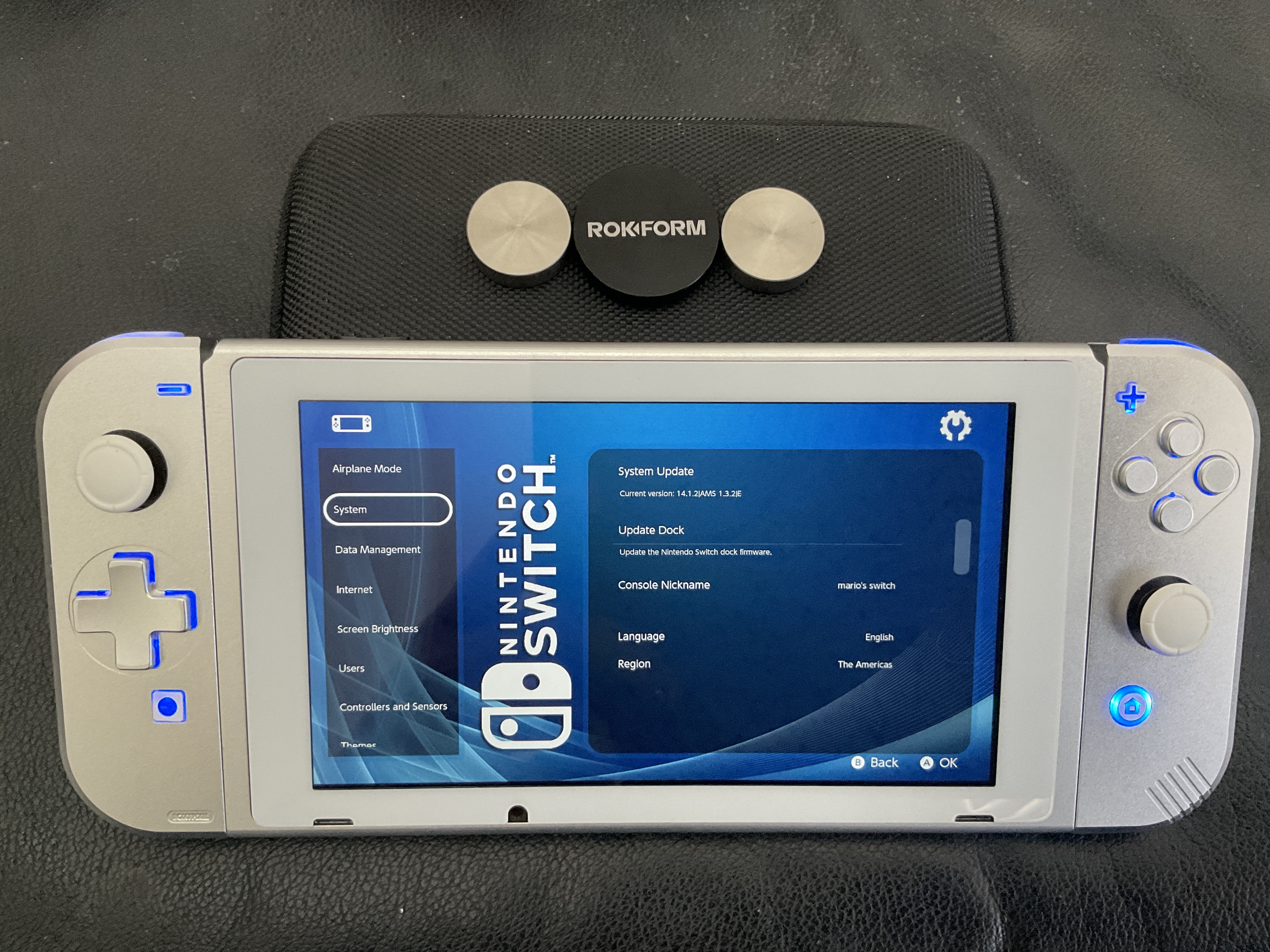

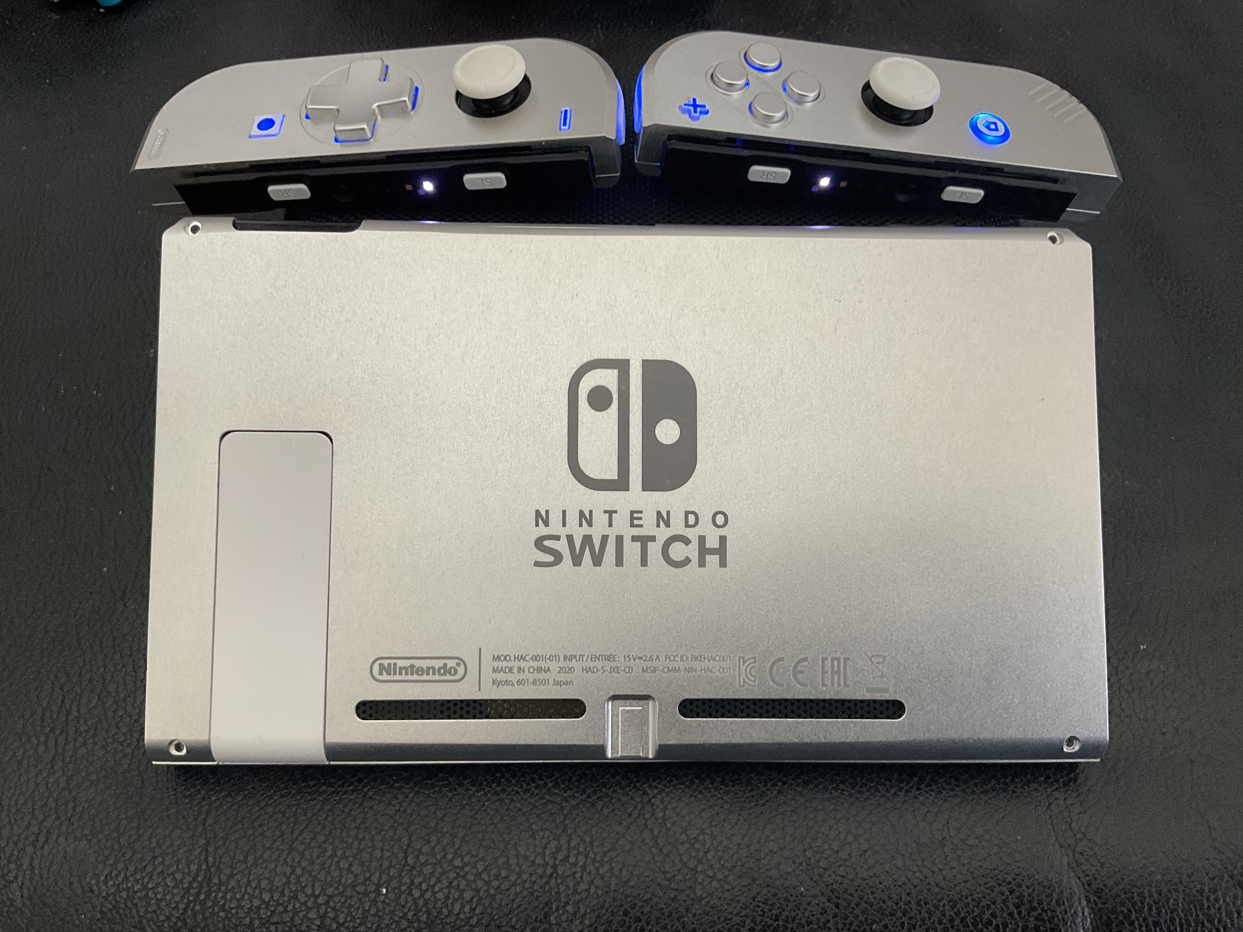

Whew…at long last I’m finally done! what a journey!
I jacked up my original board trying to notch a pass through for my Trinket M0 wires to get from the front to the back. Long story short, multi-layered boards do NOT like this.
Bought a donor board off eBay to swap out the battery circuit components that I undoubtedly fried in the “notching” process…ended up letting the smoke out of that one by simply plugging it in to the battery. Not sure if my fault or the board was bad to begin with since it was parts-only.
Finally broke down and bought a Fair Condition V1 off eBay and swapped out all the guts.
Here’s what’s new:
  • all aluminum shell (front and back)
  • Replaced all screen components with one piece digitizer/LCD
  • Reed switch (magnetic) Trinket reset “button” (aluminum doesn’t flex, yo!)
  • upgraded the fan
  • new thermal paste and thermal pads...everywhere!
  • boxy pixel aluminum joycons
aluminum dpad and abxy buttons​
metal slide locks​
new thumb sticks (white)​
  • Extremerate stuff (all together so this doesn’t look like an advertisement)
illuminated trigger buttons (white)​
firefly kit (white)​
screen protector (with white border)​
Overall, impressions, everything has a bit more heft to it. Feels very nice in the hands. The look is just out of this world!
All that said it now feels a bit like a museum pice. I’m scared I’ll scratch it. It’s made of metal but i feel like I’m going to break it because I know the bodges I put in to make it all work. I’m always hyper-critical of my own work and every little bulge or .25mm gap drives me nuts. The kickstand pops off a little too easy for my tastes. I had to replace the internal button on one of the triggers and it’s way clicker than all the other buttons now. The aluminum buttons are a bit wobbly (going to try the double sided tape fix). I liked it when it was all Ninty’s fault. Now all issues are mine alone! I know I’ll get over it with time.
Bottom Line: Would I do it again? Hells yes!
Anyway, without further ado, here’s some glamour shots of the finished product!
(circular magnets are to trigger the reset switch on the Trinket)
(the white knight rider lights are nuanced...nobody is ever going to see them but me.)

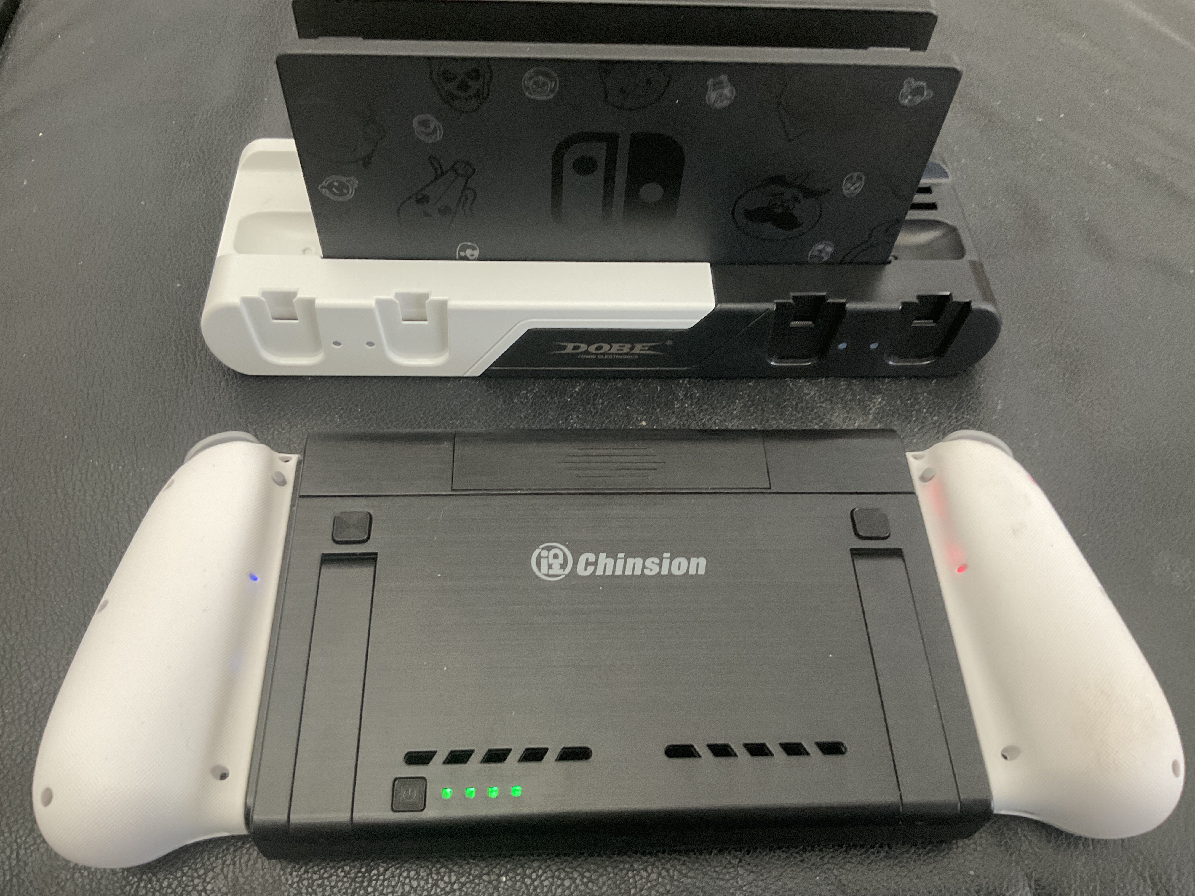

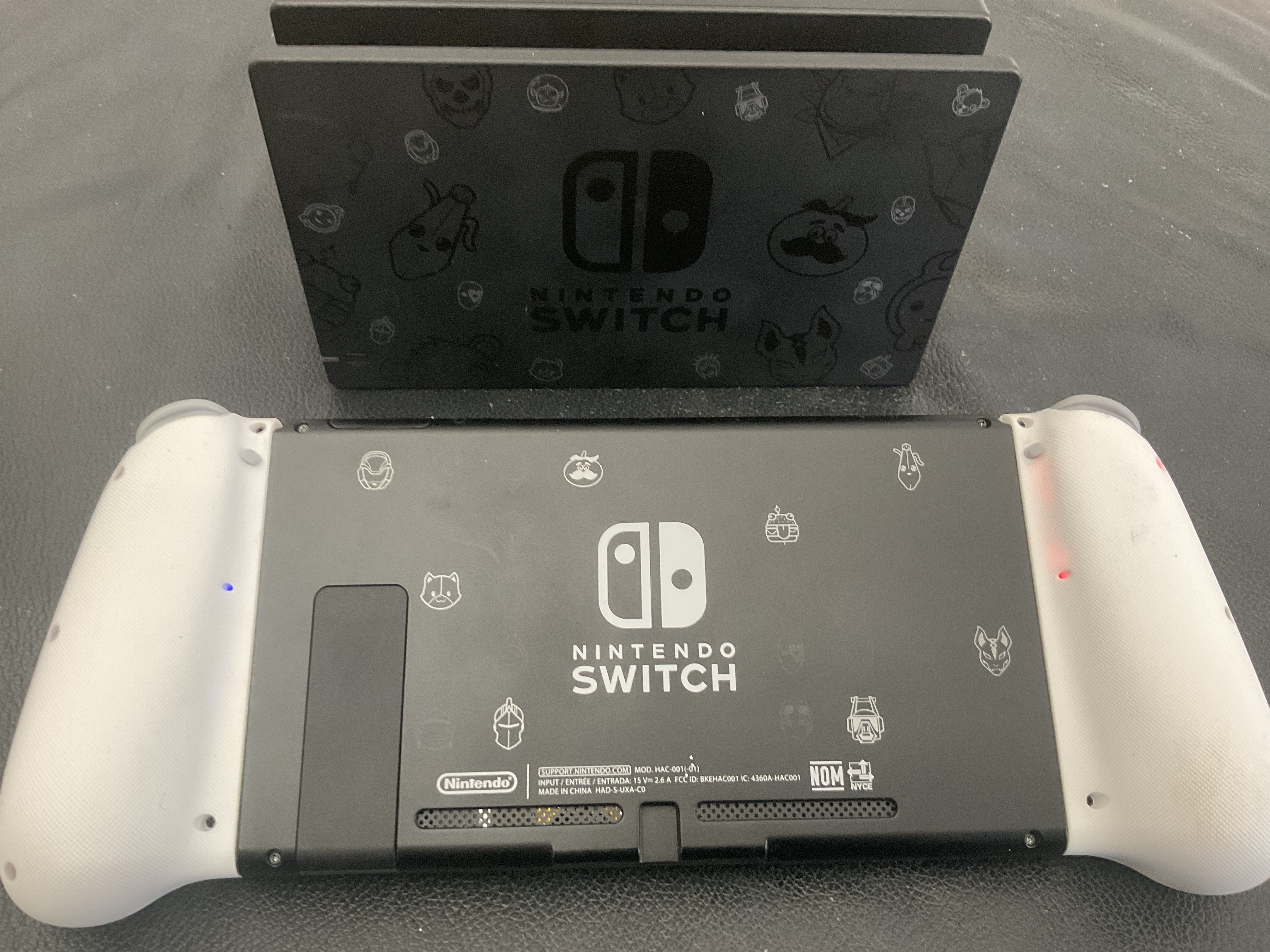

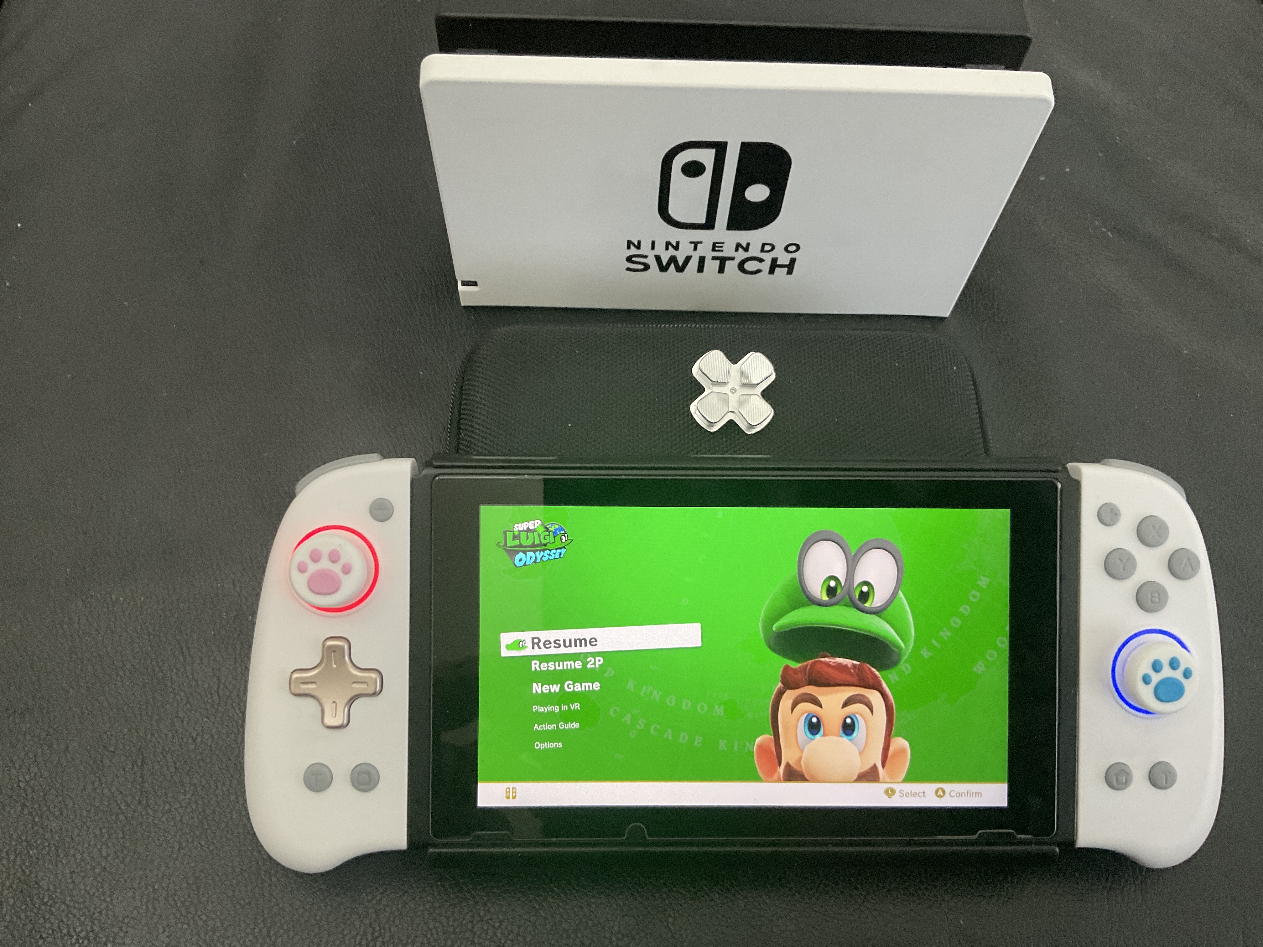

side project: while my V1 system was down I bought a cheap V2 and chipped it. HWFLY prices are <$80 on aliexpress now so timing was right. This project was super easy in comparison. I was probably being more careful and making fewer mistakes. Almost everything is second hand off eBay or slow boated in from Aliexpress so while it looks like a lot, it really wasn’t.
Here she is in all her glory:
white binbok slim controllers
white dock is just an aliexpress faceplate.
was going to swap out the dpad with the aluminum PlayStation one but binbok changed their sizing. :-(
Fortnite Edition underneath…
10000mAh battery extender that‘s too fat to work with the dock mounted joycon charger which also doesn’t fit the binbok joycons.
(Custom mods are hard to get right ya’ll)

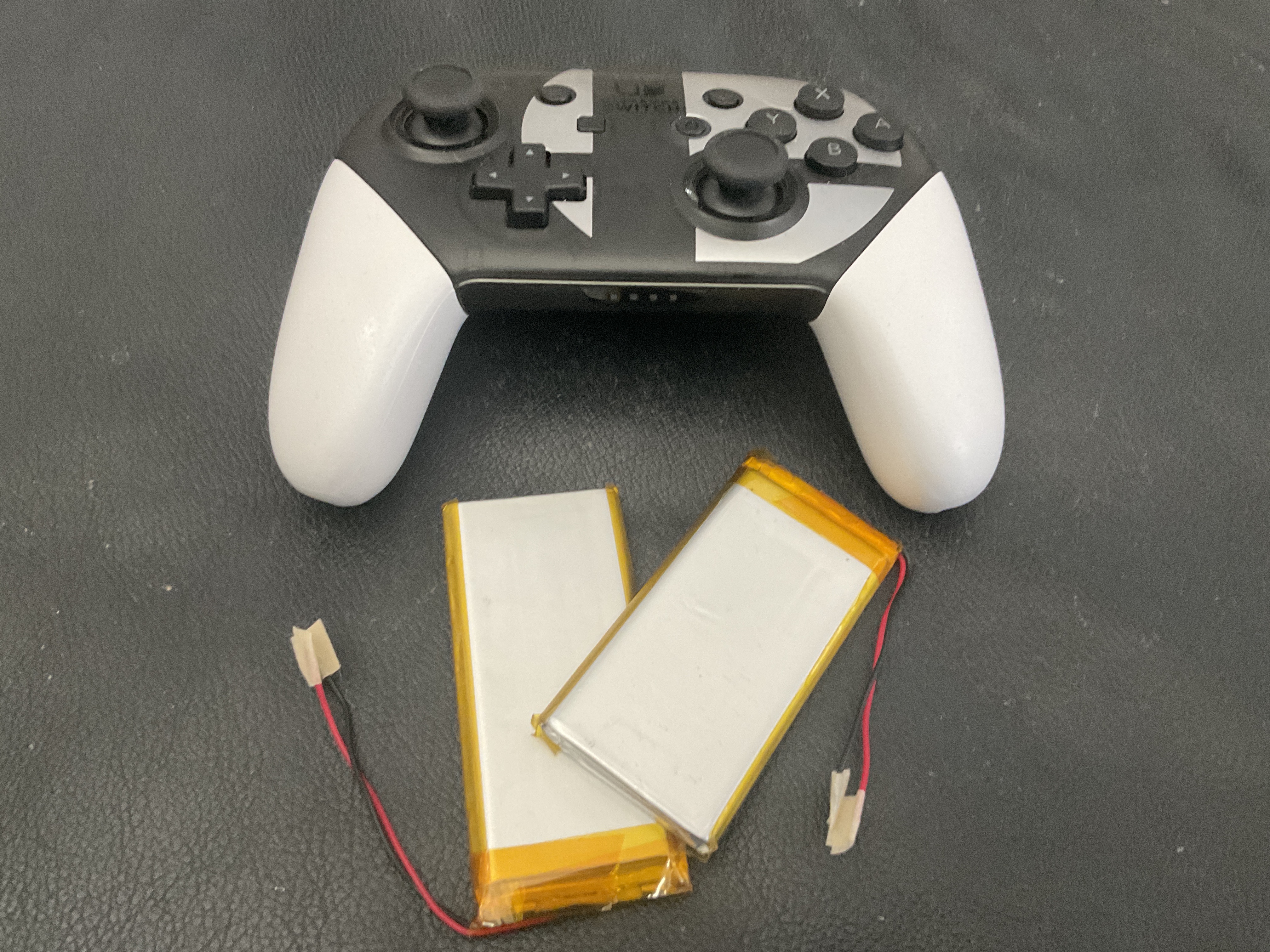

(Knock off Pro controller and 3500mAh LiPos from AE just arrived…back to the workbench?)

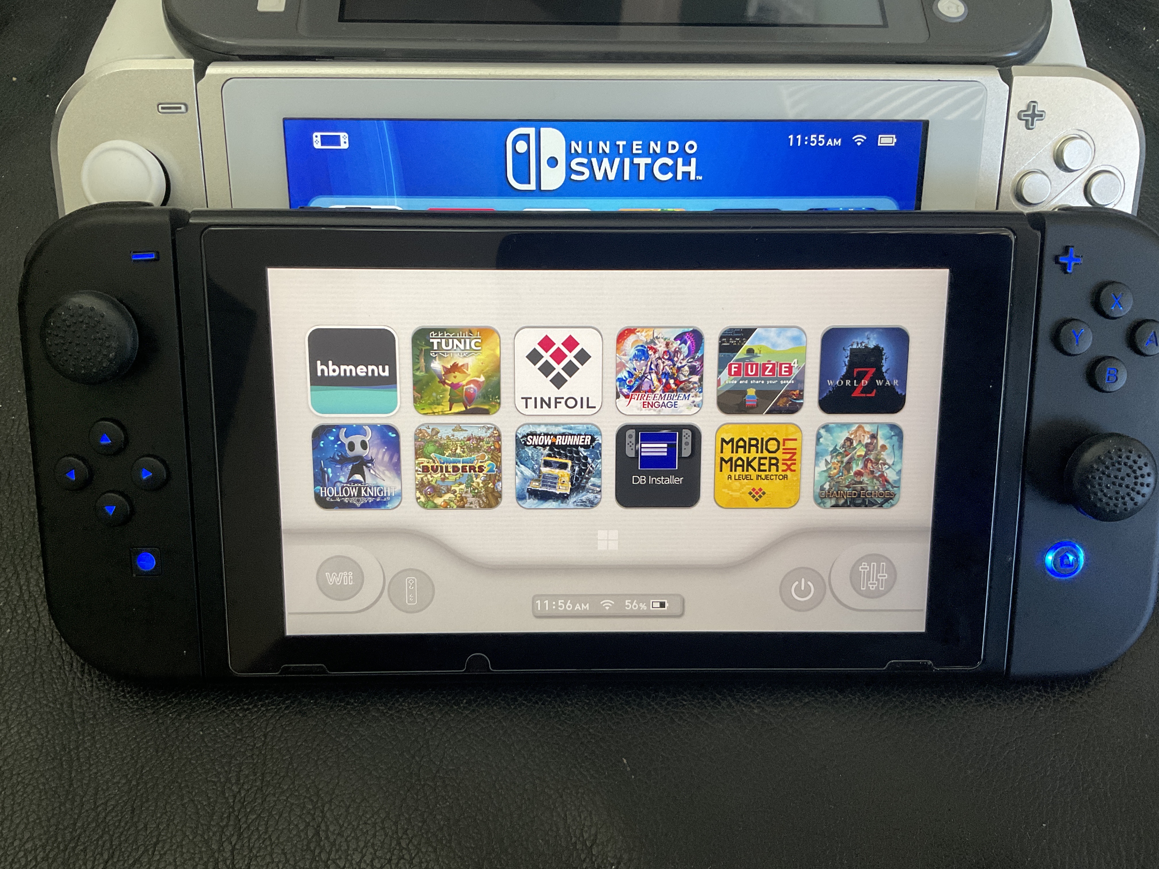

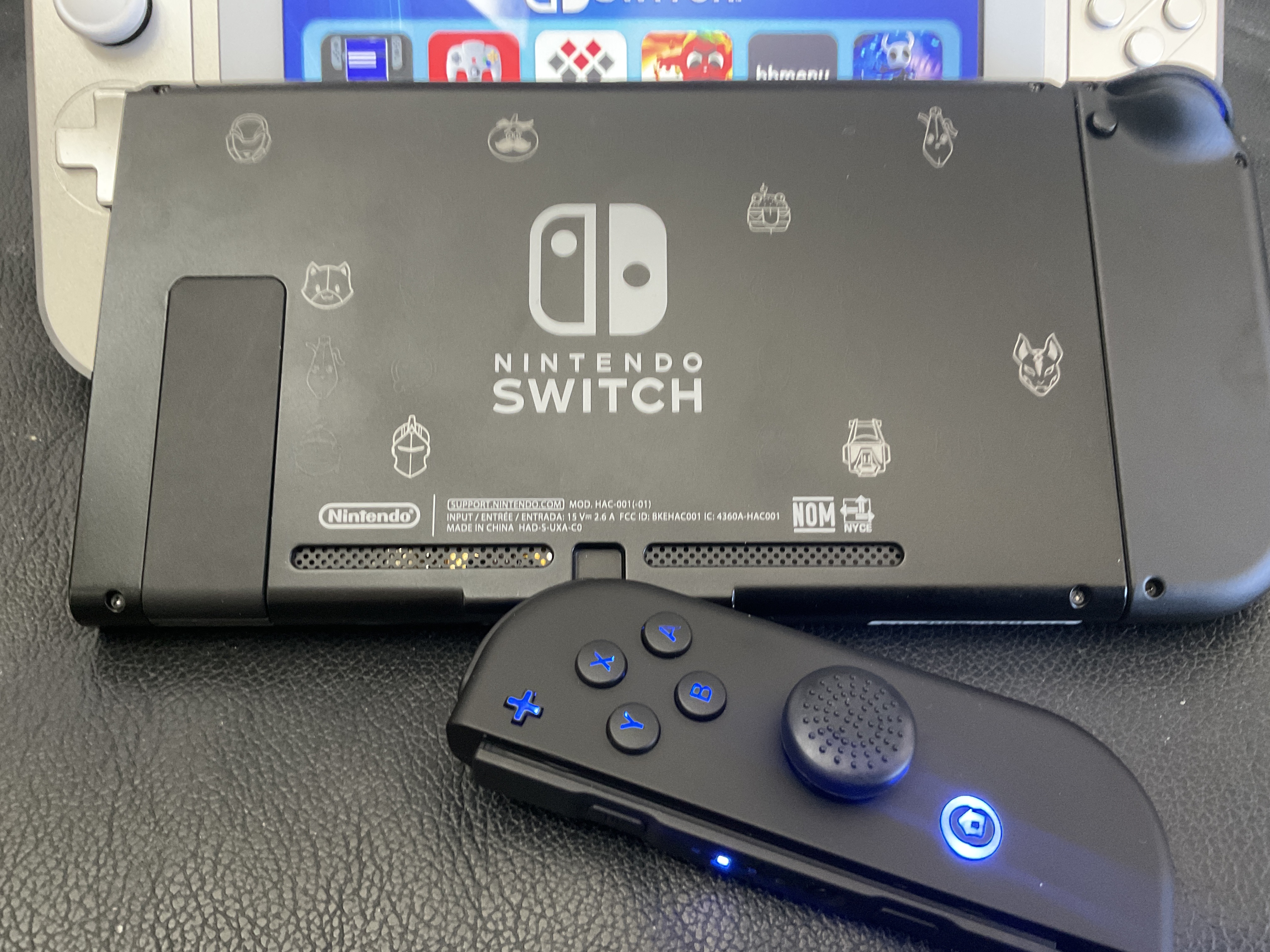

I've been using eXtremeRate soft touch shells for some time now, and while they look great and function well, I got irritated by the marks they pick up, simply by being used. I made the switch (see what i did there?) to the BoxyPixel casings (Black Anodized Aluminium) about a month ago. Now that i have enough playtime with them under my belt I wanted to share the finished product!
Biggest worry for me pre-purchase was connectivity between the Joy-Cons and console. I don't know if its because of the anodizing, but i haven't noticed any difference at all.
During the installation process, I wish i had read the comment about pre-installing the screws - even the BoxyPixel website advises it, but i thought i knew better. Its soul destroying trying to find a method to extract a snapped screw without damaging my shiny new toys, but live and learn. I highly recommend to use the supplied screws, but you only get 2 per Joy-Con, whereas there are 4 OEM screws.
In terms of problems after successful installation - only one really. If you use the OEM ABXY buttons, i found they are able to rotate about 270° in either direction. Functionally, no problem at all, but aesthetically, its a shit-show.
I ordered a new set of Black eXremeRate buttons to see if they were any better. In my opinion these fit much better, but there is still a small degree of rotation - this time I was happy enough to live with it. Bonus points for the embossed effect, which compared to OEM buttons means the paint wont ever rub off - e.g. there isn't any! (Curious point - this set of buttons have an awesome matte effect to them, my previous eXtremeRate purchases have been gloss).
Anyway, parts list below. Happy to upload a picture or two if anyone cares or is interested in the final product. I ended up with a very pretty but unintended Darth Vader aesthetic because of the Red LEDs and full black 'armor' :D
