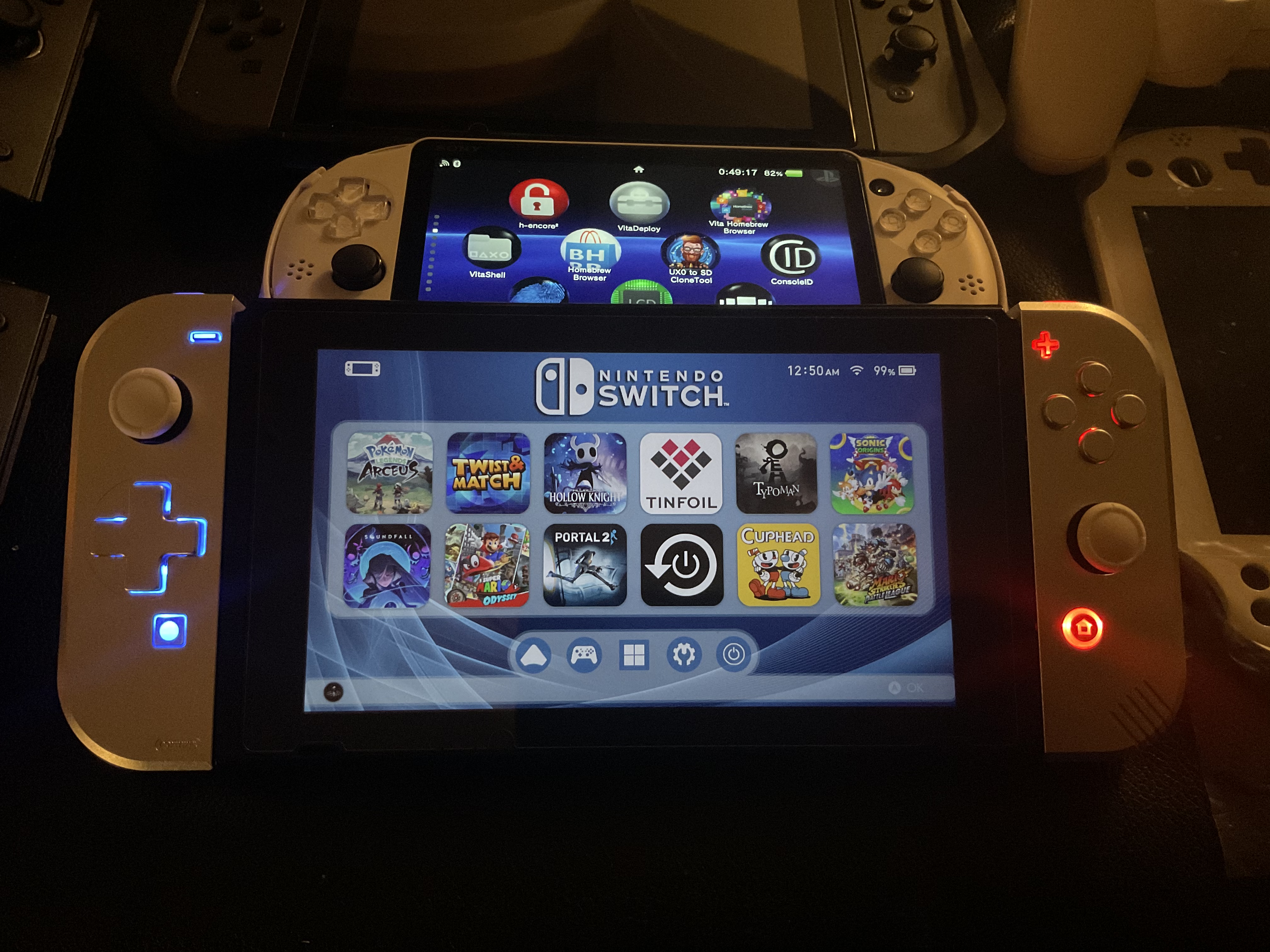

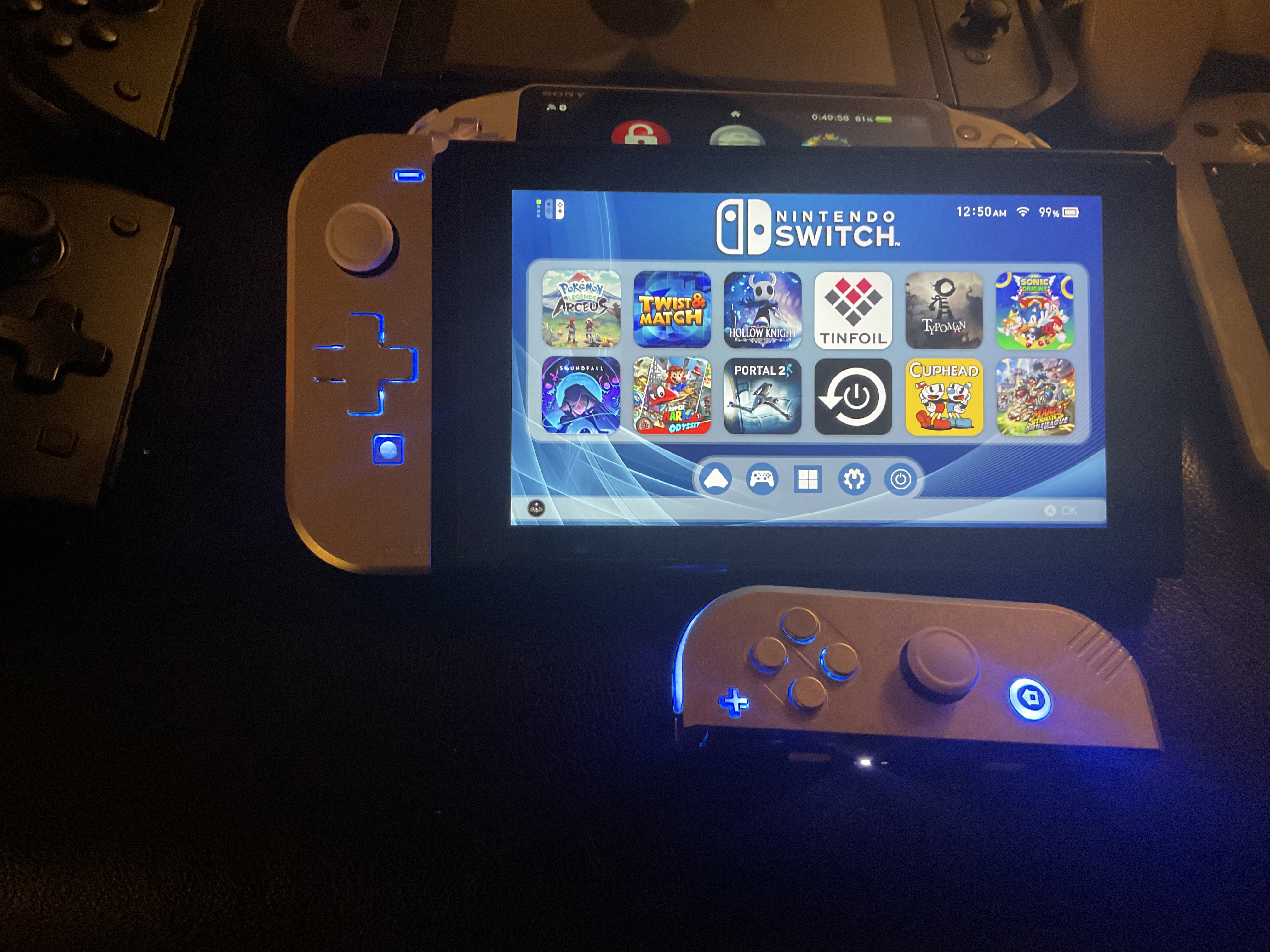

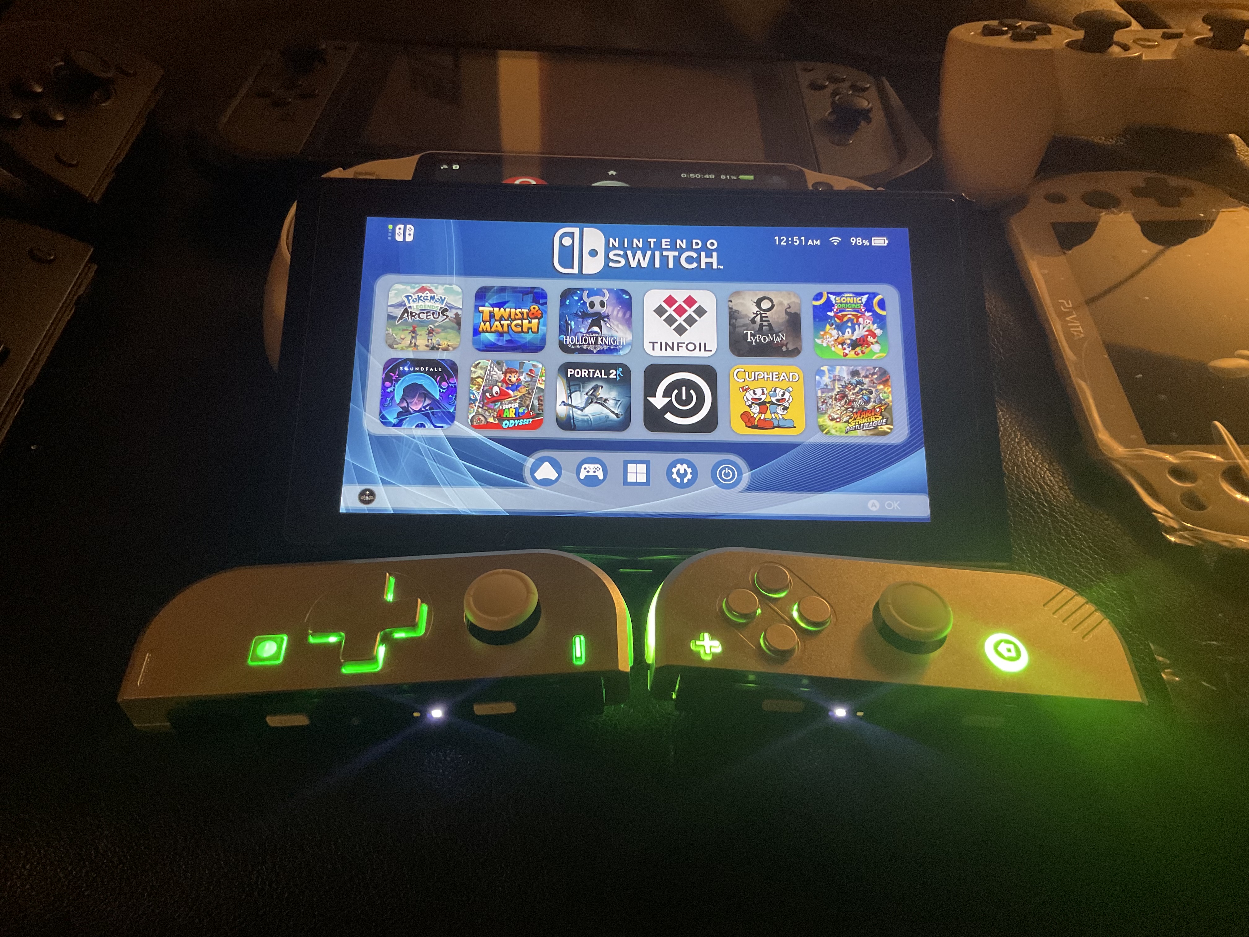

So quick update:
I decided to go whole hog on the joycons. I had an old pair that needed refurbishing anyway.
I went with a monochrome washed out look so I had to wait on the aluminum D pad and buttons.
Picked up some white analog joysticks.
I bought the Extremerate DFS LED kit w/ white buttons (because anything worth doing is worth making it difficult on yourself!)
Since everything else was changing I simply couldn’t keep the green LEDs on the inside of each joycon so I got the white Extremerate Firefly kit.
Had a mishap with the shoulder buttons..smashed one trying to get the new button in place. Ordered a new ”button on a ribbon cable” thingie. Sorted. Then I promptly broke off one of the buttons on the circuit board pulling up traces in the process. throws toys
Bought a $20 used joycon off eBay. waiting intensifies It arrives and is in better shape than mine so I pulled everything out and put in the better parts.
Today I’m essentially done but when I did a dry fire test of everything before buttoning it all up…my Firefly kit turns to be stock green. WTF! In addition, turns out the DFS kit doesn’t do white (reading product descriptions is fundamental!)
Sooooo, I just now pulled everything apart in disbelief and kicked my cat.
I have a replacement Firefly kit in the mail. Will be here this week…at which point I’ll hopefully be done and can publish the finished product.
I’m getting too old for this shit!

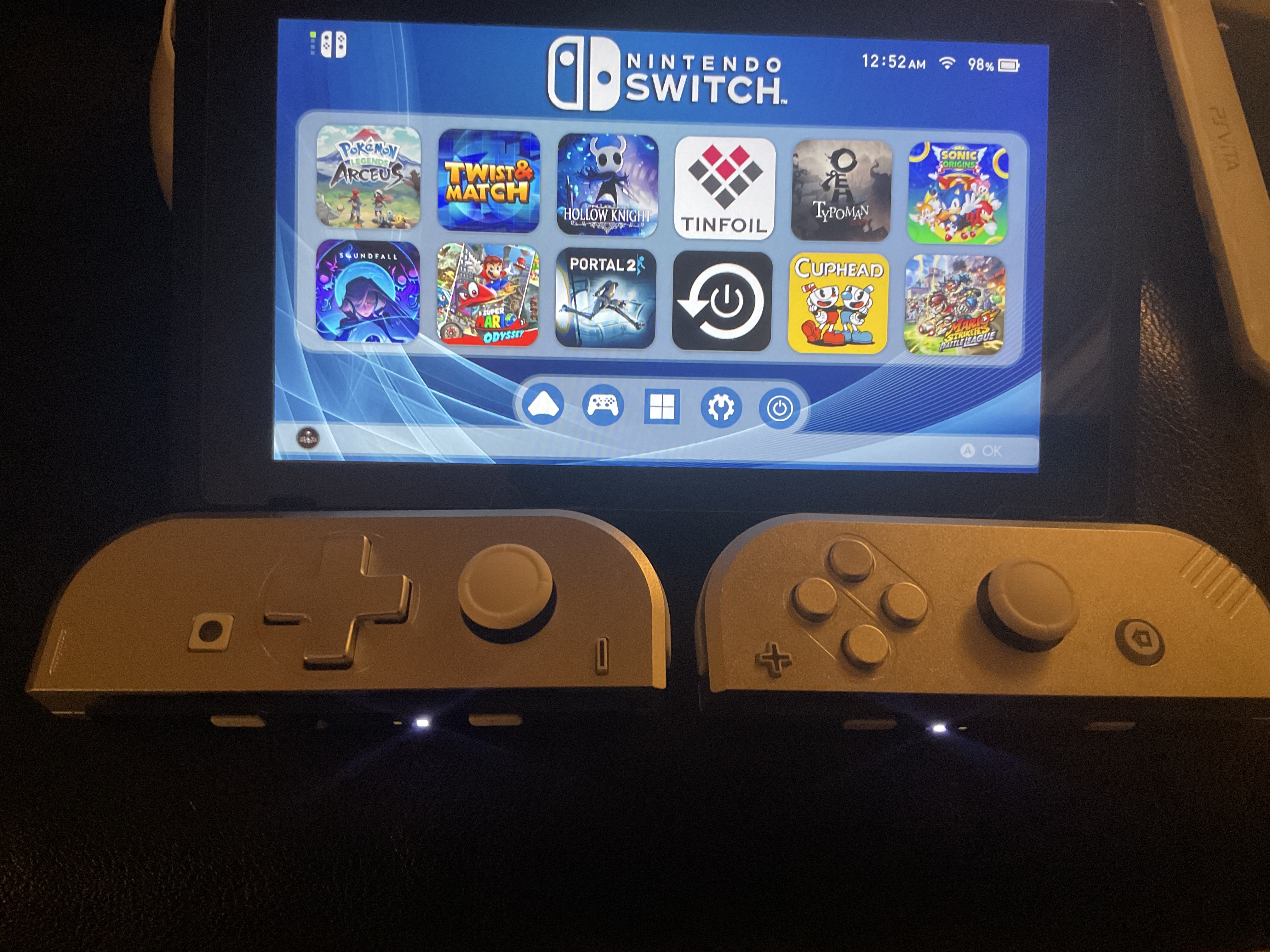

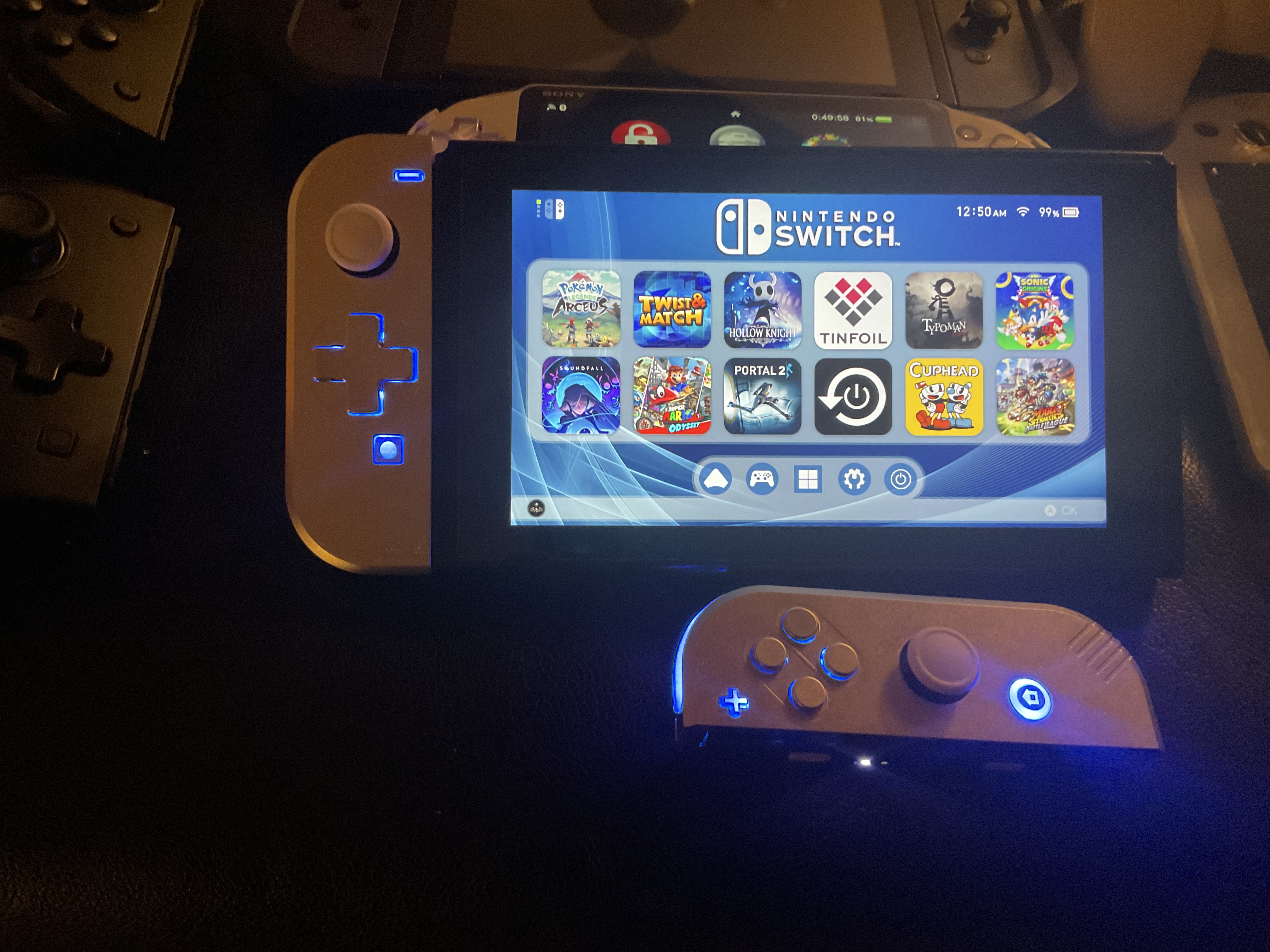

Since everything relies on wireless communication (Joy-Cons with Bluetooth, Switch with WiFi) I'm not so sure how wise it is to use a metal shell. Anything I'm overseeing here?

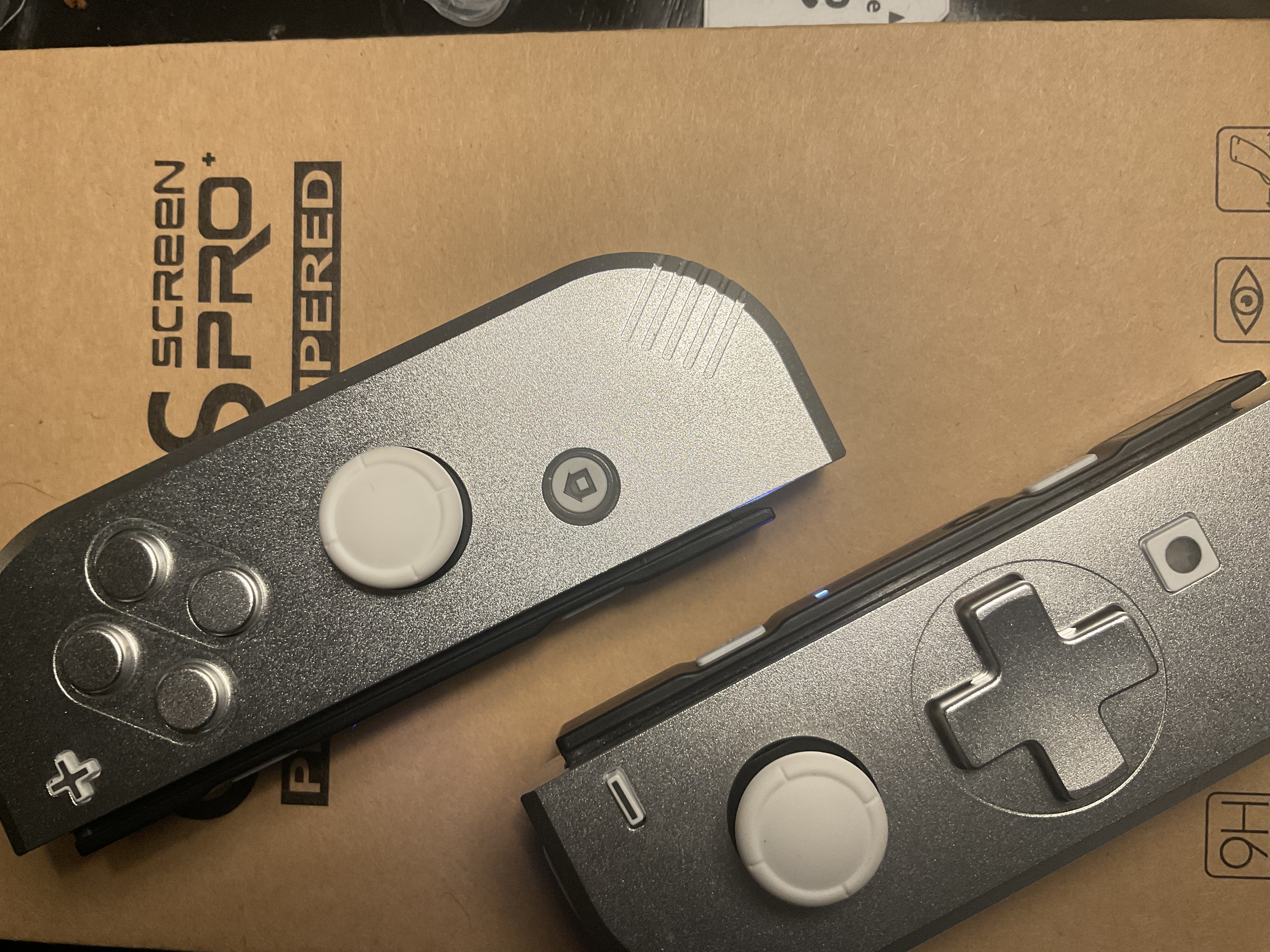

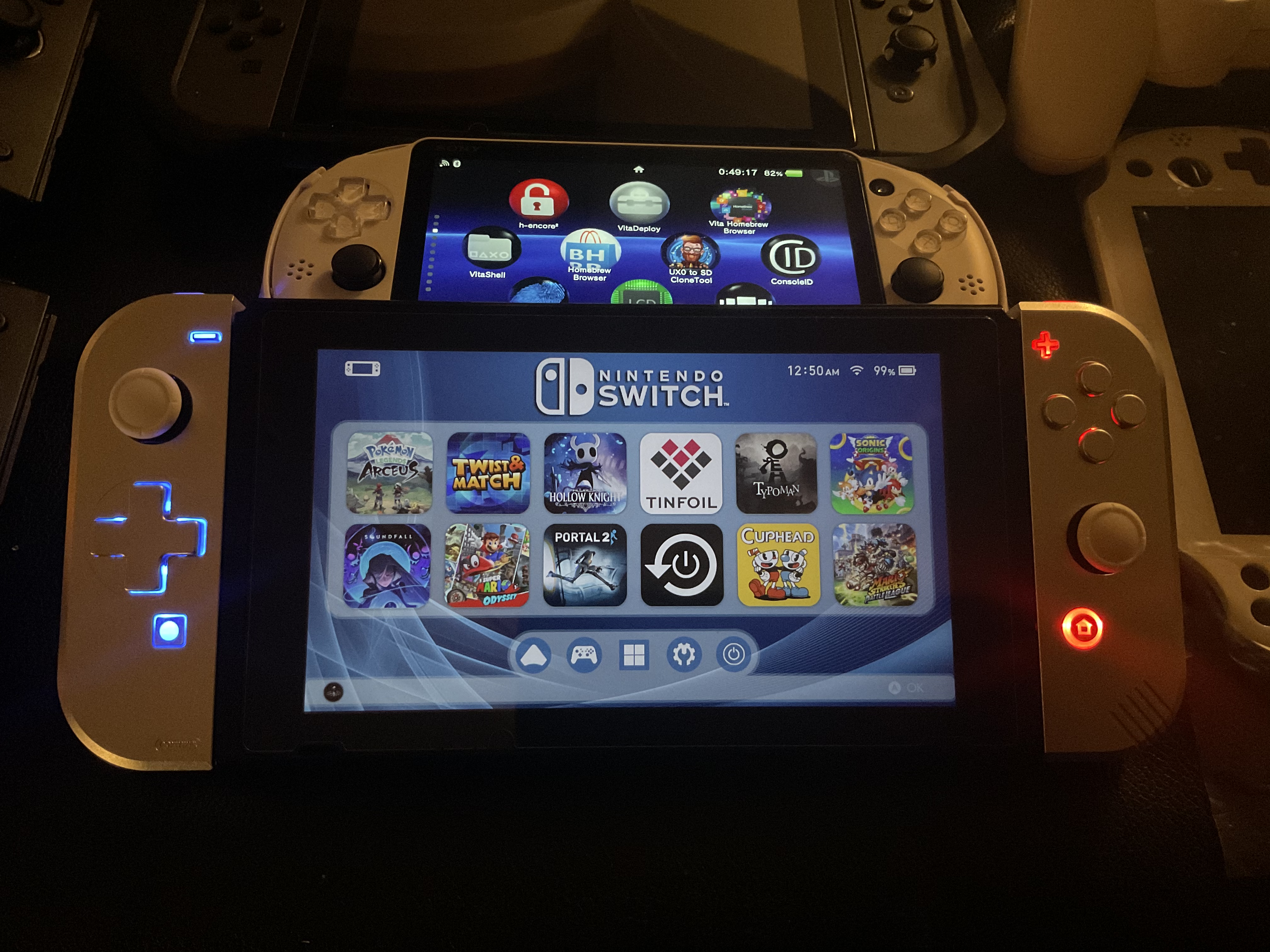

Nifty. How do you rate the d-pad?
I went out of my way to buy the dpad and buttons and had to wait for them to ship (forgot to ask the waifu) and…well…
…they complete the look of the kit very well but they wobble/rattle around, are a bit “clicky” and make a tiny bit more noise than stock.
Definitely more show than go!
They do have a “silky”(?) feel to them and I think they look cool. So far they don’t adversely impact gameplay but due to the noise I might replace them with the white/transparent set that came with the DFS kit later on. It was one yuppie buck for the set so I’m definitely happy with the purchase. Just being honest.

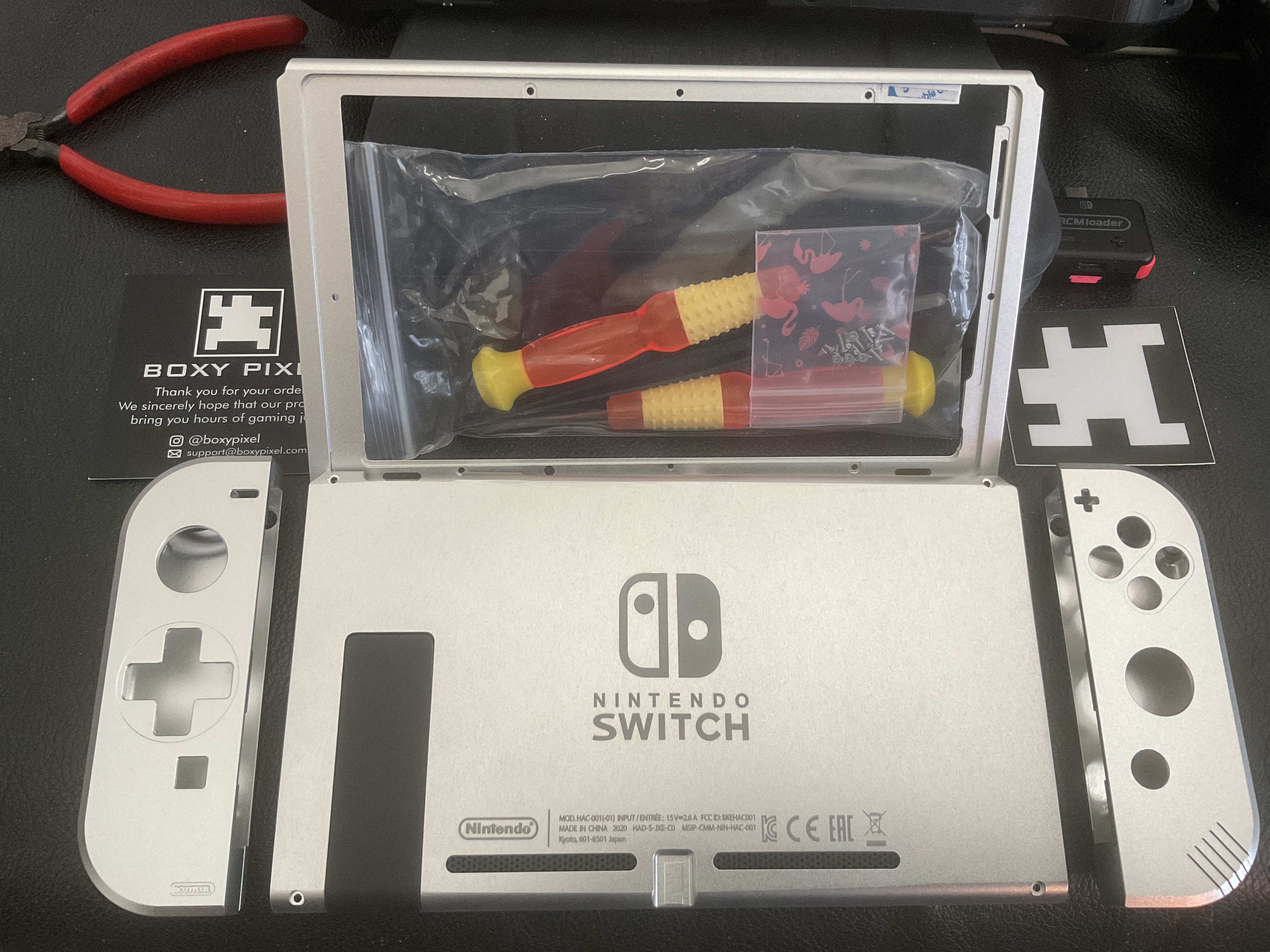

The boxypixel aluminum shells are the absolute bomb BTW. Love them!
You’re not wrong. Theres a slight degradation over stock and I’ve only done the joycons. I expect more attenuation when I wrap the Switch itself in metal. A faraday cage around your RF is definitely counter to what most people are looking for. My thoughts are that I play this one in handheld like 99.9% of the time and I sit in the same room as my wifi so I don’t need meters of reception. I have another legit Switch that sits in its dock for playing Online w/ my kid that’s hooked up to the TV that won‘t be getting the same treatment for precisely this reason.

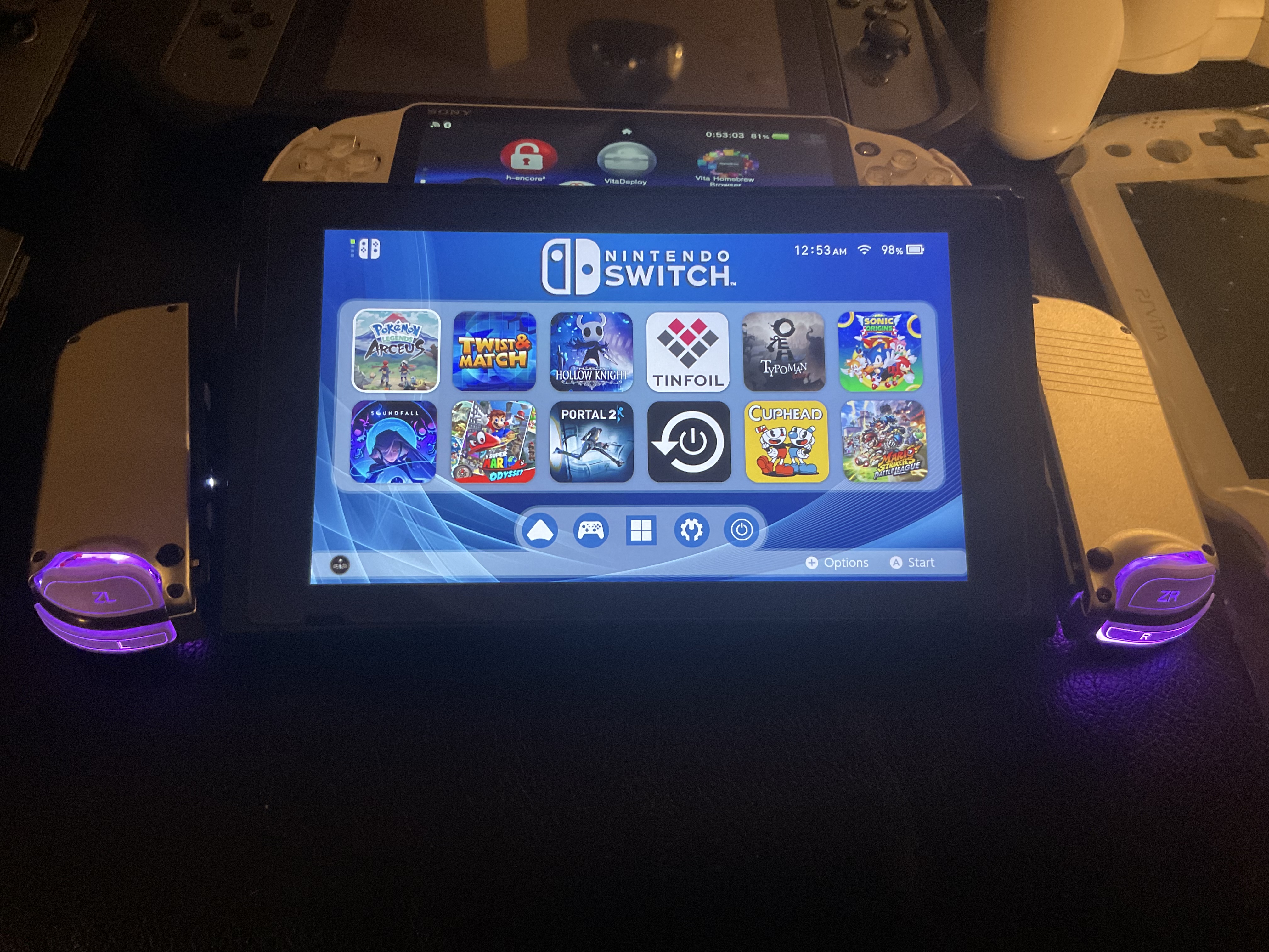

Saw the backplate alone on AliExpress a while ago but they were ~£50, which is too much for just a backplate imo. Cool to see someone with everything assembled (minus the faceplate). The LEDs shining from under the Joycon buttons looks really fucking cool contracting with the metal imo.
