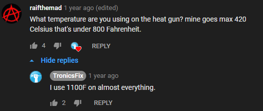

    i don't like that tronicsfix roasts everything with 600°C / 1100°F

    yeah, someone asked him about the temperature in the comments.
    that's almost double of what's necessary...
