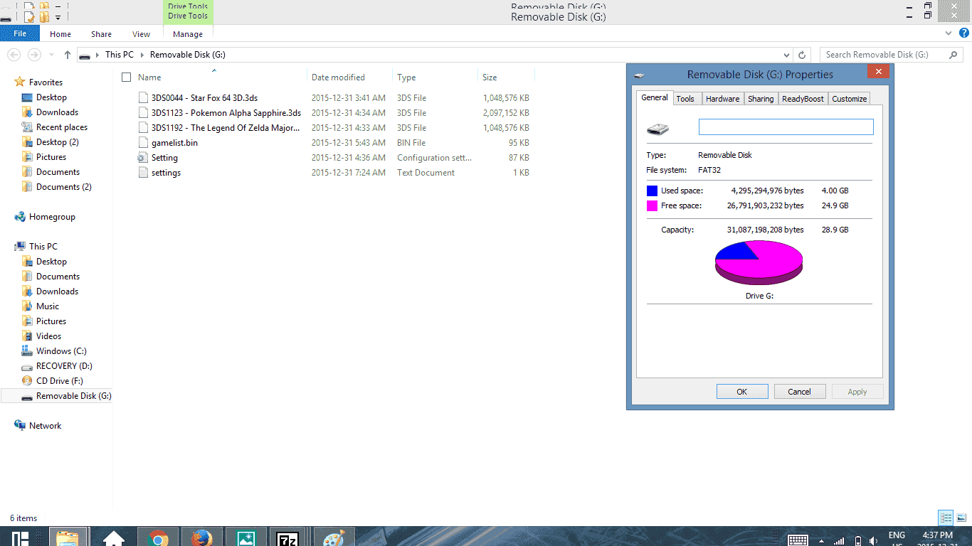

Here is what my folder looks like. Is anything wrong?
