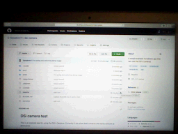

I've been wanting to make a homebrew app that can use the DSi's cameras for quite a while, but was stuck since whatever I did it just wouldn't actually get an image, but thanks to @StapleButter's research for melonDSi they found the problem and I was able to fix my app too! So here's the first (public) homebrew app that can use the DSi's cameras afaik!
Its not really anything too exciting as all it can do is show both cameras and take a picture as a BMP, but the code is here and working with libnds/devkitARM in C/C++ so hopefully that's helpful if anyone else wants to use the cameras in a homebrew app. I'll probably try add QR code support to pkmn-chest and maybe work on a fancier camera app too soon, but this one is just a simple example.
:download: Download on GitHub if you want to try it, the source code is there too
Example photo: (converted to png)

New example photo:
Edit: Hotfixed the release to simply change the save location to 100DSI00, didn't notice that DCF folders are supposed to be exactly 8 characters long.
Finally got 640×480 mode working! The fix was actually super simple lol, but last time I tried I couldn't quite find what was wrong. This example is now a bit more reasonable and able to take pictures more or less on par with the official app, using 640×480 resolution and YUV mode directly to RGB8 for better quality. I'd still like to look into the other settings and maybe add some way to give the user finer control over the camera, but for the moment it's still just as basic as always but a little more useful.
PS. The non-floating point YUV to RGB math has to be some of the most cursed math I've seen lol
