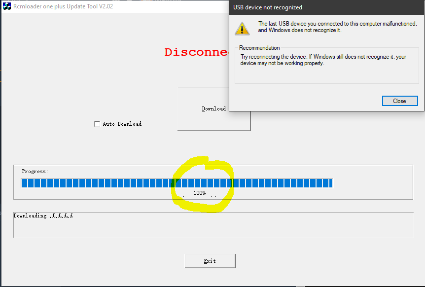

FWIW, when I run the RCMLoader it Connects (green), downloads the file (green PASS message), and then restarts the device but when it comes back up Windows doesn't recognize the device. It's probably because it tried to write a 2M image to a 700K partition and threw up.
See pics above...I have the entire thing open and full access to everything. I can certainly unsolder the + wire.
Removed the + line for 30 seconds. Soldered it back. It seemed to do nothing when I plugged it into the PC. No signs of life at all. No USB recognition on the PC side either. Was able to get back to what I assume we both believe is DFU mode by holding the + button and plugging it back in. I'm back to square one. I'm going to read up on DFU...aside from resetting Apple devices, I've not messed with it much.

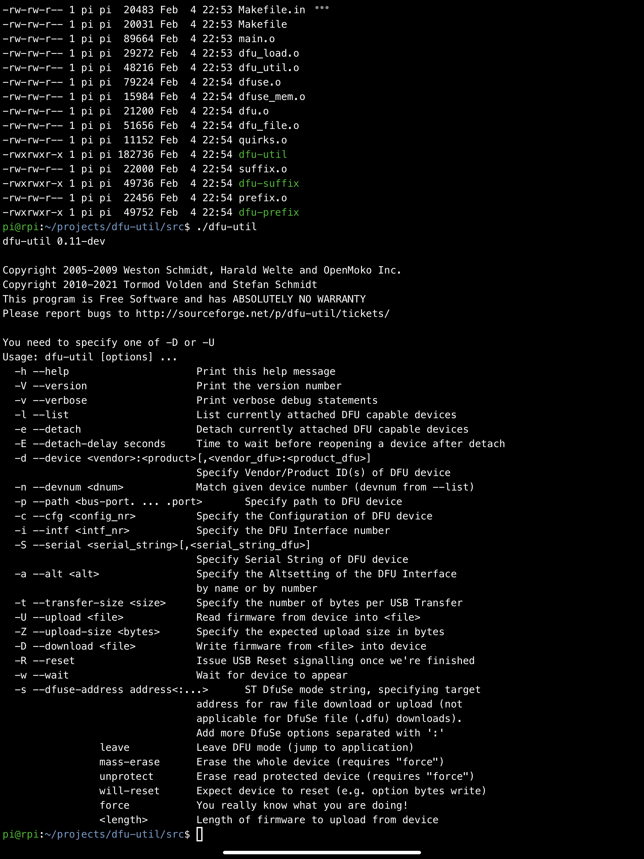

So I know more about DFU than I did 20 minutes ago.
This article was very helpful:
https://web.archive.org/web/2022122...10/emulating-usb-dfu-to-capture-firmware.html
Instead of dragging others into trying to dump firmware in DFU mode, I think I’m going to wait and risk my own when it comes in the mail.
Fortunately my logs show the VID/PID and expected folder location so maybe I can emulate a device and dump the firmware.
https://web.archive.org/web/20200618043250/http://dfu-util.sourceforge.net/
Last update for the night…was able to pull the software and build it on my rPi. It looks like I have a legit way to up/down load firmware via DFU when my device arrives. Will update when I know more.

I am 99% sure that I have a clone which I am ok with. The issue I am having is when I plug it into a Windows 10 computer, it appears to be recognized as a device but I can't actually access it at all. I have tried on Android and it also recognizes it but the filesystem is never accessible, or sometimes I can see the directory structure, but only for a few seconds before the device becomes completely inaccessible again. I bought 2 of the same device and they both do this same behavior. Any ideas how I can get the OS to see it so I can update the payload.bin on it? Once it locks up, the white light stays on even if it isn't plugged into anything. I have to wait until the battery drains completely before I can even try again to access it.
Ideas?
Ideas?
Have you tried holding down the button on the RCMLoader, then plug into PC USB while button pressed down?
Ideas?
This is a know problem of the clones, if you format the UMS disk the device becomes bricked and can not be recovered using the restore firmware method because the firmware is completely different of the official one.
Reactions: BigOnYa
I didn't try to flash or do anything to either of my devices except look at the file system which doesn't even work. I can't even get any OS to see the filesystem structure for more than a few seconds if I can get that st all.
Try pressing the reset button of the rcm loader and try again
