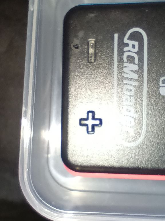

Hey guys. So I just bought an RCM loader, and the first few times I plugged it into my MacBook, it got detected just fine. But the next time I plugged it in, my Mac stopped recognizing it, and I don't know why that is. I did replace the payload.bin file in the folder titled ATMOSPHERE_HEKATE with a fusee.bin file that I renamed payload.bin. Could that be the reason why my Mac isn't recognizing my RCM loader anymore?
I should also mention that the light on it is constantly blue. Not flashing, just constantly blue. Is that a problem?

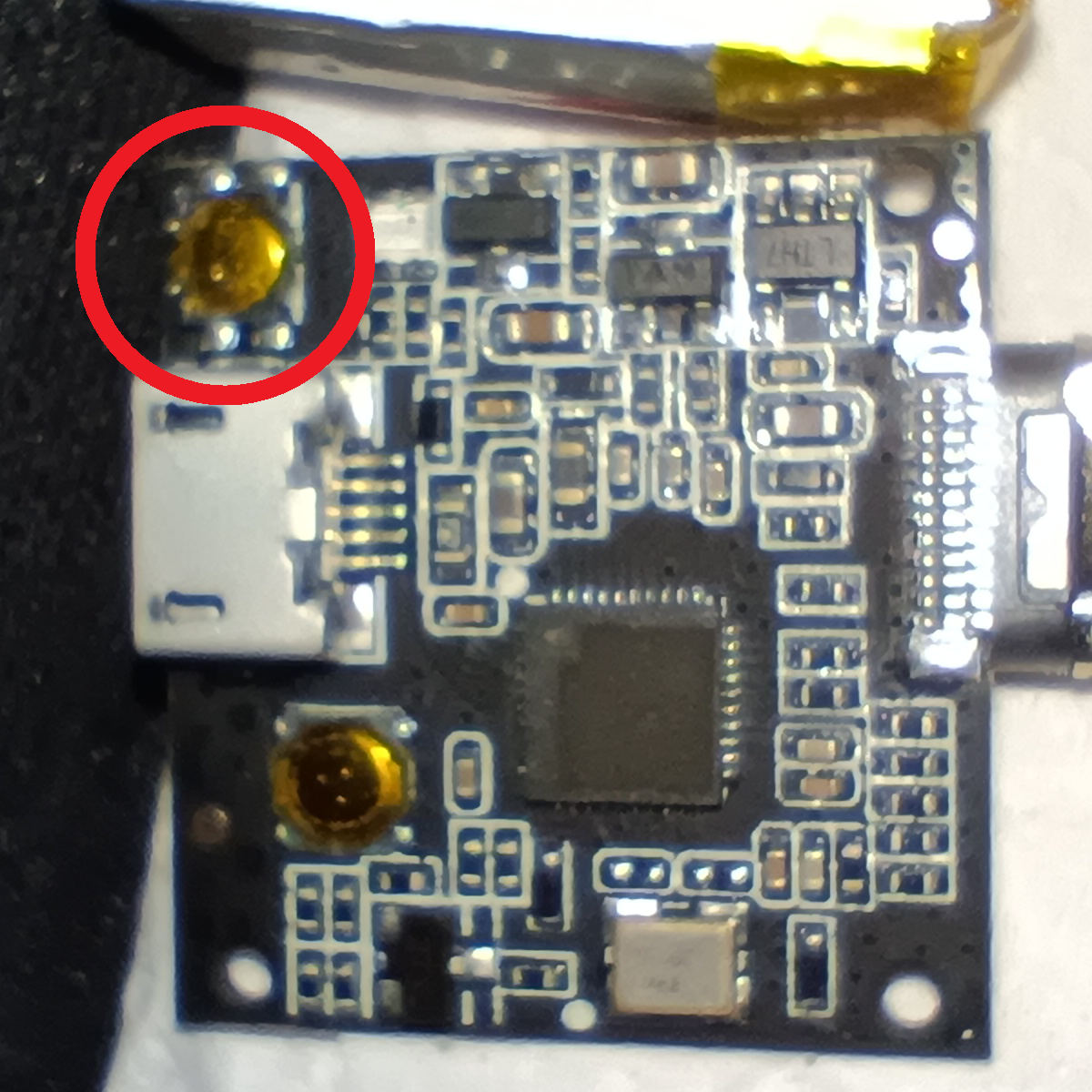

Reset the device, the original devices have the button there:
I have a fake one on which the manufacturer replaced the 90° button for a normal one so I have to open the case to reset the device
I ended opening a small hole on the case to be able to press the reset button using a paper clip.
P.S. NEVER FORMAT THE DEVICE YOU MAY BRICK IT IF YOU FORMAT IT.
