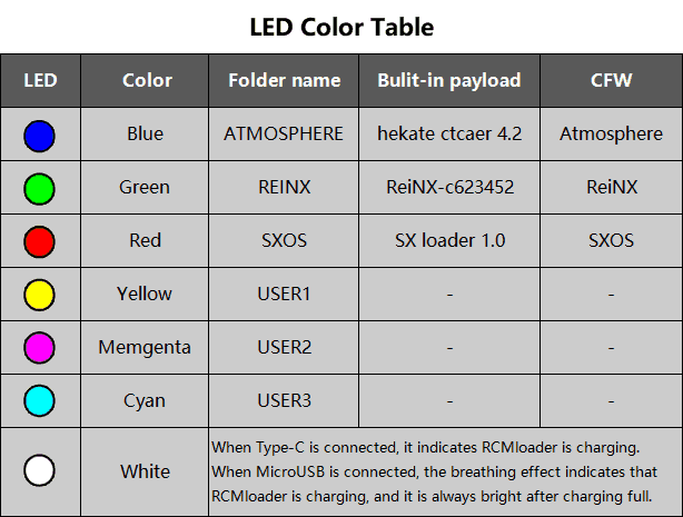

For the newer RCM loaders, just connect it with the microUSB cable to your PC and it should show up as an USB drive.
The newer ones has this LED color which indicates which payload from which folder is selected.
So a blue led will inject the payload for Atmosphere.
Make sure the payload in that folder is the same version as your Hekate/Atmosphere version on your SD card.
Putting fusee.bin in the root will not work. The RCM loader looks for it inside the folders with the names below.
When connecting the RCM loader with the microUSB port, you will only need to press the button to update the firmware of the RCM loader itself.
This is not applicable to the newer RCMloaders. They only have a blue light and they aren't flashable/updatable in any way. The only thing pressing the button does is cause the blue light to turn on while you hold it.

Solid/pulsating blue light? That just means it's charging, which it shouldn't do if you are in RCM mode. If the light flashes that means it's trying to inject.
When plugged into my PC a solid Red light. When inserting it into the Switch, solid Blue light.
These newer RCMloaders only load Hekate and rely on the update.bin functionality built into Hekate in order to load the latest Hekate version from your SD. You need Hekate on your SD for that to work obviously.

Oh yeah I guess it did have a red light. Not sure what the difference between red and blue is on these because there's no documentation for the new version. But it kind of sounds like it's not injecting. Even on the new version I think the light should turn off after it injects. Maybe I'm misremembering though.
Just extract the latest Hekate.zip on the SD, it already comes with the update.bin in the right location.
Put fusee.bin in bootloader/payloads and select it from the Hekate payloads menu.
