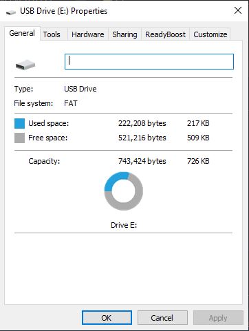

What is it’s around 700k in size to tell if its a clone?
This is a clone. about 700KB drive size.
I have plenty, usually works ok if only 1 payload in the Atmosphere/Hekate folder.
It will starts broke down when 2 or more payload in other folders. (2 sometimes work)
1 tell-tell sign is when you put more payload, trying to select payload doesn't change the blinking LED light.
Normal/Original RCM Loader should have approx 2MB drive size.

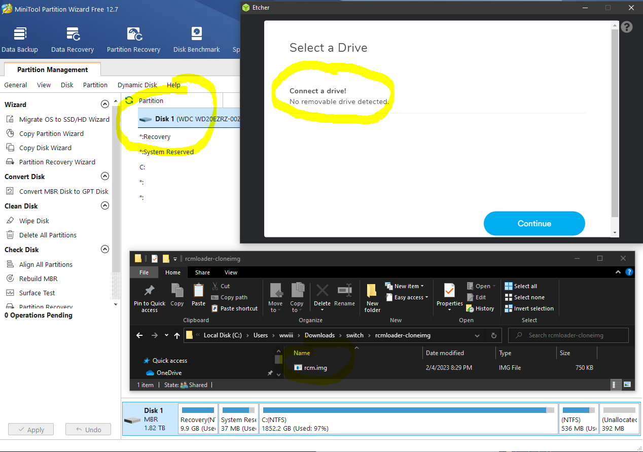

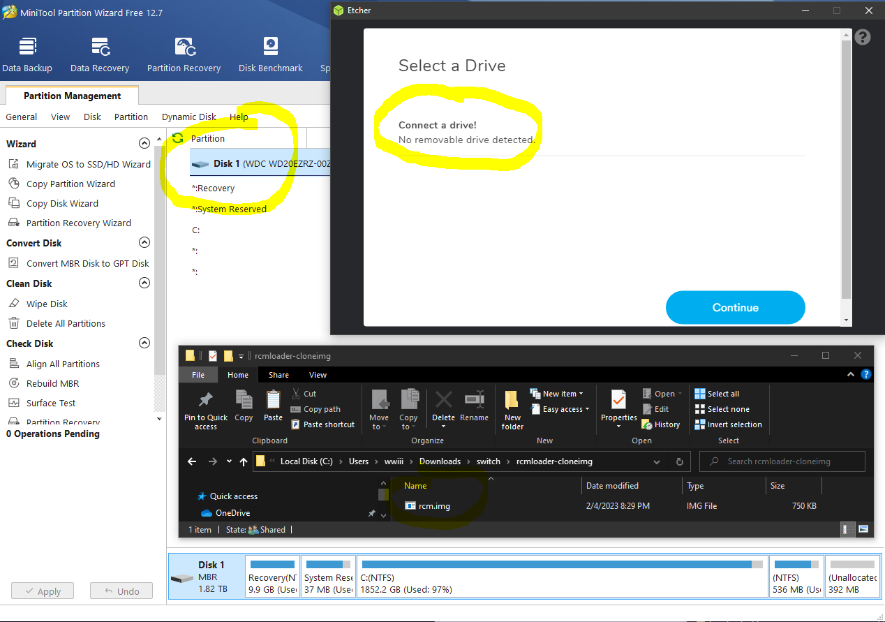

I held the + button and plugged the rcmloader in and it's flashing blue/green like it's supposed to.
Unfortunately, Balena Etcher doesn't see any drives available. All I can see in minitoolPW is my main hard drive.
Go do your shopping. I've gotta think about this. Might try Ubuntu next...
e: had to make double sure:
No go...might have to find a way to trick the firmware updater...
LOL...well, first try is a fast strike out..

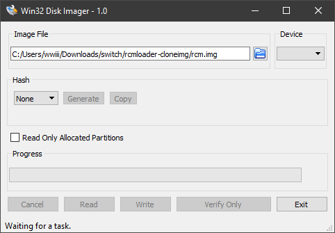

Don't hold the button. That's supposed to put it in update (DFU?) mode. You should just plug it in, and it should be detected as a drive. If it's not even detected as a drive with no volume, then it really is a brick. If it shows up in disk management, but without a drive letter, just assign it a drive letter, and then use image writer.
I tested my own RCMLoader by imaging it, then writing the image back, just to make sure it would work (and without causing a brick). Nobody ever jumped in to that thread after I suggested this same thing, to test it on a bricked one. At least this time we got one step closer by someone posting an image of a working clone.
EDIT: but what's this Balena Etcher? Don't use that. Use win32diskimager. Or dd if you're going to try Linux. The Win32DiskImager includes the MBR and such, which is where I think the problem here occurs, as a few people suggested that messing around with formats fixed their hekate injection (while many others said that formatting didn't work for them)...
https://sourceforge.net/projects/win32diskimager/

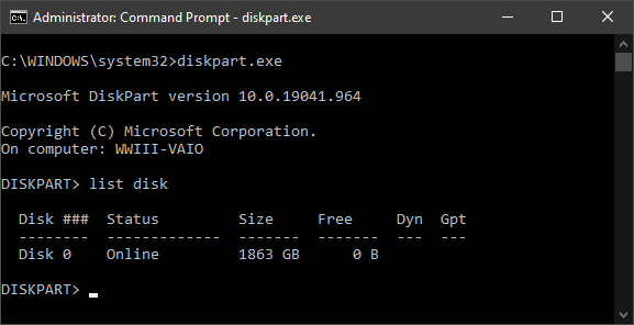

It seems to want to flash blue and green even if I don't hold the button.

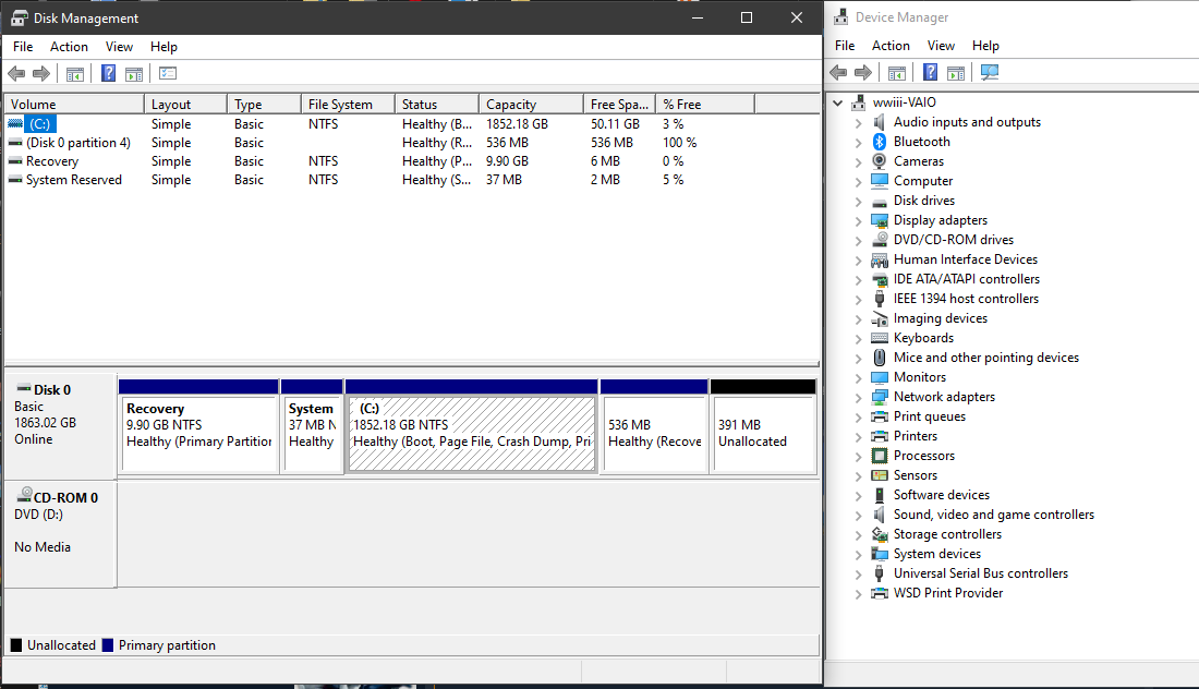

Checked w/ disk/device manager and there's no sign of life. I'll keep looking but I think we're approaching 0.
Gotta be able to see it inorder to write...ungh

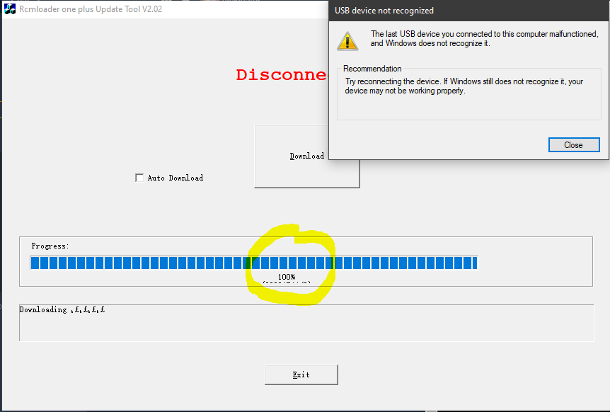

Ran the RCMLoader Update Tool and it sees it...
I think tricking this thing is going to be the only entry point. It was able to write to it before (and fuq it up...but still...it wrote to it.)
Attaching my log file (spanned two days of testing...wish I would have been more systematic now but I thought it was going to work first try...hubris in hindsight.)
Tried win32disimager as well. Nothing in the drop down.

FWIW, when I run the RCMLoader it Connects (green), downloads the file (green PASS message), and then restarts the device but when it comes back up Windows doesn't recognize the device. It's probably because it tried to write a 2M image to a 700K partition and threw up.

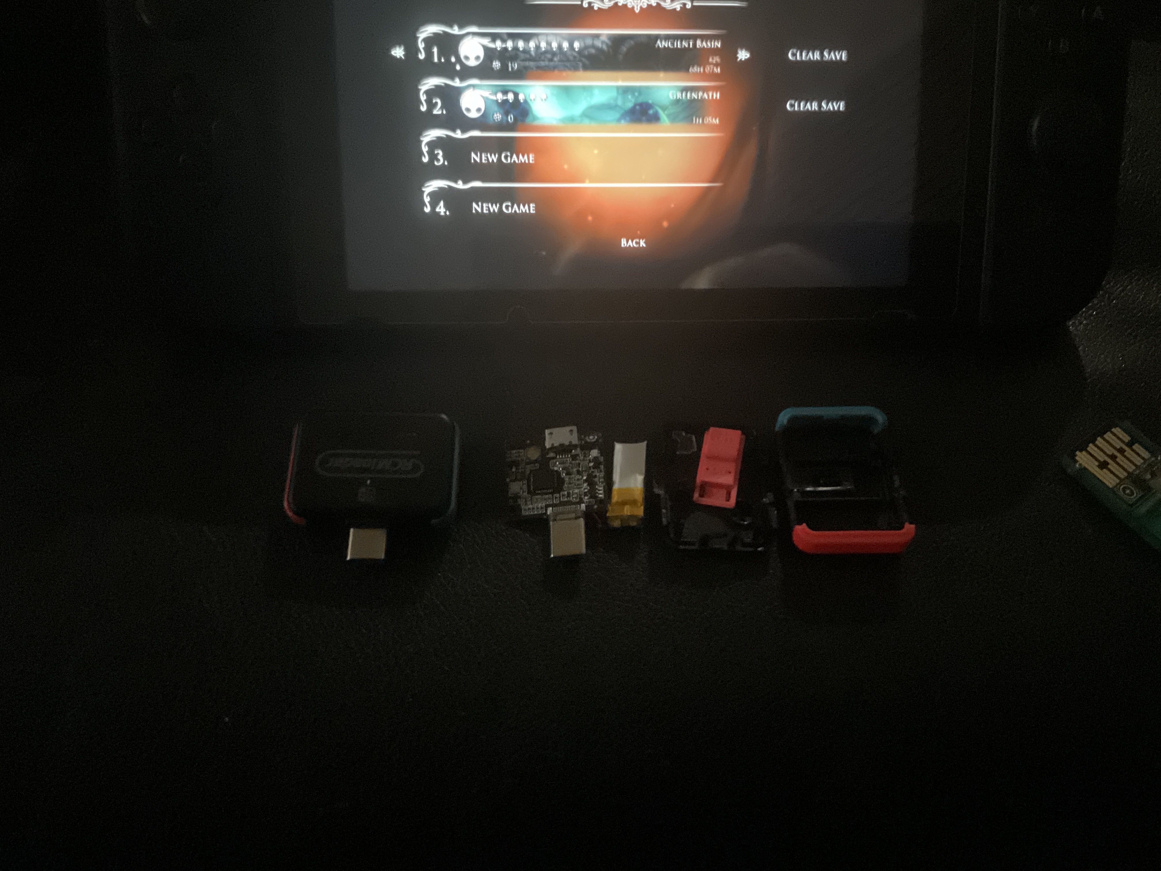

See pics above...I have the entire thing open and full access to everything. I can certainly unsolder the + wire.

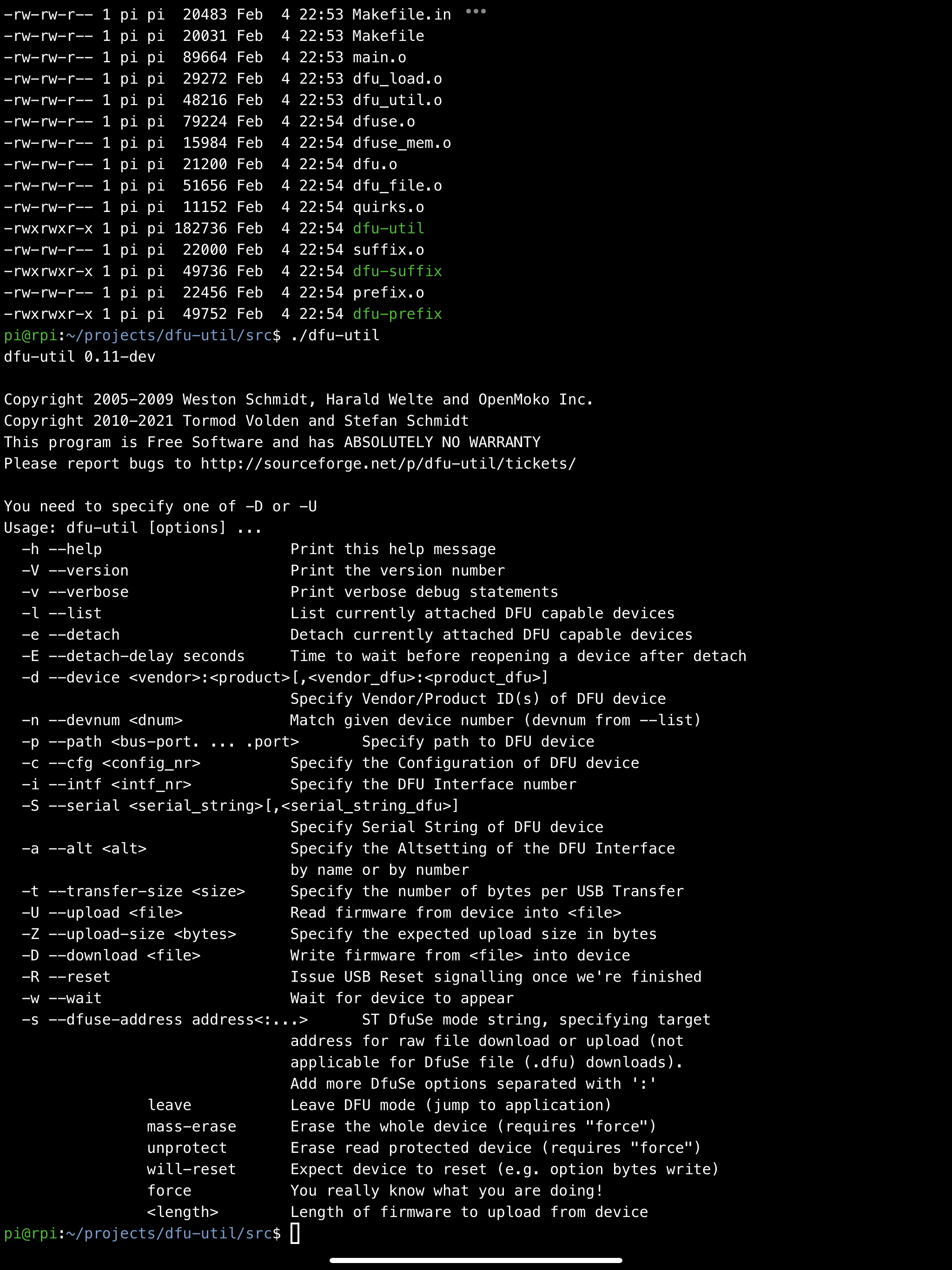

So I know more about DFU than I did 20 minutes ago.
This article was very helpful:
https://web.archive.org/web/2022122...10/emulating-usb-dfu-to-capture-firmware.html
Instead of dragging others into trying to dump firmware in DFU mode, I think I’m going to wait and risk my own when it comes in the mail.
Fortunately my logs show the VID/PID and expected folder location so maybe I can emulate a device and dump the firmware.
https://web.archive.org/web/20200618043250/http://dfu-util.sourceforge.net/
Last update for the night…was able to pull the software and build it on my rPi. It looks like I have a legit way to up/down load firmware via DFU when my device arrives. Will update when I know more.
Well, the -U flag shouldn’t possibly be able to ruin the new one. If the -D flag fixes the old one afterward, there could be quite a few people happy that you found this out.
If it doesn’t work, the next step will be to see if you can get a connection going with putty, and somehow find out what commands are at your disposal through it.
