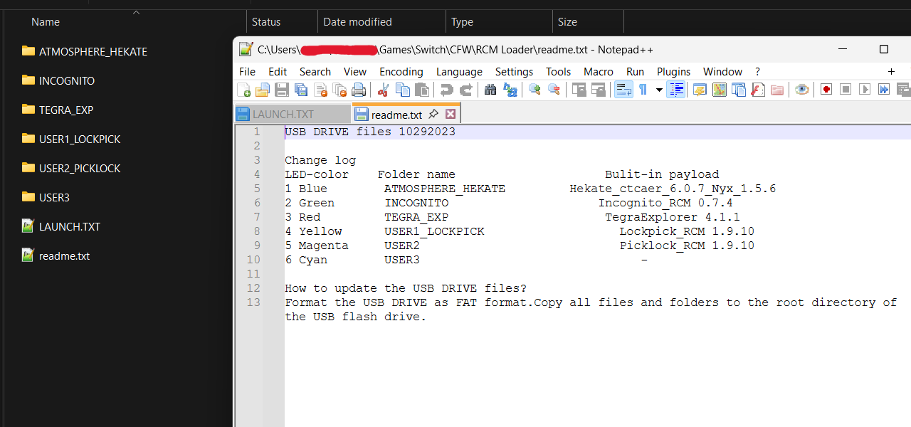

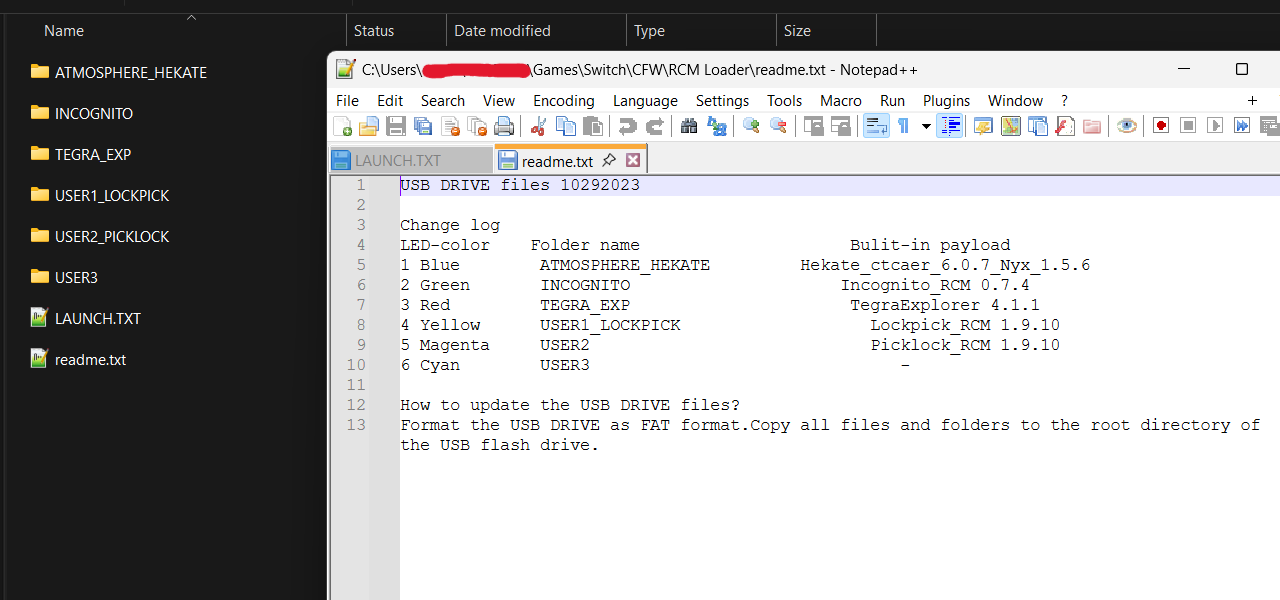

this is what my current RCM Loader looks like...I haven't updated since 10/2023
