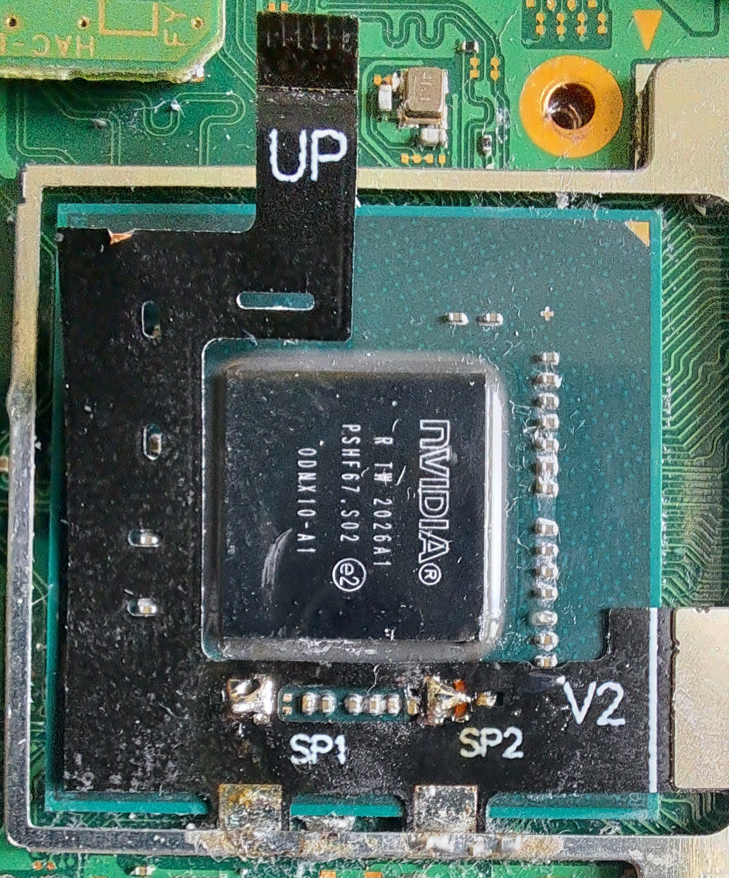

I resoldered it. The picture is the best I can do.
System ist starting up currently. Display lights minimal on. Stay on without doing anything. CPU ist getting warm, over time hot. Cooler does not do anything.

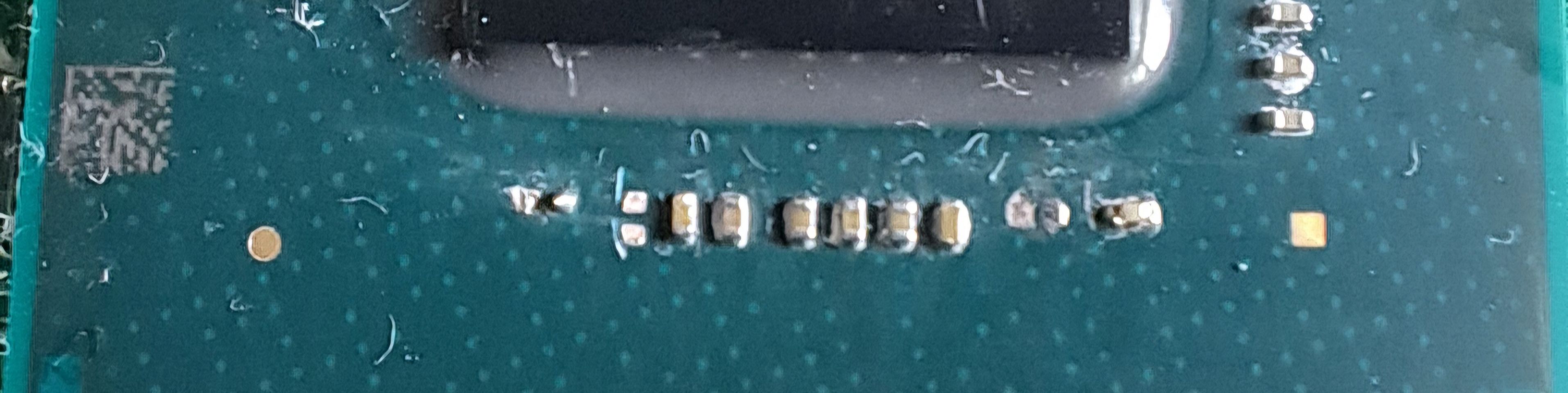

Your SP1/2 connections looked bridged. You're also missing something next to SP1
Should look similar to this. Yours looks like it's just a big blob across the whole cap.

I would fix your CPU flex cable first. Your problem isn't D0
If you have a multimeter, you can test if the points are bridged and well connected. The chances of your issues being this are pretty high

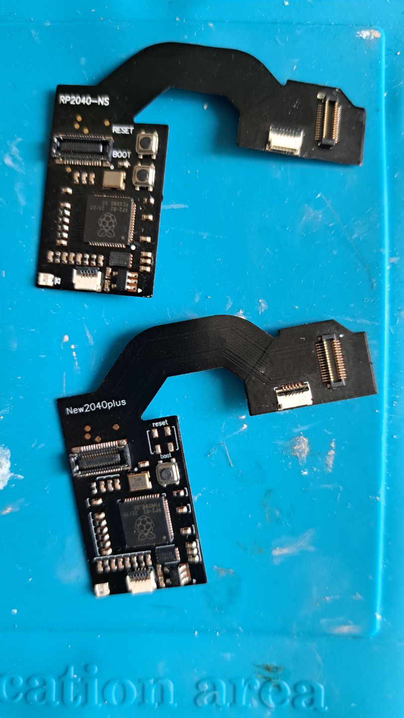

I bought a new chip. Mostly because I damaged the solderpoints of the flexcable, so I needed a new one.
The first chip has the text: "RP2040-NS", the second one "New2040plus". What do you know about those chips? Is one more recommended or even less?

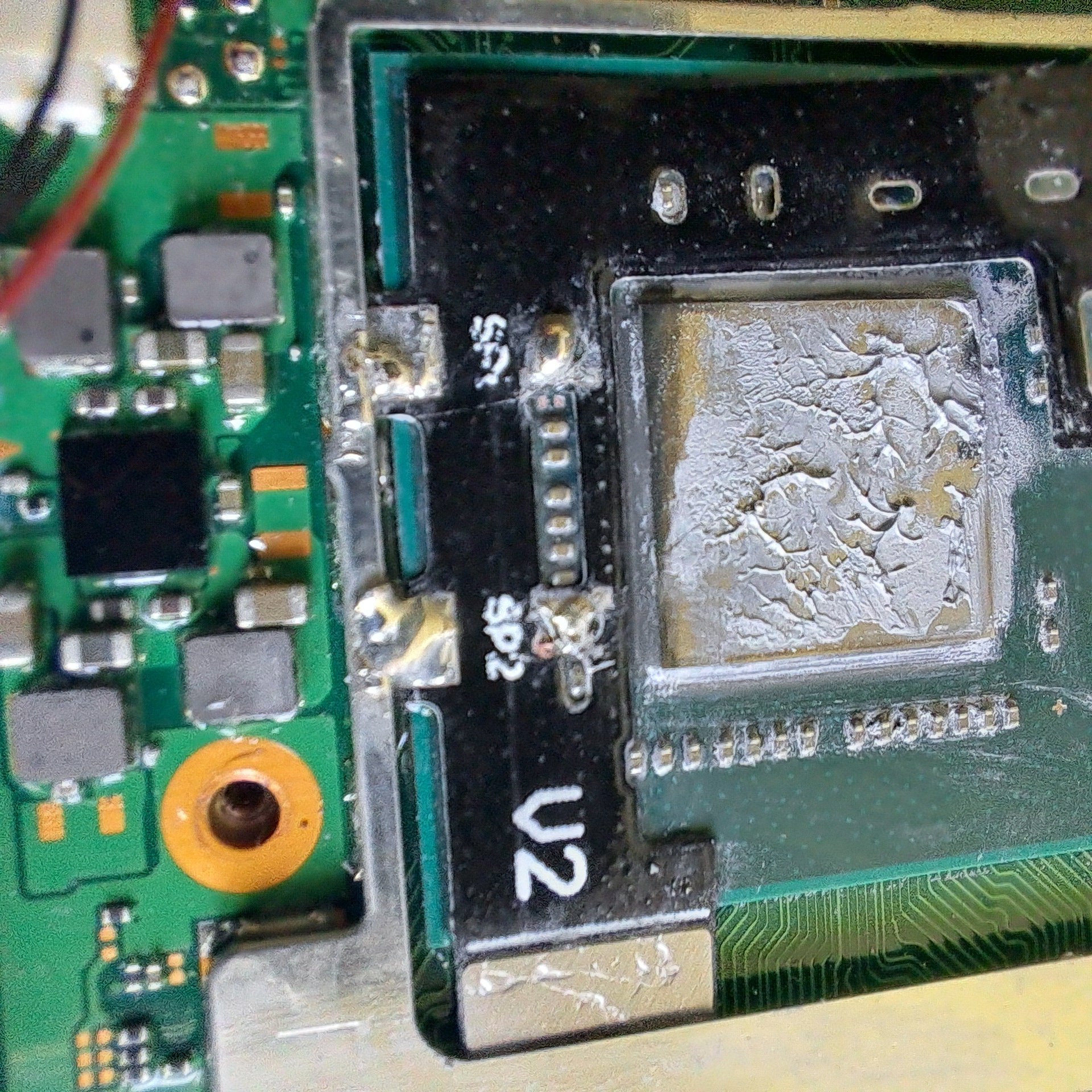

As requested, photo from my solder attached (not high quality). Additional I attached my modchips.
With this install (plus chip attached) I have a normal boot and code:
Blue - Long Yellow - Long Yellow - Short Yellow
With solderpoints like this I should stop the work on this console. I better be glad, that the console is still booting and not bricked.
If possible: please still describe the problem and solution I faced, to help me and others not making same mistakes or fixing those.

Your points on the flex cable are still bridged. And you're missing some caps in that last photo. People say those are just to filter out noise. Again, each point from the pads on the flex goes to the left or right side of each cap it sits next to, not from one pad to the other. If it's booting then I would just leave it at that, this might be too hard for you.
