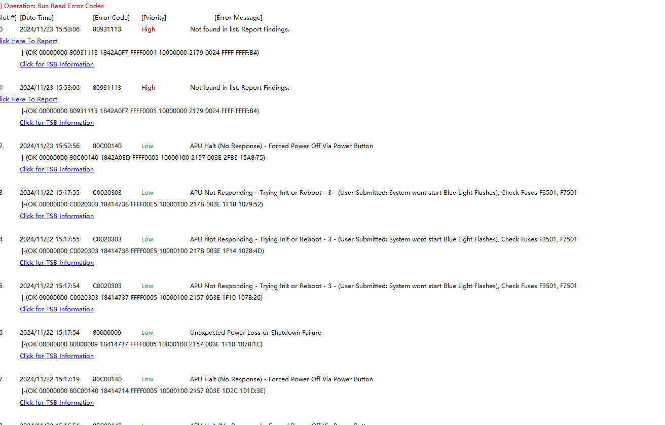

had PS5-SLIM came in with blue light blinking for ever. UART reading only found "80931113" in HIGH. Not sure if APU related or not.
