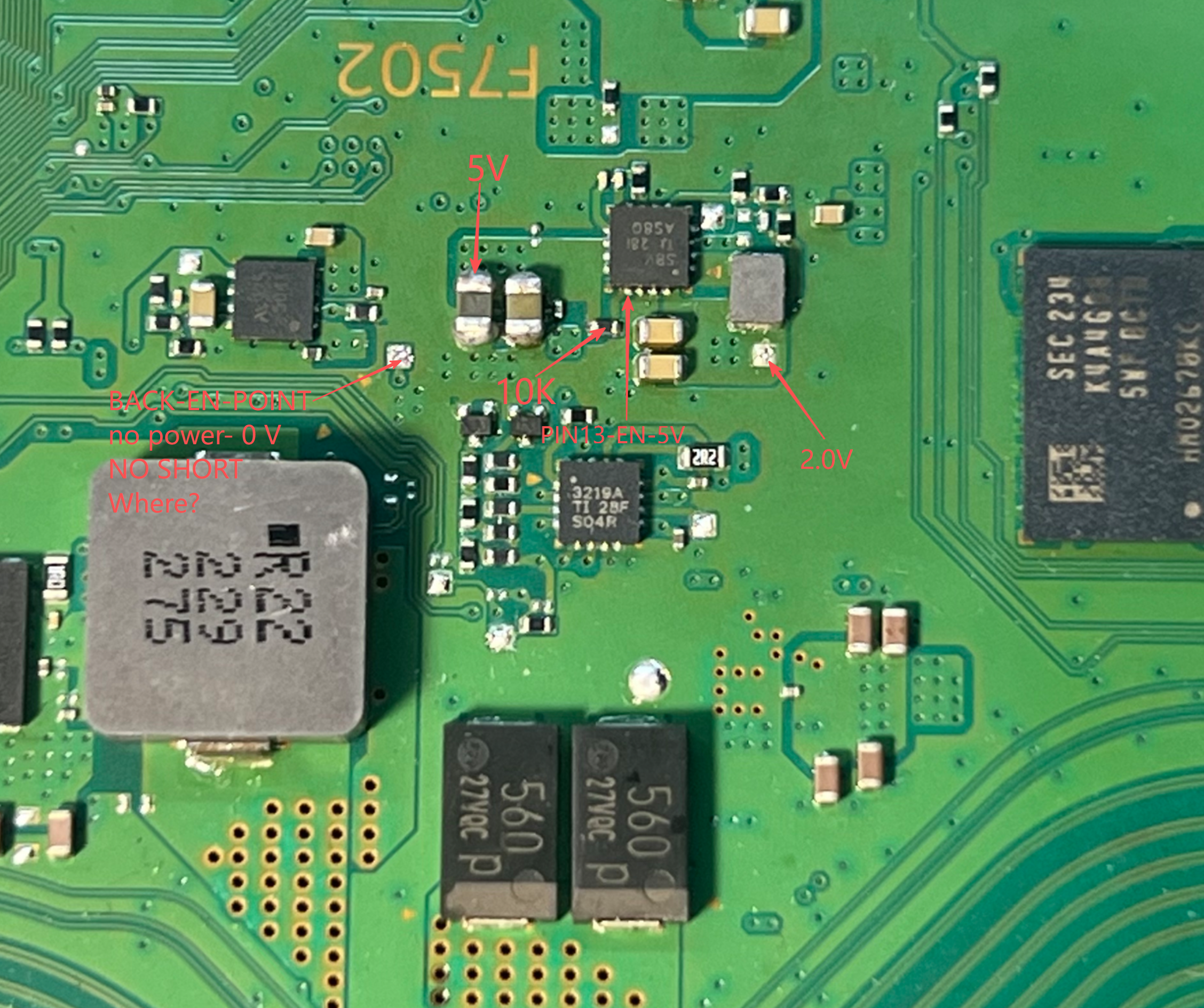

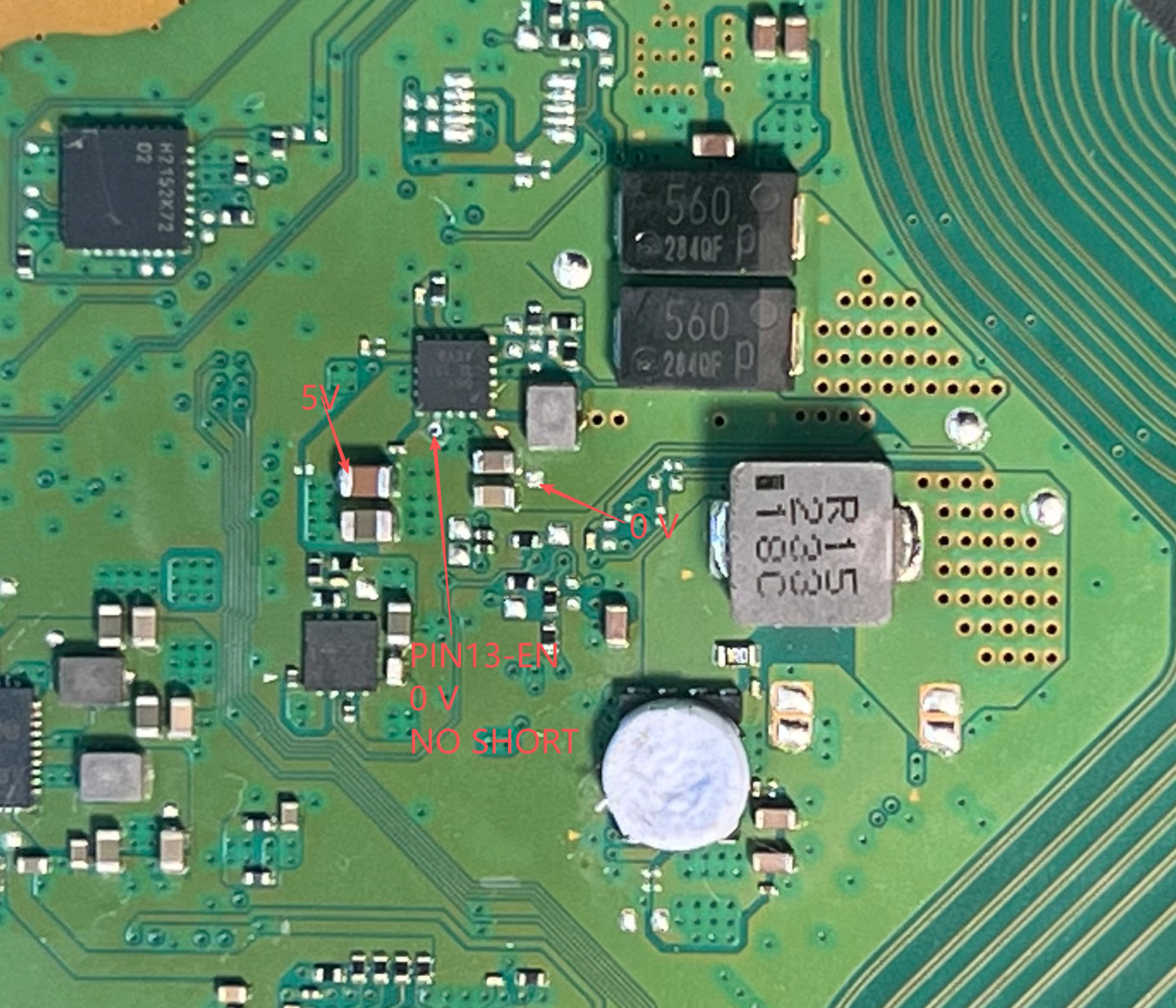

Hi everyone, I have an EDM-030 motherboard with the same BLOD codes: two C0020303s followed by 80810001.

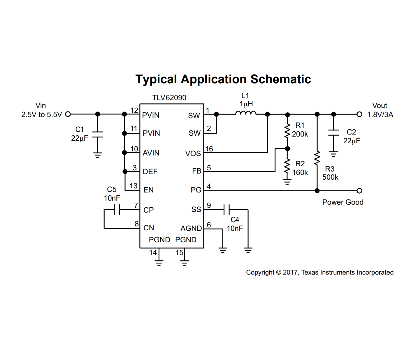

I measured the standby voltage and found that the TLV62090 on the back of the motherboard had no output voltage. Replacing it didn't solve the problem. I then discovered that pin 13 had no input voltage, and although this pin leads to the front of the motherboard, I haven't been able to find where it leads.
Can anyone help?

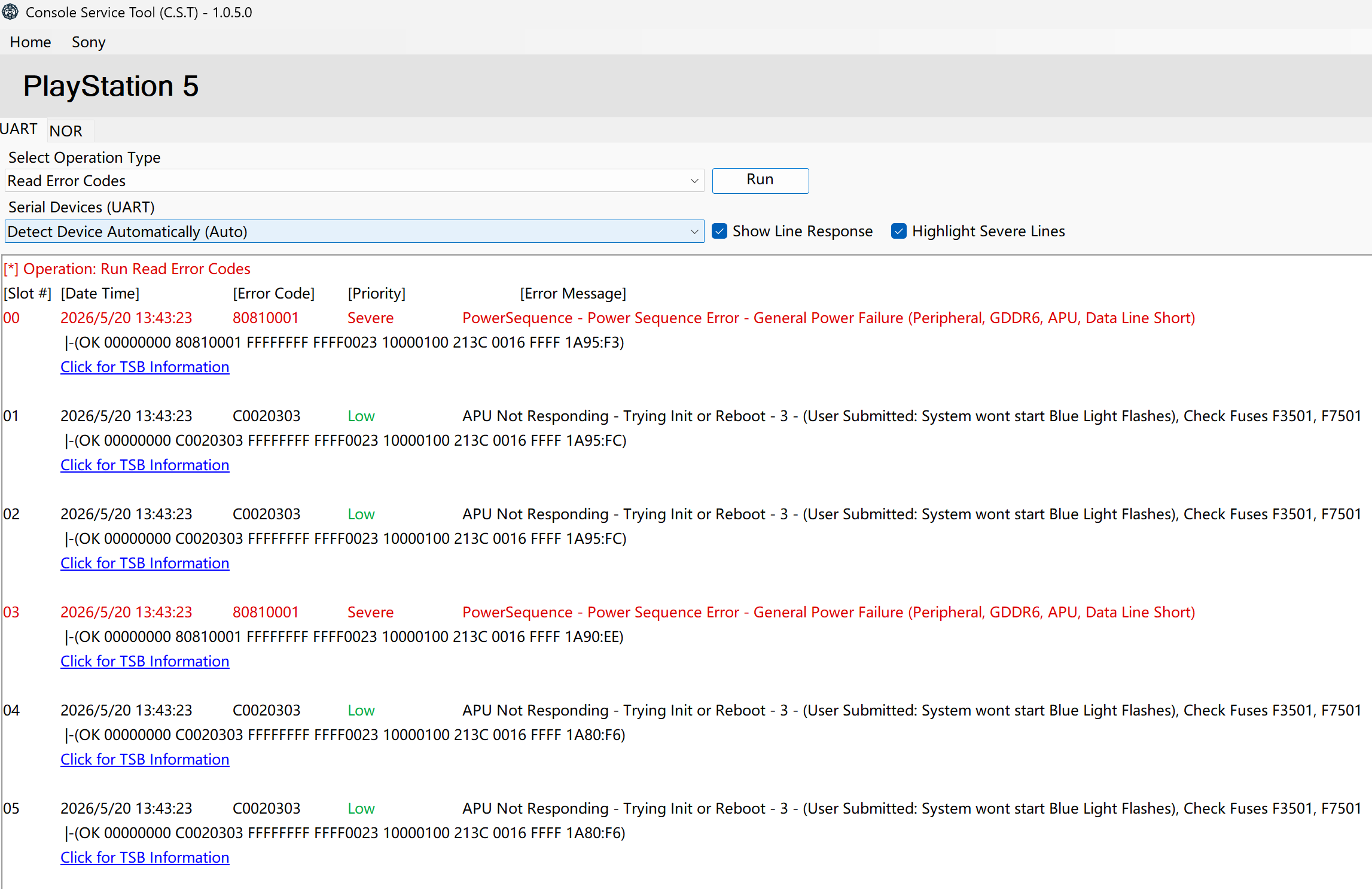

Hi, I have PS5 with 1 sec BLOD. Only one UART error - 80810001 FFFFFFFF FFFF0023 00000100 216D 0016
Any ideas?
216D has a error at ram, short or damage joint

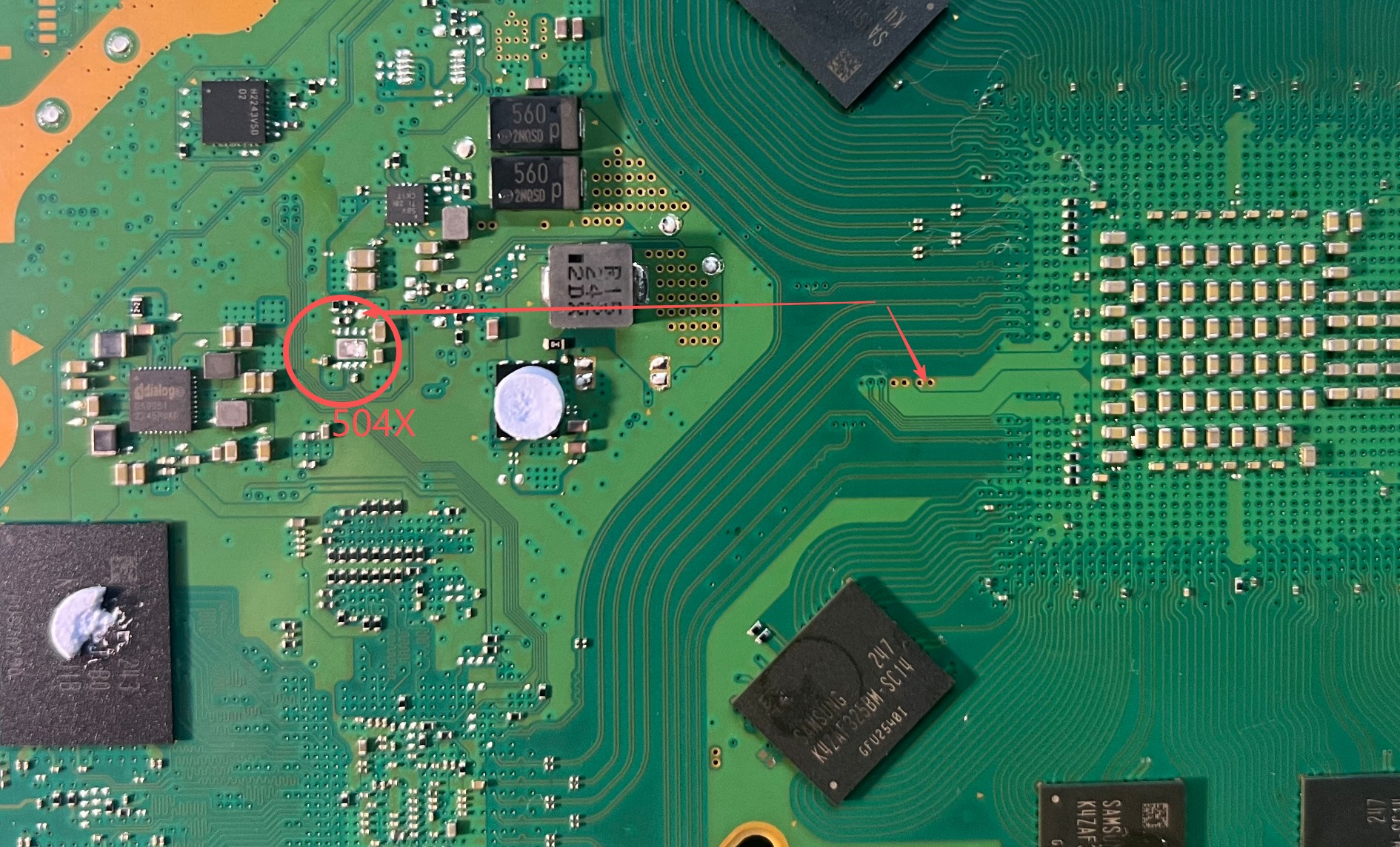

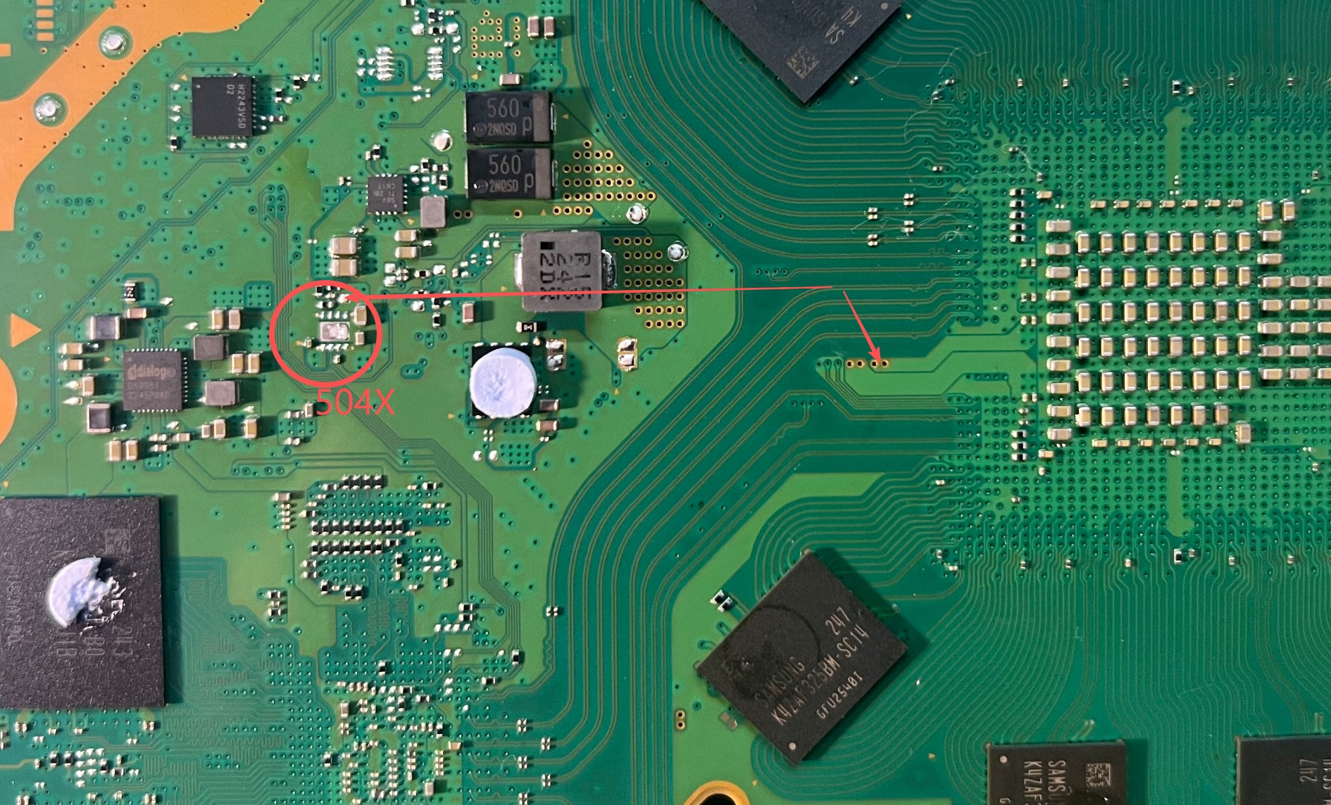

Has anyone here ever come across this code: 80871055?
I have two of them with this code, definitely the SSD chips are bad.

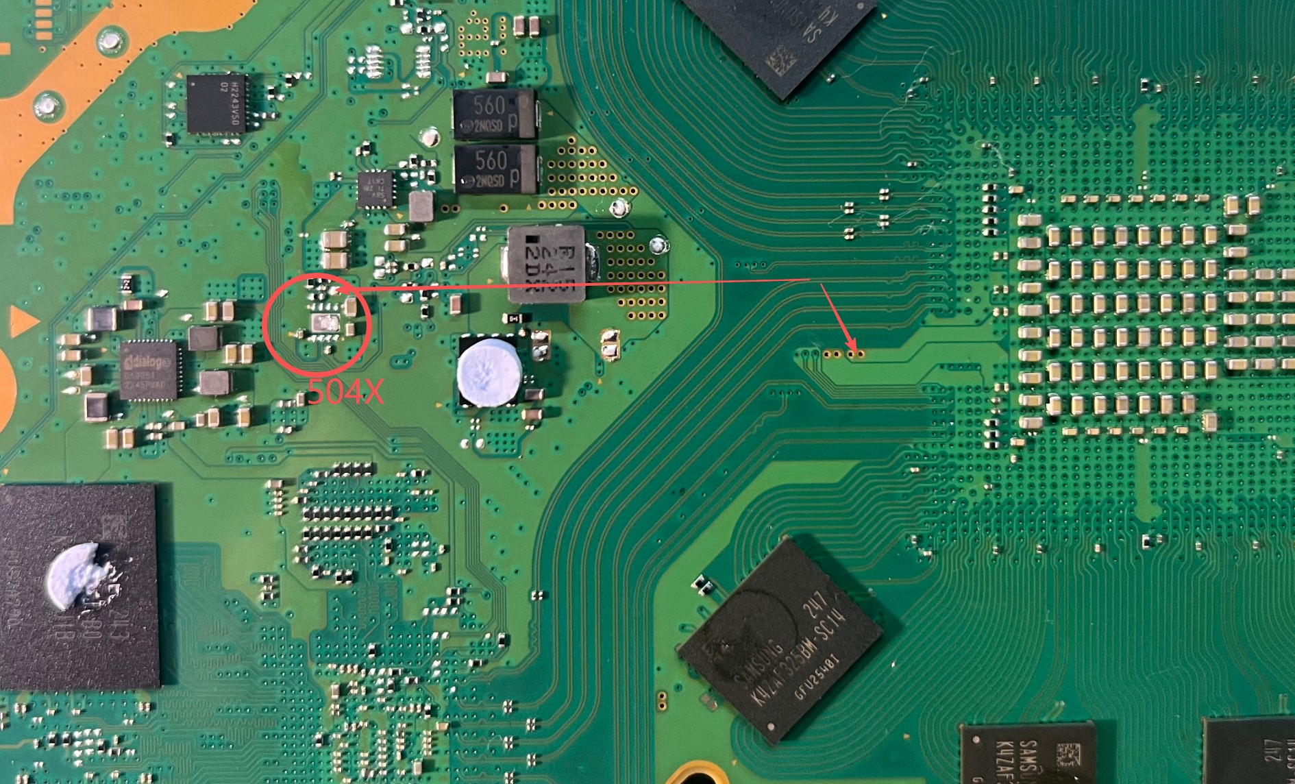

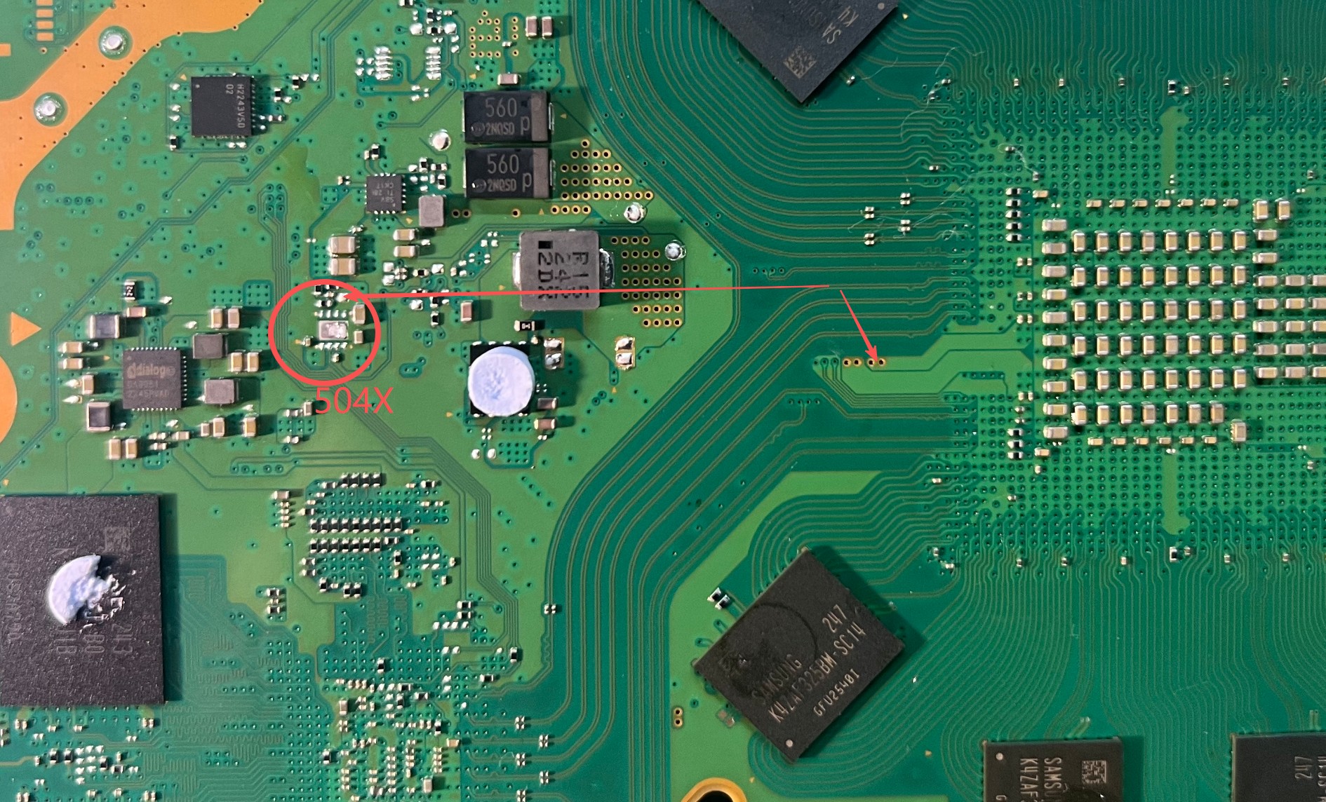

Thank you so much for your reply. I finally found that the 0.75V on the back of the APU was not working properly. After replacing it(504X or RJ=), and PS5 was fixed!
Hi, I have a 030 motherboard with the same error code. Could you tell me what got replaced?
