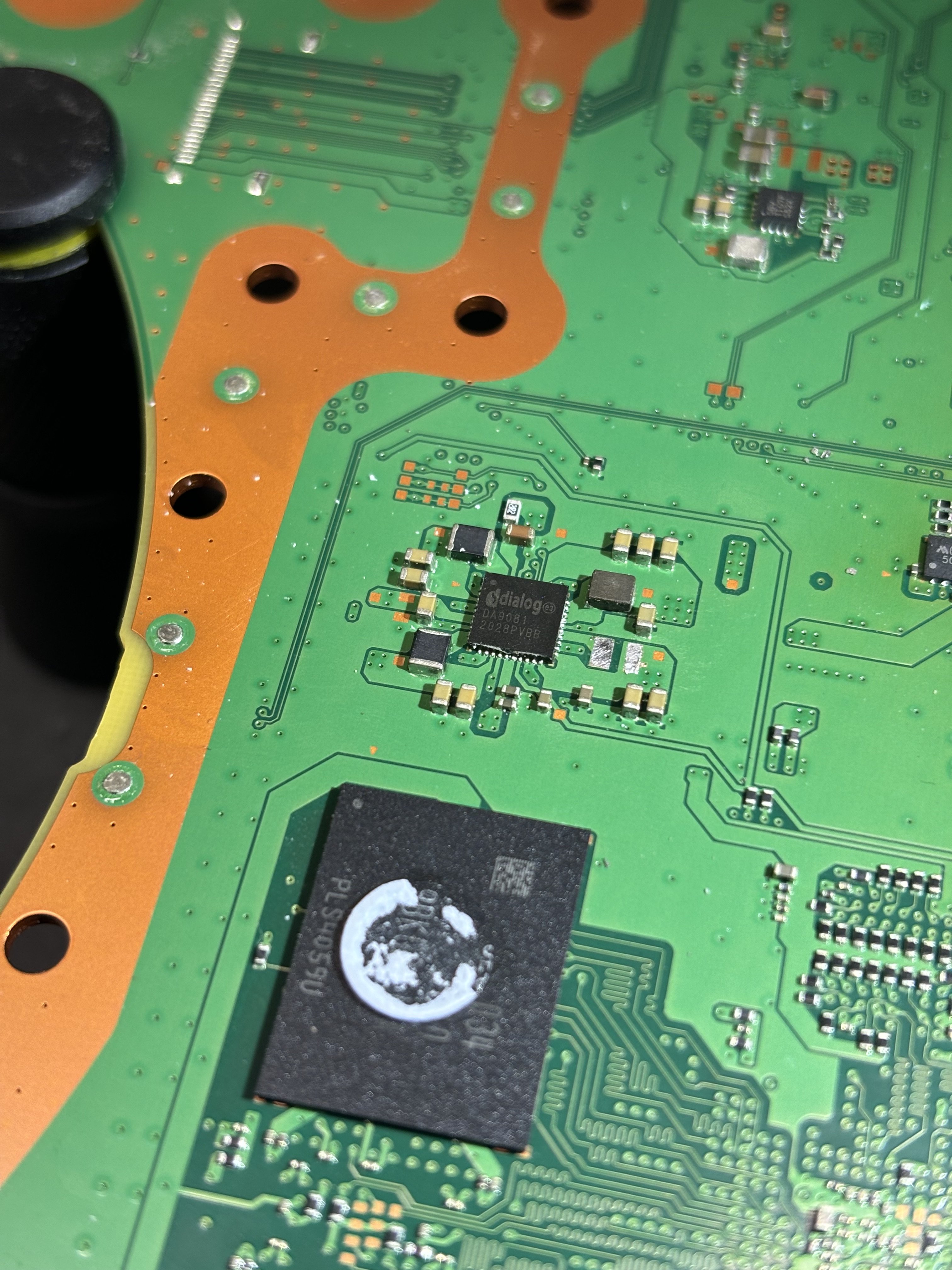

If there is not short, I would replace da9081 (if I got location correct😂)
There should be 4 voltages from coil ends (when 12v is started)
I had one EDM-010 with coil shorted -> I removed coil and different uart code came
Then coil replaced with 1uH and all good💪🏻

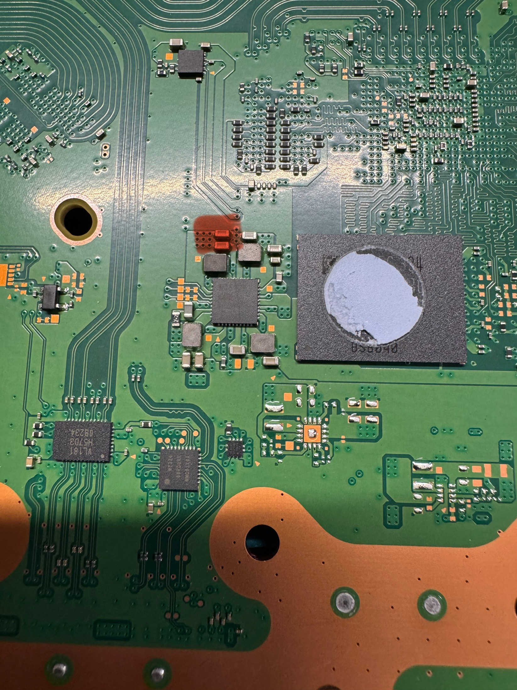

PS5 Slim EDM-040. 5 second blod. Only short I found was at the location below. The two caps highlighted. Resistance was about 78 but on my working board shows around 125. UART codes below.

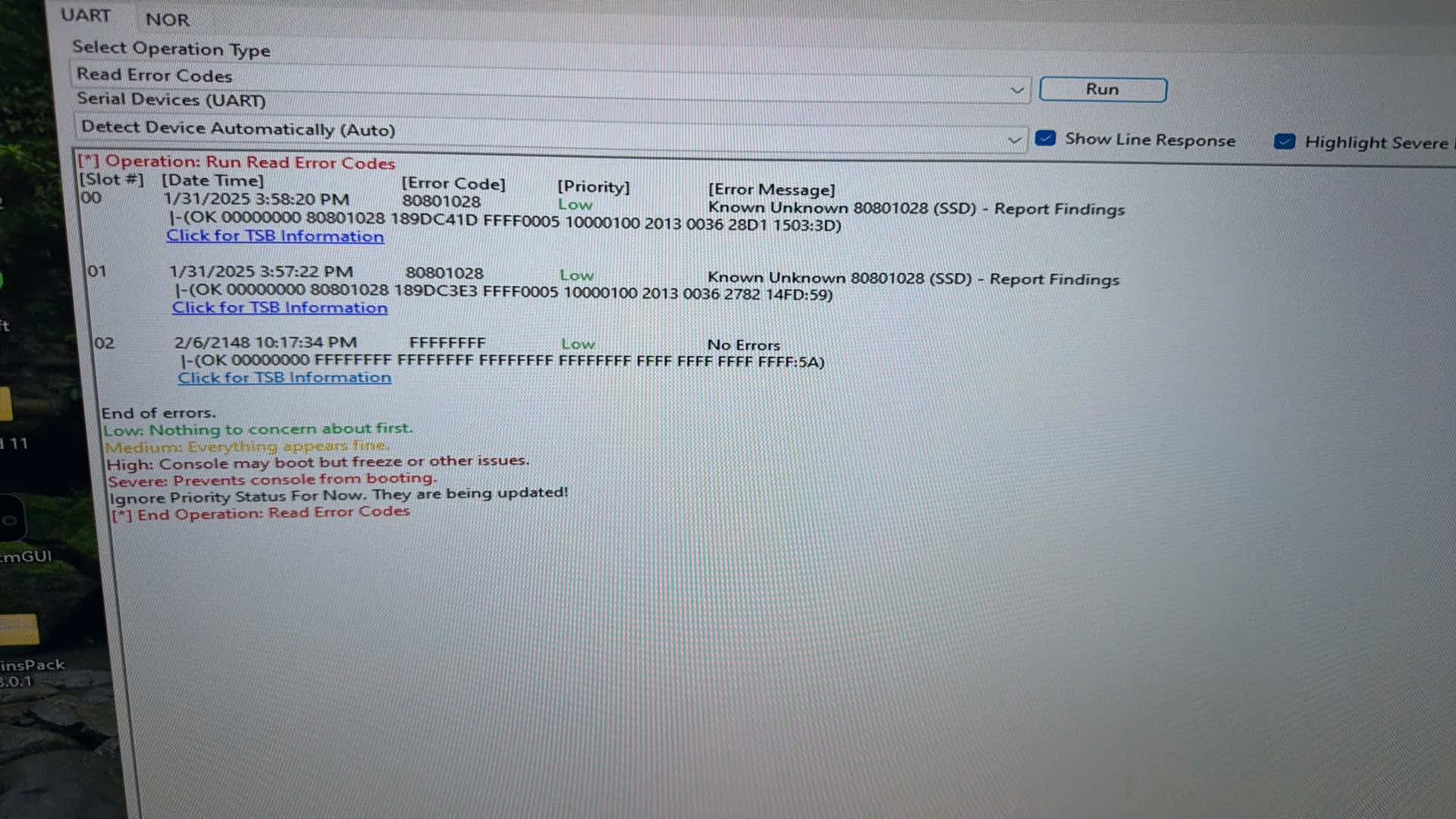

Hello, I have the exact same error on a PS5 Digital edition, 8/10 sec blod, and 80801028 UART Code error,
I have all voltage, no short found, I replaced the SSD DDR4 Cache no change, I found some people that attempt to swap SSD IC and Controller no change,
Anybody have informations / solution about the 80801028 error ?

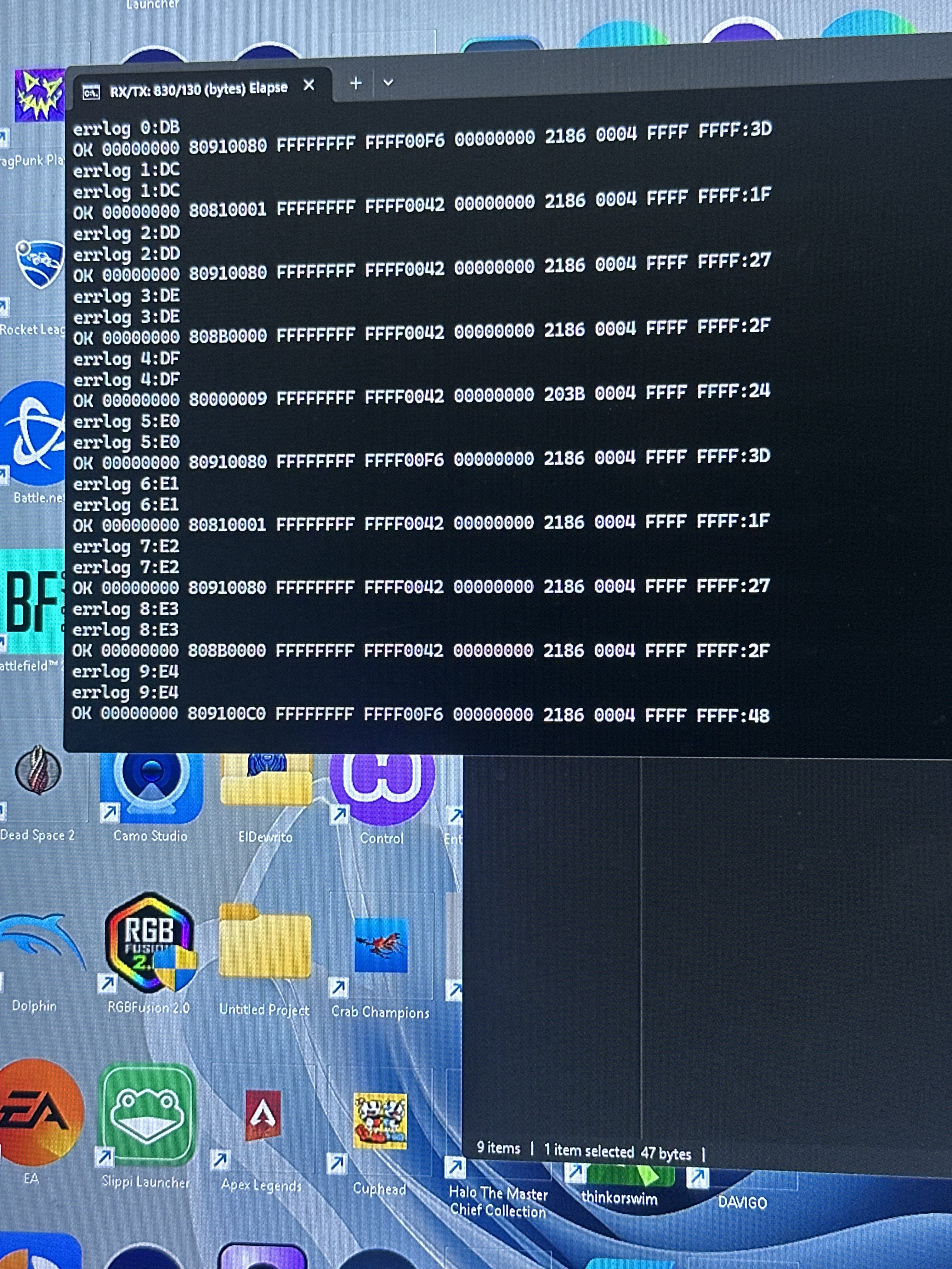

Hey I set up everything and the code I got is 80810001 Power sequence error [CE-105402-2]
What does this mean exactly in terms of what cap or chip to switch out

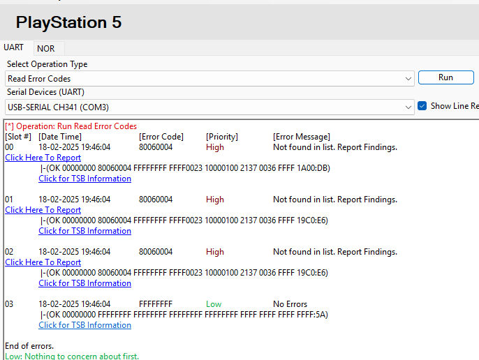

Hi,
Anybody have informations / solution about the 80060004 error ???
thks

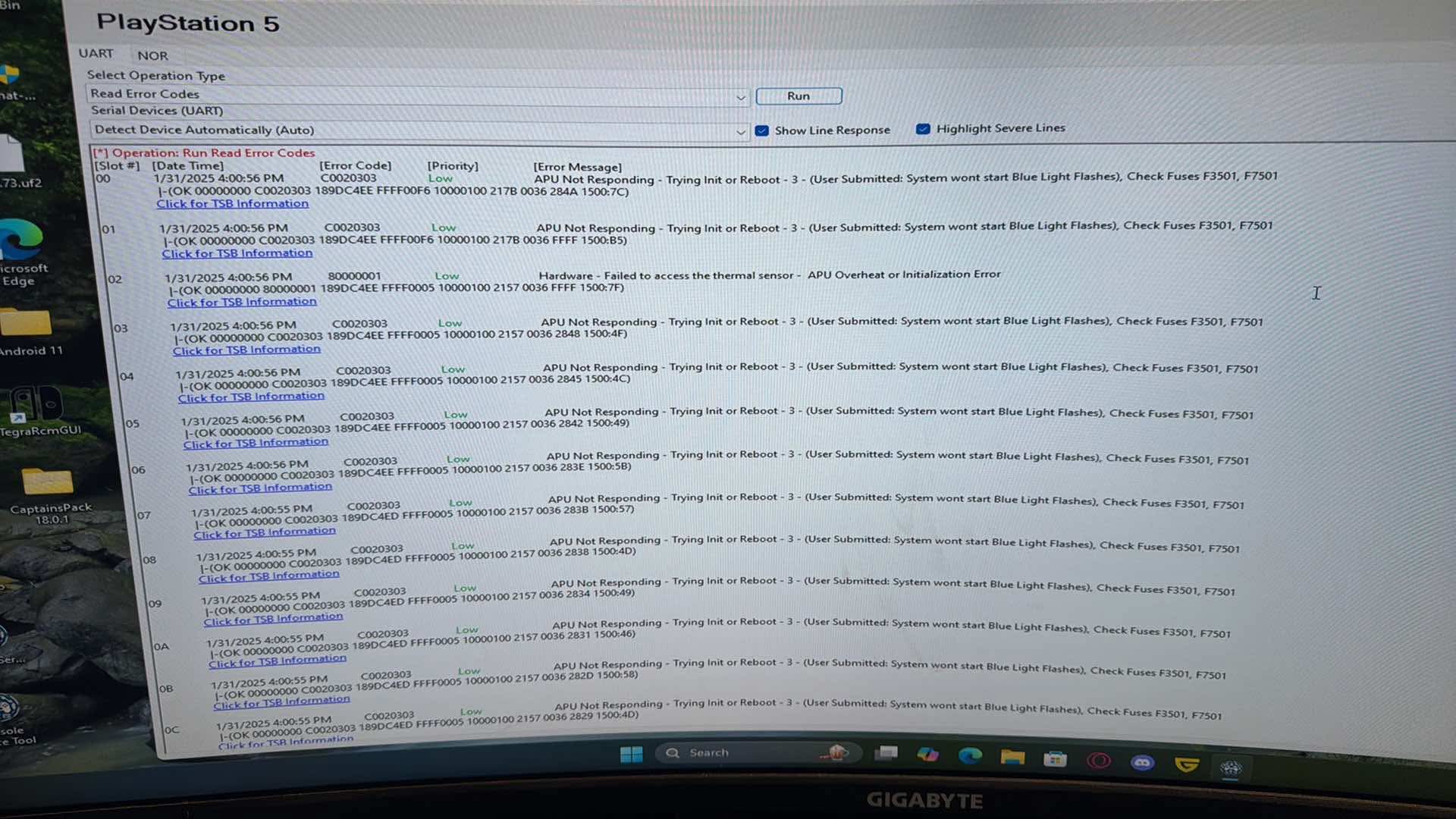

Anyone familiar with error.
80810001Short 3.3V at WiFi DC-DC bug at F7002 (2)
C0020303 APU access error SB-TSI I2C thermal sensor
the problem that it wont run ps5 games but runs ps4 games does anyone have a clue

SU-1013337-5 case: C0900303; case2: Bad USB C PD controller

Hello everyone! PS5 edm 010 after the PS logo reboots and asks to reinstall the software, the installation goes without errors and again the PS logo and reboot. There are no errors on UART. What could be the problem?
OK 00000000:3A
$$ [MANU] UART CMD READY:36
errlog 0:DB
errlog 0:DB
OK 00000000 FFFFFFFF FFFFFFFF FFFFFFFF FFFFFFFF FFFF FFFF FFFF FFFF:5A
