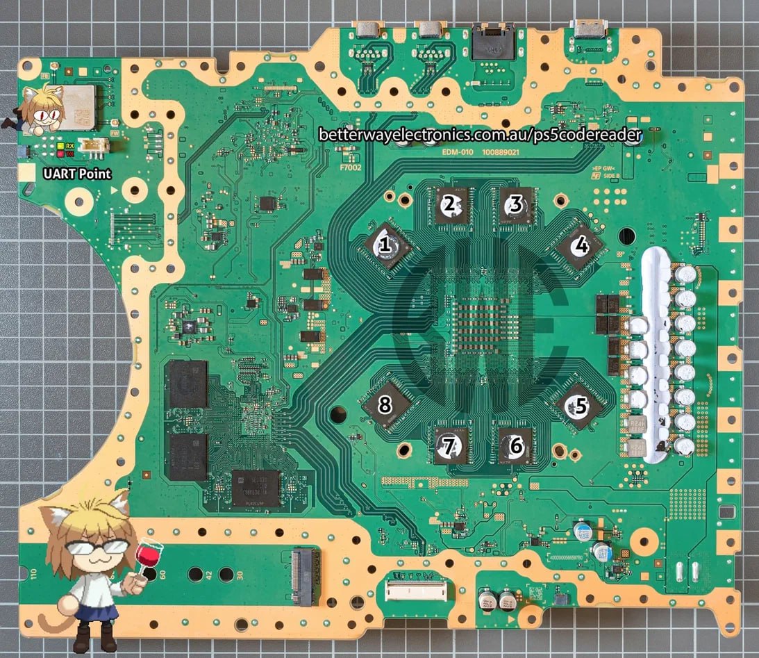

Hi. I have error code 80830000 (Shutdown or Freeze After SAM_IPL Loaded - GDDR6 Data Line Issue (Replace)). Maybe someone have meet it? Should I start to replace all Ram ic’s or its something different?
Hi, I have the same error, were you able to solve it?
Hello, I found new errors on a ps5 with possible damaged ram (all) and damaged Apu, the console presented an error:
80830000LowShutdown or Freeze After SAM_IPL Loaded - GDDR6 Data Line Issue (Replace)

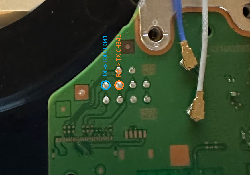

Greetings everyone! PS5 slim edm-040. Is there a UART pinout?
