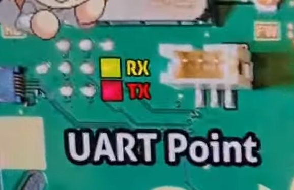

Hello,
I have a problem with a ps5
I can't read the error code i don't know why.
I use PS5 wee tools and i have install python and pyserial
the software has read the code one time and is giving me that:
€ÞÞ @ ûøÀЃ Ð €ü`?ÀðÿüÞŸÜÂÿþ OK 00000000:3A
$$ [MANU] UART CMD READY:36
üþ
i use a FT232L to connect at the computer.
i have try with PS5 Code reader and nothing.
I have connect the cable like the video of BTW and the screenshot
