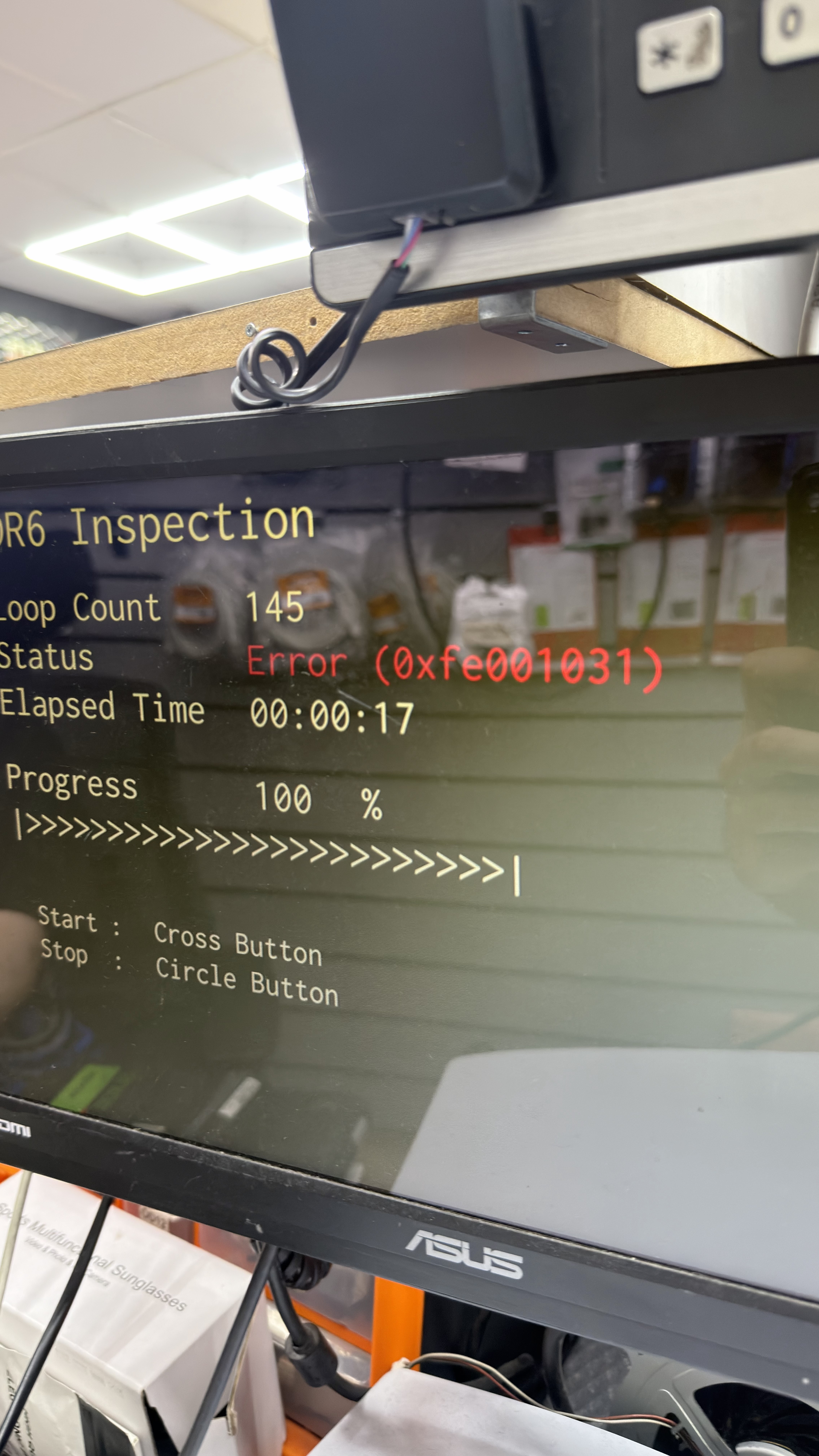

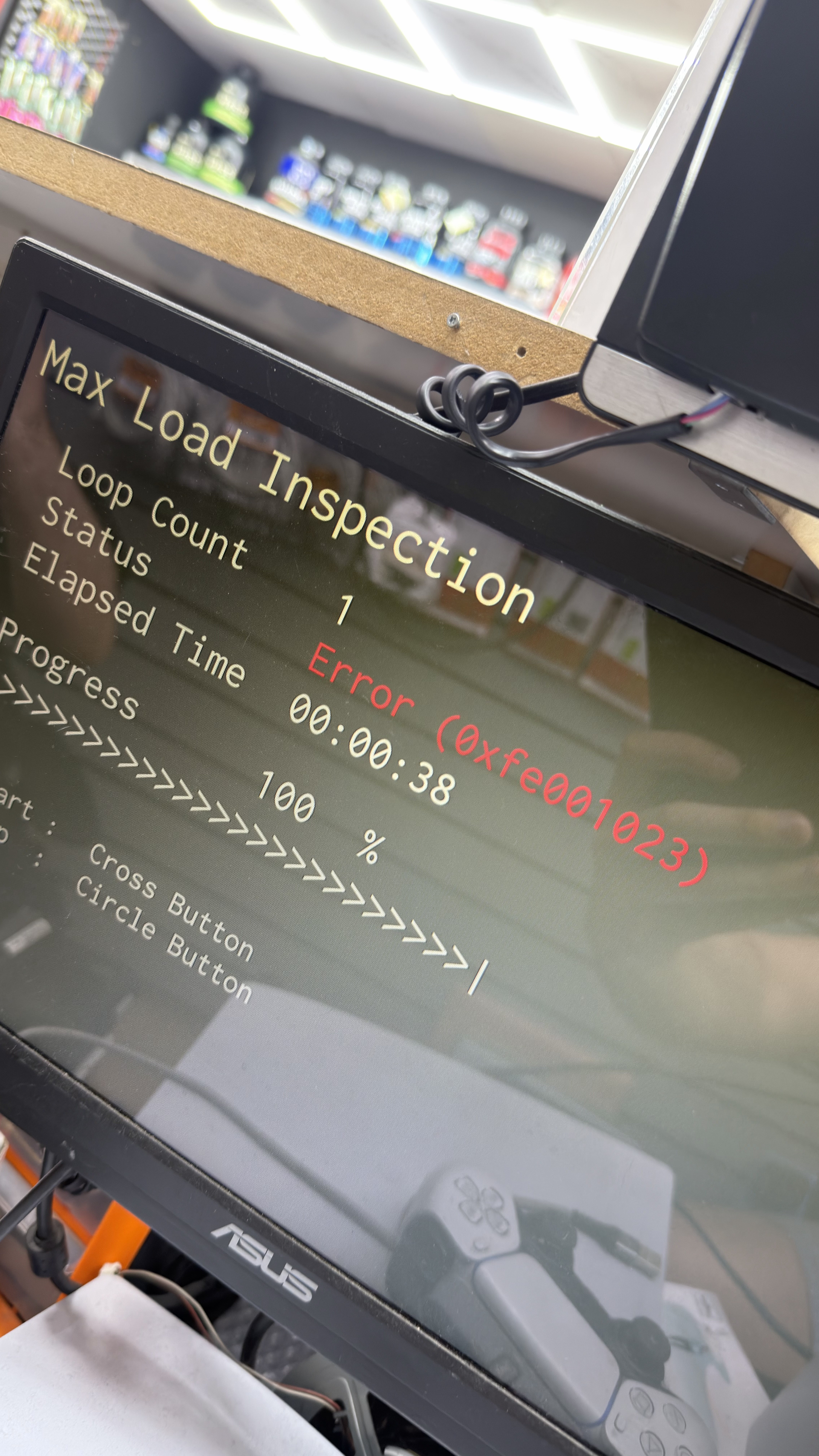

Hi guys,
Did any1 had problems with this error code? It comes from QA inspector just in less than a minute on RAM and full load test, uart does not have any errors.
Console works however it shows colour artefacts while playing ps5 games.

During the boot, there is only a very simple check if the dram chips are present and responding but it is far from a complete test. That is why the UART results might not be showing anything.
What kind of artifacts do you see?
If it is like pink dots or tearing images, then the dram might be causing it.
